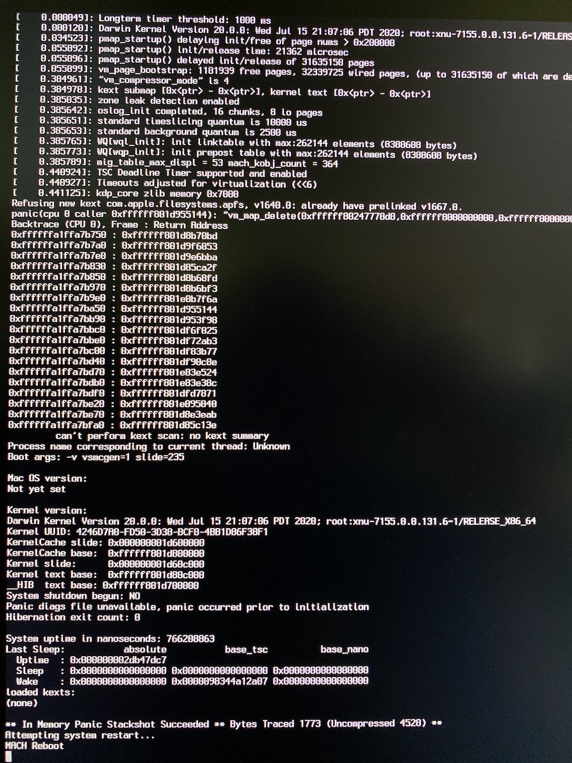

11 hours ago, iGPU said:
I've successfully updated from ß2 to ß3 using the 3970X VM in my signature. However, I have the Preboot label on the boot drive, not BigSur as intended. I'd like to change this, but I cannot seem to get into Recovery to disable csrutil. I had this same problem with ß2 Recovery; I could not boot into Recovery on Big Sur.
I can boot into Catalina Recovery just not Big Sur Recovery, so this makes me think that it's a BigSur APFS / OpenCore issue.
I tried many things, the first simply being to use the OC v060 that I use to boot into Big Sur (kexts and everything seems to work when booted into Big Sur). If I use this boot EFI, then I get an error saying "OCB: LoadImage failed - Unsupported".  This message then loops back to the OC menu each time the Big Sur Recovery disk is selected. (BTW, EnableJumpstart and JumpstartHotPlug are enabled.)
As some have suggested on this thread, I've tried adding apfs.efi or ApfsDriverLoader.efi, but these do not help much. They do show the Apple logo with a progress bar that goes ~5% and stops. When verbose is active, it stops as shown in image below (boot arguments are "-v vsmcgen=1"; oddly it says no kexts are loaded...)
I'd appreciate any help. Thanks.

Look at my post immediately above your post. (You can trace thru my previous posts from yesterday where I had same issue); maybe it will help your set up too.
