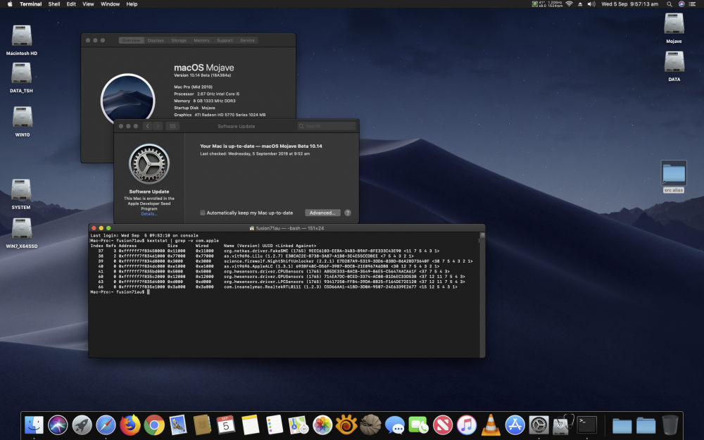

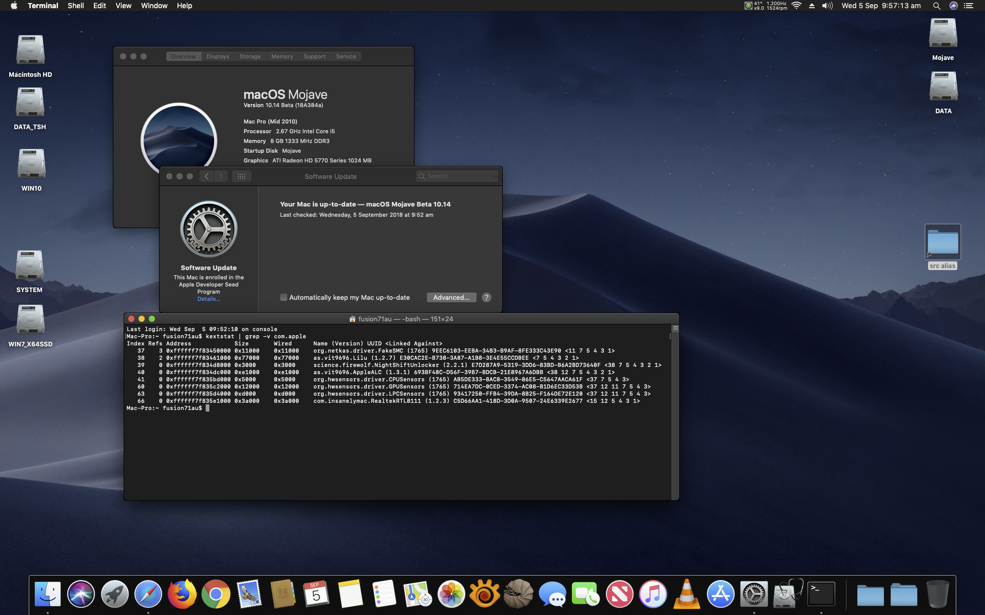

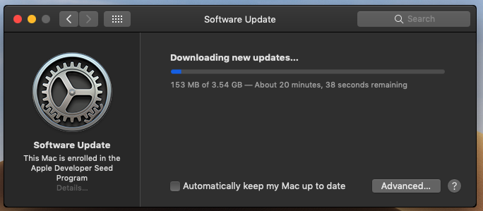

Beta 10=3.54GB

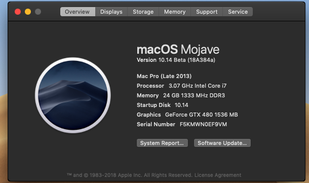

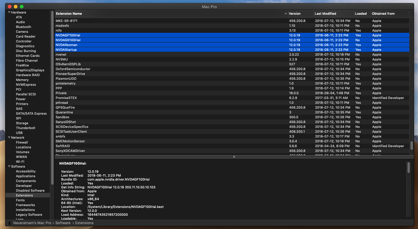

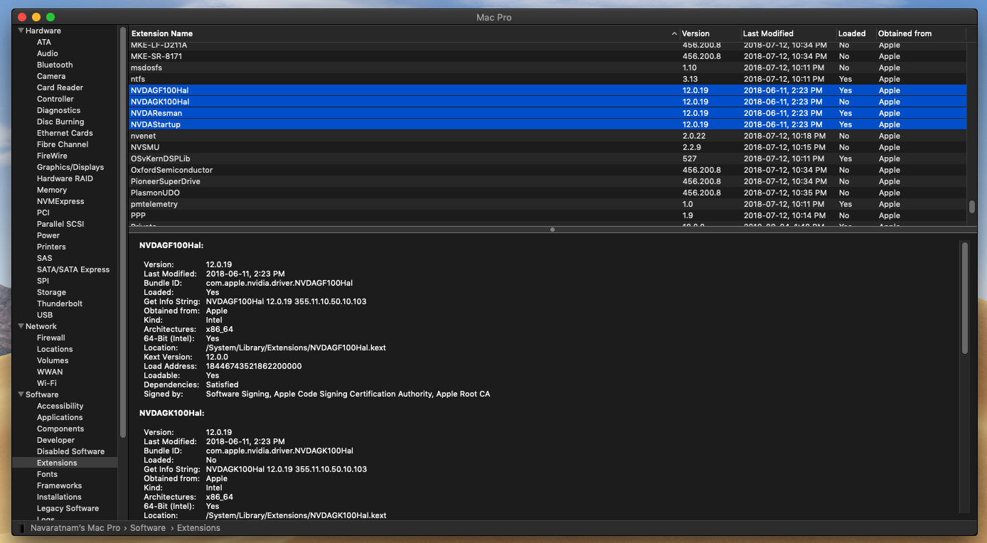

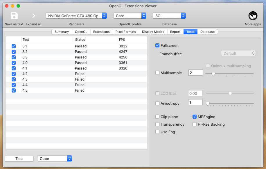

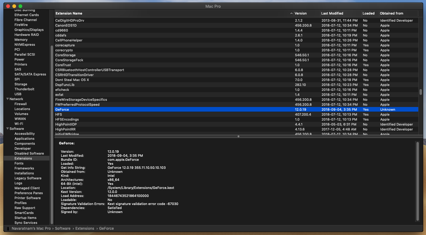

Graphics-GeForce GTX 480
GeForce.kext Not Loaded
NVArch=GF100 is missing in GeForce.kext info.plist
Edited by nmano

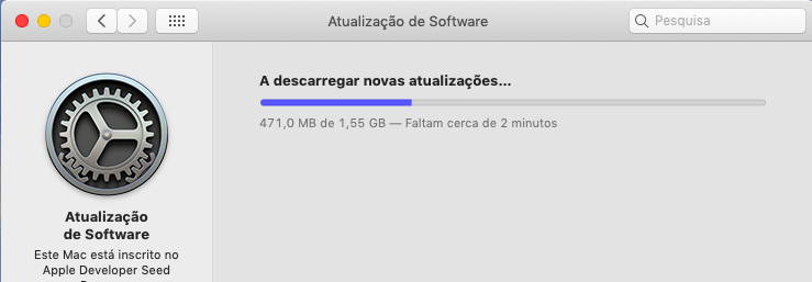

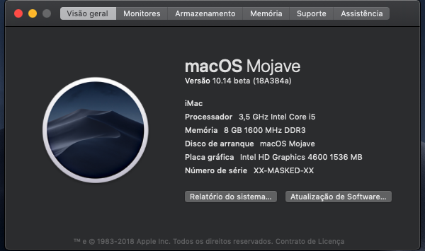

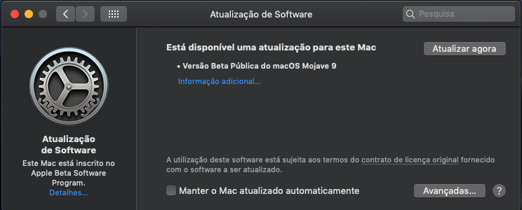

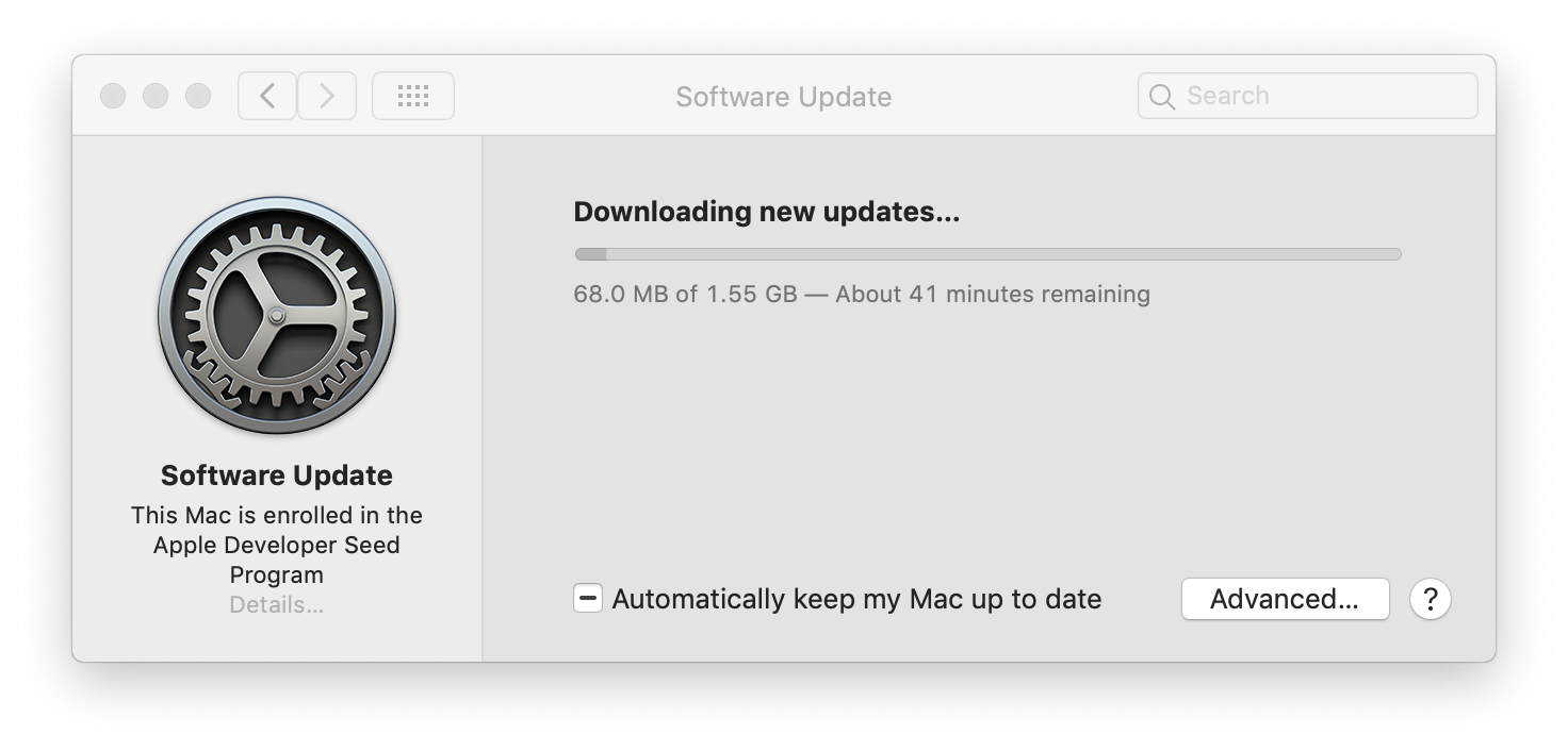

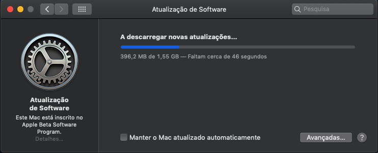

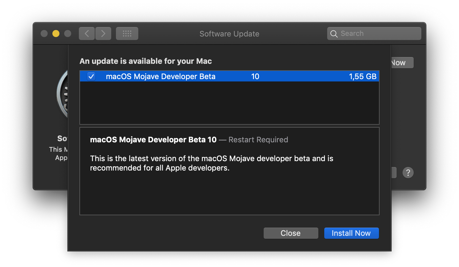

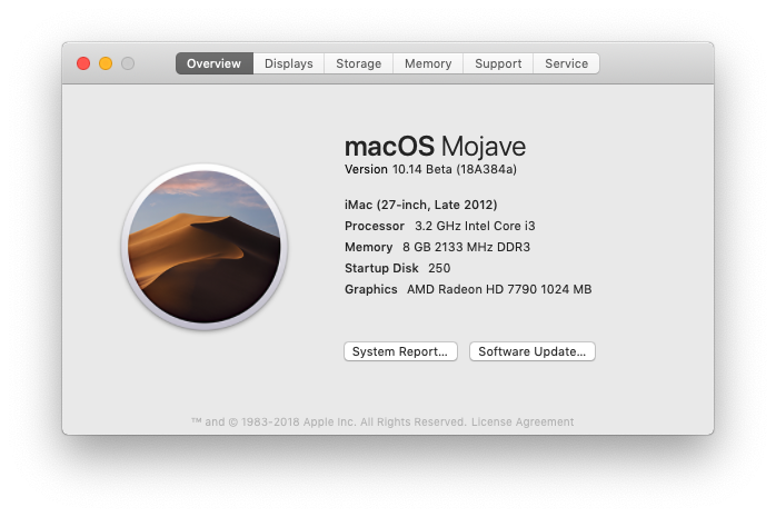

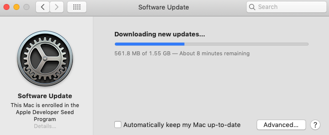

Update made with FakeSMC, and without kexts update and I have sound...
The update for me was 1.55 GB, too ... As you can see, in the second photo it says Public Beta macOS Mojave 9...
Edited by MorenoAv

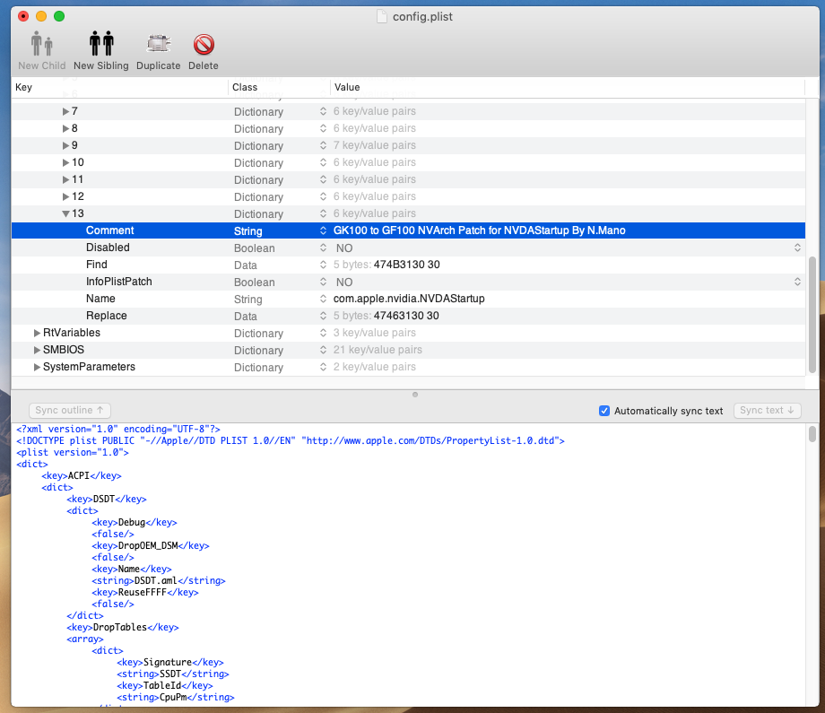

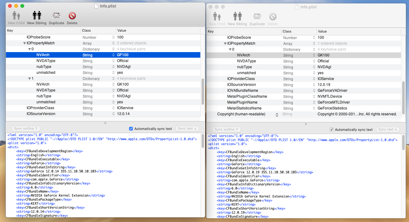

All GF100 Graphics card
1-GeForce.kext info.plist patch add manually
Under IOPropertyMatch change
GK100 to GF100

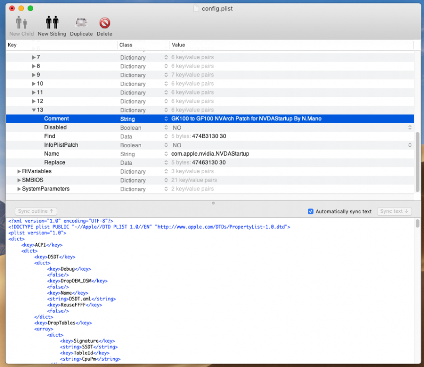

2-Add clover patched for NVDAStartup
Comment  GK100 to GL100 NVArch DisableGK for NVDAStartup By N.Mano
Name        com.apple.nvidia.NVDAStartup
Find          474B3130 30
Replace       474C3130 30
3-Replace CoreDisplay from 10.13.4
⁨System⁩ ⁨Library⁩ ⁨Frameworks⁩ ⁨CoreDisplay.framework⁩ ⁨Versions⁩ ⁨A⁩

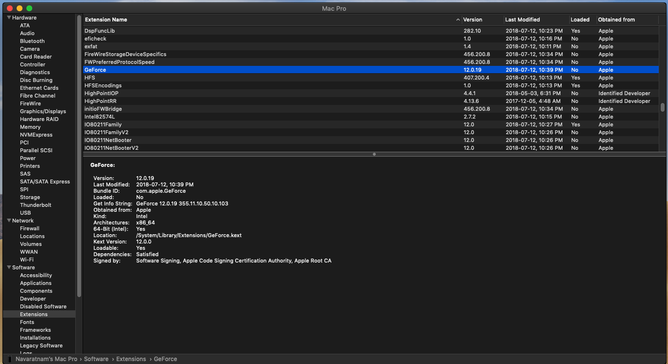

Finally All GeForce and NV kexts are Loaded.
CoreDisplay.zip
Info.plist.zip
Edited by nmano
  • Thanks 3

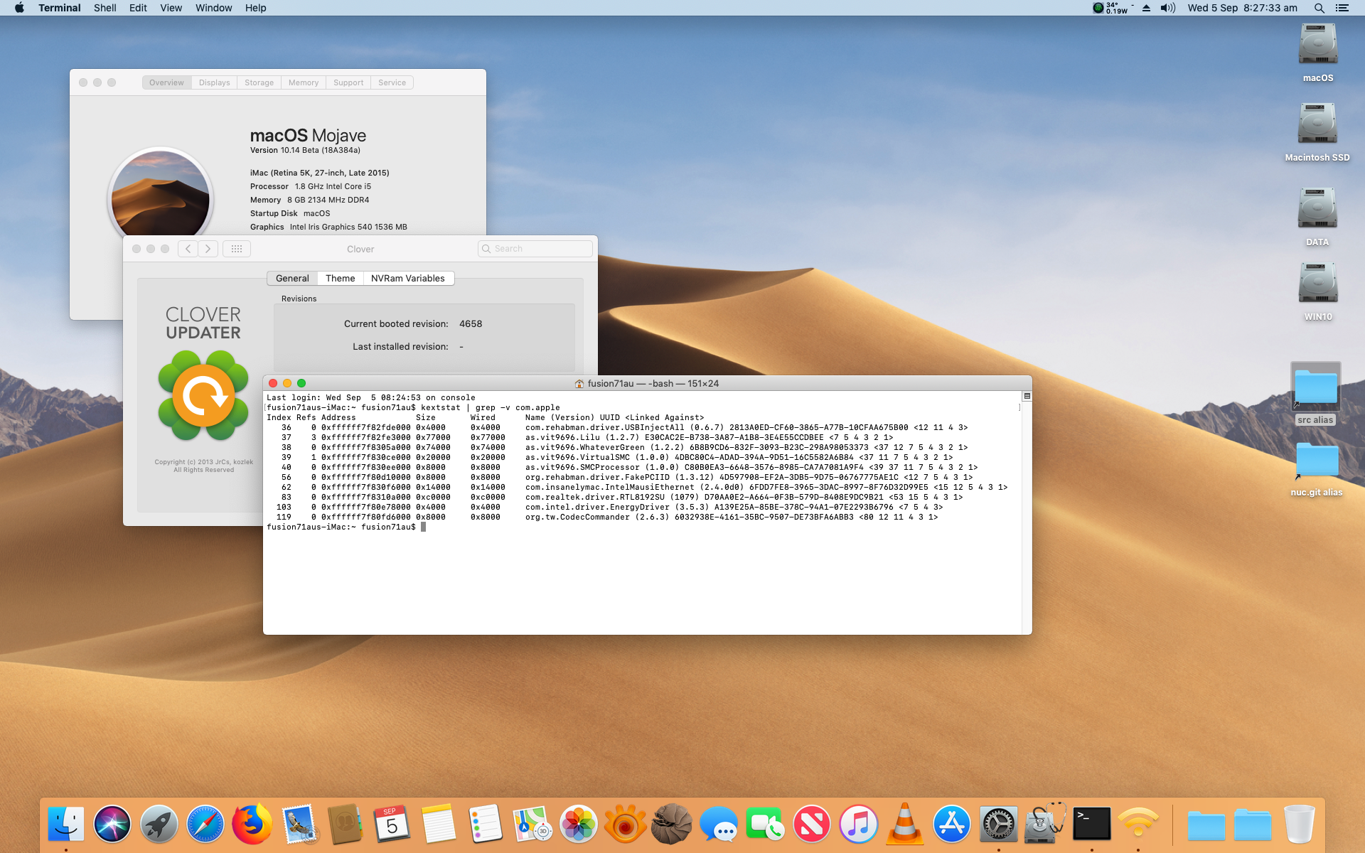

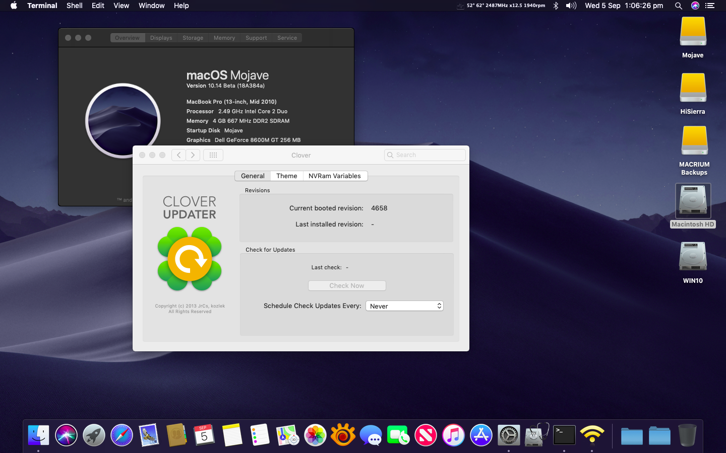

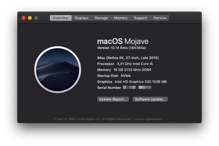

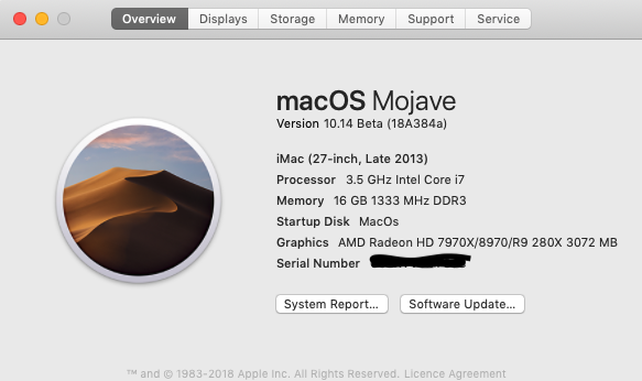

4 minutes ago, fusion71au said:
Works OK here with Clover r4658, App Store upgrade to DB10_18A384a on my Skylake NUC6i5SYH...
And... why you get no weird Apple Top Menu Bar on LightMode? Is it with reduced transparency?

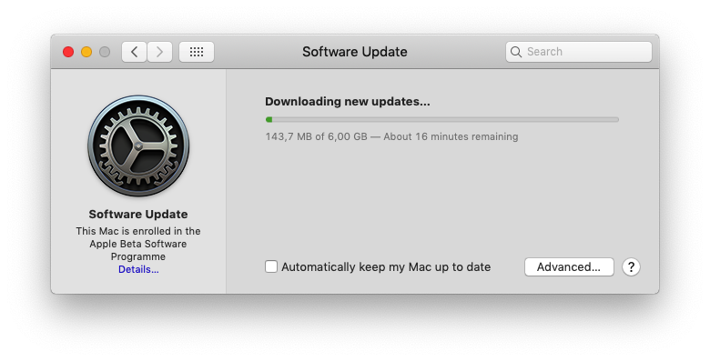

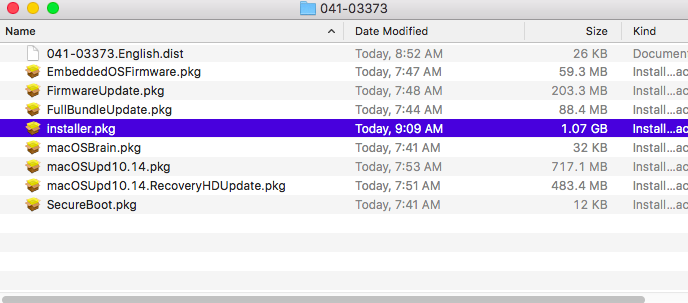

It is 6,00 GB here. At first it didn't show up. I tried all 4 settings from SWUSwitcher (was originally in Developer Seed Programme) multiple times, didn't help. Tried macOSPublicBetaAccessUtility.dmg again. No luck. Rebooted between almost each attempt. And after the second time of macOSPublicBetaAccessUtility.dmg and no reboot it finally found it.
Alright, let's see.
Edit 1:
… And that downloaded the "Install macOS Mojave Beta.app" into my Applications folder. I've never downloaded a whole macOS from within System Preferences. This was a first time experience!
But:
I do not want to reinstall everything from scratch.
How do I make my update works? I've tried SWUSwitcher and Apples official macOSPublicBetaAccessUtility.dmg method… It doesn't show up:
That is 18A377a telling me that.
Any ideas?
Edited by illdev

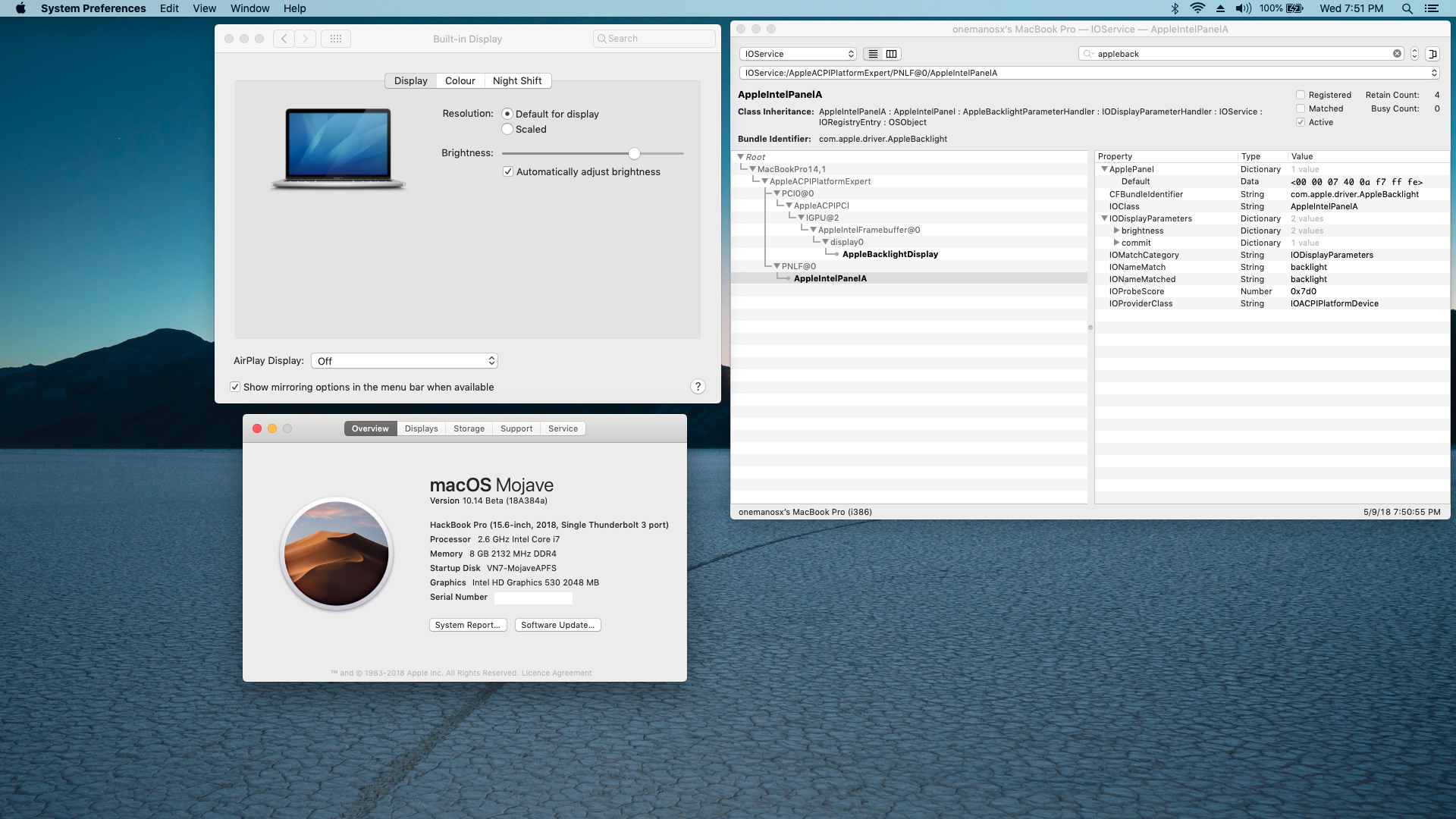

No, transparency is at default.  Iris Graphics 540 for my Skylake NUCi5SYH is natively supported in Mojave :).

Eject /var/folders/z3/6smvlngj74n6__3rr1xr31z80000gn/T/tmp.1OWTYBAJ
"disk6" ejected.
Delete /var/folders/z3/6smvlngj74n6__3rr1xr31z80000gn/T/tmp.1OWTYBAJ
Creating installer.pkg without macOSUpd10.14.RecoveryHDUpdate.pkg and macOSUpd10.14Patch.pkg...
productbuild: Wrote product to installer.pkg
Installing update to System partition without macOSUpd10.14Patch.pkg.
Password:
installer: Package name is macOS Mojave Developer Beta
installer: Upgrading at base path /
installer: The upgrade was successful.
installer: The install requires restarting now.
After updating finished and reboot, Safari and App Store will stop connecting to the internet.
To fix this, need to run the following code in Terminal, and reboot after finished:
sudo update_dyld_shared_cache -force
完成更新及重新启动电脑之后,Safari 及 App Store 将发生无法联网的错误。
须在终端,键入以下命令修复,并在完成后重新启动电脑:
Spoiler
649177707_MojaveDB10_18A384aonXPSM1530.thumb.png.4747bf9ee656d9313a9e235b724a3bfb.png
2 hours ago, illdev said:
Could I now reinstall this appearantly yet unpatched macOSUpdCombo10.14.pkg with Installer.app without breaking anything?
Yes, you can reuse the installer.pkg to update Mojave on another machine, as long as it is at the same starting point as the original machine eg update from DB9 to DB10.  I copied installer.pkg from /tmp/041-03373 to a USB thumb drive, then ran it on the second machine.  Don't forget to update dyld cache afterwards....
Edited by fusion71au
answer extra question from @illdev
  • Thanks 1
  • Haha 1

Yeah the clean install of DP 10 went fine on my SkyLake rig and I'm doing another clean install on my IvyBridge right now.
Update:
All good on my IvyBridge as well.

Backlight display slider works native?
I was a little bit annoyed when I installed Mojave Beta 1 on my laptop and the brightness slider function broke.
And I decided to troubleshoot by first blocking the backlightinjector kext and its clover patch on Beta 10.
Lo and behold, the brightness slider works! NATIVE! Unbelievable!
Edit: Except still require PNLF ssdt for slider to appear. Stoked nonetheless..
Edit2: Work in High Sierra 10.13.6 without kext and clover patch as well
136382028_Screenshot2018-09-05at7_51_08PM.thumb.png.ce8ce2e1988f4ee751c97a17ec89f8aa.png
