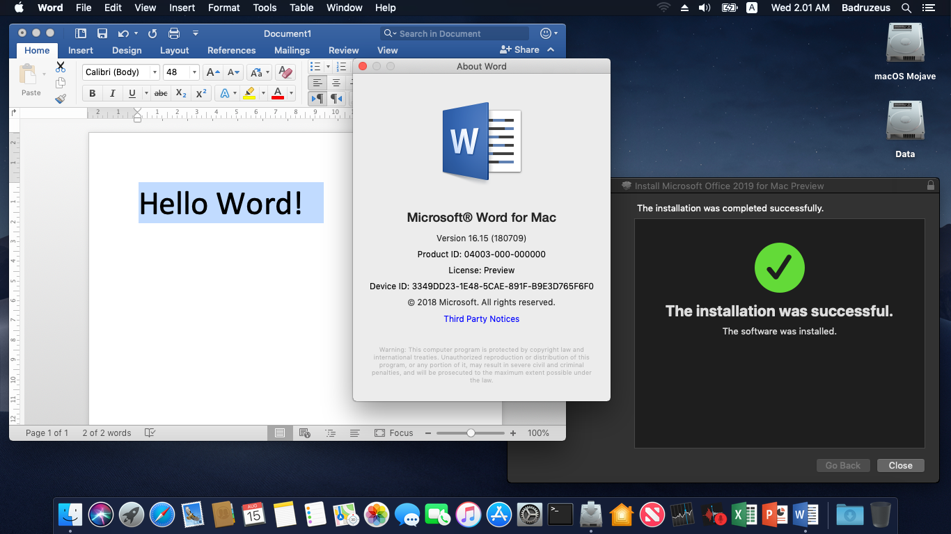

Yuu huu, updated to macOS Mojave Beta 7 (18A365a) on my pretty old Asus A43SJ laptop, finally.. uhmmb, for testing "Microsoft Office 2019 for Mac Preview" but.., this new office app still has no DarkMode appearance, or Microsoft just make it like that.
Oh, I need using DP 1 to get Beta 7 update notif (bcoz, DP 1 is the only full installer I have #LoL), w/o any BetaUtility installed. Thanks.
Edited by Badruzeus

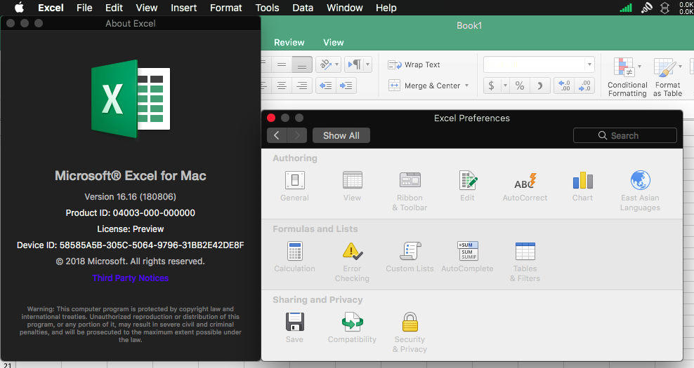

2
It seems you're one update behind. Here's the latest version with supposedly dark mode(!)

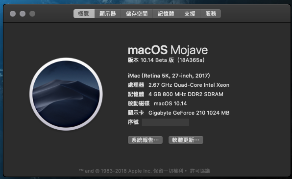

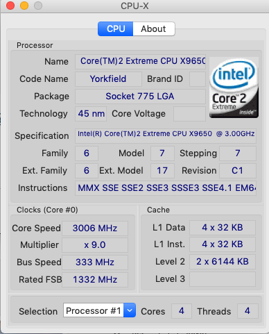

15 hours ago, crazybirdy said:
New patch script.
It works fine with 10.14 db1 ~ db6, and future version for CPU SSE4.1 as E8400.
mojave2core.zip
Thanks for this patch which also working for Mojave beta7 in my ASUS P5Q PRO hackintosh with CPU Core2 Extreme X9650 which is similar to E8400 without SSE 4.2 support.
Edited by jsl2000
  • Haha 1

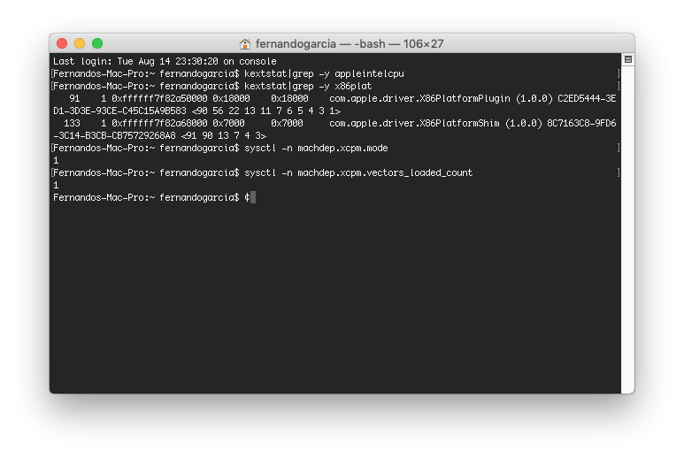

16 hours ago, Pavo said:
I guess I am not understanding how to enable XCPM on dual Xeon E5 2670v2 Ivy Bridge-EP cpus.
Try it here! I think PMHeart also uses and talks about Ivy Bridge...
https://www.insanelymac.com/forum/topic/334898-pre-release-macos-mojave/?page=2&tab=comments#comment-2616660

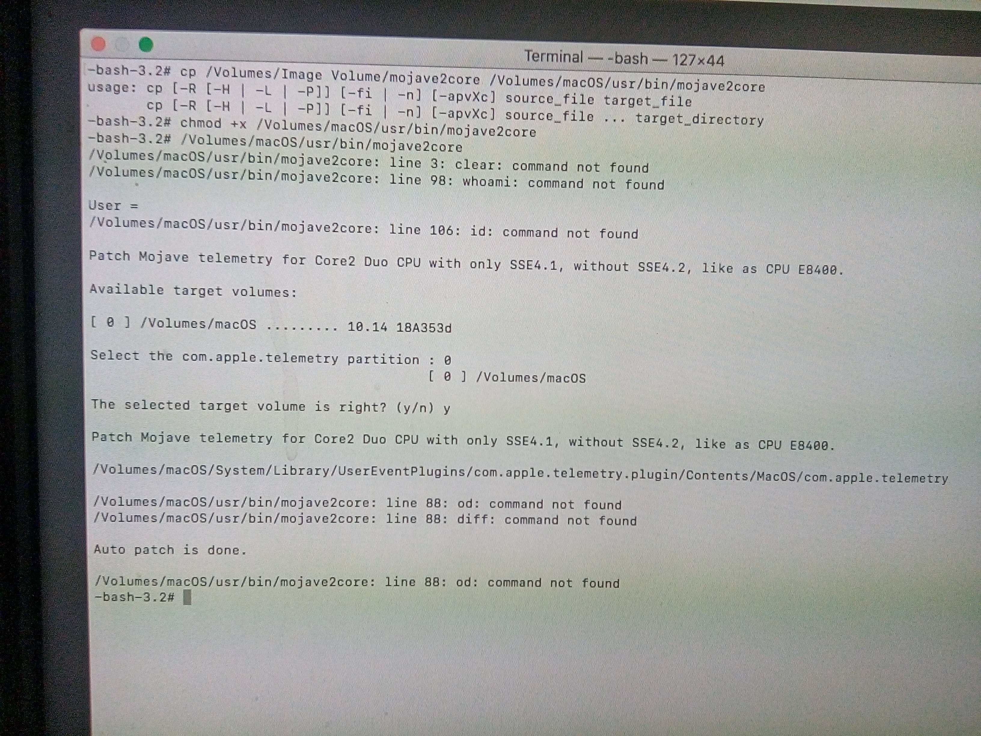

On 8/16/2018 at 1:46 AM, ANONIMNIQ said:
@crazybirdy I get some errors when running the script. I can't find a way to put the script file directly on the root of the USB, so I put it in the installer partition.
Clover boot -s to single user mode to apfs system /macOS.
PS: your cp command is wrong. Need copy again.
Try to rename "Image Volume" to single name.
or add \ as "Image\ Volume" when you use cp.
@ANONIMNIQ
Try this new script, it should work on mac installer, needn't boot to apfs partition.
Q5-mojave2core/mojave2core
windows:
copy to mac installer/mojave2core
clover:
boot to mac installer
Run Terminal:
cp /mojave2core /Volumes/1014name/usr/bin/mojave2core
chmod +x /Volumes/1014name/usr/bin/mojave2core
done.
1014name is your 10.14 volume name.
