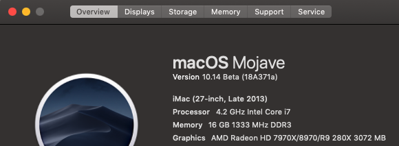

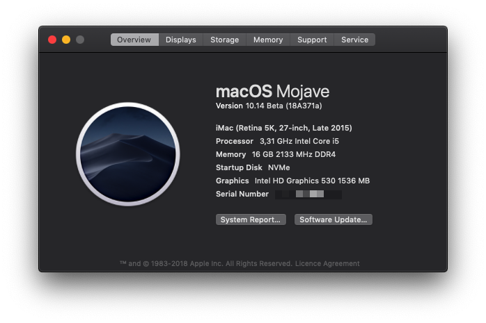

I'm back and made all the updates successfully and just now made the last update Mojave beta8 (build 18A371a), and all works as it should... not necessary to update or re install any kexts...

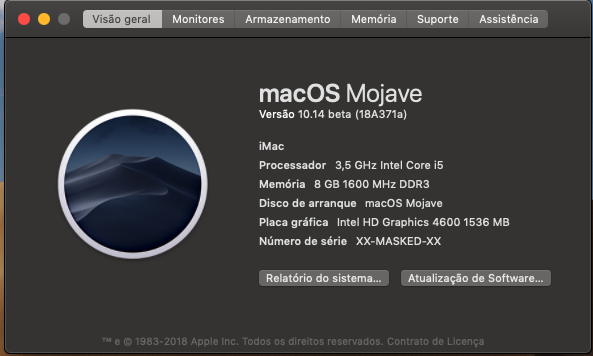

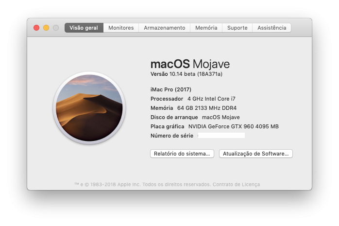

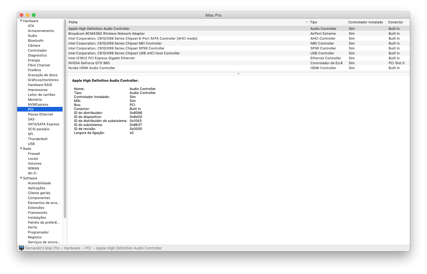

Update on X-99 to 18A371a
Edited by Fergarth

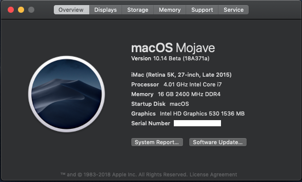

Yeap, plus a Mojave update on the X-99 with Haswell-E without any problems and as always with everything running, even without native support! The question is: Why do I always have KP on the Skylake Laptop with native support???

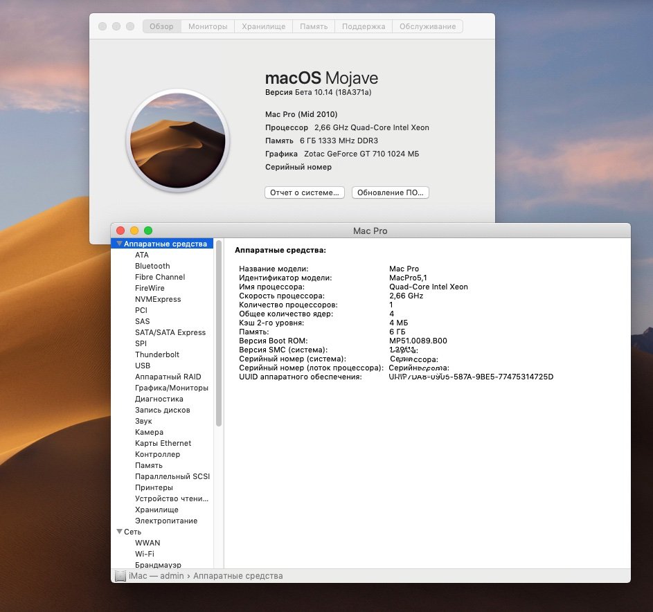

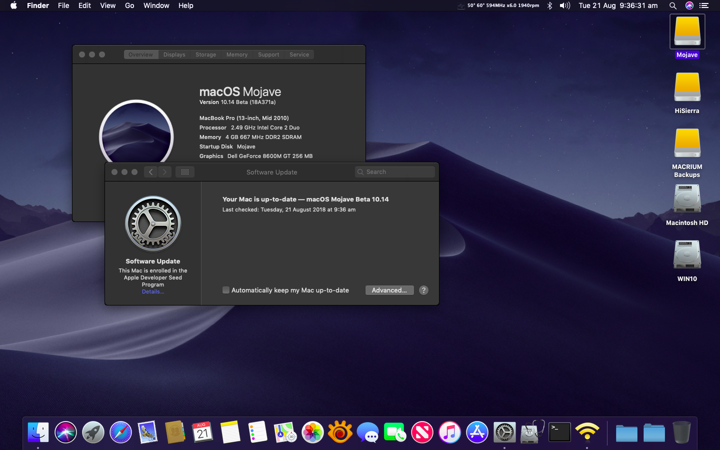

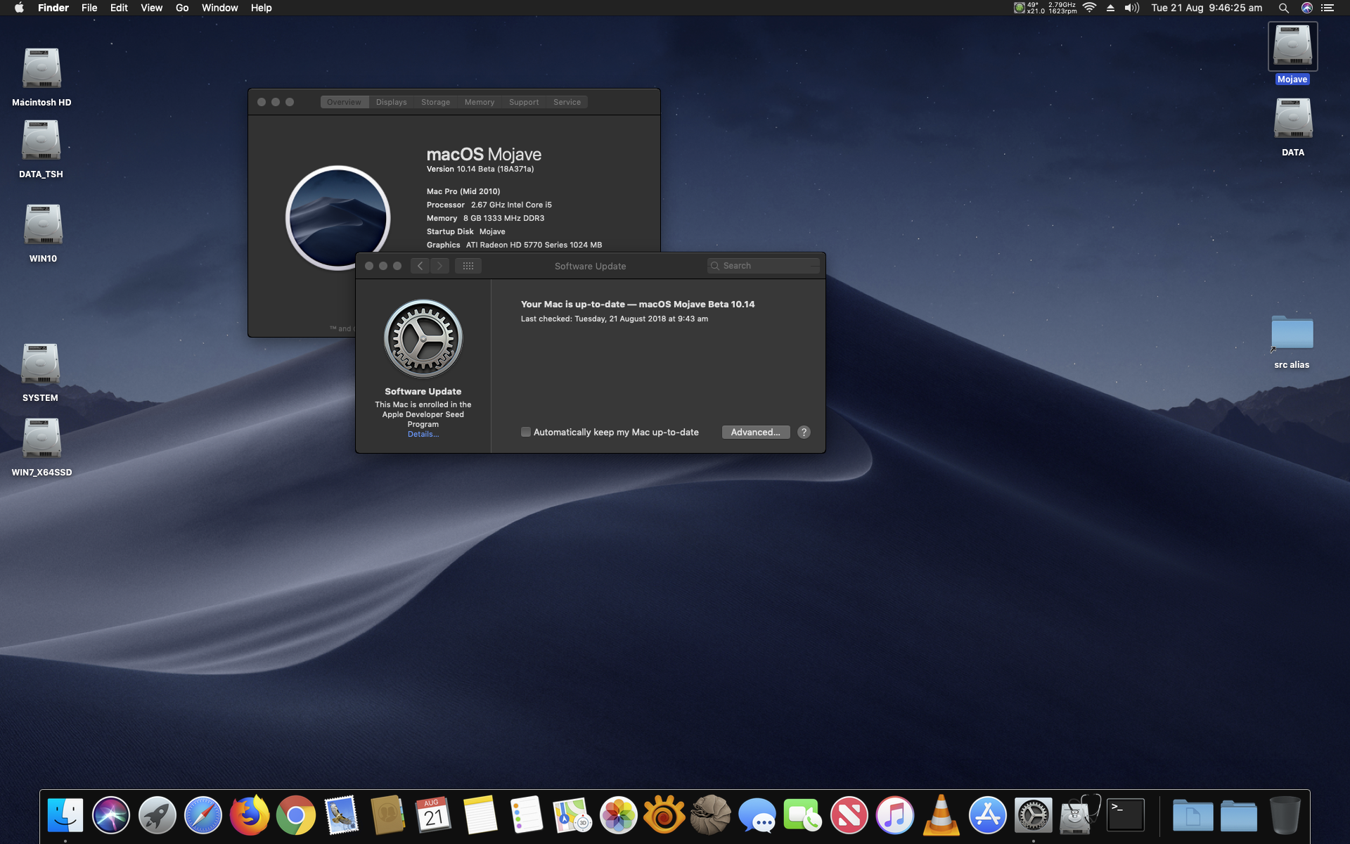

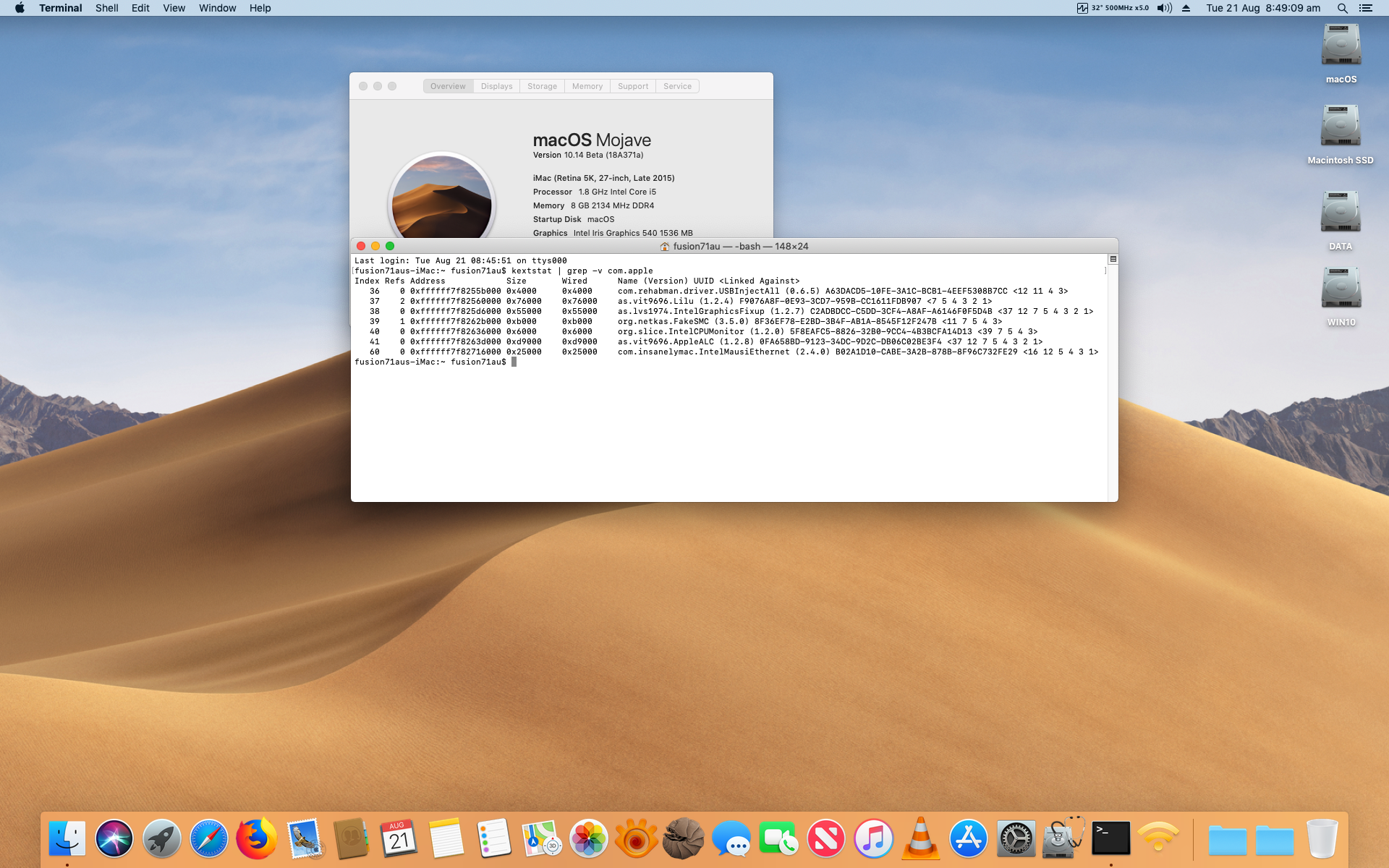

Successful upgrade of all my systems in signature to DB8_18A371a.
Skylake NUC6i5SYH, legacy BIOS GA-P55AUD3 desktop and legacy notebook Dell XPSM1530...
Spoiler
NUC6i5SYH_DB8_18A371a.thumb.png.d4415e7adc9b3d017a9b6fab24fb6683.pngGAP55AUD3_DB8_18A371a.thumb.png.f75d4108a90cf2ae2cc97f59e5d3941b.pngXPSM1530_DB8_18A371a.thumb.png.c30c1bb98e149cb4b8335002f73f4a0d.png
The legacy systems were upgraded in place after making a full installer USB, patched with @dosdude's macOS Mojave patcher - XPS with Mojave on HFS+ and P55AUD3 with Mojave on apfs volume.  The AMD HD5770 works OK but unfortunately without graphics acceleration, despite adding graphics kexts for HD5000 from High Sierra.  On the other hand, QE/CI was still possible with legacy GeForce tesla kexts for the 8600M GT.
As before, on first boot (in single user mode) for my Core2Duo laptop, I ran @crazybirdy's mojave2core ---> patch com.apple.telemetry.plugin, then updated system caches/prelinked kernel...
fsck -fy
mount -uw /
/usr/bin/mojave2core
touch /System/Library/Extensions && kextcache -u /
reboot
The Skylake NUC upgraded painlessly by directly running the full installer "Install macOS Mojave Beta.app"  :).

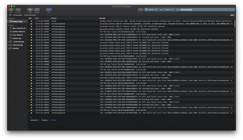

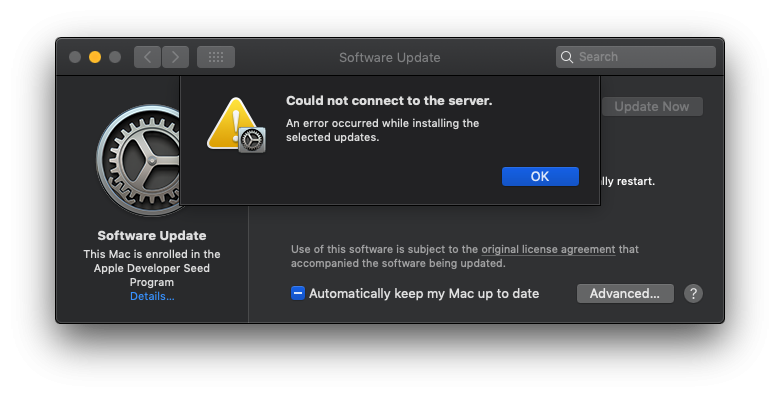

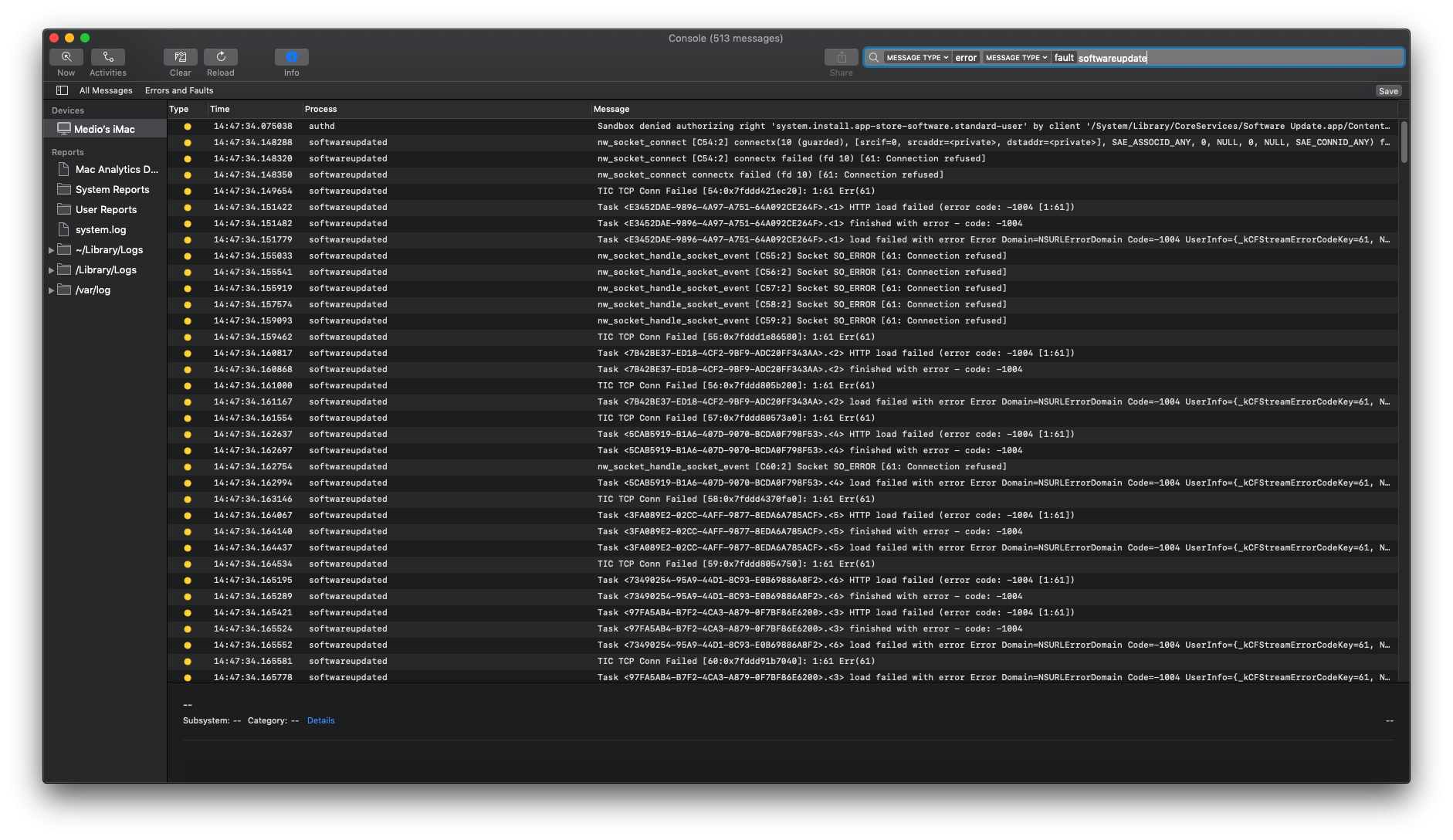

Some strange error for me when trying to update via software update... I thought at first it's because I having long old build (DP1) but after I download DP7 from MAS and (clean) reinstalling it, the problem still there, can't update via SU.
no ethernet error btw, because I can connect into my iTunes/iCloud account. And no problem at all on updating Mojave beta on my MBA & MBP...
561376846_ScreenShot2018-08-21at15_34_41.thumb.png.0e13bfe35a8c2565051f962a8f018aa3.png
log related to this...
UPDATE:  the update works after I plugged my ethernet cable, turning off my wifi. click update, progress bar shows but no sign of life. click update again and that error shows again. this time with wifi turning on and ethernet plugged, clicked again and works....
Edited by memedmedio
I had a similar issue, I reran the Beta Auth tool from page 1 and it updated just fine.
