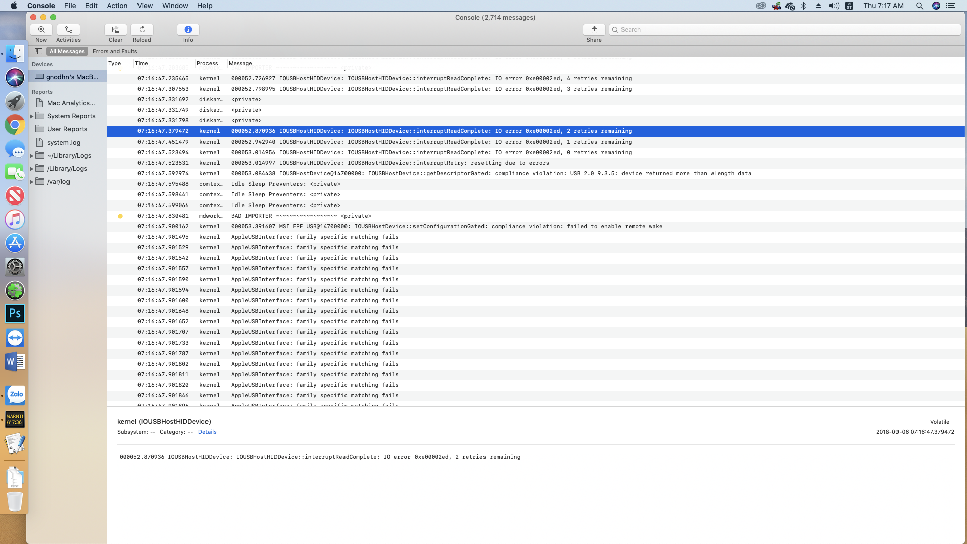

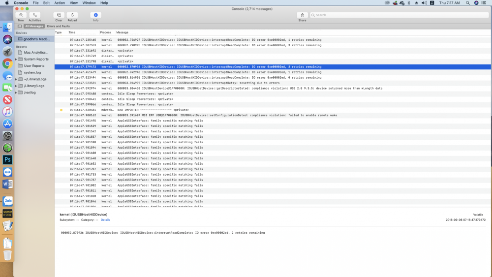

hi every one , when i boot i see IOUSBHostHIDDIVECE error and then i open console log app , i see so much error
how can i fix it ?  it's just happen on Mojave , everything work perfectly with High Sierra.
i include my CLOVER and Log error screenshot below
Please help me , thank all

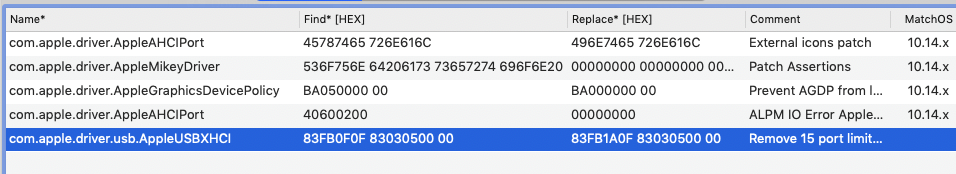

On 9/8/2018 at 4:26 AM, onemanOSX said:
I tried but it still not work :( it's ok on 10.14 beta 2 but when I update to beta 10 , it happened
on beta 10 I use
kext : com.apple.driver.usb.AppleUSBXHCI
FIND 83FB0F0F 83030500 00
REPLACE. : 83FB0F90 90909090 90
my USB port works but error on console log app.
On 8/21/2018 at 11:50 PM, al6042 said:
Name = com.apple.driver.usb.AppleUSBXHCI
Find [HEX] = 83FB0F0F 83030500 00
Replace [HEX] = 83FB1A0F 83030500 00
Comment = Remove 15 port limit completely 10.14 since DevBeta2
Use that one instead...
Edited by al6042
please see my boot log message
mo more error in console but still see when it boots

000137.387774 IOUSBHostHIDDevice: IOUSBHostHIDDevice::interruptRetry: resetting due to errors
000137.457310 IOUSBHostDevice@14700000: IOUSBHostDevice::getDescriptorGated: compliance violation: USB 2.0 9.3.5: device returned more than wLength data
IOConsoleUsers: time(0) 0->0, lin 1, llk 0,
IOConsoleUsers: gIOScreenLockState 1, hs 0, bs 0, now 0, sm 0x0
loginwindow is not entitled for IOHIDLibUserClient keyboard accessloginwindow is not entitled for IOHIDLibUserClient keyboard access000137.770386 MSI EPF USB@14700000: IOUSBHostDevice::setConfigurationGated: compliance violation: failed to enable remote wake
Report bytes: input:1 output:1 feature:257Collections : 3Buttons     : input:0 output:0 feature:0Values      : input:0 output:0 feature:2Element value capacity 6664Report count: 3Report ID: 0 input:0 output:0 feature:0Report ID: 1 input:8 output:8 feature:64Report ID: 2 input:8 output:8 feature:2056000137.795846 IOUSBHostHIDDevice: IOUSBHostHIDDevice::interruptReadComplete: IO error 0xe00002ed, 9 retries remaining
000137.867851 IOUSBHostHIDDevice: IOUSBHostHIDDevice::interruptReadComplete: IO error 0xe00002ed, 8 retries remaining
000137.939854 IOUSBHostHIDDevice: IOUSBHostHIDDevice::interruptReadComplete: IO error 0xe00002ed, 7 retries remaining
000138.011852 IOUSBHostHIDDevice: IOUSBHostHIDDevice::interruptReadComplete: IO error 0xe00002ed, 6 retries remaining
000138.083862 IOUSBHostHIDDevice: IOUSBHostHIDDevice::interruptReadComplete: IO error 0xe00002ed, 5 retries remaining
000138.155843 IOUSBHostHIDDevice: IOUSBHostHIDDevice::interruptReadComplete: IO error 0xe00002ed, 4 retries remaining
000138.227832 IOUSBHostHIDDevice: IOUSBHostHIDDevice::interruptReadComplete: IO error 0xe00002ed, 3 retries remaining
000138.299843 IOUSBHostHIDDevice: IOUSBHostHIDDevice::interruptReadComplete: IO error 0xe00002ed, 2 retries remaining
000138.371833 IOUSBHostHIDDevice: IOUSBHostHIDDevice::interruptReadComplete: IO error 0xe00002ed, 1 retries remaining
000138.443847 IOUSBHostHIDDevice: IOUSBHostHIDDevice::interruptReadComplete: IO error 0xe00002ed, 0 retries remaining
000138.443903 IOUSBHostHIDDevice: IOUSBHostHIDDevice::interruptRetry: resetting due to errors
000138.515407 IOUSBHostDevice@14700000: IOUSBHostDevice::getDescriptorGated: compliance violation: USB 2.0 9.3.5: device returned more than wLength data
000138.828139 MSI EPF USB@14700000: IOUSBHostDevice::setConfigurationGated: compliance violation: failed to enable remote wake
Report bytes: input:1 output:1 feature:257Collections : 3Buttons     : input:0 output:0 feature:0Values      : input:0 output:0 feature:2Element value capacity 6664Report count: 3Report ID: 0 input:0 output:0 feature:0Report ID: 1 input:8 output:8 feature:64Report ID: 2 input:8 output:8 feature:2056000138.851842 IOUSBHostHIDDevice: IOUSBHostHIDDevice::interruptReadComplete: IO error 0xe00002ed, 9 retries remaining
000138.923865 IOUSBHostHIDDevice: IOUSBHostHIDDevice::interruptReadComplete: IO error 0xe00002ed, 8 retries remaining
000138.995839 IOUSBHostHIDDevice: IOUSBHostHIDDevice::interruptReadComplete: IO error 0xe00002ed, 7 retries remaining
000139.067771 IOUSBHostHIDDevice: IOUSBHostHIDDevice::interruptReadComplete: IO error 0xe00002ed, 6 retries remaining
000139.139842 IOUSBHostHIDDevice: IOUSBHostHIDDevice::interruptReadComplete: IO error 0xe00002ed, 5 retries remaining
000139.211867 IOUSBHostHIDDevice: IOUSBHostHIDDevice::interruptReadComplete: IO error 0xe00002ed, 4 retries remaining
000139.283856 IOUSBHostHIDDevice: IOUSBHostHIDDevice::interruptReadComplete: IO error 0xe00002ed, 3 retries remaining
000139.355853 IOUSBHostHIDDevice: IOUSBHostHIDDevice::interruptReadComplete: IO error 0xe00002ed, 2 retries remaining
000139.427856 IOUSBHostHIDDevice: IOUSBHostHIDDevice::interruptReadComplete: IO error 0xe00002ed, 1 retries remaining
000139.499850 IOUSBHostHIDDevice: IOUSBHostHIDDevice::interruptReadComplete: IO error 0xe00002ed, 0 retries remaining
000139.499940 IOUSBHostHIDDevice: IOUSBHostHIDDevice::interruptRetry: resetting due to errors
000139.570908 IOUSBHostDevice@14700000: IOUSBHostDevice::getDescriptorGated: compliance violation: USB 2.0 9.3.5: device returned more than wLength data
Dongs-MacBook-Pro:~ gnodhn$
bootllog
5 minutes ago, Allan said:
Post your hardware specs.
So all the others users can have an idea to how give you the proper help. ;)
I'm using a MSI GP72M 7REX
CPU : i7 7700HQ
Audio : ALC899
GPU :  intel HD630
PORT :  2 USB 3.0 , 1 USB 2.0 , 1 USB Type C
CLOVER.zip

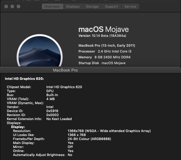

I was successfully able to install macOS Mojave (18A384a) on my Dell Inspiron 15 5567 (i3-7100U, IHD 620) on the first try. All the previous versions had issues during the second phase of installation, but this one went smoothly ie. it was able to convert an HFS+J partition to APFS and install itself in there. But the only problem I'm facing right now is the QE/CI problem.
Currently I'm using latest version of Lilu with WhateverGreen and using the following boot args:
dart=0 kext-dev-mode=1 -disablegfxfirmware -lilubeta -wegbeta -alcbeta -igfxvesa  -v slide=0
I'm using `-gfxvesa` because I'll get a kernel panic otherwise (no QE/CI).
