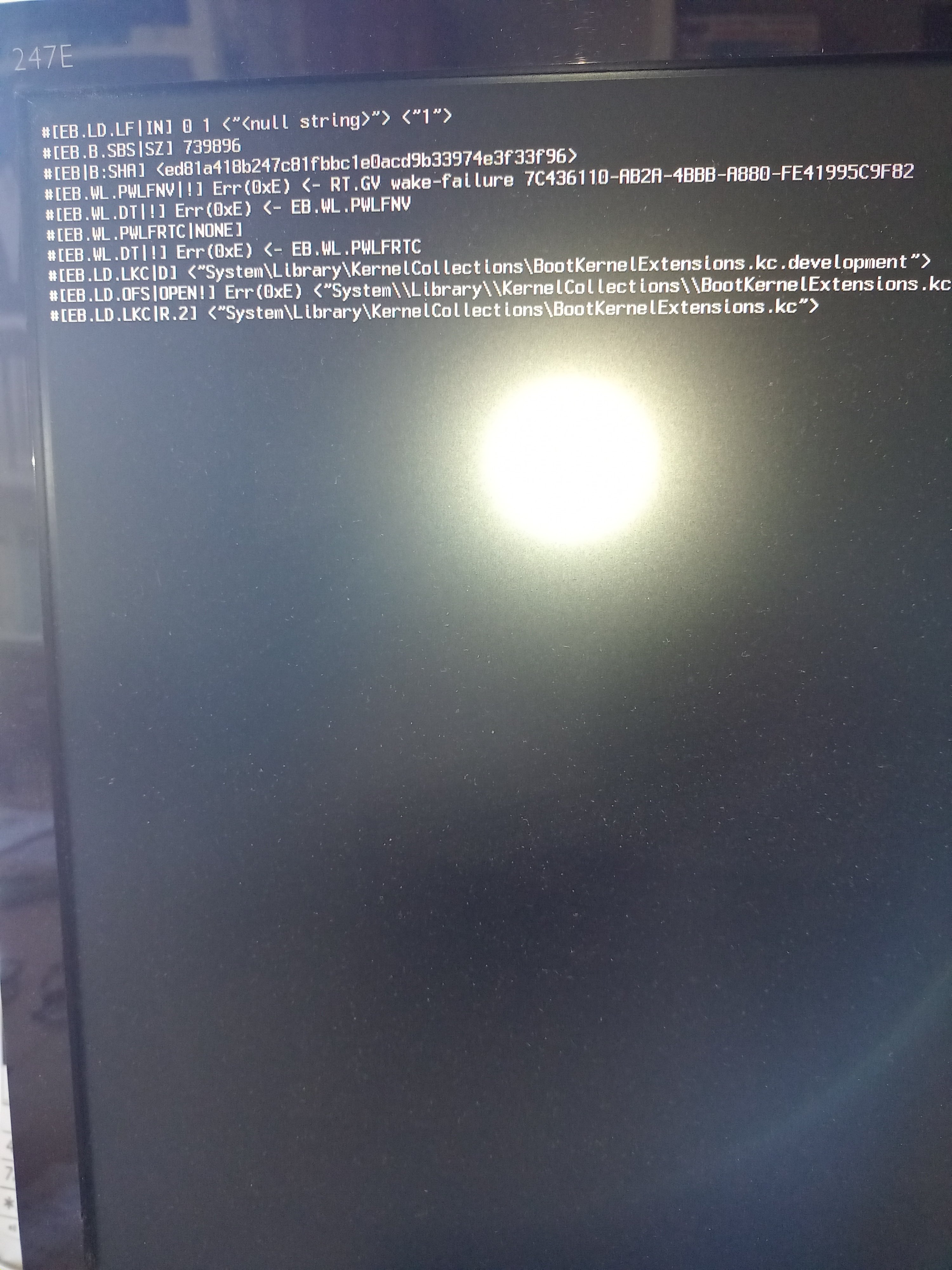

My question is different, i am asking if there are any developments for the people that NEED avoidruntimedefrag to boot big sur or more recent, and so can't really boot into venura (with an attempt at booting without that quirk enabled resulting into a system stuck during boot, for example shortly after `[pci configuration end]` or similar, like my x99 system does).
Edited by ITzTravelInTime
4 minutes ago, ITzTravelInTime said:
My question is different, i am asking if there are any developments for the people that NEED avoidruntimedefrag to boot big sur or more recent, and so can't really boot into venura (with an attempt at booting without that quirk resulting into a system stuck during boot, for example shortly after `[pci configuration end]` or similar, like my x99 system does).

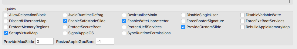

Guest 5T33Z0
@ITzTravelInTime EDIT: AvoidRuntimeDefrag quirk has been fixed
On most Intel CPU Generations, AvoidRuntimeDefrag is a necessity to boot the System.
What I know/observed so far:
  • 10th Gen and newer: don't require it to boot, therefore macOS 13 can be installed
  • 3rd Gen (Ivy Bridge): requires it, so no chance to install macOS 13 on it.
  • 4th (Haswell): ?
  • 5th Gen (Broadwell): ?
  • 6th Gen (Skylake): required.  Also requires Skylake Inector kext for the iGPU
  • 7th Gen (Kaby Lake): ?
  • 8th & 9th  Gen (Coffee Lake): I am seeing mixed results
Latest Lilu build works without -lilubetaall, btw: https://dortania.github.io/builds/?product=Lilu&viewall=true
In fact, you should update OpenCore and ALL your kexts to the latest avaialble builds (esp. Lilu, VirtualSMC and Whatevergreen) before attempting to install macOS Ventura. They all can be obtained from Dortania's build repo (select from them from the dropdown menu).
