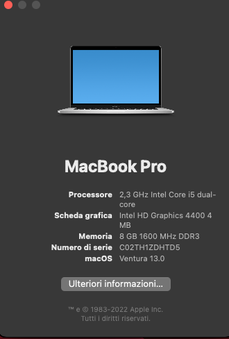

Ludox Posted June 8, 2022 Share Posted June 8, 2022 Test on Acer E1 in signature. OC installation 0.8.2 second OC restart 0.8.2 third reboot on Clover 5146 plus normal boot after installation. Issue encountered: Detects Intel HD 4400 4MB card without graphics accelerator, even using DSDT and SSDT tables The audio does not work The rest works "including touchpad" Tip to enable the video card? Using SMBIOS macbookpro 14.2 5 Link to comment https://www.insanelymac.com/forum/topic/351969-pre-release-macos-ventura/page/11/#findComment-2784251 Share on other sites More sharing options...

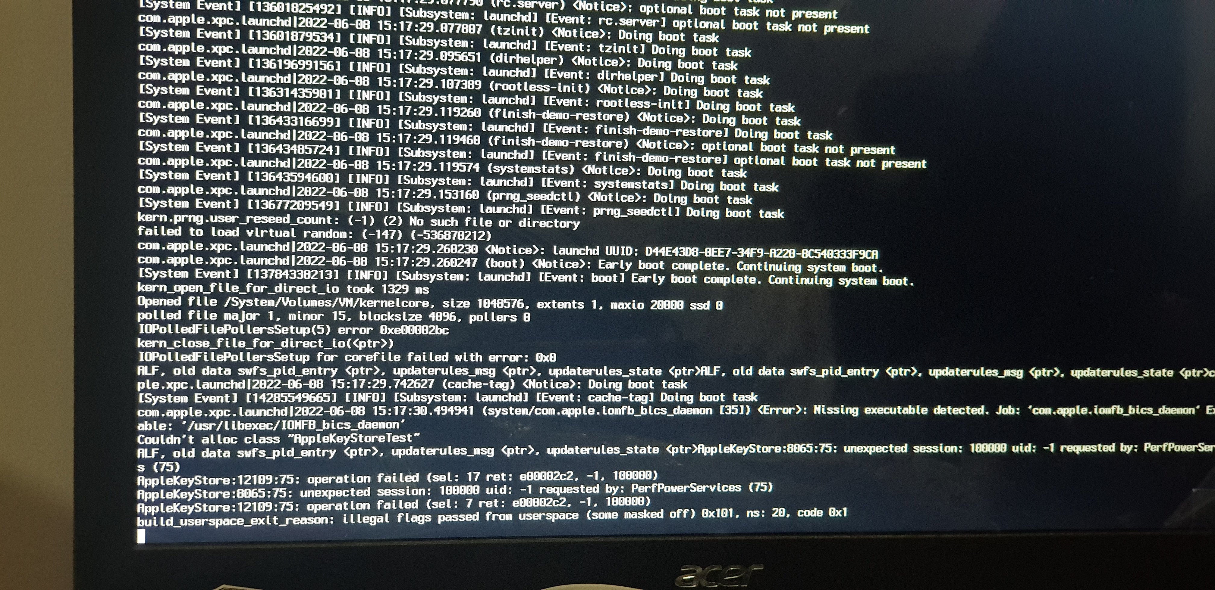

hohoho Posted June 8, 2022 Share Posted June 8, 2022 (edited) I am getting a kernel panic during first boot after the installation finishes. I can run the installer and finish installing but it doesn't boot afterwards. The boot stops and does a kernel panic right after: "build_userspace_exit_reason: illegal flags passed from userspace.." [Solved] - i solved this by installing ventura on my main drive. I was trying to install it first to a usb to try it out first but i was always getting this error when booting from a usb. Edited June 9, 2022 by hohoho Link to comment https://www.insanelymac.com/forum/topic/351969-pre-release-macos-ventura/page/11/#findComment-2784258 Share on other sites More sharing options...
jsl2000 Posted June 8, 2022 Share Posted June 8, 2022 (edited) 11 hours ago, Ludox said: Test on Acer E1 in signature. OC installation 0.8.2 second OC restart 0.8.2 third reboot on Clover 5146 plus normal boot after installation. Issue encountered: Detects Intel HD 4400 4MB card without graphics accelerator, even using DSDT and SSDT tables The audio does not work The rest works "including touchpad" Tip to enable the video card? Using SMBIOS macbookpro 14.2 I'm so lucky to boot successfully in my Z97 hackintoshs with Clover 5145. All are working except no hardware acceleration of HD 4600. Even WIFI (802.11ac) working too ! Config.plist for Clover 5145 was attached here. Even WiFi works perfectly ! config.plist Edited June 9, 2022 by jsl2000 3 1 Link to comment https://www.insanelymac.com/forum/topic/351969-pre-release-macos-ventura/page/11/#findComment-2784259 Share on other sites More sharing options...

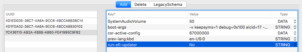

Middleman Posted June 9, 2022 Share Posted June 9, 2022 Alright so I managed to make some progress! I got into the installer with my H370 Acer Nitro 5! So what happened was, I was using a working OC 0.7.9 Monterey 12.4 build I had for the Acer and I had it updated to OC8.1 via OCAuxiliaryTools and just added -lilubetaall, MaxKernel of 22.99.99, AdviseFeatures ON, ProvideCurrentCPUInfo OFF and AvoidRunTimeDefrag to OFF. EnableSafeModeSlide, EnableWriteUnProtector and SetupVirtualMap is ON but RebuildAppleMemoryMap is OFF as is SyncRuntimePermissions. Key differences I noticed in the new one and my previous build (which was a manual alteration of my other Rocket Lake Ventura build to the Nitro 5 settings) was that PollAppleHotKeys was off but also LauncherOption was set to Short and all Debug options were turned off including DisableWatchdog. SecureBootModel setting was Default and SMBIOS was MacbookPro14,3. Aside from that, all of the VirtualSMC kexts were enabled as was CPUFriend & CPUFriendDataProvider, NVMEFix and NoTouchID. Also I did not use any AptioFix drivers either. EFI drivers enabled was only OpenHFS, OpenCanopy and OpenRuntime and everything else was disabled. Link to comment https://www.insanelymac.com/forum/topic/351969-pre-release-macos-ventura/page/11/#findComment-2784269 Share on other sites More sharing options...
Middleman Posted June 9, 2022 Share Posted June 9, 2022 1 hour ago, PropoFlexWX4 said: Hmmm. My CPU doesn't have integrated graphics. Tried using MacPro7,1 SMBIOS too which doesn't have iGPU... same result. Okay, do you have run-efi-updater set to No? Link to comment https://www.insanelymac.com/forum/topic/351969-pre-release-macos-ventura/page/11/#findComment-2784271 Share on other sites More sharing options...

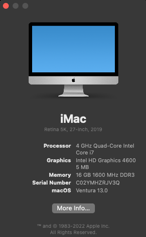

aben Posted June 9, 2022 Share Posted June 9, 2022 (edited) 6 hours ago, PC IT said: Hello dear, may i have your skylake config plist or your efi for test?, i tried your solution on my skylake hd520 laptop but seems i am missing something, the usb installer halt with graphics properties, i appreciate your help. Thanks Sure thing! Feel free to review the attached as a reference point for macOS Ventura tests ONLY, not recommended to use as-is (should your firmware require other patches that would otherwise be necessary to boot macOS). Good luck! OC.zip Edited June 9, 2022 by aben 1 Link to comment https://www.insanelymac.com/forum/topic/351969-pre-release-macos-ventura/page/11/#findComment-2784272 Share on other sites More sharing options...

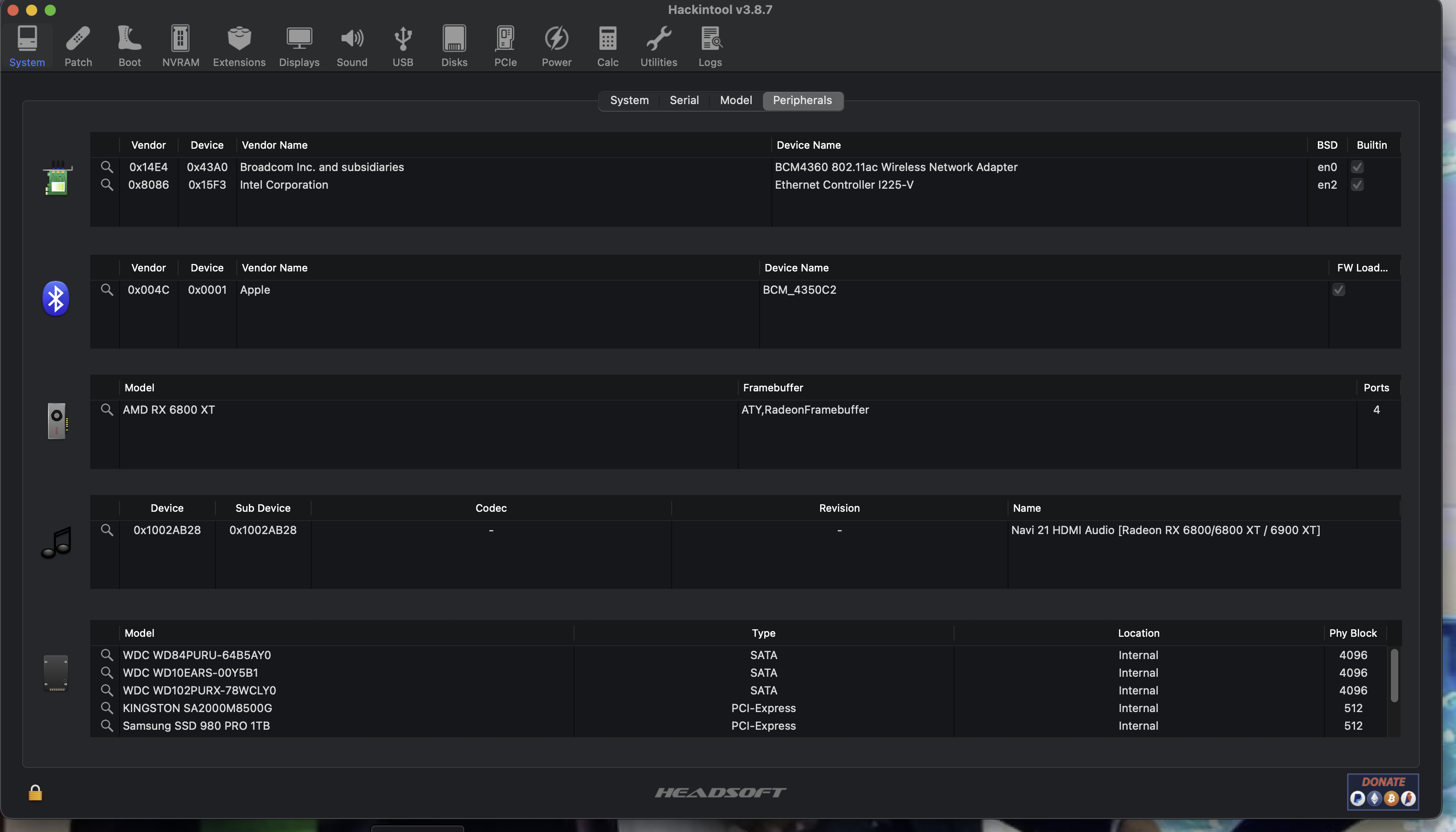

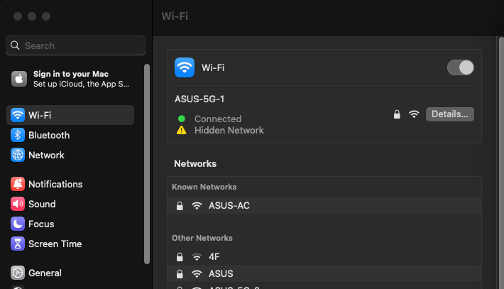

surenmunoo Posted June 9, 2022 Share Posted June 9, 2022 (edited) I managed to get it installed on my Z690 Aero D but my Fenvi 919 wifi and bluetooth does not work, anyone has any ideas how to fix it? It shows up in Hackintool but still not working Edited June 9, 2022 by surenmunoo 3 Link to comment https://www.insanelymac.com/forum/topic/351969-pre-release-macos-ventura/page/11/#findComment-2784287 Share on other sites More sharing options...
Middleman Posted June 9, 2022 Share Posted June 9, 2022 Just now, surenmunoo said: I managed to get it installed on my Z690 Aero D but my Fenvi 919 wifi and bluetooth does not work, anyone has any ideas how to fix it? It shows up in Hackintool but still not working Well I have a Z590I just installed with Ventura yesterday and I noticed that too - WiFi and Bluetooth wasn't working with my current setup which was actually working with Monterey 12.4. I am curious as to what is causing this, since they (the kexts) are pretty much all the same we have been using up until now (IntelBluetoothFirmware, BlueTool, & Airportitlwm). If you are using Broadcom BT you might want to check out also installing BrcmBluetoothInjector, BrcmFirmwareData & BRCMPatchRAM3.kext if that helps. 1 Link to comment https://www.insanelymac.com/forum/topic/351969-pre-release-macos-ventura/page/11/#findComment-2784288 Share on other sites More sharing options...
surenmunoo Posted June 9, 2022 Share Posted June 9, 2022 5 minutes ago, Middleman said: Well I have a Z590I just installed with Ventura yesterday and I noticed that too - WiFi and Bluetooth wasn't working with my current setup which was actually working with Monterey 12.4. I am curious as to what is causing this, since they (the kexts) are pretty much all the same we have been using up until now (IntelBluetoothFirmware, BlueTool, & Airportitlwm). If you are using Broadcom BT you might want to check out also installing BrcmBluetoothInjector, BrcmFirmwareData & BRCMPatchRAM3.kext if that helps. Thanks @Middleman , below is the kexts I have installed. It seems I don't have the brcmbluetoothinjector.kext - where can I find that? 1 Link to comment https://www.insanelymac.com/forum/topic/351969-pre-release-macos-ventura/page/11/#findComment-2784289 Share on other sites More sharing options...
Moviemakergr Posted June 9, 2022 Share Posted June 9, 2022 15 minutes ago, surenmunoo said: I managed to get it installed on my Z690 Aero D but my Fenvi 919 wifi and bluetooth does not work, anyone has any ideas how to fix it? It shows up in Hackintool but still not working Hello mate.. Chrome working on you ? when opened freezes everything.. Can u please upload your efi for comparing ? I m on Z690 Gaming X DDR 4 Link to comment https://www.insanelymac.com/forum/topic/351969-pre-release-macos-ventura/page/11/#findComment-2784291 Share on other sites More sharing options...

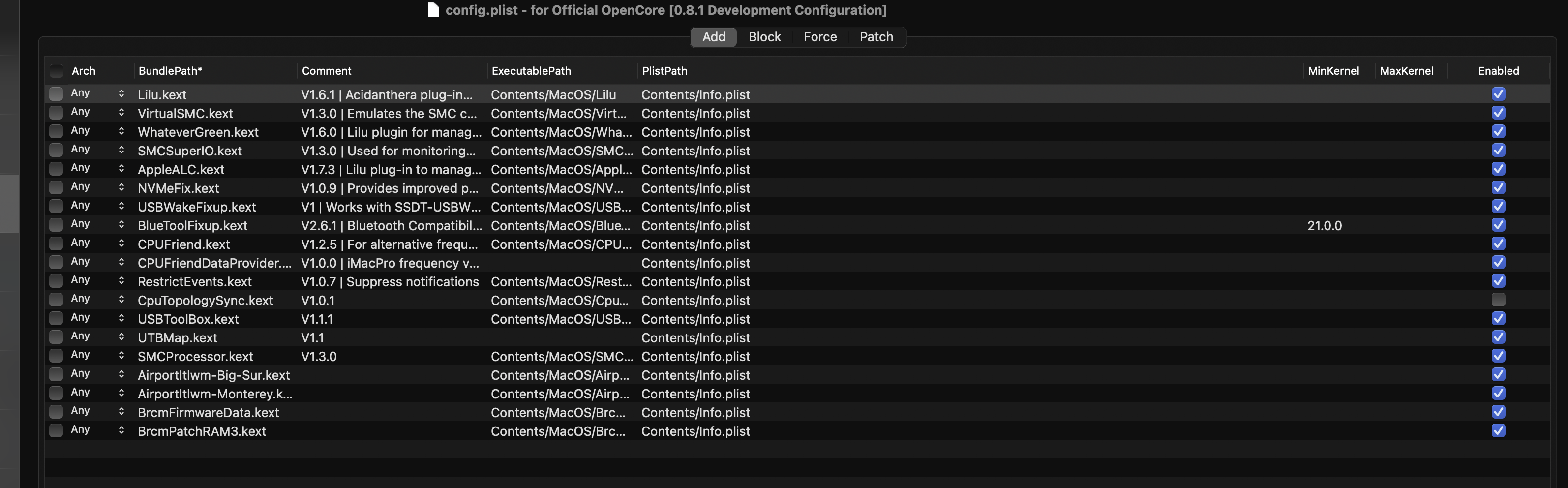

Middleman Posted June 9, 2022 Share Posted June 9, 2022 2 minutes ago, surenmunoo said: Thanks @Middleman , below is the kexts I have installed. It seems I don't have the brcmbluetoothinjector.kext - where can I find that? Right. Well it's found under the Opencore BRCMPatchRAM release here by Acidanthera > https://github.com/acidanthera/BrcmPatchRAM As for the WiFi configuration, it looks like you've got two of the Airportitlwm kexts enabled? You should only enable just one. Use the Monterey one. You're welcome! Link to comment https://www.insanelymac.com/forum/topic/351969-pre-release-macos-ventura/page/11/#findComment-2784292 Share on other sites More sharing options...
Cyberdevs Posted June 9, 2022 Share Posted June 9, 2022 @surenmunoo I have the same fenvi (T919) card and you don't need anything other than disabling the built-in WiFi and BlueTooth by removing the corresponding ports in the mapped USB kext or SSDT. @Middleman The T919 fenvi card doesn't require any extra kexts other than FixBlueTool.kext and exclusion of Intel BT/WiFi. 1 Link to comment https://www.insanelymac.com/forum/topic/351969-pre-release-macos-ventura/page/11/#findComment-2784293 Share on other sites More sharing options...
surenmunoo Posted June 9, 2022 Share Posted June 9, 2022 2 minutes ago, Moviemakergr said: Hello mate.. Chrome working on you ? when opened freezes everything.. Can u please upload your efi for comparing ? I m on Z690 Gaming X DDR 4 Chrome works for me, I had to remove the kexts folders as it was too big to upload EFI 2.zip 3 minutes ago, Middleman said: Right. Well it's found under the Opencore BRCMPatchRAM release here by Acidanthera > https://github.com/acidanthera/BrcmPatchRAM As for the WiFi configuration, it looks like you've got two of the Airportitlwm kexts enabled? You should only enable just one. Use the Monterey one. You're welcome! Thanks Mate, I will give that a try and let you know 2 minutes ago, Cyberdevs said: @surenmunoo I have the same fenvi (T919) card and you don't need anything other than disabling the built-in WiFi and BlueTooth by removing the corresponding ports in the mapped USB kext or SSDT. @Middleman The T919 fenvi card doesn't require any extra kexts other than FixBlueTool.kext and exclusion of Intel BT/WiFi. How do I remove that from SSDT? I am using the EFI you posted, is it removed from there? 4 minutes ago, Cyberdevs said: @surenmunoo I have the same fenvi (T919) card and you don't need anything other than disabling the built-in WiFi and BlueTooth by removing the corresponding ports in the mapped USB kext or SSDT. @Middleman The T919 fenvi card doesn't require any extra kexts other than FixBlueTool.kext and exclusion of Intel BT/WiFi. This Is the SSDT I made trying to map the USB ports using Hackintool SSDT-UIAC.aml 2 Link to comment https://www.insanelymac.com/forum/topic/351969-pre-release-macos-ventura/page/11/#findComment-2784294 Share on other sites More sharing options...
Cyberdevs Posted June 9, 2022 Share Posted June 9, 2022 4 minutes ago, surenmunoo said: How do I remove that from SSDT? I am using the EFI you posted, is it removed from there? You need to remap your USB ports or you need to check IOreg and see the built-in BT/WiFii is connected to which USB port on your rig. 2 Link to comment https://www.insanelymac.com/forum/topic/351969-pre-release-macos-ventura/page/11/#findComment-2784296 Share on other sites More sharing options...
surenmunoo Posted June 9, 2022 Share Posted June 9, 2022 1 minute ago, Cyberdevs said: You need to remap your USB ports or you need to check IOreg and see the built-in BT/WiFii is connected to which USB port on your rig. Will do, Thanks 1 Link to comment https://www.insanelymac.com/forum/topic/351969-pre-release-macos-ventura/page/11/#findComment-2784298 Share on other sites More sharing options...
Cyberdevs Posted June 9, 2022 Share Posted June 9, 2022 13 minutes ago, surenmunoo said: This Is the SSDT I made trying to map the USB ports using Hackintool Without the IOreg i can't tell that the built-in Bt/WiFi is connected to which port. Link to comment https://www.insanelymac.com/forum/topic/351969-pre-release-macos-ventura/page/11/#findComment-2784299 Share on other sites More sharing options...
