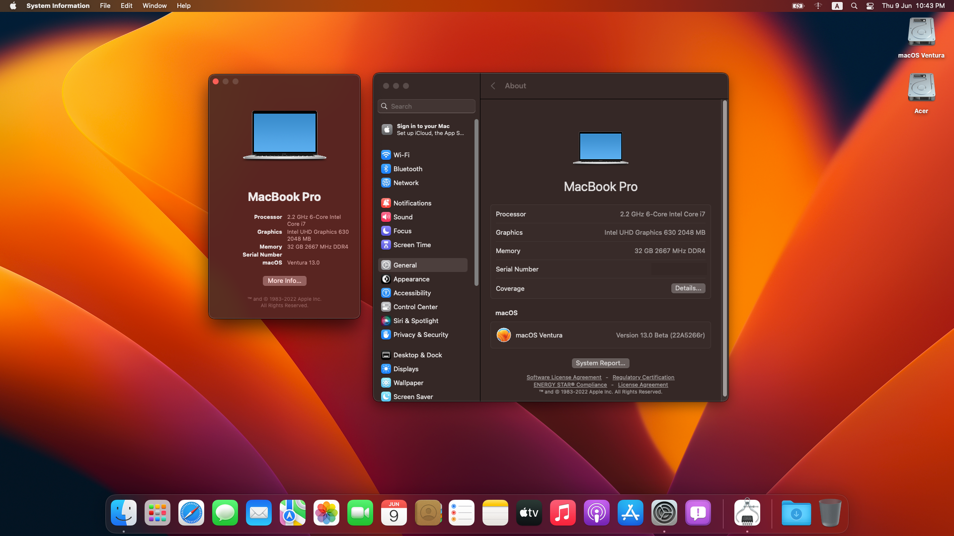

Middleman Posted June 9, 2022 Share Posted June 9, 2022 56 minutes ago, PropoFlexWX4 said: So, how is Ventura on intel H310/H370/B360/B365/Z370/Z390 going? Any successes yet? @PropoFlexWX4 Yes there is! Can confirm it also works on H370 (Acer Nitro 5)! Link to comment https://www.insanelymac.com/forum/topic/351969-pre-release-macos-ventura/page/13/#findComment-2784354 Share on other sites More sharing options...

Middleman Posted June 9, 2022 Share Posted June 9, 2022 16 hours ago, Middleman said: Alright so I managed to make some progress! I got into the installer with my H370 Acer Nitro 5! So what happened was, I was using a working OC 0.7.9 Monterey 12.4 build I had for the Acer and I had it updated to OC8.1 via OCAuxiliaryTools and just added -lilubetaall, MaxKernel of 22.99.99, AdviseFeatures ON, ProvideCurrentCPUInfo OFF and AvoidRunTimeDefrag to OFF. EnableSafeModeSlide, EnableWriteUnProtector and SetupVirtualMap is ON but RebuildAppleMemoryMap is OFF as is SyncRuntimePermissions. Key differences I noticed in the new one and my previous build (which was a manual alteration of my other Rocket Lake Ventura build to the Nitro 5 settings) was that PollAppleHotKeys was off but also LauncherOption was set to Short and all Debug options were turned off including DisableWatchdog. SecureBootModel setting was Default and SMBIOS was MacbookPro14,3. Aside from that, all of the VirtualSMC kexts were enabled as was CPUFriend & CPUFriendDataProvider, NVMEFix and NoTouchID. Also I did not use any AptioFix drivers either. EFI drivers enabled was only OpenHFS, OpenCanopy and OpenRuntime and everything else was disabled. Thought to leave this here for anyone interested. So guys I have to go, but if any of you are having issues with booting Z370 Coffee Lake or similar try my above settings using OC 0.8.1. It should work for you. If you're using a desktop try to choose the closest SMBIOS value with the same model and gen chip. Link to comment https://www.insanelymac.com/forum/topic/351969-pre-release-macos-ventura/page/13/#findComment-2784380 Share on other sites More sharing options...
