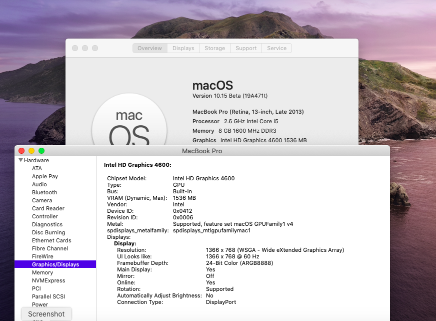

Everything good here with HP Probook 650 G1, except bluetooth 2070?   Using fakepciidkexts with BRCM94352HMB bluetooth works in Mojave.   Any fixes or patches for bluetooth?
See here
https://www.insanelymac.com/forum/topic/339035-pre-release-macos-catalina/?do=findComment&comment=2676637

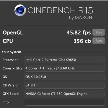

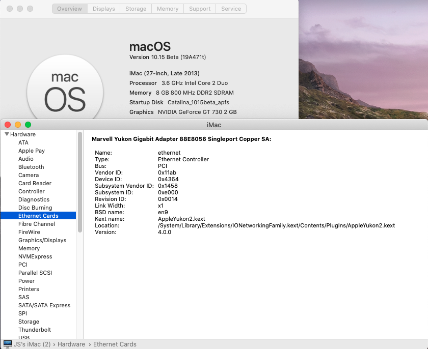

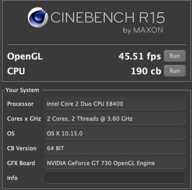

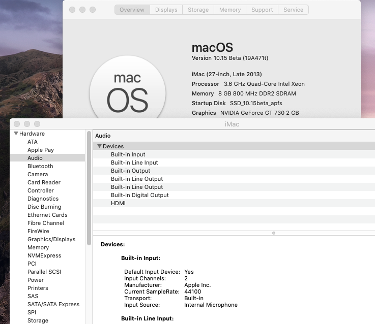

Even LGA 775/Duo Core 2 hackintoshs worked.
Previous mojave2core still needed to boot.
Roll-back AppleHDA to get HDMI audio from GT 730 working.
Need add AppleYukon2.kext from Mojave to get network working again.›
Before login to desktop there are 3 busy timeout or kextd stall, (60s) "IOUSBHostInterface" errors which caused very slow login and failure of my USB keyboard.
I must use PS2 keyboard now.

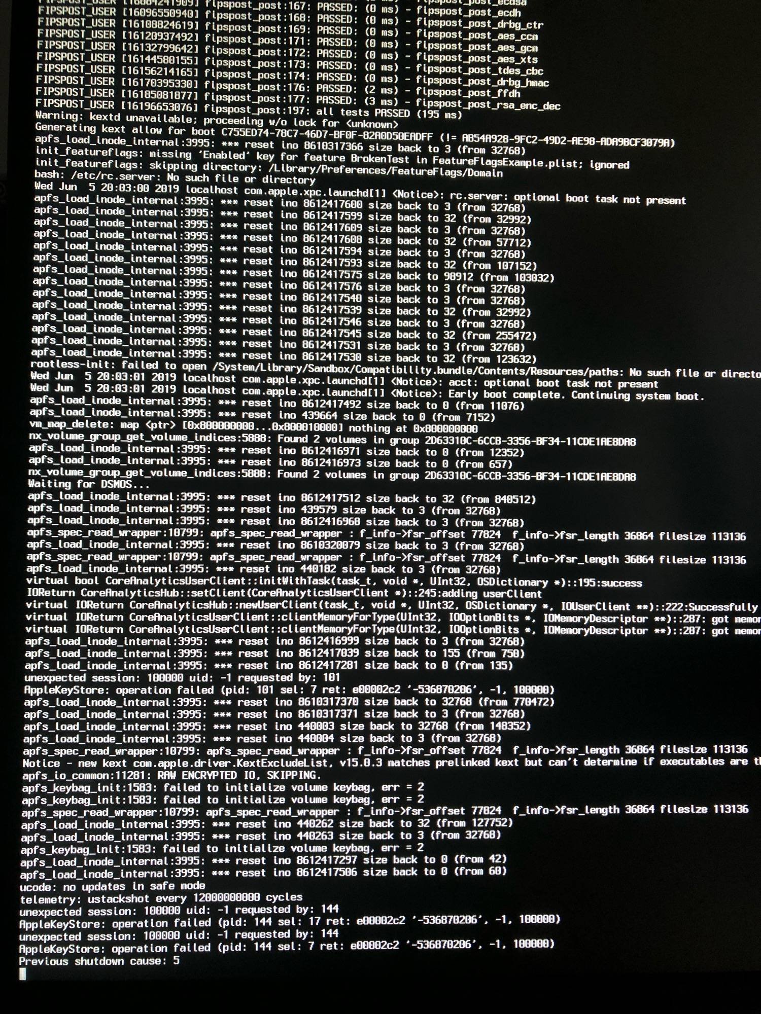

So I'm having trouble getting Catalina to boot after going through the installer.
CPU: i5-7600k
GPU: ASUS Strix Vega 64
Audio: Usually use AMD audio over DisplayPort / Machine also has Realtek audio so I use AppleALC.kext
NIC: Intel X520-DA1 flashed to SmallTree device ID, used SmallTree drivers in Mojave (renamed .kext to .kextold to see if this was causing the KP).  Motherboard also has Intel I219 Gigabit NIC.
I Updated to the latest clover, switched to VirtualSMC from FakeSMC (not sure if that helps), copied apfs.efi from the installer image, and used -lilubetaall.
Now after a reboot I’m randomly stalling like in the attached image.  I'm seeing a lot of apfs messages (although this screenshot was taken in safe mode I believe).  Could the filesystem possibly be corrupt?  It seems to stall at slightly different times every boot.
EDIT: Almost forgot, attached config.plist.
EDIT 2: Fixed It!  Turns out VirtualSMC was the culprit.  Disabled injecting all kexts and the installation completed, then I got rid of VirtualSMC and put back FakeSMC and everything boots fine.  10G card still works in Catalina as well :)
config.plist
Edited by DsurioN
resolved
