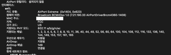

Neo.aka.Darkman Posted June 5, 2019 Share Posted June 5, 2019 1 hour ago, Sherlocks said: did you use dsdt or fakeid? i will research binary patch for airport until airportbcrmfixup resolved 나의 SM-N960N 의 Tapatalk에서 보냄 yep, it was fakeid in clover, after commenting it, it's now working with FakePCIID 1 Link to comment https://www.insanelymac.com/forum/topic/339035-pre-release-macos-catalina/page/9/#findComment-2676478 Share on other sites More sharing options...
Sherlocks Posted June 5, 2019 Share Posted June 5, 2019 yep, it was fakeid in clover, after commenting it, it's now working with FakePCIIDwhat is your fakeid? 나의 SM-N960N 의 Tapatalk에서 보냄 Link to comment https://www.insanelymac.com/forum/topic/339035-pre-release-macos-catalina/page/9/#findComment-2676481 Share on other sites More sharing options...

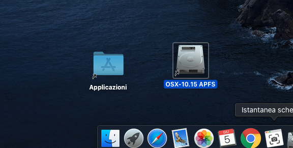

pinarek Posted June 5, 2019 Share Posted June 5, 2019 Hello all my Friends.. i have a Problem with Catalina 10.15 beta1 I can not move the icons on my desk, the green cross message comes up, which displays the symbols of other Paritions-symbols, e.g. "copied". I do not want to copy anything, just change the order, e.g. move from the right edge to the left edge of the desk. Link to comment https://www.insanelymac.com/forum/topic/339035-pre-release-macos-catalina/page/9/#findComment-2676484 Share on other sites More sharing options...
Neo.aka.Darkman Posted June 5, 2019 Share Posted June 5, 2019 1 hour ago, Sherlocks said: what is your fakeid? 나의 SM-N960N 의 Tapatalk에서 보냄 fakeid was 0x43a014e4, real id is [14e4:43b1] 1 Link to comment https://www.insanelymac.com/forum/topic/339035-pre-release-macos-catalina/page/9/#findComment-2676493 Share on other sites More sharing options...
Eniac Posted June 5, 2019 Share Posted June 5, 2019 I have the same problem and can't even create "aliases", but I solved it momentarily using Simbolik Links... 1 Link to comment https://www.insanelymac.com/forum/topic/339035-pre-release-macos-catalina/page/9/#findComment-2676499 Share on other sites More sharing options...
pinarek Posted June 5, 2019 Share Posted June 5, 2019 Thanks my friend @Herve ... I thought I had something wrong with the security or access settings. But something like that, in my opinion, should not happen in a beta 1. Says times do not test the bums of Apple before? Pulling off a big show and seeing no such flawed mistakes should not happen, even if it's Devloper Beta. Link to comment https://www.insanelymac.com/forum/topic/339035-pre-release-macos-catalina/page/9/#findComment-2676508 Share on other sites More sharing options...

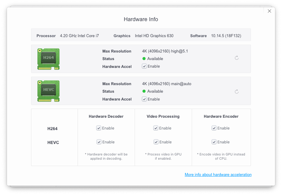

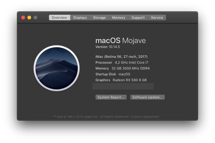

Roboter Posted June 5, 2019 Share Posted June 5, 2019 Hi folks, I'm new to this forums just to participate in this discussion. Today I managed to get headless iGPU with my RX580. I also added my basic hardware specs as a screenshot from Mohave. I followed this thread and managed to install (and run) Catalina on my CustoMac to/from an extra partition. However I did that before I was trying to get headless iGPU up and running. To do that I need to activate `iGPU multiple monitor` support in the BIOS (ASUS Maximus IX Hero). Unfortunately I get a kernel panic when I try to boot into Cataline with that BIOS setting enabled, if it's disabled it boots just fine. Does anyone has a suggestion where I can start further investigation. I also need a helping hand to extract the Kernel Panic logs from Catalina as a video recording from the iPad is not fully readable. The reason why I started this in first place was to try if this was the root case why `Sidecar` (using the iPad as an external screen always failed. I observed system logs from macOS and the iPad and there are things like weird frame buffer errors or other things. I'm not sure if this even related to my CustoMac setup or just bugs of the beta OS's.) Thank you folks in advance. Link to comment https://www.insanelymac.com/forum/topic/339035-pre-release-macos-catalina/page/9/#findComment-2676509 Share on other sites More sharing options...
Sherlocks Posted June 5, 2019 Share Posted June 5, 2019 (edited) 1 hour ago, Neo.aka.Darkman said: fakeid was 0x43a014e4, real id is [14e4:43b1] AirPortBrcmNIC.kext caused kernel panic for my laptop. therefore i determined to use deviceid(pci14e4,4331) of AirPortBrcm4360.kext. then no more kernel panic with airportbcrmfixup.kext but it's not still work. so until it is fix, we need to whitelist board-patch for airport extreme. here is patch. thanks rehabman. com.apple.driver.AirPort.Brcm4360 483B45E0 7514 FFC39090 9090 AirPortBrcm4360 whitelist patch (board-id), 10.14/10.15, credit RehabMan Edited June 5, 2019 by Sherlocks 3 Link to comment https://www.insanelymac.com/forum/topic/339035-pre-release-macos-catalina/page/9/#findComment-2676512 Share on other sites More sharing options...

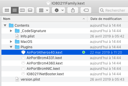

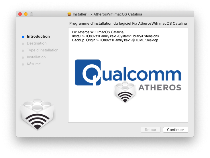

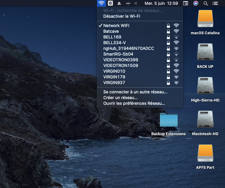

chris1111 Posted June 5, 2019 Share Posted June 5, 2019 (edited) Here my Fix for Atheros WIFI on Catalina The both Kext is from my Mojave and my High Sierra AiportAther40 inside plugin of IO80211Family.kext Testing with an Atheros AR5B93 See Spoiler ⬇︎ Spoiler here the kext contents Here package installation Fix AtherosWifi macOS Catalina.zip Edited June 13, 2019 by chris1111 Not a meta package 2 1 Link to comment https://www.insanelymac.com/forum/topic/339035-pre-release-macos-catalina/page/9/#findComment-2676522 Share on other sites More sharing options...
