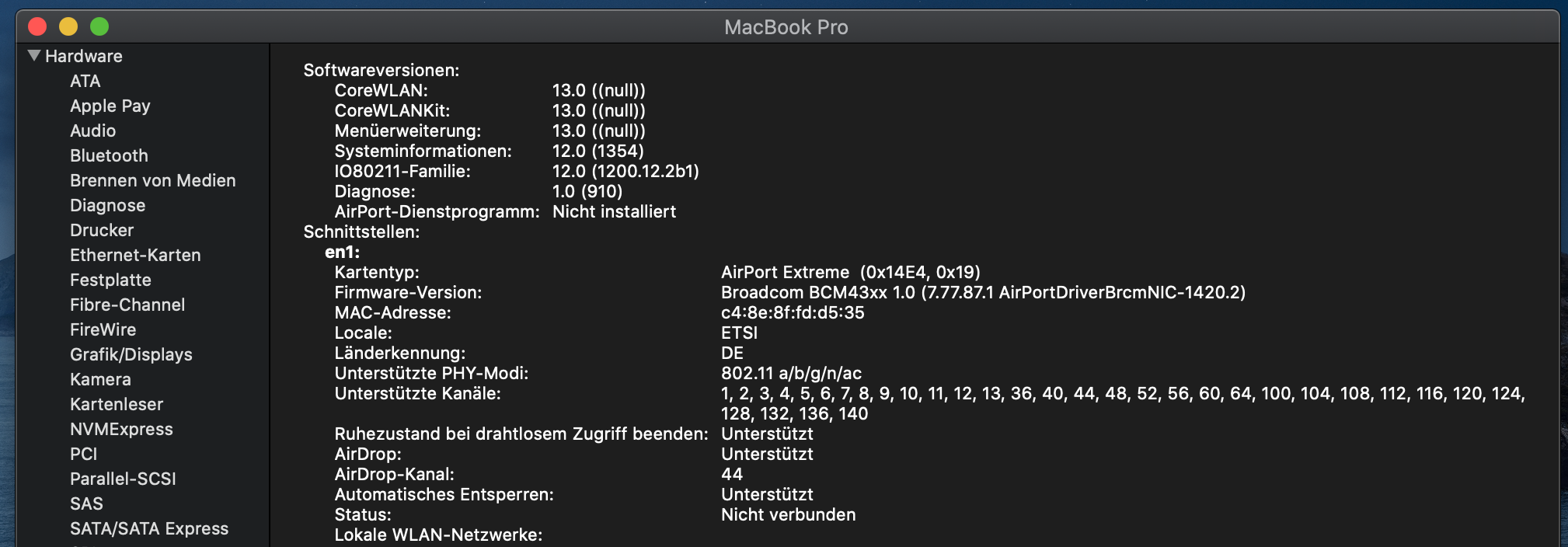

2.0.2 (DEBUG).zip
 DW-1560 works great with this version. Thank you @lvs1974
2.0.2 (RELEASE).zip
Edited by anonymous writer

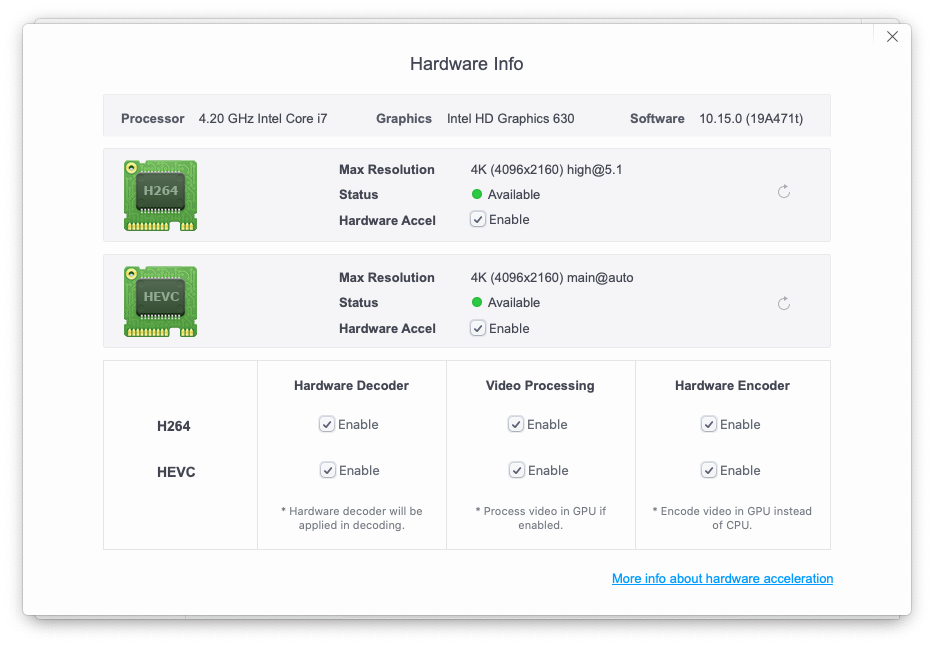

6 hours ago, mnfesq said:
Whatevergreen has been updated to 1.3.0 and it avoids the problem you have (at least it did for me.). It has been posted several times already above (alone and as a part of the Lilu Plugins.)
I can confirm that it now no longer panics. I can enable `iGPU Multiple Monitor` in my bios and boot into macOS Catalina without issues.
So for anyone of you who want SIDECAR to work on a CustoMac with a dGPU, your iGPU has to work headless to be able to provide decoding functionality or otherwise Sidecar will error out.
I compiled latest Lilu, WhateverGreen, AppleALC and VirtualSMC in Mojave and they work great so far.
Image below is taken from the app called `VideoProc` (free trial is enough; Settings - Common - Hardware Acceleration Engine - Options - Press refresh buttons if needed)
