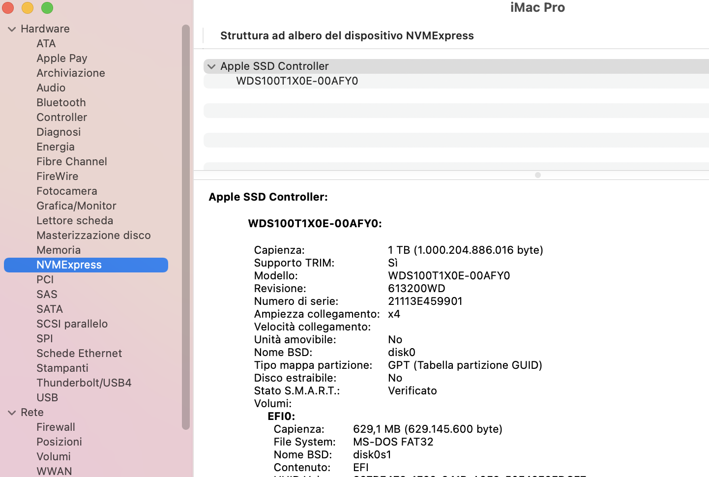

iCanaro Posted July 22, 2021 Share Posted July 22, 2021 On 7/14/2021 at 10:19 PM, Stefanalmare said: Try this. Put your IOPCIPrimaryMatch. X299NVMe.kext.zip 3.96 kB · 4 downloads https://www.hackintosh-forum.de/forum/thread/54361-nvmexpress-apple-ssd-controller/?postID=708932 thanks for the work and the idea; I added vendor and device ID of my WD SN850 1 Link to comment https://www.insanelymac.com/forum/topic/348725-pre-release-macos-monterey/page/36/#findComment-2763376 Share on other sites More sharing options...

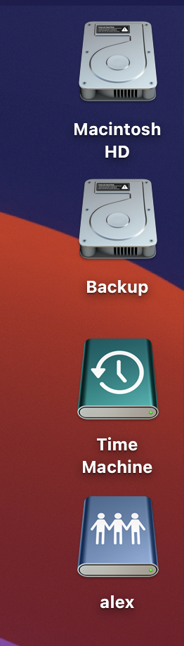

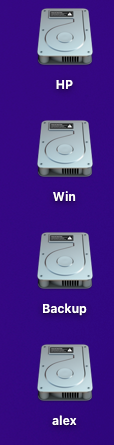

Stefanalmare Posted July 25, 2021 Share Posted July 25, 2021 Monterey see network drive as internal. It is a beta issue (no specific icon yet), or it is just me? It happen in 5 hacks. Link to comment https://www.insanelymac.com/forum/topic/348725-pre-release-macos-monterey/page/36/#findComment-2763556 Share on other sites More sharing options...
Slice Posted July 25, 2021 Share Posted July 25, 2021 37 minutes ago, Stefanalmare said: Monterey see network drive as internal. It is a beta issue (no specific icon yet), or it is just me? It happen in 5 hacks. It is not pluggable so it is internal. As far as I remember. 1 Link to comment https://www.insanelymac.com/forum/topic/348725-pre-release-macos-monterey/page/36/#findComment-2763560 Share on other sites More sharing options...
Stefanalmare Posted July 25, 2021 Share Posted July 25, 2021 (edited) 2 hours ago, Slice said: It is not pluggable so it is internal. As far as I remember. "Alex" it is network drive. Look BigSur vs Monterey. Spoiler Spoiler Edited July 25, 2021 by Stefanalmare Link to comment https://www.insanelymac.com/forum/topic/348725-pre-release-macos-monterey/page/36/#findComment-2763573 Share on other sites More sharing options...

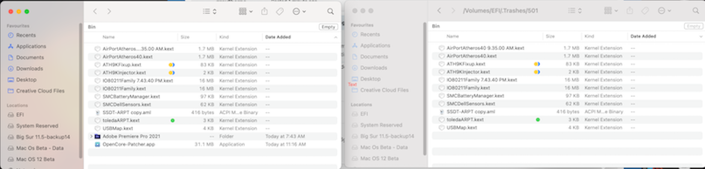

greythorne Posted July 25, 2021 Share Posted July 25, 2021 Ok this is strange. My EFI partition still has about 100++ mb of drive space available. In it I have windows/OC boot folder which in total is about 50 or so mb. Now I updated the kext and got a prompt that says insufficient drive space. Any idea why? I am on Monterey Beta 3 & Win 11. Link to comment https://www.insanelymac.com/forum/topic/348725-pre-release-macos-monterey/page/36/#findComment-2763576 Share on other sites More sharing options...
ndungu6678 Posted July 25, 2021 Share Posted July 25, 2021 4 minutes ago, greythorne said: Ok this is strange. My EFI partition still has about 100++ mb of drive space available. In it I have windows/OC boot folder which in total is about 50 or so mb. Now I updated the kext and got a prompt that says insufficient drive space. Any idea why? I am on Monterey Beta 3 & Win 11. Hi- is your trash folder empty?-used to get same message when trying to replace old EFI folder with new updated one- emptying trash used to help sometimes! Link to comment https://www.insanelymac.com/forum/topic/348725-pre-release-macos-monterey/page/36/#findComment-2763578 Share on other sites More sharing options...
greythorne Posted July 25, 2021 Share Posted July 25, 2021 3 minutes ago, ndungu6678 said: Hi- is your trash folder empty?-used to get same message when trying to replace old EFI folder with new updated one- emptying trash used to help sometimes! Hmmm. I turned on the hidden files and folder. The Trash folder in EFI partition was hidden. There was no files in it, the folder was empty. Link to comment https://www.insanelymac.com/forum/topic/348725-pre-release-macos-monterey/page/36/#findComment-2763579 Share on other sites More sharing options...
ndungu6678 Posted July 25, 2021 Share Posted July 25, 2021 (edited) 29 minutes ago, greythorne said: Hmmm. I turned on the hidden files and folder. The Trash folder in EFI partition was hidden. There was no files in it, the folder was empty. What about trash folder in dock on desktop?-Look at mine below-On the left shows contents of trash folder on dock and on right contents of trash folder in EFI -could be some other files still in trash (or BIN) in dock! -if that does not work -no idea! Edited July 25, 2021 by ndungu6678 Link to comment https://www.insanelymac.com/forum/topic/348725-pre-release-macos-monterey/page/36/#findComment-2763580 Share on other sites More sharing options...
kushwavez Posted July 25, 2021 Share Posted July 25, 2021 (edited) 7 hours ago, greythorne said: Ok this is strange. My EFI partition still has about 100++ mb of drive space available. In it I have windows/OC boot folder which in total is about 50 or so mb. Now I updated the kext and got a prompt that says insufficient drive space. Any idea why? I am on Monterey Beta 3 & Win 11. I did have the exact same issue, but for me it's started on Big Sur. Looks like the system can't really handle well the EFI partition, or it is the Finder. I'd use Commander One or even just the terminal for handling EFI. I'd also run an fsck on it, every time I got an msg says that the filesystem is corrupted, that released the space too. I'm not on Mac rn and I don't really remember the exact command, it's like fsck fat32 /dev/diskXsX or simply fsck /dev/diskXsX try & luck Last resort is reformatting the EFI. For dual-boot you can look at my writeup about recreating EFI and stuff, maybe that'll help you. It's not that hard Edited July 25, 2021 by kushwavez Link to comment https://www.insanelymac.com/forum/topic/348725-pre-release-macos-monterey/page/36/#findComment-2763602 Share on other sites More sharing options...
silencer51 Posted July 25, 2021 Share Posted July 25, 2021 The EFI partition is fat32 and really easy to corrupt, just mount it in Windows and run chkdsk /f on it. This also fixes mysterious slowdowns/load times for opencore. 1 Link to comment https://www.insanelymac.com/forum/topic/348725-pre-release-macos-monterey/page/36/#findComment-2763606 Share on other sites More sharing options...
Slice Posted July 26, 2021 Share Posted July 26, 2021 7 hours ago, kushwavez said: I did have the exact same issue, but for me it's started on Big Sur. Looks like the system can't really handle well the EFI partition, or it is the Finder. I'd use Commander One or even just the terminal for handling EFI. I'd also run an fsck on it, every time I got an msg says that the filesystem is corrupted, that released the space too. I'm not on Mac rn and I don't really remember the exact command, it's like fsck fat32 /dev/diskXsX or simply fsck /dev/diskXsX try & luck Last resort is reformatting the EFI. For dual-boot you can look at my writeup about recreating EFI and stuff, maybe that'll help you. It's not that hard I have some experience with it. For my observation FAT32 driver included in UEFI BIOS is often buggy so saving boot.log or screenshot may corrupt the file system. So why I highly recommend to Clover's users to install Fat.efi driver. It looks like does nothing but it prevents the EFI file system corruption. 2 3 Link to comment https://www.insanelymac.com/forum/topic/348725-pre-release-macos-monterey/page/36/#findComment-2763622 Share on other sites More sharing options...

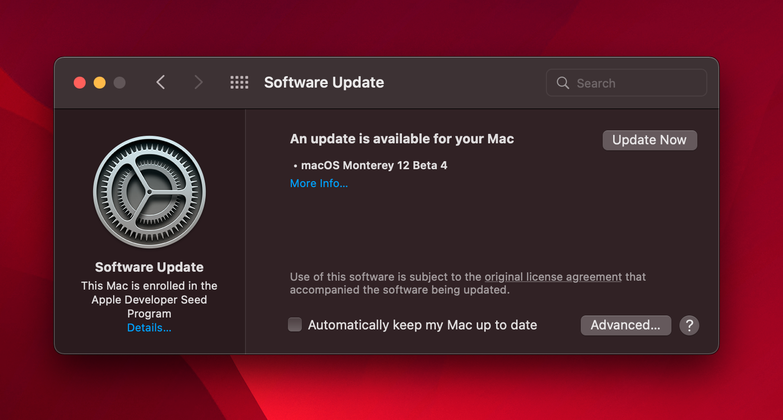

Djlild7hina Posted July 27, 2021 Share Posted July 27, 2021 (edited) Easy update not sure if Universal Control works yet or not tho. EDIT: Guess apple pulled the mention of Universal Control being live lol Edited July 27, 2021 by Djlild7hina 1 Link to comment https://www.insanelymac.com/forum/topic/348725-pre-release-macos-monterey/page/36/#findComment-2763733 Share on other sites More sharing options...
Riley Freeman Posted July 27, 2021 Share Posted July 27, 2021 Smooth update. XLD no longer crashes. It started doing this in B2 or B3. 1 Link to comment https://www.insanelymac.com/forum/topic/348725-pre-release-macos-monterey/page/36/#findComment-2763739 Share on other sites More sharing options...
robertdes69 Posted July 27, 2021 Share Posted July 27, 2021 no problem for update b4 1 Link to comment https://www.insanelymac.com/forum/topic/348725-pre-release-macos-monterey/page/36/#findComment-2763740 Share on other sites More sharing options...
miliuco Posted July 27, 2021 Share Posted July 27, 2021 (edited) 2 hours ago, eSaF said: Unlike the last Beta this update was trouble free. I see in About this Mac that your RX580 card has 4 GB, is it correct? Edited July 27, 2021 by miliuco 1 Link to comment https://www.insanelymac.com/forum/topic/348725-pre-release-macos-monterey/page/36/#findComment-2763743 Share on other sites More sharing options...
Avery B Posted July 27, 2021 Share Posted July 27, 2021 7 minutes ago, eSaF said: Correct, 4GB is all my RX580 has and it works quite well for my needs, besides it is all the wife permitted me to spend on the card at the time of purchase. You know what they say...'A happy Wife leads to a Happy Life' or something to that effect. PS - The last update gave me boot loop because I had Secure Boot Mode Default instead of Disabled also with TPM enabled. With this latest update I did not change those settings and the update was ok with Secure Boot Mode and TPM Enabled so maybe Apple changed something there in respect of those two settings???!!! Are you on the latest OC commit? They recently changed the default to x86legacy rather than one of the other T2 models. 2 Link to comment https://www.insanelymac.com/forum/topic/348725-pre-release-macos-monterey/page/36/#findComment-2763745 Share on other sites More sharing options...
miliuco Posted July 27, 2021 Share Posted July 27, 2021 Updated to Developer beta 4 build 21A5294g. I have needed: SIP enabled (csr-active-config=00000000 in config.plist) Gatekeeper enabled (sudo spctl --master-enable in Terminal) in macOS. But PTT Disabled in Bios and SecureBootModel Disabled in config.plist no longer seem to be needed. SecureBootModel has a new value (x86legacy) since build 0.7.2 dc20977, this is the recommended value for Monterey on Macs without a T2 chip and, by extension, Hacks. I have used SecureBootModel=x86legacy and the update has worked fine. 2 1 Link to comment https://www.insanelymac.com/forum/topic/348725-pre-release-macos-monterey/page/36/#findComment-2763749 Share on other sites More sharing options...
