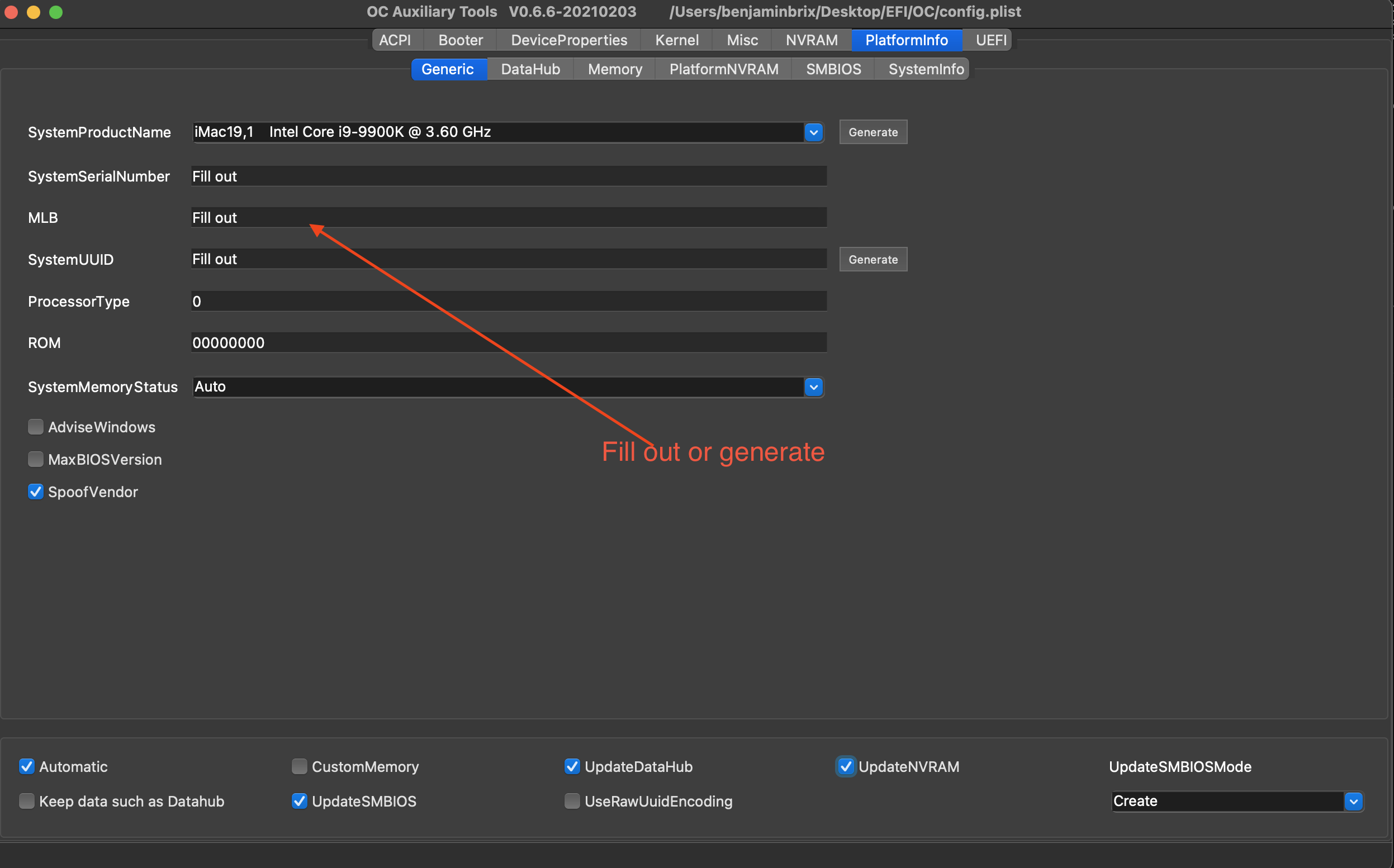

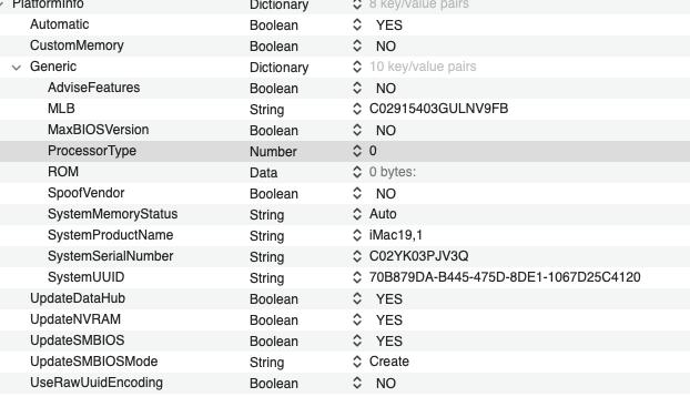

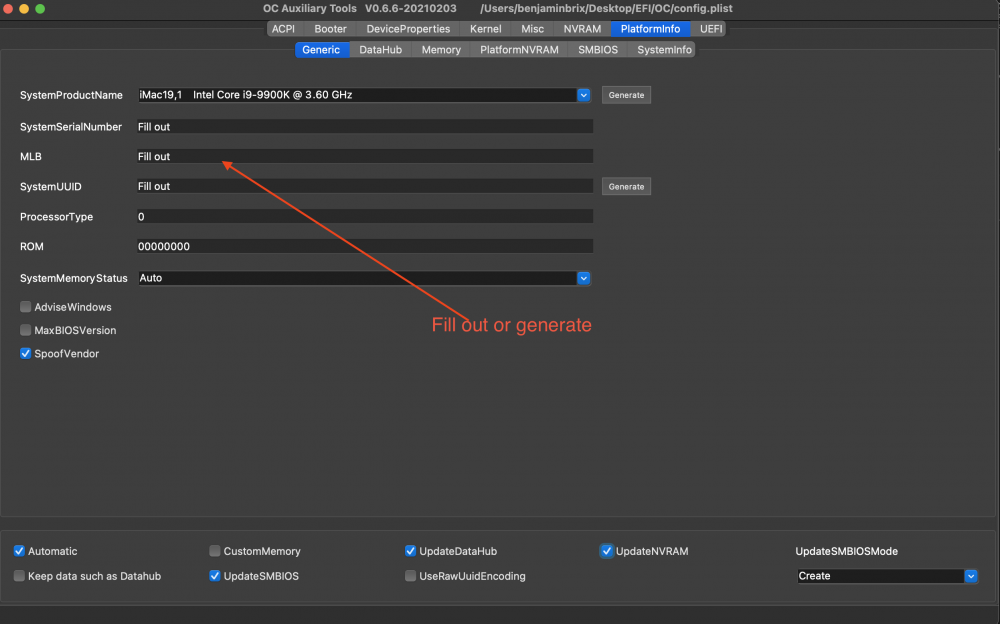

On 7/26/2021 at 10:18 AM, benjiolino said:
I made a EFI with open core 0.71 and it works with MacOS 11.5 with my specs. Z390 Aorus Pro - Radeon VII. If anybody needs it please don't forget to put your serial numbers and reset NVRAM.

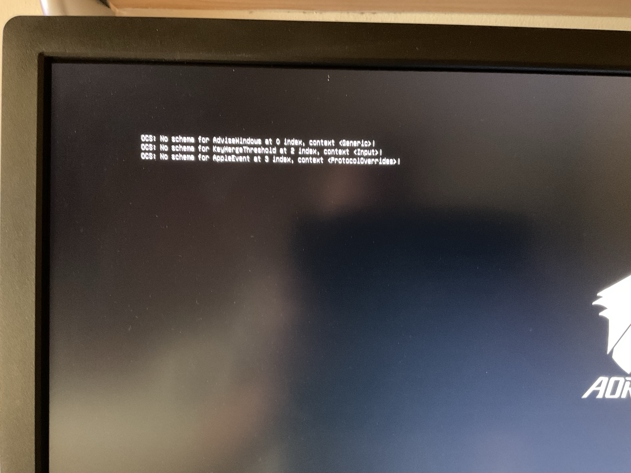

I just tried to update my EFI using @benjiolino EFI.
I changed all the MLB, Serial, UUID and ROM details and also added the pikera boot argument for my Navi GPU.
Everything seems to work but now on boot I get this text on my left side before the boot menu shows up. Any ideas what is wrong?
(Sorry for the bad quality was trying to capture it before it disappeared.)
Edited by unknownharris
Added image.

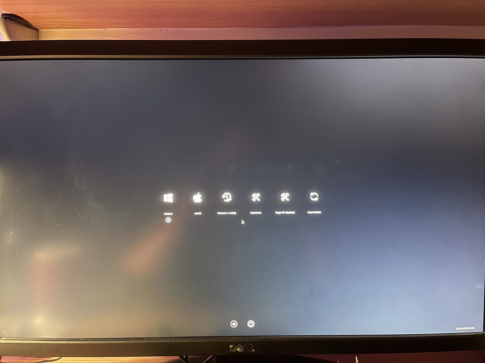

I would also like to know if this would be possible. I have my speakers connected to my monitor's audio port.
Also I used chris1111's Minimal theme on OC and the icons seem way too small for my resolution. (2560x1440)
Is there something I can change to more proportionate icons?

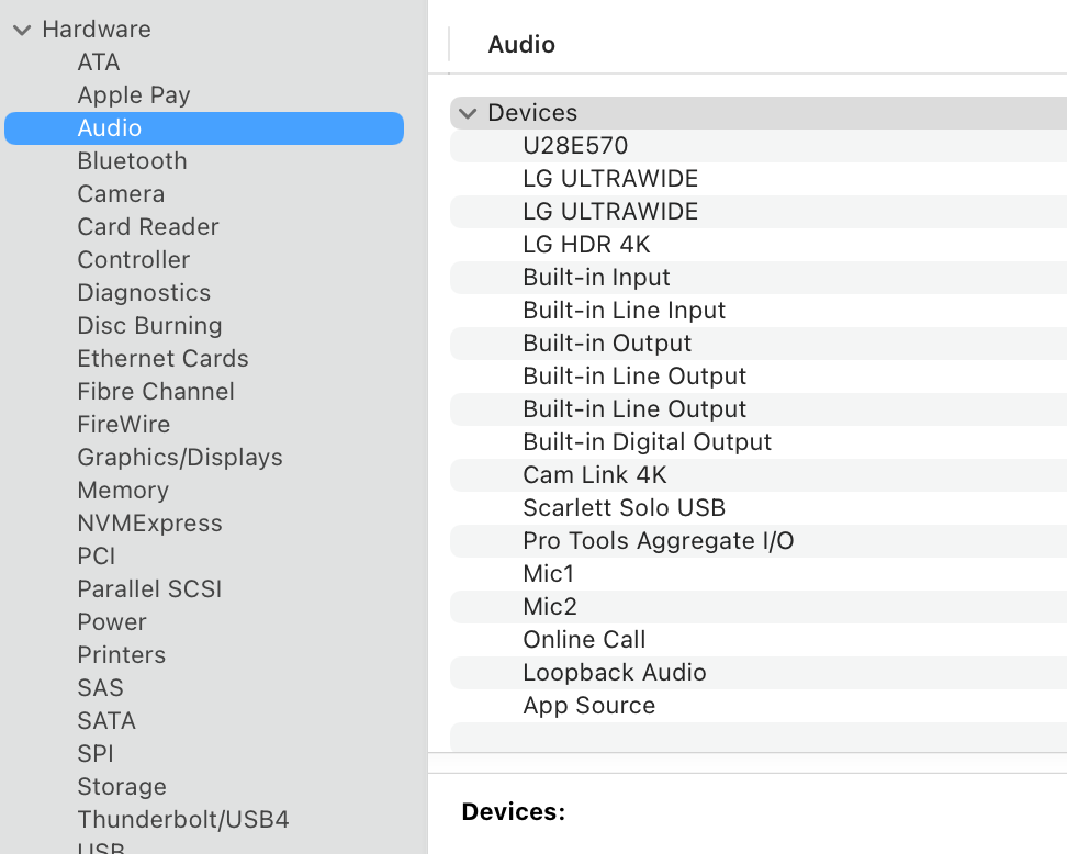

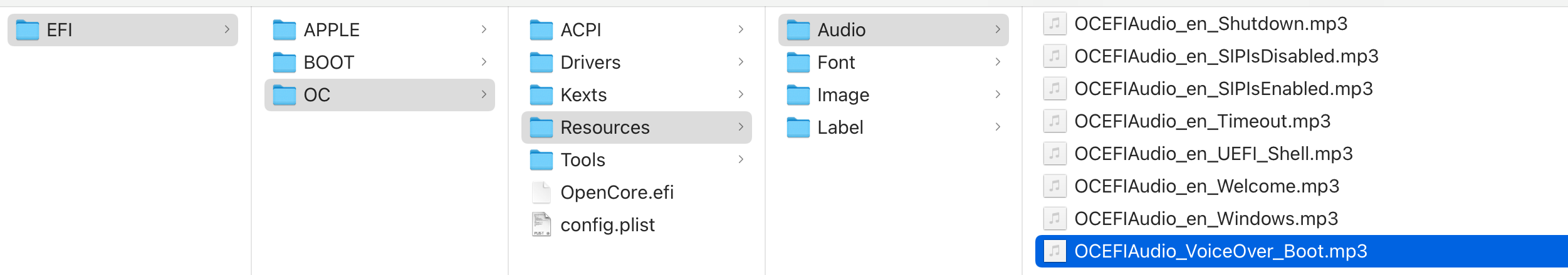

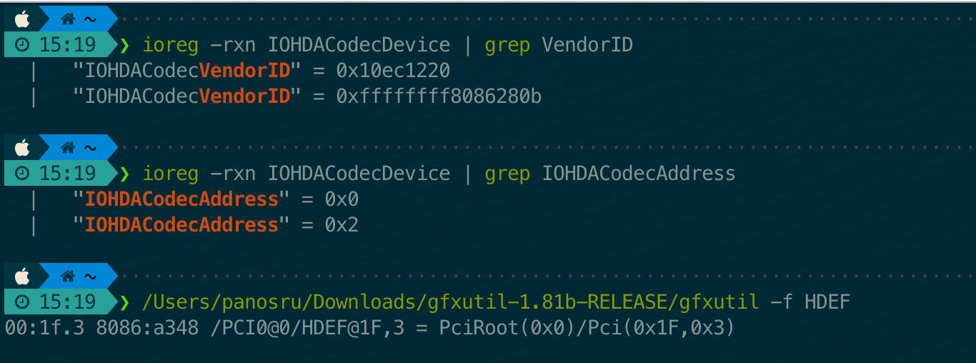

UPDATE:
So far what I've done is the following:
I run the following commands in terminal to check my vendorID and devices, I got two, I'm not sure what the 0x2 is about.

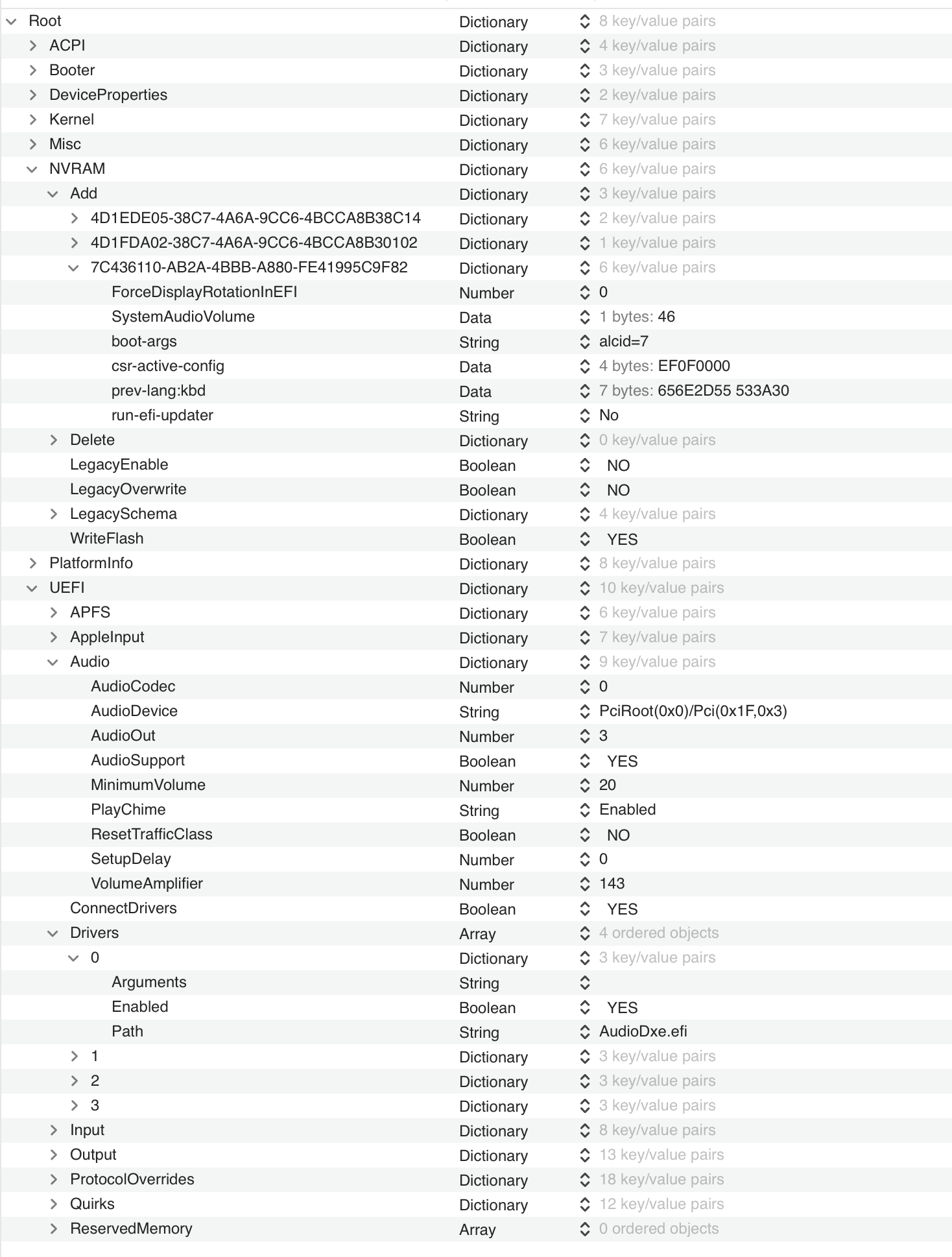

My config looks like this:

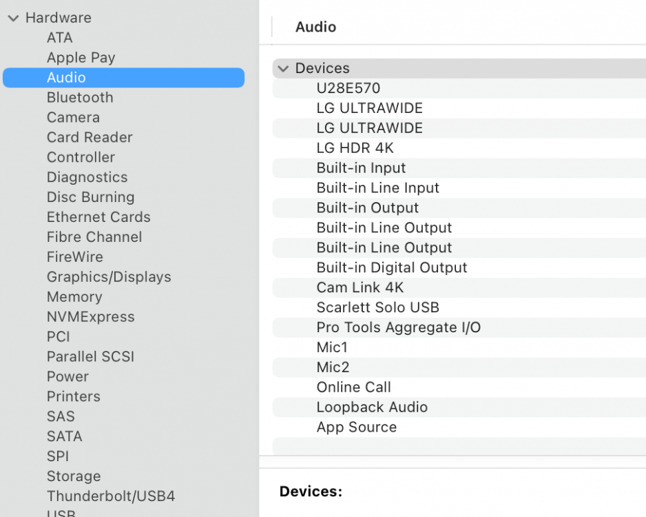

And system information is showing the following audio devices (physical + virtual):
So far I have tried with AudioOut set to 0, 1, 2, 3, and 4, but I wasn't able to hear any chime on boot, the chime mp3 file is in place:
Edited by panosru
