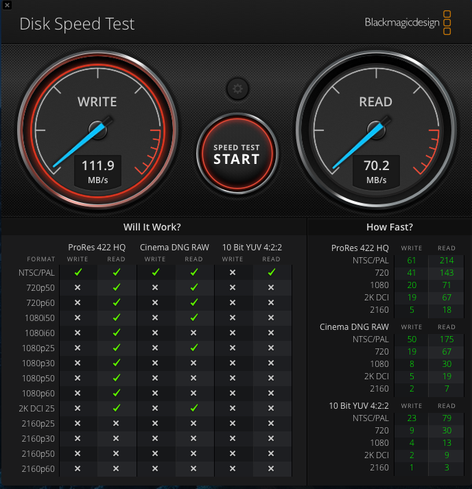

panosru Posted May 9, 2021 Share Posted May 9, 2021 (edited) @texem thanks a ton! I also had an issue with my Cam Link 4k not being recognised for some reason when I directly connect it to any of my USB3 ports, but it worked through my USB3 hub... go figure... by plugging my devices to the places where I need them to be and rebuilding the USBMap.kext, worked like a charm! This is my usb ports output from hackintool, I think everything seems to be ok Edited May 9, 2021 by panosru Link to comment https://www.insanelymac.com/forum/topic/339980-audiogods-aorus-z390-pro-patched-dsdt-mini-guide-and-discussion/page/175/#findComment-2757493 Share on other sites More sharing options...

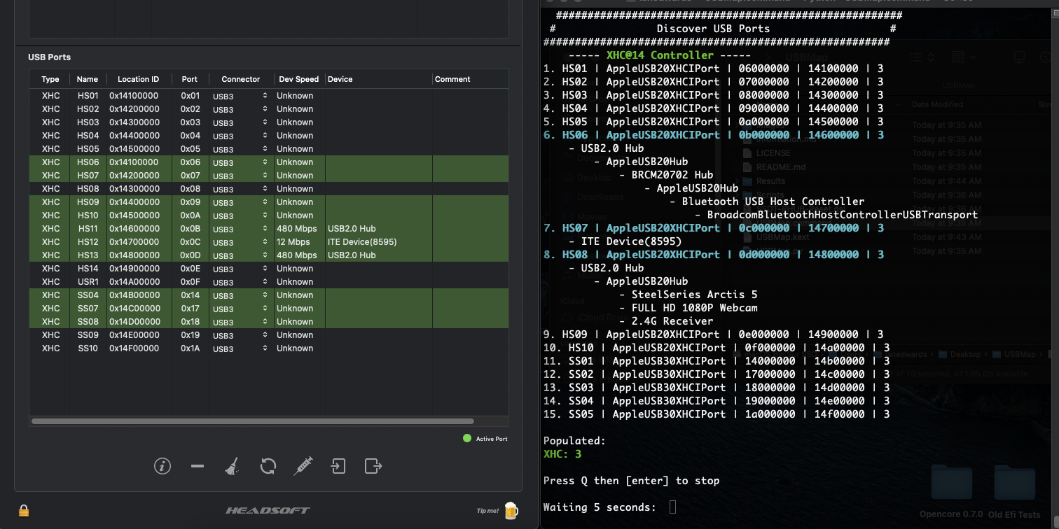

panosru Posted May 9, 2021 Share Posted May 9, 2021 (edited) @cabal2000 same is happening for me as well (I updated my previous post), but everything seems to be working fine. UPDATE: Also keep in mind that the devices USB 3 hubs that are plugged in USB3 are registered two times because a USB3 port is working both as a USB3 and as a USB2 port; thus you may see the same device USB 3 hub connected in USB3 and USB2 (like I have for example with 4-Port USB 2.0 Hub and 4-Port USB 3.0 Hub, it is the same device but is listed two times because of the above mentioned mechanism. Now, about what I just said, I'm almost confident that this is the case, but if someone with in-depth knowledge about it can verify it, then I would be sure about it (just tested) Edited May 9, 2021 by panosru corrections 1 Link to comment https://www.insanelymac.com/forum/topic/339980-audiogods-aorus-z390-pro-patched-dsdt-mini-guide-and-discussion/page/175/#findComment-2757505 Share on other sites More sharing options...

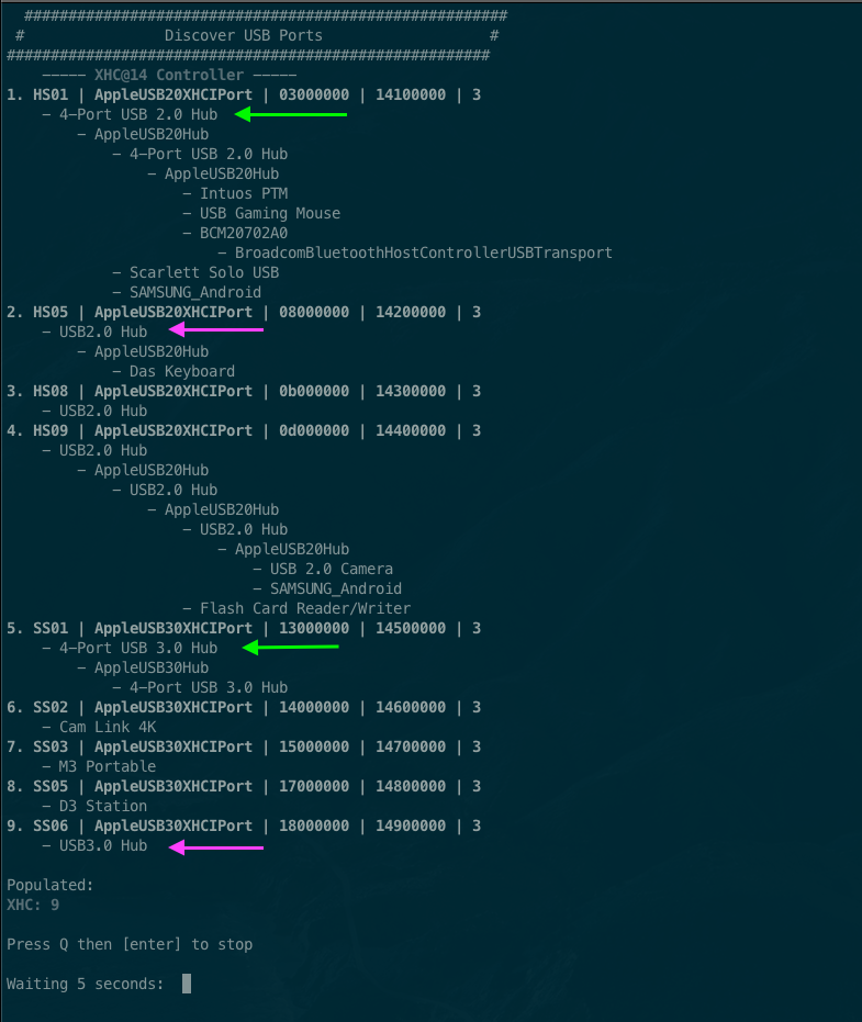

deeveedee Posted May 9, 2021 Share Posted May 9, 2021 3 hours ago, panosru said: Also keep in mind that the devices plugged in USB3 are registered two times because a USB3 port is working both as a USB3 and as a USB2 port; thus you may see the same device connected in USB3 and USB2 (like I have for example with 4-Port USB 2.0 Hub and 4-Port USB 3.0 Hub, it is the same device but is listed two times because of the above mentioned mechanism. Are you saying that when you plug a single USB device into a single USB port, that you see that single device appear on two logical ports? That's a new one for me. I've never seen a single USB device appear simultaneously on a logical USB2 and a logical USB3 port. It's common for a single physical USB port to have multiple logical ports (e.g. a single physical USB port can be associated with one USB2 logical port and one USB3 logical port), but I've never seen a single USB device appear simultaneously on two different logical ports. That is interresting. Link to comment https://www.insanelymac.com/forum/topic/339980-audiogods-aorus-z390-pro-patched-dsdt-mini-guide-and-discussion/page/175/#findComment-2757519 Share on other sites More sharing options...
panosru Posted May 9, 2021 Share Posted May 9, 2021 @tonyx86 as I said, I'm almost certain that this is the case but I'm not 100% sure; thus, someone with higher expertise on the matter could clarify that, maybe I'm wrong. I can see in my devices though that my USB hub(s) connected to a USB 3 port(s) is shown both as a USB 2.0 and 3.0 device. Also, for what I'm 99% sure is that USB 3.0/1/2 ports count as two ports, one for 3.0/1/2 and one for 2.0, in contrast with USB 2.0 which counts as one. Link to comment https://www.insanelymac.com/forum/topic/339980-audiogods-aorus-z390-pro-patched-dsdt-mini-guide-and-discussion/page/175/#findComment-2757520 Share on other sites More sharing options...
deeveedee Posted May 9, 2021 Share Posted May 9, 2021 (edited) 3 minutes ago, panosru said: Also, for what I'm 99% sure is that USB 3.0/1/2 ports count as two ports, one for 3.0/1/2 and one for 2.0, in contrast with USB 2.0 which counts as one. Yes - you are correct. Each logical USB2 and logical USB3 port counts as one of the 15. Note that you can choose to "ignore" one of the logical ports to reduce your overall port count. If you have a single USB 3 port, but you know you're only using the port for a USB2 keyboard, you can delete the logical USB3 port from your port map to make room for another logical port while remaining within your 15-port limit. Edited May 9, 2021 by tonyx86 1 Link to comment https://www.insanelymac.com/forum/topic/339980-audiogods-aorus-z390-pro-patched-dsdt-mini-guide-and-discussion/page/175/#findComment-2757524 Share on other sites More sharing options...

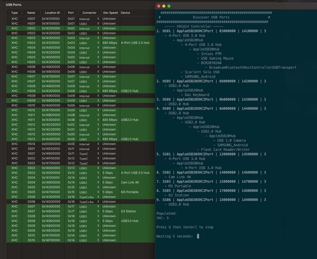

panosru Posted May 9, 2021 Share Posted May 9, 2021 Those are both two USB 3 devices connected in USB 3 ports, they are listed both as USB 2.0 and USB 3.0, what confuses me though is why the connected devices are populated under USB 2.0 instead of USB 3.0, I'll have to plug a USB 3.0 flash disk and do a speed test to make sure they work as USB 3 and not as USB 2. 1 Link to comment https://www.insanelymac.com/forum/topic/339980-audiogods-aorus-z390-pro-patched-dsdt-mini-guide-and-discussion/page/175/#findComment-2757525 Share on other sites More sharing options...
deeveedee Posted May 9, 2021 Share Posted May 9, 2021 (edited) Ah - I haven't played with hubs connected to ports. If I understand your diagram, you've inserted a single hub into a single port and the hub appears as both a USB2 hub and a USB3 hub. That does make sense. I don't have a hub to test. Edited May 9, 2021 by tonyx86 Link to comment https://www.insanelymac.com/forum/topic/339980-audiogods-aorus-z390-pro-patched-dsdt-mini-guide-and-discussion/page/175/#findComment-2757526 Share on other sites More sharing options...
panosru Posted May 9, 2021 Share Posted May 9, 2021 @tonyx86 that is correct indeed. Ah I just realised that in my USB 3 hub I have also connected some USB 2 devices, they appear as USB 2 devices, which is normal. My USB 3 flash disk, when I connect it to my USB 3 Hub, it appears as a USB 3 device and I just checked the speeds with Blackmagic disk speed test and it most certainly works as a USB 3 Link to comment https://www.insanelymac.com/forum/topic/339980-audiogods-aorus-z390-pro-patched-dsdt-mini-guide-and-discussion/page/175/#findComment-2757530 Share on other sites More sharing options...

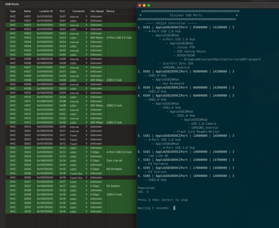

panosru Posted May 9, 2021 Share Posted May 9, 2021 (edited) Strange, it seems my two front USB ports are not working neither in 3.0 nor in 2.0 mode. The front USB ports should be SS/HS 09/10, but I see that on HS09 in my case is populated with my USB 2 hub which is connected to one of HS13 ports. UPDATE: I couldn't figure out how to enable SS10 in the python script, I ended up generating a USBPorts kext from Hacking tool, then edit the info.plist from the contents of USBMap.kext that @AudioGod had provided me a while ago, I removed SS06 as I don't need it, and I added SS10 and now one of my two front USB ports acts as a USB 3 as well. I'm attaching my kext here just in case. USBMap.kext.zip Edited May 10, 2021 by panosru Link to comment https://www.insanelymac.com/forum/topic/339980-audiogods-aorus-z390-pro-patched-dsdt-mini-guide-and-discussion/page/175/#findComment-2757534 Share on other sites More sharing options...
