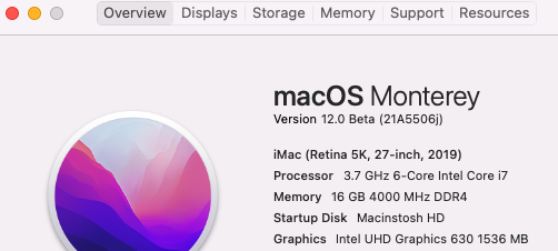

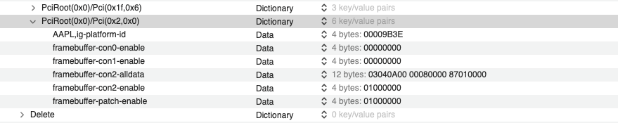

mariodj Posted September 17, 2021 Share Posted September 17, 2021 17 hours ago, eSaF said: @mariodj - See attached and carefully copy all that is shown in the box, also enable Internal Graphics in the BIOS as well should be ok. Hide contents But this add is already in your EFI, after boot i got green screen. Link to comment https://www.insanelymac.com/forum/topic/339980-audiogods-aorus-z390-pro-patched-dsdt-mini-guide-and-discussion/page/180/#findComment-2766683 Share on other sites More sharing options...

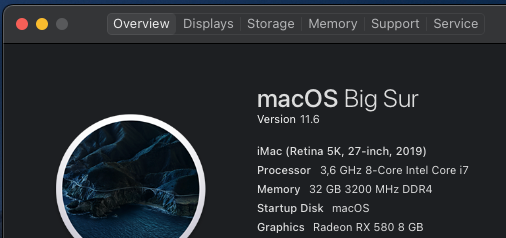

Hal012 Posted September 17, 2021 Share Posted September 17, 2021 I have the i8700k, and it is working with this setting 1 Link to comment https://www.insanelymac.com/forum/topic/339980-audiogods-aorus-z390-pro-patched-dsdt-mini-guide-and-discussion/page/180/#findComment-2766693 Share on other sites More sharing options...
mariodj Posted September 17, 2021 Share Posted September 17, 2021 1 hour ago, eSaF said: What Mac Model is your machine also did you alter the settings in the BIOS for internal Graphics only and save, are you running the latest BIOS version for your board? I don't know how much difference that makes but the EFI Folder is based on Mac Model 19.1 plus Gigabyte BIOS version k. i compare your EFI with latest from our God Audiogod , do some small changes and it works now 1 Link to comment https://www.insanelymac.com/forum/topic/339980-audiogods-aorus-z390-pro-patched-dsdt-mini-guide-and-discussion/page/180/#findComment-2766696 Share on other sites More sharing options...
