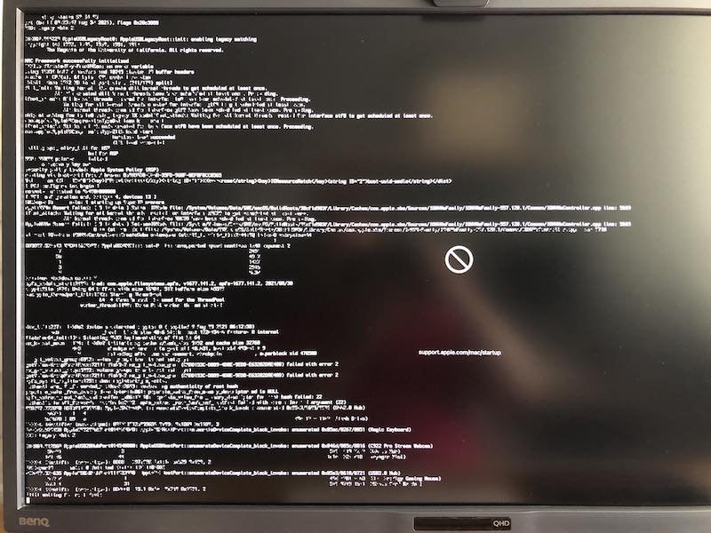

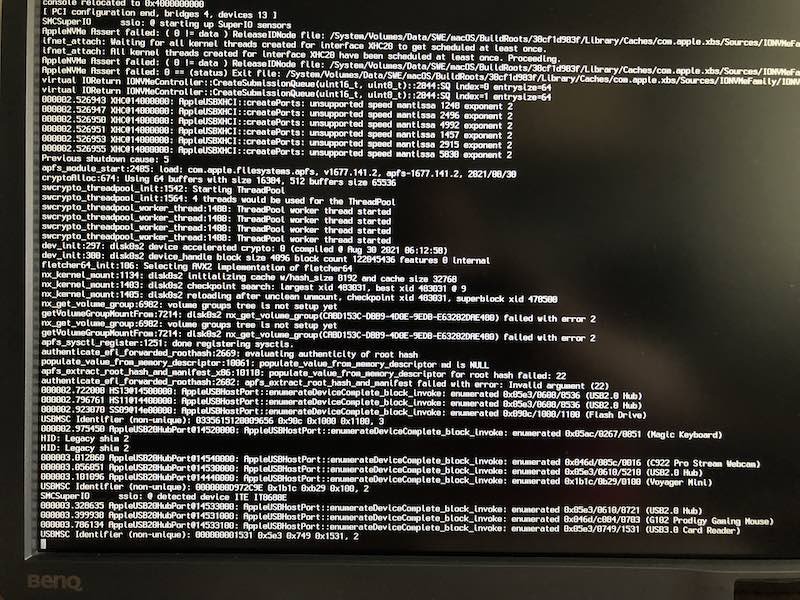

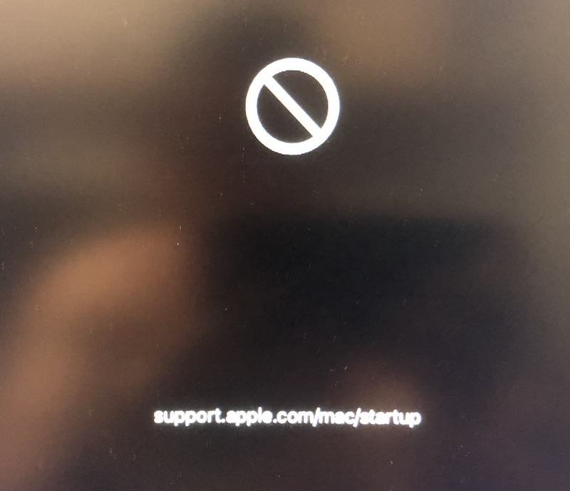

dredhorse Posted April 15, 2021 Share Posted April 15, 2021 (edited) On 4/1/2021 at 12:17 PM, AudioGod said: Sounds like you didn’t clear your nvram between EFIs as The SecureBootModel is set correctly for both EFIs. Disable it or have it set to j137 or default. so I did reset NVRAM, once from the new bootstick, and once from the original install. I still have the issue. Could it be the missing MAC address in my config? I will try disabled to see if I have other issues and investigate further. With disabled I can boot, but I don't have USB Edited April 15, 2021 by dredhorse Link to comment Share on other sites More sharing options...
pkdesign Posted April 15, 2021 Share Posted April 15, 2021 (edited) I have to have SecureBootModel disabled in order for my system to work. I know @AudioGod and I have had this discussion before. According to Dortania Guide, j137 or Default is for iMacPro1,1. Guide does not list iMac19,1 therefore it needs to be set to disabled. Edited April 15, 2021 by pkdesign Link to comment Share on other sites More sharing options...
AudioGod Posted April 15, 2021 Author Share Posted April 15, 2021 (edited) 1 hour ago, pkdesign said: I have to have SecureBootModel disabled in order for my system to work. I know @AudioGod and I have had this discussion before. According to Dortania Guide, j137 or Default is for iMacPro1,1. Guide does not list iMac19,1 therefore it needs to be set to disabled. Correct and also incorrect. There is indeed no match for 19,1 but that’s because it’s covered by using the default or j137. We have to agree to disagree on this one good sir, To quote directly from the OC Guide. Special Notes with SecureBootModel Generally Default is more than adequate to use however if you plan to have use this with ApECID for full security, we recommend setting a proper value(ie. closest to your SMBIOS or versions of macOS you plan to boot) since the Default value is likely to be updated in the future. Edited April 15, 2021 by AudioGod 1 Link to comment Share on other sites More sharing options...

dredhorse Posted April 16, 2021 Share Posted April 16, 2021 ok to recap: I did install Catalina on an Aorus Z390 Master. I needed to replace the motherboard with a Aorus Z390 Pro as the board had issues and there aren't any Masters available anymore in my area. Windows works without an issue but I can't get OSX to work. When I boot from a stick with the Z390 PRO EFI it boots to the login screen, but I don't have USB. Any idea on how to troubleshoot this? Link to comment Share on other sites More sharing options...
