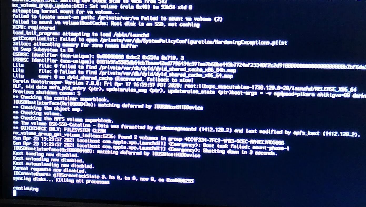

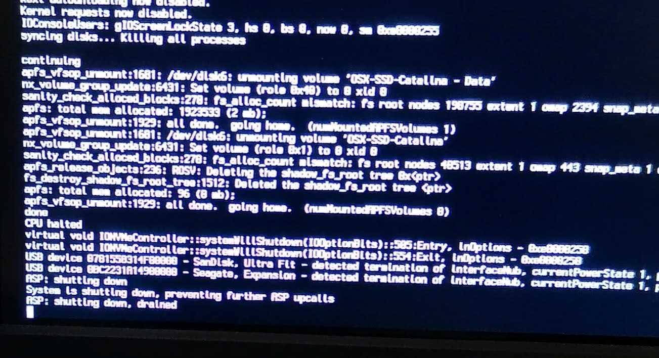

freakermonguer Posted February 7, 2021 Share Posted February 7, 2021 to anybody that could help me, specially @AudioGod that indeed is a god in this matters :-) Z390 PRO mb. I've been working with it around a year now, but didn't update a thing. Still on Catalina. Works like a charm except an usb random issue that happens just sometimes. If I recall properly I have bios 11J (could it be?) it seems that now there's a new bios. I want to be careful in what I do as I don't want to mess up anything. My plan is to update everything step by step so I can go back and correct it if I go wrong. Which steps should I follow to update my build?. I don't want to get stuck up with a non working build. Of course before doing anything I will backup my OS drive to be able to go back instead of anything goes bad, but it's the bios update / open core update altogether that scares me, I have a few questions: What do you recommend? BIOS & OPENCORE update (i will do it in a new USB drive just to be careful) and then -> OS UPDATE? Or OS UPDATE (with older opencore and bios) and then -> BIOS & OPENCORE update? (I wonder if old opencore will work with BigSur) - If I update the BIOS withouth updating opencore will the older OpenCore still boot? - Will and updated bios and updated OpenCore Work with Catalina? Because I can go step by step. Update Bios -> Boot in Catalina -> update OpenCore -> Boot in Catalina with new opencore -> Update Catalina There's another path I can follow which is Update to BigSur -> Boot BigSur with older OpenCore and Bios -> Update OpenCore -> Update BIOS -> Boot again in BigSur with everything updated But for this path to work I need to know if I can boot in BigSur with the older F11J bios and the older OpenCore, or is it mandatory to update the OpenCore and Bios FIRST so BigSur works? Link to comment Share on other sites More sharing options...

freakermonguer Posted February 11, 2021 Share Posted February 11, 2021 On 2/7/2021 at 8:53 PM, freakermonguer said: to anybody that could help me, specially @AudioGod that indeed is a god in this matters :-) Z390 PRO mb. I've been working with it around a year now, but didn't update a thing. Still on Catalina. Works like a charm except an usb random issue that happens just sometimes. If I recall properly I have bios 11J (could it be?) it seems that now there's a new bios. I want to be careful in what I do as I don't want to mess up anything. My plan is to update everything step by step so I can go back and correct it if I go wrong. Which steps should I follow to update my build?. I don't want to get stuck up with a non working build. Of course before doing anything I will backup my OS drive to be able to go back instead of anything goes bad, but it's the bios update / open core update altogether that scares me, I have a few questions: What do you recommend? BIOS & OPENCORE update (i will do it in a new USB drive just to be careful) and then -> OS UPDATE? Or OS UPDATE (with older opencore and bios) and then -> BIOS & OPENCORE update? (I wonder if old opencore will work with BigSur) - If I update the BIOS withouth updating opencore will the older OpenCore still boot? - Will and updated bios and updated OpenCore Work with Catalina? Because I can go step by step. Update Bios -> Boot in Catalina -> update OpenCore -> Boot in Catalina with new opencore -> Update Catalina There's another path I can follow which is Update to BigSur -> Boot BigSur with older OpenCore and Bios -> Update OpenCore -> Update BIOS -> Boot again in BigSur with everything updated But for this path to work I need to know if I can boot in BigSur with the older F11J bios and the older OpenCore, or is it mandatory to update the OpenCore and Bios FIRST so BigSur works? Any help with this would be appreciated Link to comment Share on other sites More sharing options...
AudioGod Posted February 11, 2021 Author Share Posted February 11, 2021 (edited) 1 hour ago, freakermonguer said: Any help with this would be appreciated Sorry buddy, I missed your original message. Big Sur will work with OpenCore 0.6.4 or higher although I recommend you use V0.6.6 from the off. OpenCore is free from bios version dependency as there’s no dsdt involved so your free to stick on the bios revision your currently using or use the latest version available and just dial back in the settings on page one. Your choice. to upgrade to big sur update to OpenCore 0.6.6 first. As for usb randomly cutting out, well that a Z390 Pro bug and it also happens on a few other Gigabyte boards including AMD X570 and B550 boards. As far as I know it’s still not been fixed on the Z390 Pro and there’s not a lot that can be done about it other then bugging Gigabyte. (It happens in windows too). Tip - Download the latest OC EFI from here and copy your serial number, uuid, MLB and MAC Address from your old config.plist to the new one and stick it on a USB macOS Install drive and make sure it works for you. Follow the steps on the install update notice that you can find on the top of page 172. Everything you need to know and download is there waiting for you. (The V0.6.6 EFI will work with Mojave, Catalina or Big Sur) Edited February 11, 2021 by AudioGod 1 Link to comment Share on other sites More sharing options...
