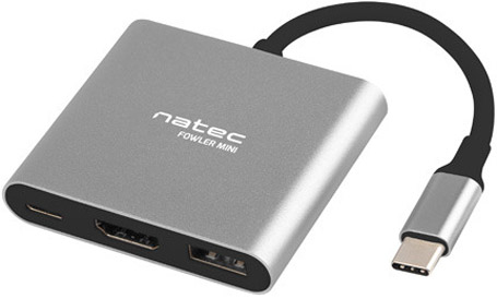

panosru Posted June 23, 2021 Share Posted June 23, 2021 Hello everyone! I was wondering if anyone tried to use USB-C port to connect an HDMI adapter. I bought today the bellow adapter, but the HDMI port didn't work with my Hackintosh, neither it did with various Xiaomi devices nor with a Saumsung A7. USB 3 port worked fine, when I connected a USB flash disk it was recognised by all devices. I will return the item tomorrow and I will swap it with another one, but I was wondering if there is a kext maybe that I have to install in order to USB-C to HDMI to work. Thanks a lot! Link to comment https://www.insanelymac.com/forum/topic/339980-audiogods-aorus-z390-pro-patched-dsdt-mini-guide-and-discussion/page/177/#findComment-2761487 Share on other sites More sharing options...
WizeMan Posted June 24, 2021 Share Posted June 24, 2021 10 hours ago, panosru said: Hello everyone! I was wondering if anyone tried to use USB-C port to connect an HDMI adapter. I bought today the bellow adapter, but the HDMI port didn't work with my Hackintosh, neither it did with various Xiaomi devices nor with a Saumsung A7. USB 3 port worked fine, when I connected a USB flash disk it was recognised by all devices. I will return the item tomorrow and I will swap it with another one, but I was wondering if there is a kext maybe that I have to install in order to USB-C to HDMI to work. Thanks a lot! It's a USB 3.1 Gen 2. The fact that it uses a USB-C port does not mean it is Thunderbolt or that it supports Video signal pass. Link to comment https://www.insanelymac.com/forum/topic/339980-audiogods-aorus-z390-pro-patched-dsdt-mini-guide-and-discussion/page/177/#findComment-2761502 Share on other sites More sharing options...
panosru Posted June 24, 2021 Share Posted June 24, 2021 (edited) @WizeMan but shouldn't it work at least on mobile? Btw, on the box description it says that it supports Windows and MacOS, therefore I'll return it today and see other options available. One other question that I have is if this product will be able to work on macOS. I understand that MST technology is not supported by macOS (FFS...) but all I need is to take one feed and split it into two mirrored feeds so I could have my main 4K monitor at 60fps and a second monitor mirroring my main monitor. ^It doesn't work, I called the company ^ Edited June 24, 2021 by panosru Link to comment https://www.insanelymac.com/forum/topic/339980-audiogods-aorus-z390-pro-patched-dsdt-mini-guide-and-discussion/page/177/#findComment-2761503 Share on other sites More sharing options...
WizeMan Posted June 24, 2021 Share Posted June 24, 2021 32 minutes ago, panosru said: @WizeMan but shouldn't it work at least on mobile? Btw, on the box description it says that it supports Windows and MacOS, therefore I'll return it today and see other options available. One other question that I have is if this product will be able to work on macOS. I understand that MST technology is not supported by macOS (FFS...) but all I need is to take one feed and split it into two mirrored feeds so I could have my main 4K monitor at 60fps and a second monitor mirroring my main monitor. ^It doesn't work, I called the company ^ Unless it's defective, it will work on macOS or Windows but with hardware that supports the passing of video signal through the USB-C / Thunderbolt port. The Aorus z390 Pro does not have this functionality. 2 1 Link to comment https://www.insanelymac.com/forum/topic/339980-audiogods-aorus-z390-pro-patched-dsdt-mini-guide-and-discussion/page/177/#findComment-2761504 Share on other sites More sharing options...

jimborae Posted July 5, 2021 Share Posted July 5, 2021 (edited) On 6/24/2021 at 7:52 AM, panosru said: @WizeMan but shouldn't it work at least on mobile? Btw, on the box description it says that it supports Windows and MacOS, therefore I'll return it today and see other options available. One other question that I have is if this product will be able to work on macOS. I understand that MST technology is not supported by macOS (FFS...) but all I need is to take one feed and split it into two mirrored feeds so I could have my main 4K monitor at 60fps and a second monitor mirroring my main monitor. ^It doesn't work, I called the company ^ Not necessarily, many/most mobiles that have a USB C port are not USB 3 configured. The vast majority only support USB 2, you can check by looking at the file trasfer speeds. Some have implemented HDMI out via USB C port but not many and even fewer are genuinely USB 3 with video out supported. Basically it's total cr@pshoot when it comes to mobile phone ports & supported protocols. Edited July 5, 2021 by jimborae 1 Link to comment https://www.insanelymac.com/forum/topic/339980-audiogods-aorus-z390-pro-patched-dsdt-mini-guide-and-discussion/page/177/#findComment-2762304 Share on other sites More sharing options...
panosru Posted July 6, 2021 Share Posted July 6, 2021 @jimborae, yes, that was the case, sorry, I forgot to update my topic. Xiaomi Mi Max 2 (which is the phone I intended to use the cable), does not support video output from the USB-C, only data transfer and charging. And as @WizeMan pointed, Aorus Z390 Pro, doesn't support video output via USB-C port either. Link to comment https://www.insanelymac.com/forum/topic/339980-audiogods-aorus-z390-pro-patched-dsdt-mini-guide-and-discussion/page/177/#findComment-2762380 Share on other sites More sharing options...
