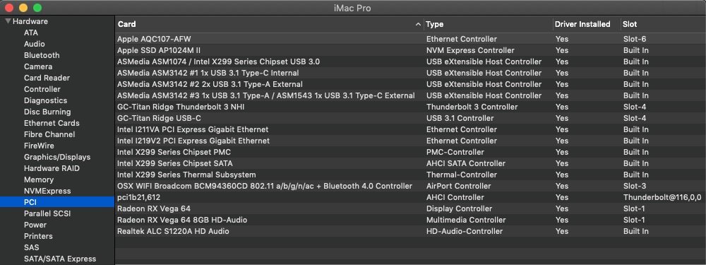

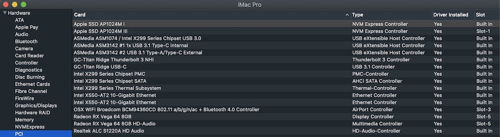

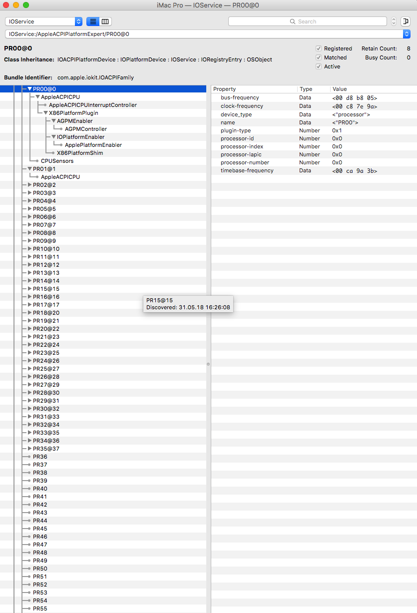

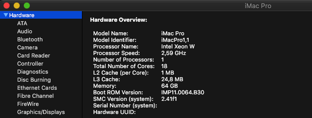

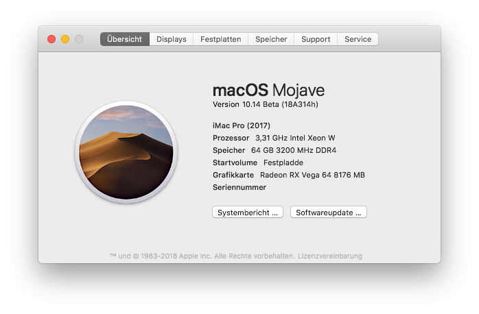

Up and running macOS Mojave 10.14.4  (18E226) on iMac Pro Skylake-X/X299 Hackintosh!
This afternoon @DSM2 advised me that yesterday Apple seems to have added a second special build of MacOS 10.14.4 (18E2034) on swcdn.apple.com, likely for new devices.

D.) iMac Pro macOS 10.14 Mojave System Setup
This chapter includes a general guideline how to perform the initial setup of your iMac Pro with macOS Mojave 10.14.
D.1) iMac Pro EFI-Folder Preparation
D.2) iMac Pro macOS Mojave 10.14 Installer Package Creation
D.3) iMac Pro macOS Mojave 10.14 USB Flash Drive Installer Creation
D.4) iMac Pro macOS Mojave 10.14 Clean Install on Skylake-X/X299
D.5) Direct iMac Pro conversions of a functional Skylake-X/X299 system with a SMBIOS System Definition different from iMacPro1,1 and a standard macOS build implementation
D.6) iMac Pro macOS 10.14 Mojave Update Procedure

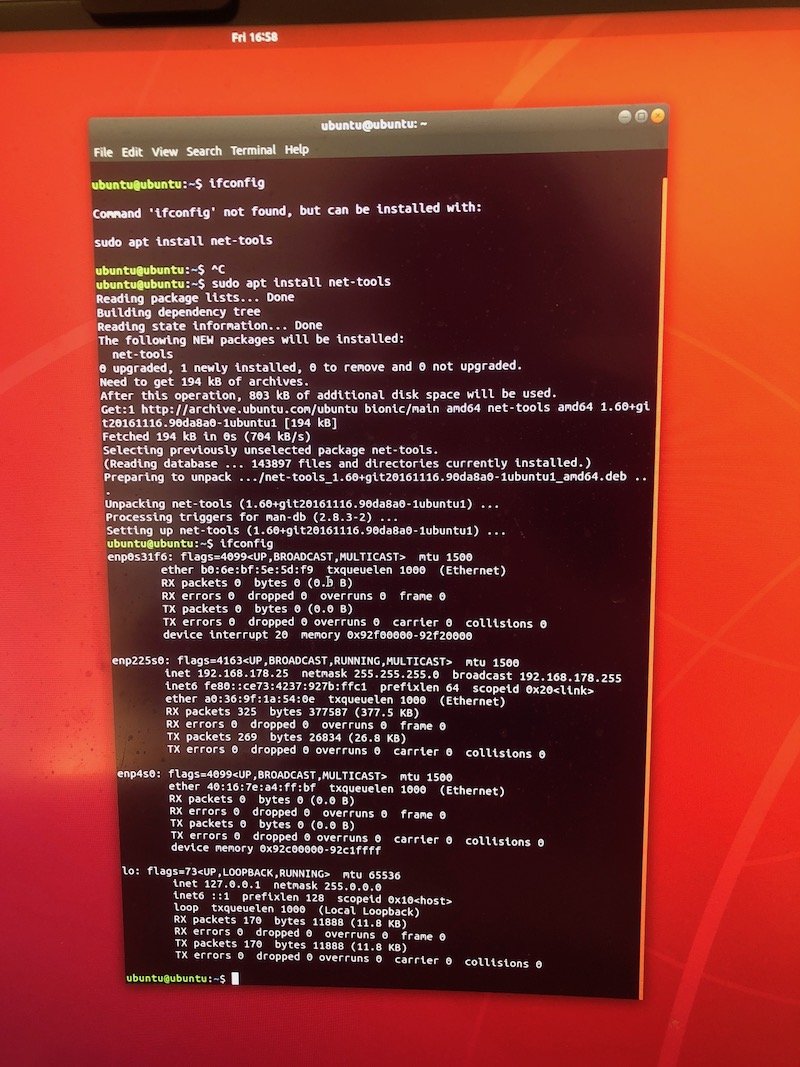

E.8) Gbit and 10-Gbit Ethernet Implementations
E.8.1) ASUS Prime X299 Deluxe on-board Gbit Ethernet Functionality
E.8.2) 10-Gbit LAN Implementations
E.8.2.1) ASUS XG-C100C Aquantia AQC107 10-Gbit NIC
E.8.2.2) Intel X540-T1 10-Gbit NIC

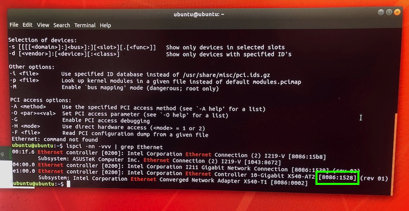

E.8.2.3) Onboard Intel X550-AT2 10-Gbit NICs of the ASUS WS X299 Sage 10G
E.8.2.4) Small-Tree P2EI0G-2T 10-Gbit NIC
E.8.2.5) NetGear ProSave XS508M 8-port 10-Gbit Switch
E.8.2.6) QNAP TS-431X2 Quad-core 4-Bay NAS tower
E.8.2.7) 10-GBit Ethernet Optimisation

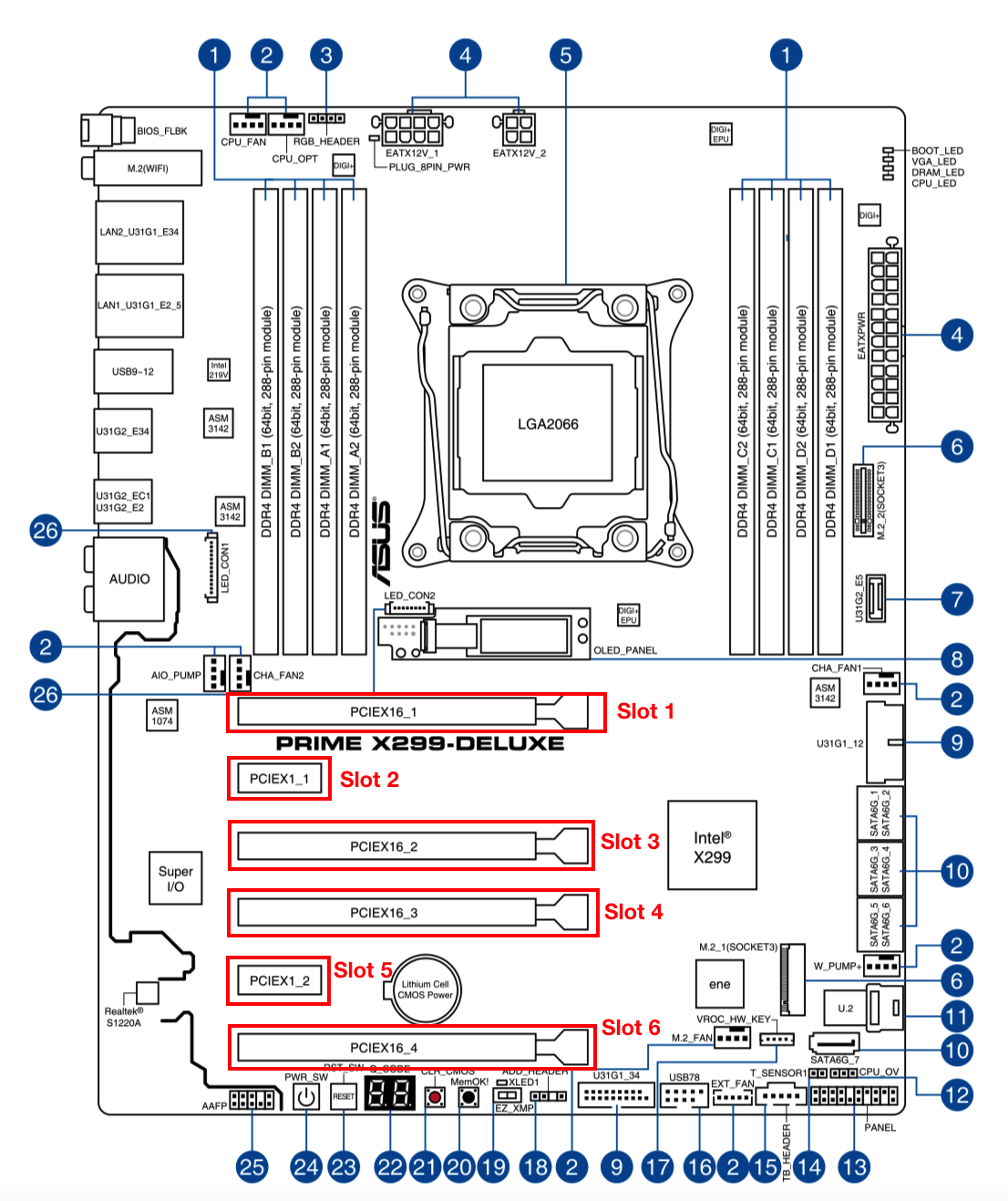

E.9) ASUS Prime X299 Deluxe PCI Device Implementation

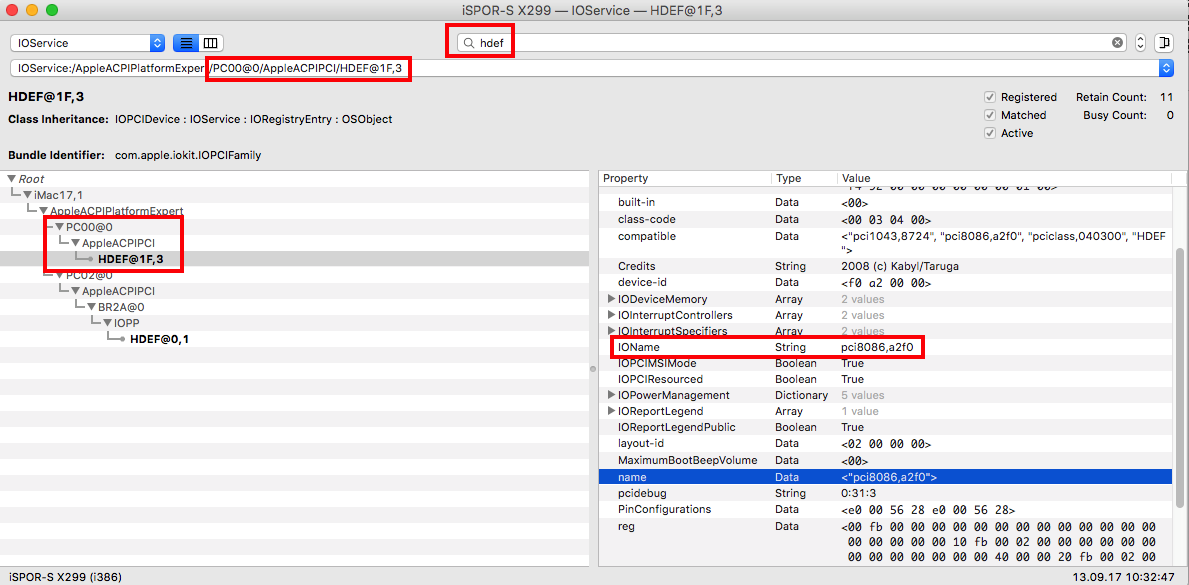

E.9.1) ACPI DSDT Replacement Implementation
E.9.2) System SSDT PCI Device Implementation
E.9.2.1) - HDEF - onboard PCI Audio Controller PCI Implementation

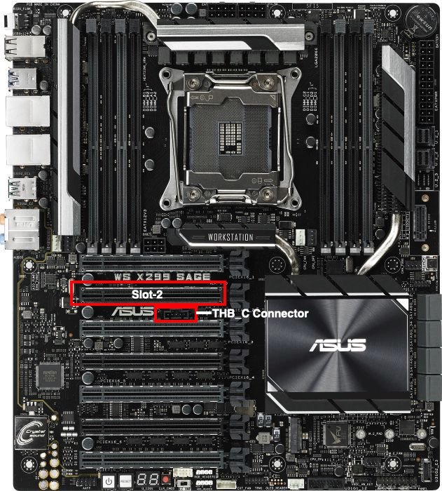

E.9.2.13) - GC-Titan Ridge / GC-Alpine Ridge / Asus TBEX 3 Thunderbolt HotPlug System Implementation

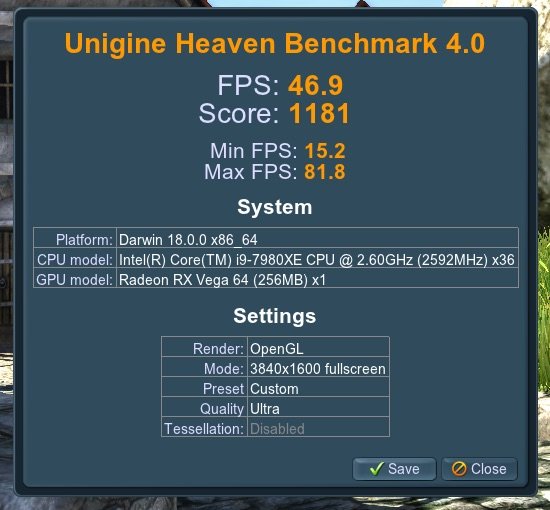

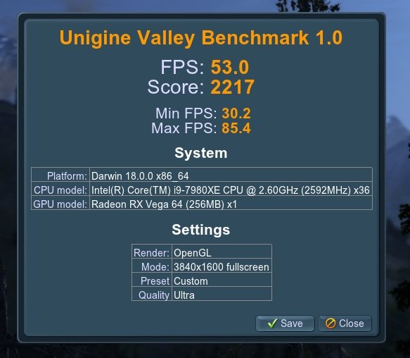

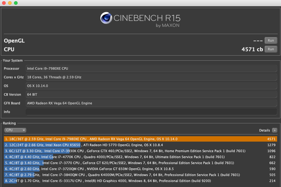

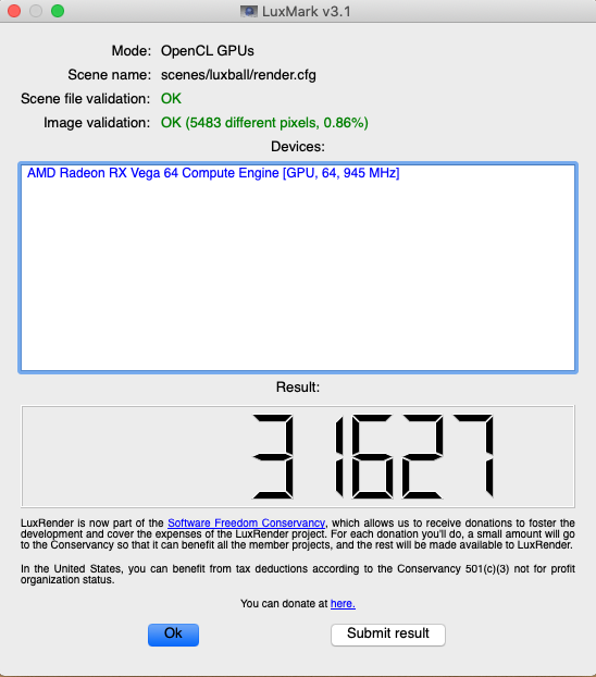

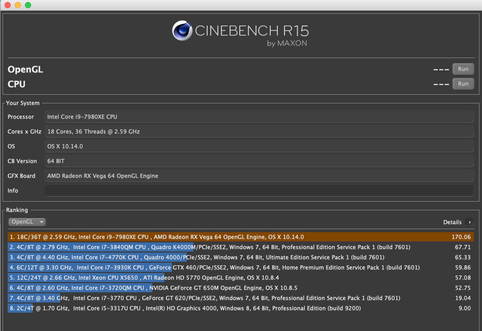

F.) Benchmarking
F.1) Sylake-X Intel I9-7980XE CPU Benchmarking
F.2) Gigabyte AORUS GTX 1080 Ti Waterforce EB 11GB Extreme Edition Benchmarking

4.) To avoid Skylake-X thread TSC desynchronisation errors during boot and wake from S3 with unpatched X299 mainboards, likely induced by yet erroneous Skylake-X BIOS microcode implementations, we need to use TSCAdjustReset.kext provided by @interferenc in the /EFI/CLOVER/kexts/Other/ directory of both USB Flash Drive and System Disk.
To access TSCAdjustRest.kext, download primarily its source distribution from Github with the following terminal command:
git clone https://github.com/interferenc/TSCAdjustReset
Subsequently copy the TSCAdjustRest source distribution to your Desktop using the following terminal command:
mv /TSCAdjustReset ~/Desktop
Now change in the terminal to the TSCAdjustReset source distribution on your Desktop with the following terminal command:
cd ~/Desktop/TSCAdjustReset/
Now compile the source distribution with Xcode by using the following terminal command:
xcodebuild
After successful compilation, you will find the TSCAdjustRest.kext in ~/Desktop/TSCAdjustReset/build/Release/
Please note that the TSCAdjustRest.kext by default is configured for a 8-core CPU (16 threads) like the i7-7820X. To adopt the kext for Skylake-X processers with more or less cores than 8 cores, apply the following approach:
a.) Right-click with the mouse on the TSCAdjustRest.kext file and select "Show Packet Contents".
b.) Double-click with the mouse on /contents/ . After a right-click on the "Info.plist" file, select "Open with /Other". Select the TextEdit.app and edit the "Info.plist" file.
c.) Use the "find"-function of TextEdit.app and search for the term "IOCPUNumber"
d.) Note that the adequate IOCPUNumber for your particular Skylake-X processor is the number of its threads -1, by always keeping in mind that the number of it's threads is always 2x the number of it's cores.
Thus in case of the 8 core i7-7820X, the IOCPUNumber is 15 (16 threads - 1).
<key>IOCPUNumber</key>				<integer>15</integer>
By following this methodology, the correct IOCPUNumber for the 10-core i9-7900X would be 19 (20 threads -1)
<key>IOCPUNumber</key>				<integer>19</integer>
and the IOCPUNumber for the 18-core i9-7980XE would result in 35 (36 threads -1).
<key>IOCPUNumber</key>				<integer>35</integer>
e.) After adopting the IOCPUNumber for your particular Skylake-X processor, save the info.plist file and copy the modified TSCAdjustRest.kext to the /EFI/CLOVER/kexts/Other/ - directories of both USB Flash Drive Installer and System Disk and you are save and all done!

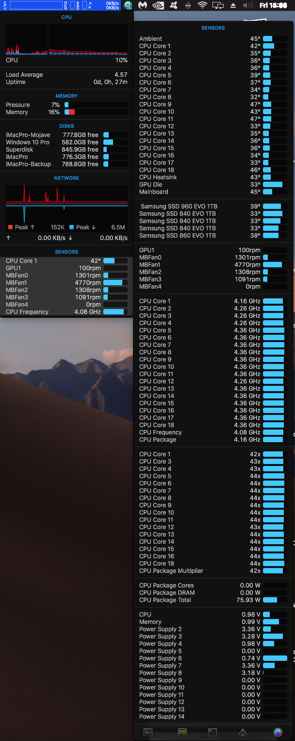

How to verify a working xcpm configuration?
a.) Typically the command "sysctl machdep.xcpm.mode" reveals 1, which means that XCPM is active.
b.) Verify that in the IORegistryExplorer you have now under CP00@0 the following entry:
Property:         Type:         Value:
plugin-type       Number        0x1
c.) Also verify with the terminal command:
kextstat|grep -y x86plat
that the "X86PlatformPlugin.kext" is now loaded. If the command returns something like
112    1 0xffffff7f822bc000 0x17000    0x17000    com.apple.driver.X86PlatformPlugin (1.0.0) FD88AF70-3E2C-3935-99E4-C48669EC274B <111 19 18 13 11 7 6 5 4 3 1>
146    1 0xffffff7f822d3000 0x7000     0x7000     com.apple.driver.X86PlatformShim (1.0.0) DCEA94A4-3547-3129-A888-E9D5C77B275E <112 111 13 7 4 3>
d.) Verify with the following terminal command:
kextstat|grep -y appleintelcpu
that you got rid of the Apple Intel CPU power management. If the result is empty you are fine.
e.)  Verify with the following terminal command:
sysctl -n machdep.xcpm.vectors_loaded_count
If this command returns "1", the XCPM FrequencyVectors are properly loaded and you are all set.
E.2) Graphics Configuration
Most ATI GPUs, e.g. RX Vega 64, RX Vega Frontier, RX 580, RX 560 are supposed to be "natively" implemented. It is commonly recommended not to use RX 560 and RX 580 GPUs due to the lacking iGPU implementation when using SMBIOS iMacPro1,1.
With macOS 10.14.5 Beta 1, also the new Radeon VII is now natively implemented.
By means of my RadeonVII/Vega64/Vega56/RX560/RX580 SSDTs, available in my respective X299 SSDT Github repository, and Whatevergreen.kext, all available DP and HDMI ports, including multi-monitor support, display HotPlug and system sleep/wake should be automatically and successfully implemented. Whatevergreen.kext only seems required for all Vegas possessing less than 6 physical ports (including the original Vegas like Frontier and Vega 64), else the current AMD SSDTs do pretty well their job.
Important additional comment for all Vega users with 4K monitors though: when connecting a Vega with e.g. the LG 38UC99-W (WUHD, 3840 pix x 1600 pix) via one of the Display Ports (DPs), the screen resolution is fine under both Windows 10 and macOS High Sierra but is totally at odd during boot (VGA like boot screen resolution). The VEGA DP 4K boot screen resolution issue is neither related with the fact that the LG 38UC99-W is an ultra-wide (3840x1600) and not a true UHD (3840x2160) monitor nor related to any likely apparent issue with the ASUS Prime X299 Deluxe firmware. It is definitely a Vega firmware problem in combination with most 4K displays, as the DP 4K boot screen resolution issue is totally absent with any Nvidia GPU and the problem also does not only affect the ASUS Splash Screen but also spreads over the entire boot process until the login screen is reached (Windows and macOS). Splash Screen, Apple logo or verbose boot messages are not stretched but rather have VGA like resolution. Any fix of the AMD vBIOS would be highly appreciated. It is more than disappointing to witness such issues with 600-1000$ GPUs... Fortunately, the 4K boot screen issue is restricted to the Vega DP ports and likely due to the fact that the LG 38UC99-W only supports DP 1.2. Solution: Connect your Vega and your 4K display via the HDMI port. The 30 Hz HDMI monitor frequency issue under 10.13 is successfully removed under Mojave: monitor frequency of 60 Hz with the display connected via HDMI (in contrary to 75 Hz via DP).
Also Nvidia Kepler Graphics Cards are natively implemented.
All Users with Nvidia Maxwell and Pascal Graphics Cards Users still have to wait for the official release of 10.14 Web Drivers. I was actively requesting Web Driver development for macOS 10.14 Betas from Nvidia, which has been rejected. I really hope that Nvidia will not leave the respective community again without Web Driver support. In the meanwhile,  Nvidia GPU users have to live with e.g. patched Web Driver xxx.40.105 for macOS High Sierra 10.13.6 after a simple patching procedure detailed below, although the latter Web Driver is not really suited for 10.14 and works without hardware acceleration.

b.) Download, unzip and run IORegistryExplorer.
Search for HDEF and write down the "IOName"-entry under e.g. PC00@0/AppleACPIPCI/HDEF@1F,3 which can slightly deviate on mainboards different from the ASUS Prime X299 Deluxe.
The HDEF-IOName on the ASUS Prime X299 Deluxe is "pci8086,a2f0"
Concert the IOName as shown below in case of the HDEF-IOName of the ASUS Prime X299 Deluxe:
"0xa2f08086"
c.) Now replace in the "Info.plist" of "VoodooHDA.kext"
"0x43831002"
by
"0xa2f08086"
and save the "Info.plist".

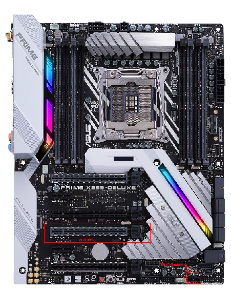

7.) Now switch off your rig and start with the installation of our Thunderbolt 3 Add-In PCIe Adapter
On the ASUS Prime X299 Deluxe, I recommend to install any Thunderbolt 3 Add-In PCIe Adapter in the 4th PCIe Slot from top, which is PCIEX_3, while on the ASUS WS X299 Sage 10G any Thunderbolt 3 Add-In PCIe Adapter must be in the second slot from top PCIEX_2 by default.
8.) Reboot into windows and install accompanying TB3 PCIe Drivers and Software.
9.) Reboot and enter the Mainboard BIOS (F2)
Go to /Advanced/ Thunderbolt(TM) Configuration/ and apply the following BIOS Settings detailed below:
TBT Root por Selector                               PCIE16_3 (Prime X299 Deluxe) / PCIE16_2 (WS X299 Sage 10G)

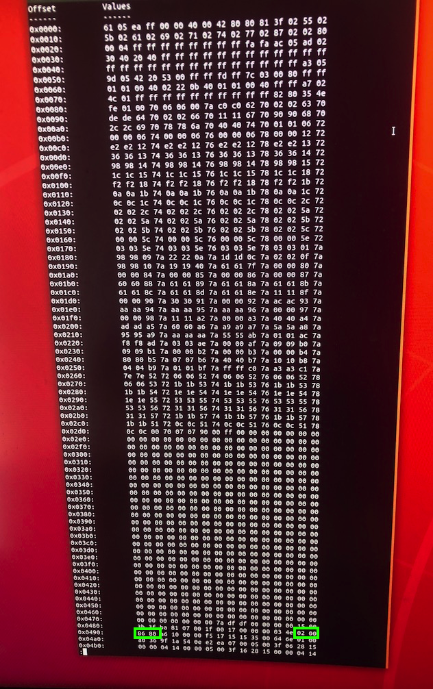

Thanks to some Ubuntu EEPROM modding, I also achieved the successful implementation of the Intel X540-T1 single port 10GB LAN PCIe Adapter by means of the Small-Tree 10GB macOS 10.13 driver.
Some additional notes to the EEPROM modding guideline provided by the above link.
1.) When creating your Ubuntu USB Flash Drive, use RUFUS 3.0 and select the GPT option to obtain a Ubuntu USB boot drive, fully compatible with your UEFI BIOS implementation!
2.) To install "net-tools", enter the following terminal command
sudo apt install net-tools
3.) To install "ethtool" enter the following terminal command:
sudo apt-get install ethtool

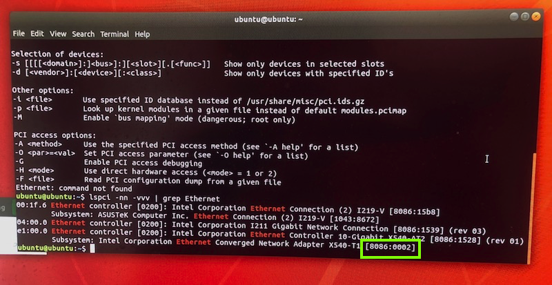

4.) Within the latest Ubuntu distributions, ETH0, ETH1, etc. have been replaced by some weird "enp" port-nomenclature, thus the command "ifconfig" would reveal something like the following:
My Intel X540-T1 was assigned to enp225s0.

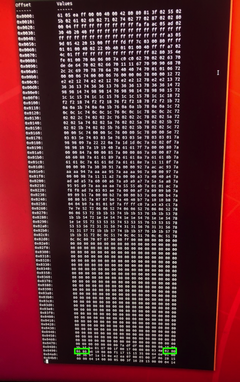

5.) With the command "lspci -nn -vvv | grep Ethernet" you have to use in 6.) the Vendor/Device-ID entry highlighted by the green rectangle.
6.) By running the "sudo ethtool -e enp225s0 | less" command and eyeballing the offsets, be aware that the latter can be distributed over two lines:
You have to count from left to right 0,1,2,3,4,5,6,7,8,9,a,b,c,d,e,f for each pair of digits for each offset.
Thus, the commands I had to run to mod the Intel X540-T1 EEPROM were:
sudo ethtool -E enp225s0 magic 0x15288086 offset 0x48e value 0x0a
sudo ethtool -E enp225s0 magic 0x15288086 offset 0x48f value 0x00
Note that the "magic" value implemented in this command has been taken from the "lspci -nn -vvv | grep Ethernet" command output, again encircled by a green rectangle:
The rest is as described in the EEPROM modding guideline linked above.

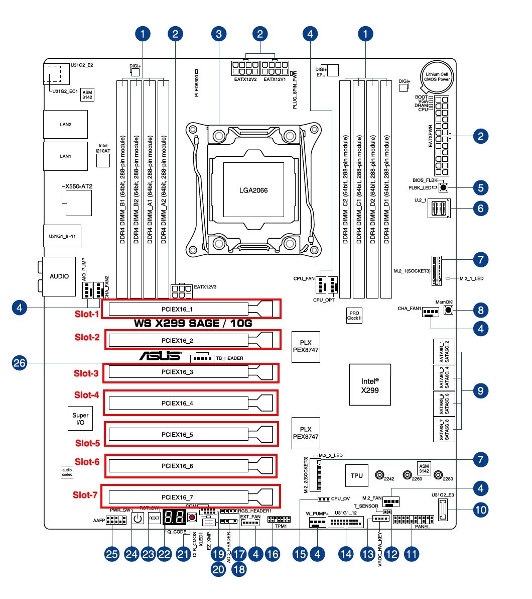

E.9) ASUS Prime X299 Deluxe / WS X299 Sage 10G PCI Device Implementation
In order to properly implement all PCI device drivers on his/her system and build, one needs adequate ACPI DSDT Replacements and a sophisticated system SSDTs. Both requirements have been originally successfully implemented for the ASUS Prime X299 Deluxe by our gorgeous @apfelnico. Many thanks for the extensive efforts and extremely fruitful and brilliant work! Subsequently, I adopted the ACPI DSDT Replacements and system SSDTs in concordance with SMBIOS iMacPro1,1. Some ACPI DSDT Replacements are still part of the config.plist contained in my actual respective X299 EFI-Folder distribution. Others are part of my System SSDTs provided in my X299-System-SSDTs Github repository.
Note that the ACPI DSDT Replacements in config.plist and System SSDTs are build and PCIe slot population dependent and have to be verified and adopted or modified for all mainboards different from the ASUS Prime X299 Deluxe and builds or PCIe slot populations different from the one that constitutes the baseline of this guide.
For the ASUS Prime X299 Deluxe and ASUS WS X299 Sage 10G I will use in the following the PCIe Slot nomenclature depicted below:
ASUSPrimeX299Deluxe-PCI-Slot-Nomenclature.thumb.png.9c67e3562cea6d9f90cdaf83e3b77e87.png
ASUS WS X299 Sage 10G:
2111941963_Screenshot2019-03-21at14_20_56.thumb.jpg.6ccd90af07810fec4f85026036f76460.jpg
The verification and likely adaptation/modification can be performed by the help of IORegistryExplorer.
How to adopted or modify the ACPI DSDT Replacement Patches and System SSDT implementations is detailed within this short guideline by means of the OSXWIFI PCIe Adaptor implementation in PCIe Slot-3. I hope that by this specific example it rapidly becomes evident that the correct PCI Device implementation cannot be outlined for each individual "build-in" or "slot-specific" PCI device within this guide. The complexity and effort would just exceed by far all available capacities and indeed require the implementation of a separate guide and thread in addition. I therefore hope on your skills and flexibility to extend and apply the approach and methodology detailed above to any other "build-in" or "slot-specific" PCI device yet to be adopted or implemented
Important Note: It is strongly recommend to perform a stepwise SSDT PCI Device implementation, starting with one single specific PCI device. Once this PCI device has been successfully implemented, another SSDT PCI Device module can be added and verified. In case that the implementation of a specific PCI Device would be erroneous and fail, it would simply disappear from Section "PCI" of Apple's System report. To facilitate the stepwise PCI device implementation, the former SSDT-X299-iMacPro.aml has been split into separated modules now forming part of my X299-System-SSDTs Github repository.
Also keep always in mind to modify/adopt the ACPI replacements in your config.plist in parallel when ever necessary!
Note once more that the ACPI DSDT Replacements in config.plist and System SSDTs require SMBIOS iMacPro1,1.

h.) The 56 CPxx -> PRxx replacements are i9-7980XE specific and result in a proper CPU core reordering as well as in a iMac Pro specific CPU core variable naming.
All i9-7980XE users can now enable all 56 CPxx -> PRxx replacements. All users of CPUs different from the i9-7980XE have to adopt/modify the 56 CPxx -> PRxx replacements in concordance with their original IOREG CPU core values.
Comment:             Find*[Hex]        Replace [Hex]

Resulting CPU Core Implementation:

For the proper PCI device driver implementation (detailed in the figure above), within my X299-System-SSDTs Github repository one finds two sets of system SSDTs for the ASUS Prime X299 Deluxe and the ASUS WS X299 Sage 10Grespectively, which partly need to be modified/adapted/extended, depending on the user specific motherboard, device or PCIe Slot population/configuration. How to adopted or modify ACPI path, ACPI replacements and respective SSDT Device definitions is detailed within this short guideline by means of the OSXWIFI PCIe Adaptor implementation in PCIe Slot-3 of the ASUS Prime X299 Deluxe. Further note, that any PCIe devices in respective PCIe slots on e.g. the ASUS WS X299 Sage 10G, sharing the same PCI device on different PCI bridges, like PC02.BR2A.SL05 in case of the ANS1 NVME controller in Slot-1 (PCI bridge @10) and in case of the ARPT OSXWIFI Broadcom BCM94360CD BT/WIFI PCIe Adapter in Slot-3 (PCI bridge @08), need to be implemented in the same system SSDT, like in case of SSDT-X299-Slot1-Slot3-PC02-BR2A-SL05-ANS-ARPT.aml for the ASUS WS X299 Sage 10G.
Note that each SSDT contains a DefinitionBlock entry and the underlying PCI device implementation. In case of necessary modifications/adaptations, don't forget to also modify/adapt the respective DefinitionBlock entries in concordance with your IOREG entries. The entire SSDT structure is now completely module like. Each module can be independently added, changed or removed in dependence of your specific build, needs and requirements. A stepwise implementation of the individual PCI device modules is highly recommended!

E.9.2.3) - PMCR - onboard Power Management Controller (PMC) PCI Implementation:
The SSDT-X299-PMCR.aml onboard Power Management PMCR PCI device implementation should be valid for all X299 mainboards and should not require any build specific adaptation/modification. Note the PMC1 -> PMCR ACPI replacement directly performed within the SDDT.
E.9.2.4) - USBX:
When using the XHCI device name for USB (see the XHCI PCI Device Implementation below), one observes a bunch of USB Power Errors when booting the system. The SSDT-X299-USBX.aml PCI device implementation fixes this errors.
E.9.2.5) - XHCI - onboard Extended Host Controller Interface (XHCI) PCI Implementation:
The SSDT-X299-XHCI.aml USB3.0 ASMedia ASM1074 / Intel X299 Series Chipset XHCI PCI device implementation is valid for the ASUS Prime X299 Deluxe / ASUS WS X299 Sage 10G and for all other X299 mainboards with the same XHC controller chipset. Verify and adopt/modify if necessary device path "PCI0.XHCI" and XHCI PCI device implementation by means of IOREG.
E.9.2.6) - XHC2,3,4 - ASMedia ASM3142 USB 3.1 Controller PCI Implementation:
The SSDT-X299-XHC.aml onboard ASMedia ASM3142/ASM1543 USB 3.1 XHC2,XHC3,XHC4 controller PCI device implementation is valid for the ASUS Prime X299 Deluxe and for all other X299 mainboards with the same XHC USB3.1 controller ASMedia ASM3142 chipset configuration. Note the following ACPI Replacements
PCI0.RP01.PXSX -> PCI0.RP01.XHC2
PCI0.RP05.PXSX -> PCI0.RP01.XHC3
PCI0.RP07.PXSX -> PCI0.RP01.XHC4
within the SSDT in concordance with the respective SMBIOS iMacPro1,1 variable naming. Verify and adopt/modify if necessary the corresponding "PCI0.RP01.XHC2", "PCI0.RP05.XHC3", "PCI0.RP07.XHC4" PCI device implementations by means of IOREG.
Note that there is a separate SSDT-X299-XHC.aml device implementation for the ASMedia ASM3142 USB3.1 XHC1 and XHC2 controllers on the ASUS WS X299 Sage 10G in the ASUS WS X299 Sage 10G subdirectory of the X299 SSDT Github repository.
E.9.2.7) ANS1, ANS2 - Apple NVMe Controller PCI Implementation:
The SSDT-X299-ANS.aml Apple NVMe Controller ANS1 and ANS2 PCI implementations are of purely cosmetic nature and are valid for the ASUS Prime X299 Deluxe. Note the following ACPI Replacements
PCI0.RP09.PXSX -> PCI0.RP09.ANS1
PCI0.RP21.PXSX -> PCI0.RP21.ANS2
performed within the SDDT in concordance with the respective SMBIOS iMacPro1,1 variable naming.
Verify and adopt/modify if necessary the "PCI0.RP09.ANS1" and "PCI0.RP21.ANS2" PCI device implementations by means of IOREG.
Note that there is a separate SSDT-X299-ANS.aml device implementation for the ASUS WS X299 Sage 10G in the ASUS WS X299 Sage 10G subdirectory of the X299 SSDT Github repository.
E.9.2.8) - SAT1 - Intel AHCI SATA Controller PCI Implementation:
The SSDT-X299-SAT1.aml onboard Intel AHCI SATA controller PCI device implementation is valid for the ASUS Prime X299 Deluxe / ASUS WS X299 Sage 10G and for all other X299 mainboards with the same AHCI SATA controller chipset. Verify and adopt/modify if necessary device path "PCI0.SAT1" and PCI device implementations by means of IOREG.
E.9.2.9) - THSS - Intel Thermal Subsystem Controller Implementation:
The SSDT-X299-THSS.aml onboard Intel X299 Series Thermal Subsystem controller PCI device implementation, recently provided by @apfelnico is valid for the ASUS Prime X299 Deluxe / ASUS WS X299 Sage 10G and for all other ASUS X299 mainboards with the same Thermal Subsystem controller chipset.
E.9.2.10) XGBE - 10GBit NIC Implementation:
SSDT-X299-ACQU.aml, SSDT-X299-X540-T1.aml and SSDT-X299-P2EI0G-2T.aml perform a XGBE (XGBF) PCI implementation of an Acquantia AQC107-AFW, Intel X540-T1 and Small-Tree P2EI0G-2T 10GB NIC, respectively and are mainly of cosmetic nature. For each PCIe Adapter and for different PCIe slot populations or mainboard implementations, the XGBE PCI device implementation needs to be adopted/modified accordingly. This also states for the respective ACPI path entries "PC03", "BR3A" and respective SL09 -> PEGP and PEGP -> XGBE ACPI Replacements (in compliance with the iMac Pro 10GB ACPI variable nomenclature), directly performed within each SSDT.
Note that there is a separate XGBE/XGBF PCI device implementation SSDT-X299-ETH.aml available for the 2x Intel X550-AT2 10GB onboard NICs of the ASUS WS X299 Sage 10G, which one finds in the ASUS WS X299 Sage 10G subdirectory of the X299 SSDT Github repository.
E.9.2.11) - ETH0/ETH1 - onboard LAN Controller PCI Implementation:
Note that the SSDT-X299-ETH.aml Intel I219V2 PCI Express Gigabit Ethernet and Intel I211VA PCI Express Gigabit Ethernet onboard LAN controller ETH0/ETH1 PCI implementations are of pure cosmetic nature and only valid for ASUS Prime X299 Deluxe or X299 mainboards with the same LAN Controller configuration. Owners of different X299 mainboards have to verify and adopt/modify if necessary the device these PCI device implementations by means of IOREG. Note the PCI0.GBE1 -> PCI0.ETH0, PCI0.RP02.D0A4 -> PCI0.RP02.PXSX and PCI0.RP02.PXSX -> PCI0.RP02.ETH1 ACPI replacements directly performed within the SSDT.
Note that there are no onboard 1GB hardware implementations on the ASUS WS X299 Sage 10G, thus E.9.2.11 can be skipped entirely by all users of the latter motherboard.
E.9.2.12) - ARPT - OSX WIFI Broadcom BCM94360CD 802.11 a/b/g/n/ac + Bluetooth 4.0 AirPort Controller PCI Implementation:
The SSDT-X299-ARPT.aml OSX WIFI Broadcom BCM94360CD 802.11 a/b/g/n/ac + Bluetooth 4.0 AirPort Controller PCI device implementation is of pure cosmetic nature and only valid for users of the latter WIFI/Bluetooth PCIe Adapter in PCIe Slot 3 of the ASUS Prime X299 Deluxe. Users of this PCIe Adapter within a PCIe slot population different from PCIe Slot 3 or on a mainboard different form the ASUS Prime X299 Deluxe have to likely adapt/modify the respective device path "PC03","BR3D","ARPT" and likely also the respective ACPI Replacements PC03.BR3D.SL0C -> PC03.BR3D.PEGP and PC03.BR3D.PEGP -> PC03.BR3D.ARPT, directly performed within the SSDT. Users of the Asus Prime X299 Deluxe onboard Bluetooth chipset controller or with a completely different WIFI/Bluetooth configuration have to adopt the entire Airport PCI implementation by means of IOREG.
On the ASUS WS X299 Sage 10G, the ANS2 NVME controller in Slot-1 (PCI bridge @10) and the ARPT OSXWIFI Broadcom BCM94360CD BT/WIFI PCIe Adapter in Slot-3 (PCI bridge @08) share the same PCI device on different PCI bridges and therefore need to be implemented within the same system SSDT, namely SSDT-X299-Slot1-Slot3-PC02-BR2A-SL05-ANS-ARPT.aml, which one finds in the ASUS WS X299 Sage 10G subdirectory of the X299 SSDT Github repository.

E.12) iStatMenus Hardware Monitoring
Thanks to extended tweet session between @BJango, @gxsolace and myself, it seems that we achieved a major step forward in properly monitoring Skylake-X/X299 Hardware with iStatMenus. iStatMenus now correctly interfaces with the HWSensor and FakeSMC kext distribution provided by @interferenc.
The actual iStatMenus v6.2 distribution can be assessed at https://bjango.com/mac/istatmenus/
The actual HWSensor and FakeSMC kext distribution of @interferenc can be assessed at https://github.com/interferenc/HWSensors
To compile the the HWSensor and FakeSMC kexts of @interferenc, perform the individual steps detailed below:
1.)
git clone https://github.com/interferenc/HWSensors
2.)
cp HWSensors ~/Desktop/
3.)
cd ~/Desktop/HWSensors
4.)
xcodebuild -project Versioning\ And\ Distribution.xcodeproj/
5.)
xcodebuild -project HWMonitor.xcodeproj/
6.)
xcodebuild -project HWSensors.xcodeproj -alltargets
Subsequently, one finds the all compiled binaries in ~/Desktop/HWSensors/Binaries/.
Many thanks to both @interferenc and @Bjango for their awesome and extensive contributions and brilliant work!
Note that I recently modified the Kozlek/Interferenc Source Code distribution locally to also support GPU Temp sensor information for all Vegas and the new Radeon VII. In my recent 10.14 X299 EFI-Folder distributions, the resulting FakeSMC.kext and HWSensor.kexts supporting all Vegas already have been implemented by default in /EFI/CLOVER/kexts/Other. The actual 10.14.5 Beta X299 EFI-Folder distribution contains FakeSMC.kext and HWSensor.kexts also supporting the new Radeon VII.

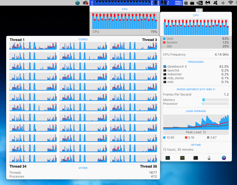

Skylake-X/X299 iStatMenus Hardware Sensor Data:
Skylake-X CPU Thread Utilisation Graphs:
To change from CPU core to thread utilisation monitoring, uncheck "Hide Hyper-Threading cores" in Section "CPU & GPU" of iStatMenus Preferences.
Temperature unites can be adjusted between Celsius, Fahrenheit and Kelvin in Section "Sensors" of iStatMenus Preferences.
F.) Benchmarking

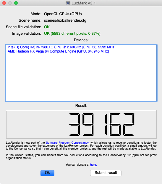

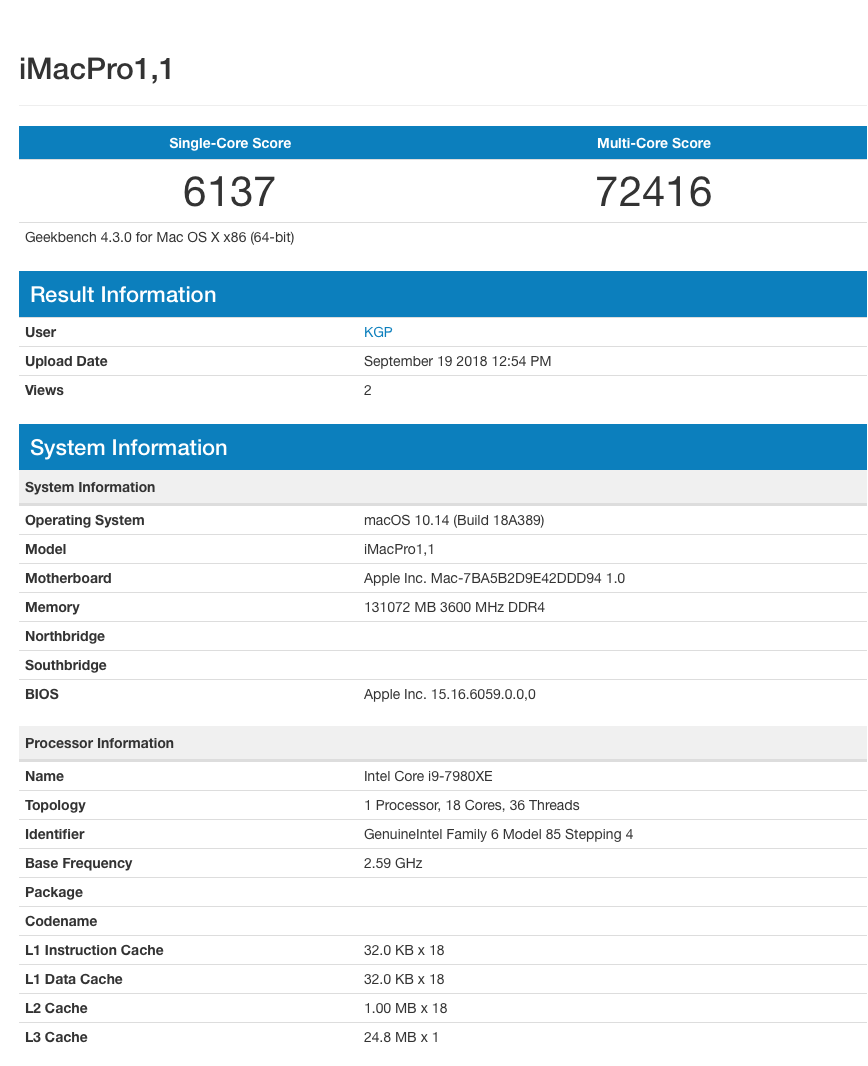

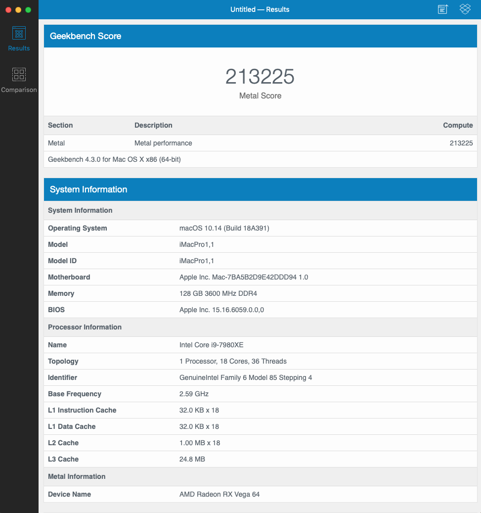

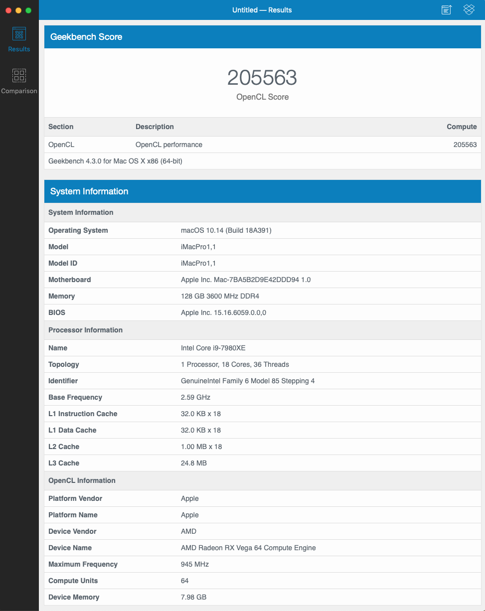

F.1) Sylake-X Intel I9-7980XE (4.7GHz) CPU Benchmarking
Jesus :drool:
F.2) Sapphire Nitro+ RX Vega 64 8GB

Loloflat6_X299_iMacPro.thumb.png.3306c78e70d6907e80bada370364f263.pngI have managed intall MacOs Mojave beta dp1 on a HDD HFSJ+ patition : works perfectly :)
( i have installed before MacOs Mojave in another system with Mojave MBR HFS Firmware Check Patch 10.14.db1 , i did a dmg image from the partition an restorered this dmg image on my X299 system  :happymac: )
Some restrictions :
- Sleep / wake issue
- Whatevergreen.kext is needed
The great point TB3 with SSDT-X299-TB3-iMacPro-Gigabyte is fully working hot plug with USB_C for my screen.
Edited by Loloflat6
