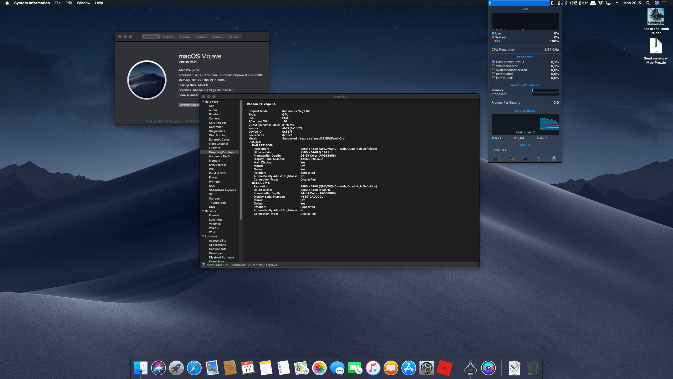

@KGP-iMacPro, amazing work you have here
Today my Radeon RX Vega 64 has arrived, after I uninstalled Nvidia Webdriver then replaced my GTX1080Ti to RX Vega 64, and boom lol ...it works flawlessly, my dual monitor setup work out of the box, I don't do anything, just plug and play, not plug and Pray :D
Thank you
well, after couple of minutes playing my Mojave Desktop with new RX Vega 64 always freeze/stuck/halt for no reason at all, I have try to use with/without -lilubetaall but still no effect
and become worse, everytime I reboot and freeze just after a couple of second entering the desktop, I try to reboot, and keep fail, fail and fail.
then I found a thread about Vega FE , so it looks like I have try to play about table power or something, so patched/edited AMD10000Controller.kext and now seems like working fine
been playing and fooling around almost 6 hours and no crash or freeze now
maybe any other tips beside to edit AMD10000Controller.kext?
this is my working kext (at least for me), testing using LuxMark, Rise of the tomb raider and Fortnite, no lag, no freeze and no crash...hope will be "fixed" by apple with the final Mojave
AMD10000Controller.kext.zip
