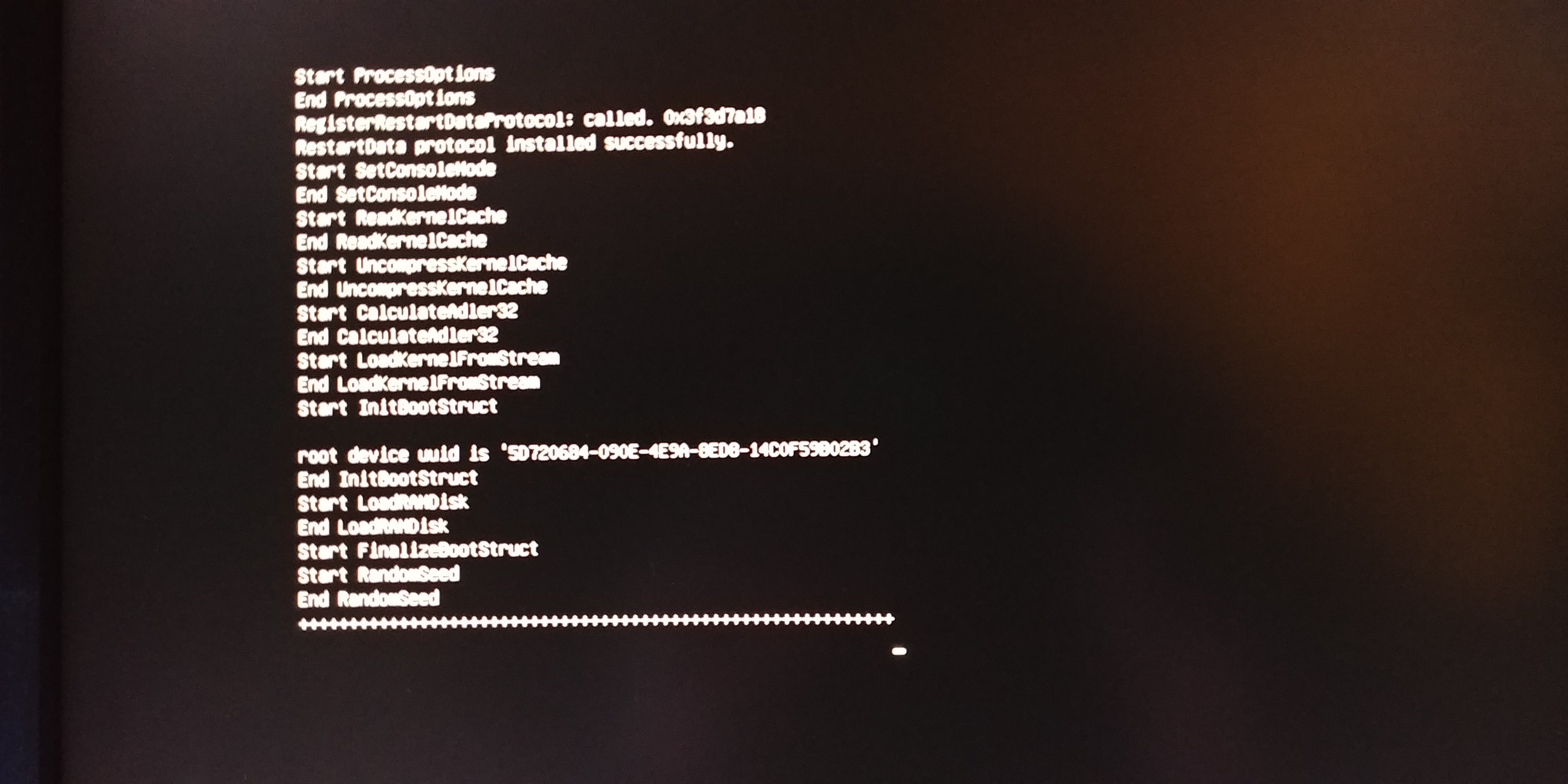

tio121 Posted December 25, 2018 Share Posted December 25, 2018 9 hours ago, vladie said: Hi Trying to run your config on i7-9800x, asus prime x299-a, rx vega 64. Kernel starts to boot (from USB stick) and i see first screenshot for near 60 seconds, and then i see second screenshot (if i will wait more i see message 'still waiting for root device') TSCAdjustReset was adopted. UPDATE: seems that are only one USB port are seen by os x (i can insert usb stick into this port and boot installer). Tried kext-s from XHC-USB-Kext-Library, but no luck Keyboard/mouse not working, so i can't install macos in order to create working XHC-USB-Kext config with IoRegistryExplorer. I've also tried to boot high sierra installer (with usb port count patch enabled) - but result the same - no keyboard/mouse. Hey can you share your EFI Folder? I’m trying to get this running on the same setup as you but I can’t even get that far. Link to comment https://www.insanelymac.com/forum/topic/334343-imac-pro-x299-live-the-future-new-with-macos-1014-mojave-successful-buildsuccessful-guide/page/4/#findComment-2655580 Share on other sites More sharing options...
vladie Posted December 26, 2018 Share Posted December 26, 2018 (edited) 11 hours ago, Napka said: @Vladie I had similar problems with latest BIOS v1602. Reverted to 1503 and everything’s good again. My CPU i7-9800x is supported since v1602. But i will try to revert, thanks. UPDATE: unfortunately, downgrading to v1503 have no effect. will try to buy usb hub today (i have one working usb port), connect usb flash+keyboard+mouse to it and install mac os. Edited December 26, 2018 by vladie Link to comment https://www.insanelymac.com/forum/topic/334343-imac-pro-x299-live-the-future-new-with-macos-1014-mojave-successful-buildsuccessful-guide/page/4/#findComment-2655612 Share on other sites More sharing options...

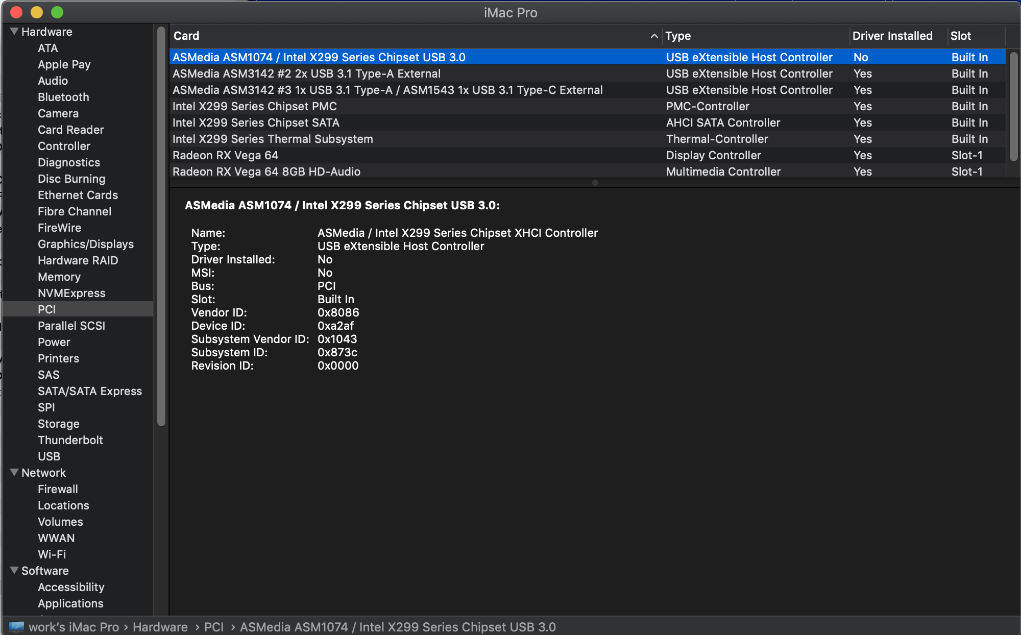

vladie Posted December 26, 2018 Share Posted December 26, 2018 (edited) I've successfully installed mojave on asus x299-a prime + i7-9800x, using usb hub on single working usb port. Mojave didn't want to work with Asmedia 2142 ports, currently i have no idea how to make them active. Tried USBInjectAll+XHCI-unsupported, but no luck. Intel ports (except single working) also didn't work, but i see two USB 3.1 Bus intel controllers into USB device tree. Edited December 26, 2018 by vladie Link to comment https://www.insanelymac.com/forum/topic/334343-imac-pro-x299-live-the-future-new-with-macos-1014-mojave-successful-buildsuccessful-guide/page/4/#findComment-2655759 Share on other sites More sharing options...
tio121 Posted December 26, 2018 Share Posted December 26, 2018 30 minutes ago, vladie said: I've successfully installed mojave on asus x299-a prime + i7-9800x, using usb hub on single working usb port. Mojave didn't want to work with Asmedia 2142 ports, currently i have no idea how to make them active. Tried USBInjectAll+XHCI-unsupported, but no luck. Intel ports (except single working) also didn't work, but i see two USB 3.1 Bus intel controllers into USB device tree. Can you post your EFI folder? Link to comment https://www.insanelymac.com/forum/topic/334343-imac-pro-x299-live-the-future-new-with-macos-1014-mojave-successful-buildsuccessful-guide/page/4/#findComment-2655773 Share on other sites More sharing options...
vladie Posted December 26, 2018 Share Posted December 26, 2018 36 minutes ago, tio121 said: Can you post your EFI folder? it's just a efi folder from KGP github repository. you need to use usb hub, inserted into cyan usb connector (it's located above single usb-c connector), for connecting usb installer flash, keyboard and mouse. Link to comment https://www.insanelymac.com/forum/topic/334343-imac-pro-x299-live-the-future-new-with-macos-1014-mojave-successful-buildsuccessful-guide/page/4/#findComment-2655792 Share on other sites More sharing options...

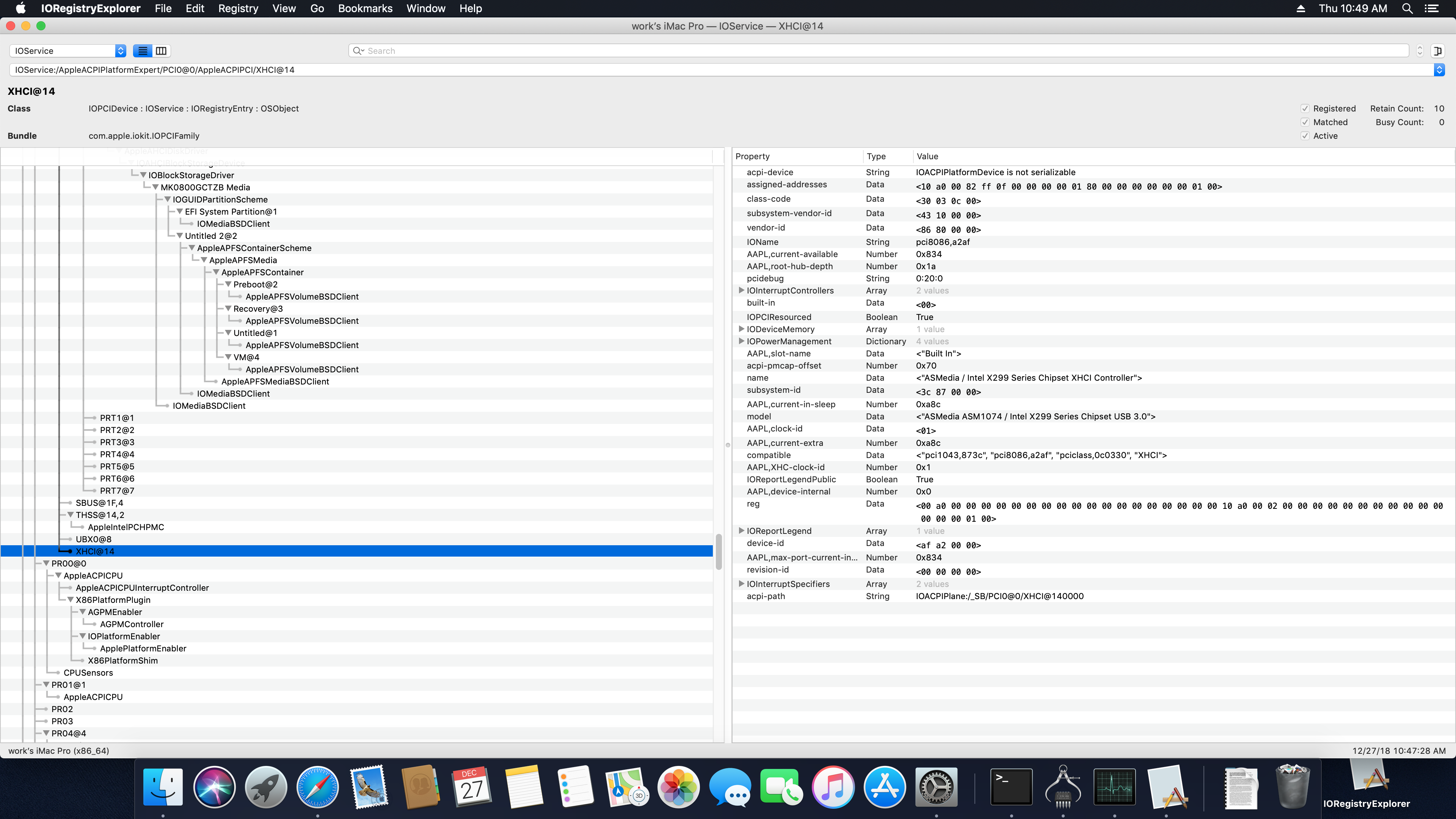

vladie Posted December 27, 2018 Share Posted December 27, 2018 It's quite strange, but Asmedia ASM1074 driver is not loaded. I've installed KGP's ACPI patches (seems that they are matched X299-A prime, i've checked USB definitions), but this doesn't help. Is anyone know how to force this driver loading? Link to comment https://www.insanelymac.com/forum/topic/334343-imac-pro-x299-live-the-future-new-with-macos-1014-mojave-successful-buildsuccessful-guide/page/4/#findComment-2655864 Share on other sites More sharing options...

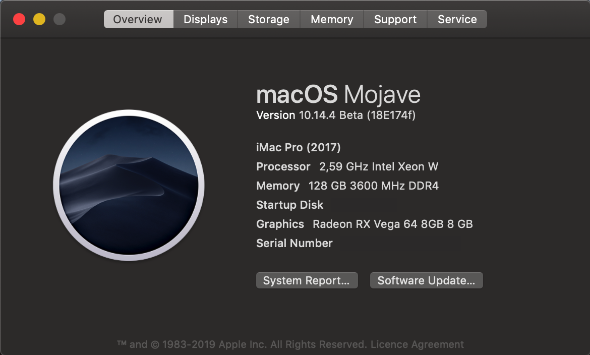

kgp Posted January 25, 2019 Author Share Posted January 25, 2019 macOS Mojave 10.14.4 beta1 (18E174f) Important Note: to properly load respective kexts under 10.14.4 beta1 during boot, Clover_v2.4k_r4862 is deemed necessary. @Slice recently committed respective modifications of kext_inject.c introduced by @PMheart . Enjoy and have fun, Link to comment https://www.insanelymac.com/forum/topic/334343-imac-pro-x299-live-the-future-new-with-macos-1014-mojave-successful-buildsuccessful-guide/page/4/#findComment-2661226 Share on other sites More sharing options...

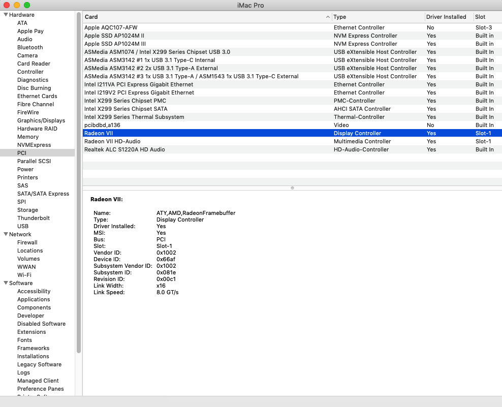

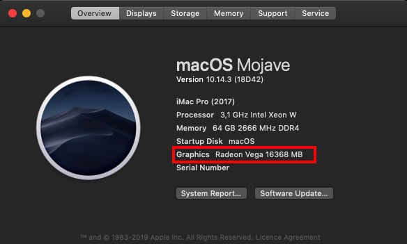

kgp Posted February 8, 2019 Author Share Posted February 8, 2019 (edited) First steps with a Sapphire Radeon VII under macOS 10.14.3 (18D42) and 10.14.3 SU (18D109) Today, I encountered a unique opportunity to perform some dirty first steps and tests with a Sapphire Radeon VII under macOS 10.14.3 (18D42) and macOS 10.14.3 SU (18D109) on a friend's system here in Berlin. 1.) The first disappointing discovery independent from macOS was that this GPU for now apparently seems not compatible with UEFI. The BIOS enforced "CSM" by default otherwise the ASUS Prime X299 Deluxe system would not have booted at all. 2.) Once under macOS 10.14.3, the Radeon VII was rather recognised by macOS like a Vega Frontier at first place, with only one DP1.4 port actually natively working. 3.) After applying just some cosmetics to SSDT-X299-Vega64.aml and implementing the latter in line with Whatevergreen.kext, the Radeon VII appeared under "About this Mac" such: Thanks to SSDT-X299-Radeon-VII.aml (which is basically SSDT-X299-Vega64.aml), Radeon VII and Radeon VII HD-Audio PCI drivers also correctly popped-up in Section "PCI" of Apple's system Report as properly implemented and fully loaded: In combination with Whatevergreen.kext, the three DP1.4 ports and the single HDMI port of the Sapphire Radeon VII also have been properly implemented in form of just four Radeon frame buffers + the respective HDAU device. All four ports were fully functional, including display HotPlug and multi-monitor support. Also sleep/wake worked absolutely flawless. The UI worked fluid without an issues or lag and also video playback fully worked as expected. Now the bad news at least for macOS 10.14.3 (18D42) and macOS 10.14.3 SU (18D109):All benchmark tools available, i.e. Cinebench OpenGL, Geekbench OpenGL and Metal, LuXMark OpenGL or Heaven and Valley were not able to find any GPU supporting OpenGL or Metal. Thus, unfortunately under the above mentioned macOS versions, the Radeon VII seems yet not to support OpenGL or Metal so far.Thought that this recent findings also might be interesting for others .. Edited February 11, 2019 by KGP-iMacPro 1 2 Link to comment https://www.insanelymac.com/forum/topic/334343-imac-pro-x299-live-the-future-new-with-macos-1014-mojave-successful-buildsuccessful-guide/page/4/#findComment-2663270 Share on other sites More sharing options...

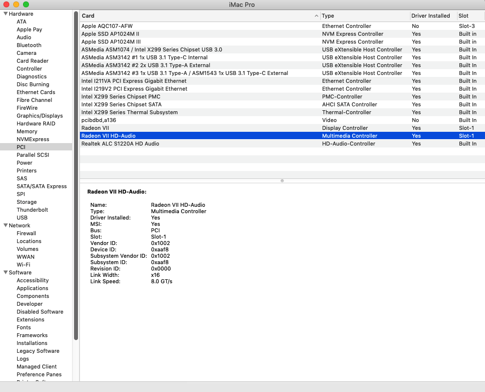

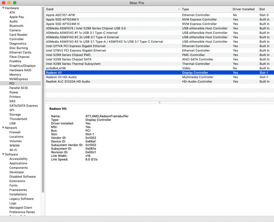

kgp Posted February 11, 2019 Author Share Posted February 11, 2019 Sapphire Radeon VII now fully UEFI compatible! At first place I should highlight some important correction. My first tests and results concerning the Radeon VII did not base on a MSI but Sapphire Radeon VII. I simply confused the brand my friend employed on his system. I therefore already correct my initial lapsus in my former post above up to my best knowledge.. This morning, @DSM2 pointed me to some approach recently discussed in the German Hackintosh forum: @Mork vom Ork recently provided a link for a windows tool developed by ASRock, which implements a hybrid firmware on the ASRock Radeon VII. Unfortunately, ASRX7_16G190201.exe did not work in my case with the Sapphire Radeon VII. However, @CMMChris extracted the VBIOS from ASRX7_16G190201.exe by means of a hex editor and provided the resulting BIOS ROM radeon-vii-uefi.rom in his respective post in the German Hackintosh Forum. After saving the original Firware of the Sapphire Radeon VII with Winflash.exe (admin permissions) of AMD/ATI ATIFlash 2.84 under Windows 10, I subsequently flashed the Sapphire Radeon VII with radeon-vii-uefi.rom without any issues.Subsequently I disabled CSM in the BIOS of my ASUS Prime X299 Deluxe and successfully booted my system with the Sapphire Radeon VII and new ASRock hybrid firmware..Legacy only problem of Radeon VII fully removed! I guess that the latter approach should work for any Radeon VII.Enjoy and have fun, 2 Link to comment https://www.insanelymac.com/forum/topic/334343-imac-pro-x299-live-the-future-new-with-macos-1014-mojave-successful-buildsuccessful-guide/page/4/#findComment-2663650 Share on other sites More sharing options...

kgp Posted February 13, 2019 Author Share Posted February 13, 2019 21 hours ago, Balamut said: Still having issues with OpenCL and Metal? The entire correct, native VII macOS implementation is still missing.. At present the VII is recognised and implemented Vega like, without hardware acceleration. 1 Link to comment https://www.insanelymac.com/forum/topic/334343-imac-pro-x299-live-the-future-new-with-macos-1014-mojave-successful-buildsuccessful-guide/page/4/#findComment-2663914 Share on other sites More sharing options...
