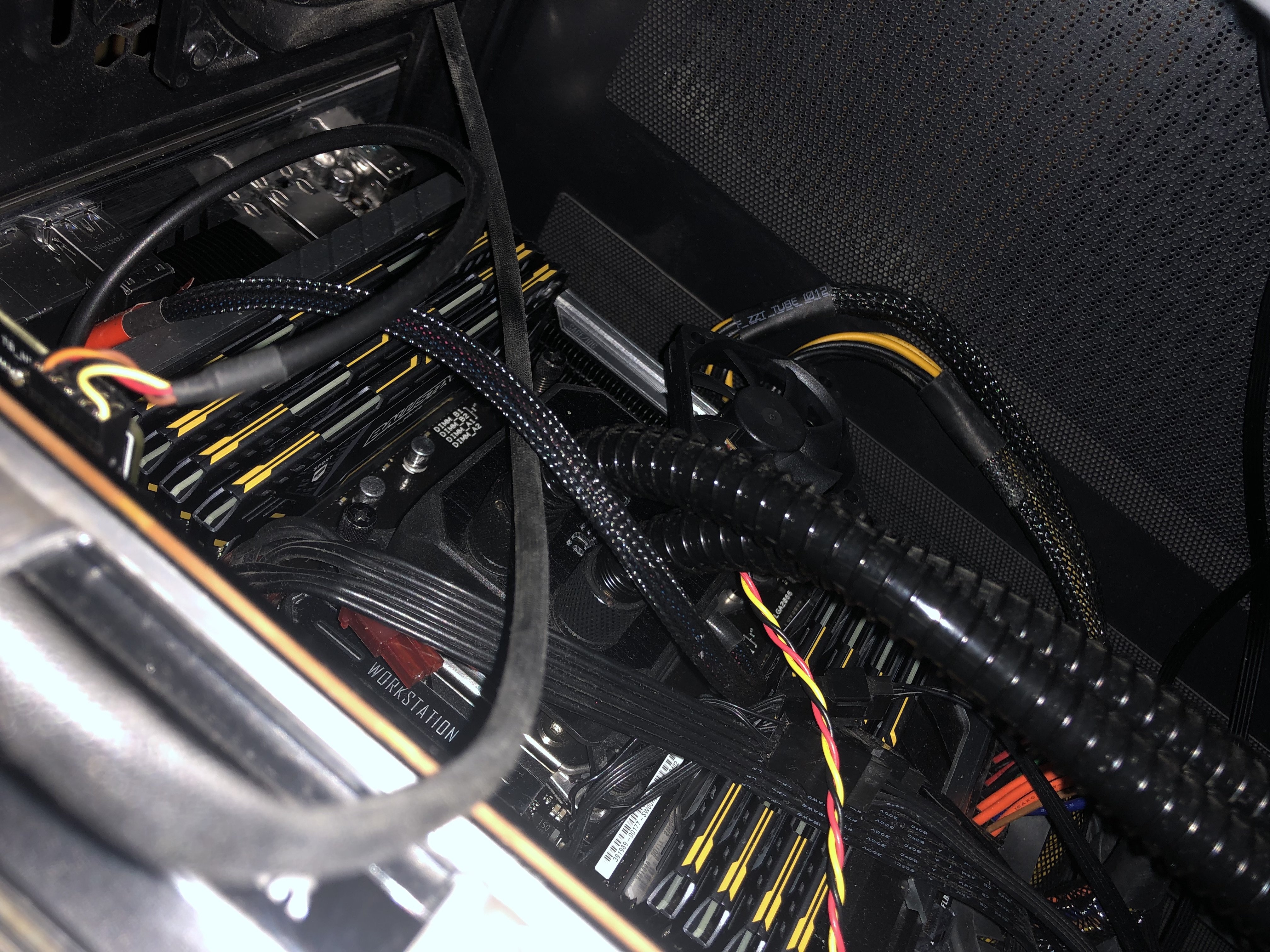

kgp Posted April 20, 2019 Author Share Posted April 20, 2019 (edited) On 4/19/2019 at 11:20 AM, fabiosun said: I am new with sage 10g configuration and I have had no particular problem in setting it in a basic way. I use to feed also that connector because system could benefit of it in case (as you say) of an extreme OC, but also if you populate more PCIEX slot (in my case some time with a spare GFX or thunderbolt EX card or PCIEX NVME card) In case I would feed it (if no extra power need it is also safe to have it connected) @fabiosun, I tried now to also use 3rd EATX connector as you recommended, but my system gets irresponsive after system boot and login under Windows and macOS with such configuration. Edited April 21, 2019 by KGP-iMacPro 1 Link to comment https://www.insanelymac.com/forum/topic/334343-imac-pro-x299-live-the-future-new-with-macos-1014-mojave-successful-buildsuccessful-guide/page/6/#findComment-2670821 Share on other sites More sharing options...
kgp Posted April 21, 2019 Author Share Posted April 21, 2019 3 hours ago, fabiosun said: Hi @KGP-iMacPro i am sorry for that but it is very weird this behaviour in your system and if you have some spare time you should have to investigate it many Asus motherboard have those spare connector in different form (molex,Eatx) and asus advice to connect them i have connected with a simple gfx pciex connector as one i use for my gfx (6 pin connector) i have no done any test without it In photo you can see a WS x299 Sage (no 10G) of a friend of mine he uses to full fill all pciex slot with different things happy holidays to you and all people here Yea.. was using a simple PCIEX cable too. Will further investigate the problems I faced with it. Thanks for your answer and happy holidays to you too! 1 Link to comment https://www.insanelymac.com/forum/topic/334343-imac-pro-x299-live-the-future-new-with-macos-1014-mojave-successful-buildsuccessful-guide/page/6/#findComment-2670846 Share on other sites More sharing options...

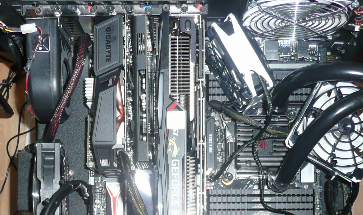

Guest Posted April 21, 2019 Share Posted April 21, 2019 (edited) This is system of mine. sorry for dust and cable management Slot 1 empty, in 2 ThunderboltEx 3 and in slot 3 my GFX OT Your Titan Ridge could work in different slot? have you installed in this rig? I am asking because I have a strange a not well documented " feature" using tb in that mandatory slot for Asus card Edited April 21, 2019 by Guest Link to comment https://www.insanelymac.com/forum/topic/334343-imac-pro-x299-live-the-future-new-with-macos-1014-mojave-successful-buildsuccessful-guide/page/6/#findComment-2670847 Share on other sites More sharing options...
kgp Posted April 21, 2019 Author Share Posted April 21, 2019 (edited) 12 minutes ago, fabiosun said: This is system of mine. sorry for dust and cable management Slot 1 empty, in 2 ThunderboltEx 3 and in slot 3 my GFX OT Your Titan Ridge could work in different slot? have you installed in this rig? I am asking because I have a strange a not well documented " feature" using tb in that mandatory slot for Asus card I have TTR in slot-2 from above as recommended by ASUS for the X299 Sage. As far I know, TB adapters just work in this slot assigned to PCH lanes. Also in BIOS TB settings it is the only option available. In slot-1, I use now a EK water blocked VII without problems, in slot-3, I have my OSX WIFI and in slot-5, I use a water blocked NVMe PCIe adapter for my EVO 970 Pro. Edited April 21, 2019 by KGP-iMacPro Link to comment https://www.insanelymac.com/forum/topic/334343-imac-pro-x299-live-the-future-new-with-macos-1014-mojave-successful-buildsuccessful-guide/page/6/#findComment-2670849 Share on other sites More sharing options...

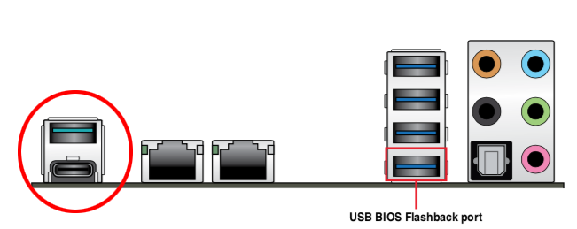

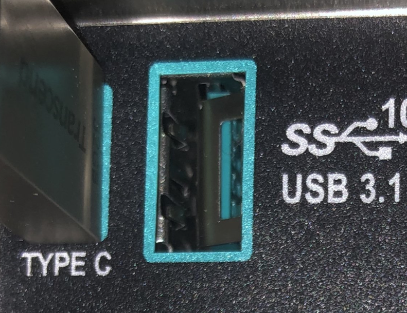

Guest Posted April 21, 2019 Share Posted April 21, 2019 7 minutes ago, KGP-iMacPro said: I have TTR in slot-2 from above as recommended by ASUS for the X299 Sage. As far I know, TB adapters just work in this slot assigned to PCH lanes. Also in BIOS TB settings it is the only option available. In slot-1, I use now a EK water blocked VII without problems, in slot-3, I have my OSX WIFI and in slot-5, I use a water blocked NVMe PCIe adapter for my EVO 970 Pro. In this TTR slot condition have you a working USB 3.1 as you can see in attachment? I can't find any documentation that with thunderbolt card inserted in slot 2 I loose 2 back USB port . It seems they are shared with slot 2 but I can't find any documentation (I have had same behavior in my previous X99 system so I define it a feature Obviously USB thunderbolt port are working well Link to comment https://www.insanelymac.com/forum/topic/334343-imac-pro-x299-live-the-future-new-with-macos-1014-mojave-successful-buildsuccessful-guide/page/6/#findComment-2670851 Share on other sites More sharing options...
kgp Posted April 21, 2019 Author Share Posted April 21, 2019 (edited) 20 minutes ago, fabiosun said: In this TTR slot condition have you a working USB 3.1 as you can see in attachment? I can't find any documentation that with thunderbolt card inserted in slot 2 I loose 2 back USB port . It seems they are shared with slot 2 but I can't find any documentation (I have had same behavior in my previous X99 system so I define it a feature Obviously USB thunderbolt port are working well That's weird and does not happen in my case. Just checked on that. SD1-T0500D is external Dell 500 MB Tunderbolt3 NVMe and Trident is USB 3.1 Type-C. All 4 back panel USB3.0 ports are working too. Just realised that I mounted the motherboard such that one of the silver contact plates for the USB3.1 Type-A connector accidentally blocks the latter, thus I cannot test it at present, but I am sure it would work too. Edited April 21, 2019 by KGP-iMacPro Link to comment https://www.insanelymac.com/forum/topic/334343-imac-pro-x299-live-the-future-new-with-macos-1014-mojave-successful-buildsuccessful-guide/page/6/#findComment-2670852 Share on other sites More sharing options...
Guest Posted April 21, 2019 Share Posted April 21, 2019 (edited) All 4 back panel USB3.0 are working well for me also..I have no working USB3.1 type a and C if TB card is inserted in slot 2 I have no working motherboard USB3.1 Gen1 type a and C I(left ethernet rj connector placed) Without TB card they are fine...Maybe Titan Ridge card has a better management..I don't know for now thank you for your confirmation Edited April 21, 2019 by Guest Link to comment https://www.insanelymac.com/forum/topic/334343-imac-pro-x299-live-the-future-new-with-macos-1014-mojave-successful-buildsuccessful-guide/page/6/#findComment-2670854 Share on other sites More sharing options...
kgp Posted April 21, 2019 Author Share Posted April 21, 2019 (edited) 12 minutes ago, fabiosun said: All 4 back panel USB3.0 are working well for me also..I have no working USB3. if TB card is inserted in slot 2 I have no working motherboard USB3.1 Gen1 type a and C I(left ethernet rj connector placed) Without TB card they are fine...Maybe Titan Ridge card has a better management..I don't know for now thank you for your confirmation Maybe some other PCIe slot I did not populate but you did is using PCIe lanes assigned to the two USB 3.1 back panel connectors? I don't think that the two USB 3.1 back panel connectors are using PCH lanes assigned to Slot-2, when using any x4 TB adapter in this latter slot. I would be also surprised if the else quite sophisticated PCIe/PCH lane management of the Sage would have conflicting lanes assigned twice to two respective devices. My problem is now how to get the silver contact plate actually blocking my USB3.1 Type-A connector in its place without removing everything incl. water blocking Edited April 21, 2019 by KGP-iMacPro Link to comment https://www.insanelymac.com/forum/topic/334343-imac-pro-x299-live-the-future-new-with-macos-1014-mojave-successful-buildsuccessful-guide/page/6/#findComment-2670856 Share on other sites More sharing options...

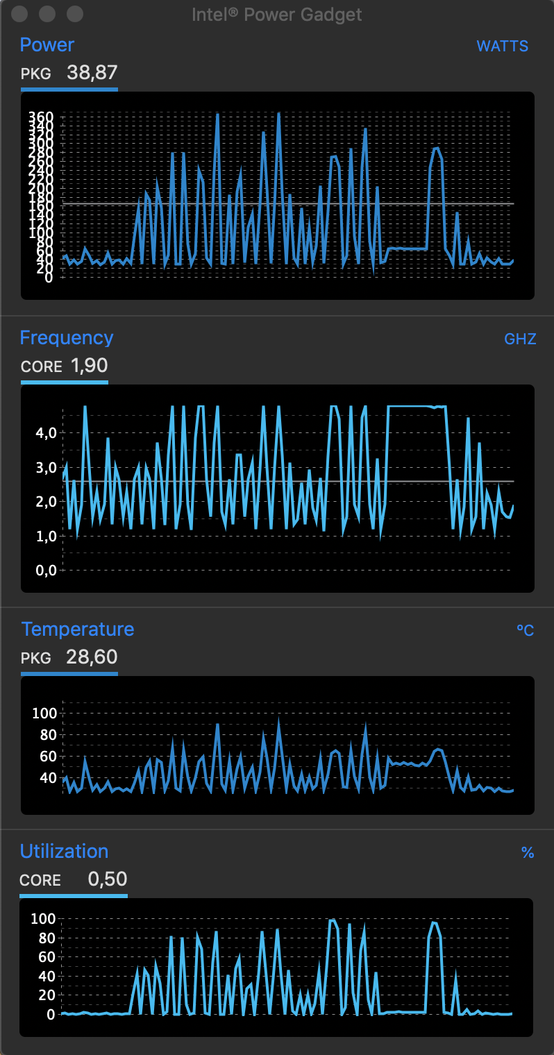

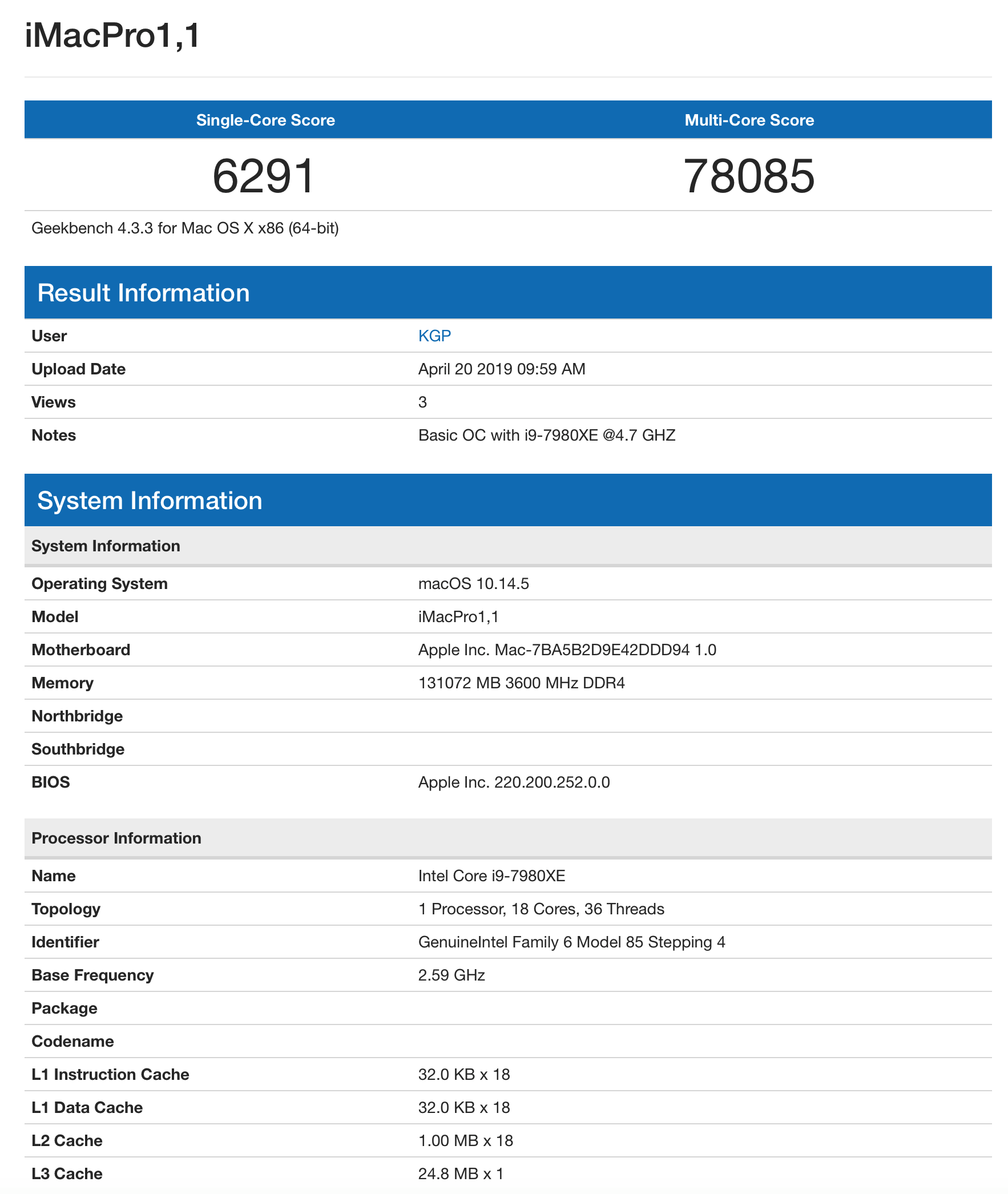

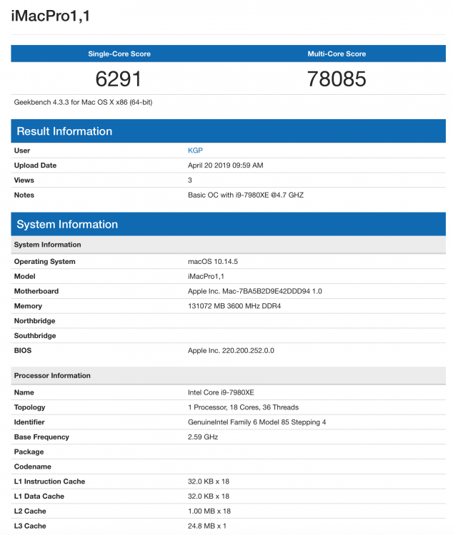

kgp Posted April 21, 2019 Author Share Posted April 21, 2019 (edited) BTW.. there is another Boost of approx. 6000 in Skylake-X Geekbench scores either related with 10.14.5 Public Betas or recent modifications within the latest Geekbench software distribution. And that's just with a turbo clock ratio of 47 and CPU core ratio set to Sync All Corse but everything else related to CPU OC just on Auto in BIOS and even SVID enabled. Nobody should mimic such benchmarks though without extensiv custom water blocking! Edited April 21, 2019 by KGP-iMacPro Link to comment https://www.insanelymac.com/forum/topic/334343-imac-pro-x299-live-the-future-new-with-macos-1014-mojave-successful-buildsuccessful-guide/page/6/#findComment-2670859 Share on other sites More sharing options...

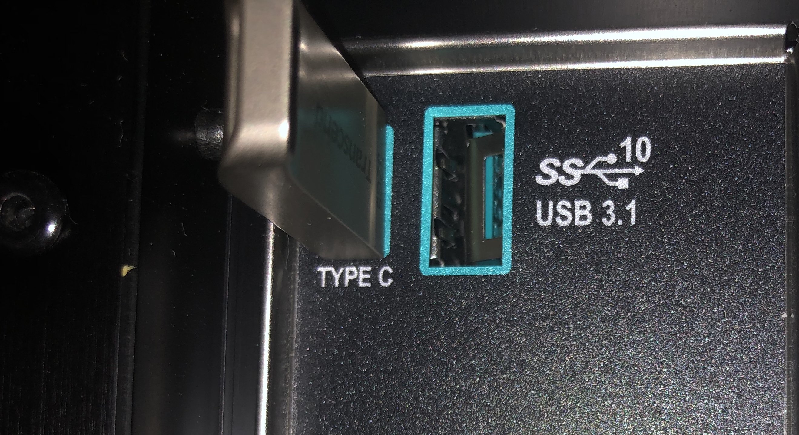

Guest Posted April 21, 2019 Share Posted April 21, 2019 @KGP-iMacPro I am happy you found the source of irresponsive system..and also very happy is not caused from my indication to connect 3rd EATX power connector Also I found the reason of my usb 3.1 problem..it was a combination of cable problem and mounting problem of my back plate...so now I have a full functionality of also those usb connection Very happy of this motherboard , it is more simple to configure respect my old Designare ex motherboard and I have a full working sleep / wake without doing anything of strange things..also it seems I can avoid the use of TSC kext in other I have a minor cosmetic problem because I am using a PCIEx card adapter for my nvme 960 pro, in it I have windows and OSX sees it with an orange icon , if I put it on a M2 connector it is grey as it should be. With old x299 designare ex I have not this "cosmetic" problem. Link to comment https://www.insanelymac.com/forum/topic/334343-imac-pro-x299-live-the-future-new-with-macos-1014-mojave-successful-buildsuccessful-guide/page/6/#findComment-2670897 Share on other sites More sharing options...
Guest Posted April 21, 2019 Share Posted April 21, 2019 if you have time also take a look at your image I reposted here metal on light blue is not good I think you can't insert there any usb peripheral because back plate metal is on connector this was part of my "mounting problem" Link to comment https://www.insanelymac.com/forum/topic/334343-imac-pro-x299-live-the-future-new-with-macos-1014-mojave-successful-buildsuccessful-guide/page/6/#findComment-2670899 Share on other sites More sharing options...
kgp Posted April 21, 2019 Author Share Posted April 21, 2019 44 minutes ago, fabiosun said: if you have time also take a look at your image I reposted here metal on light blue is not good I think you can't insert there any usb peripheral because back plate metal is on connector this was part of my "mounting problem" Yea.. that's what I said, I should remove everything and properly replug the motherboard, which however is a major endeavour because of my custom water blocking 1 hour ago, fabiosun said: @KGP-iMacPro I am happy you found the source of irresponsive system..and also very happy is not caused from my indication to connect 3rd EATX power connector Also I found the reason of my usb 3.1 problem..it was a combination of cable problem and mounting problem of my back plate...so now I have a full functionality of also those usb connection Very happy of this motherboard , it is more simple to configure respect my old Designare ex motherboard and I have a full working sleep / wake without doing anything of strange things..also it seems I can avoid the use of TSC kext in other I have a minor cosmetic problem because I am using a PCIEx card adapter for my nvme 960 pro, in it I have windows and OSX sees it with an orange icon , if I put it on a M2 connector it is grey as it should be. With old x299 designare ex I have not this "cosmetic" problem. Great that you removed all USB3.1 issues Interesting.. I never tried to boot without any TSC kext with this motherboard. I will see what happens in my case. Are you using SSDT for NVMe in PCIEx card adapter? Link to comment https://www.insanelymac.com/forum/topic/334343-imac-pro-x299-live-the-future-new-with-macos-1014-mojave-successful-buildsuccessful-guide/page/6/#findComment-2670904 Share on other sites More sharing options...

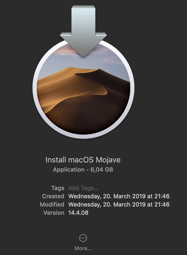

kgp Posted April 23, 2019 Author Share Posted April 23, 2019 (edited) New createInstaller.sh scripts for macOS Mojave 10.14.4 (18E226) and macOS Mojave 10.14.4 (18E2034) - special buildApple recently changed the index for macOS Mojave 10.14.4 (18E226) on http://swcdn.apple.com/, although resulting Install macOS Mojave.app version remains 14.4.08. I therefore expect the respective macOS Mojave 10.14.4 build still to be 18E226.Respective changes for macOS Mojave 10.14.4 (18E226) on http://swcdn.apple.com/ also required minor modifications of createInstall.sh for Mojave 10.14.4 (18E2034), which else also still reveals receptive Install macOS Mojave.app version 14.4.10. Corresponding Update of Section D.2) completed. New versions of createInstaller-10.14.4-23042019.sh.zip and createInstaller-10.14.4-SB-23042019.sh have been linked in the guide in the originating post of this thread. Enjoy and have fun, Edit: Update of createInstaller-10.14.4-SB-23042019.sh as I accidentally renamed and linked old file before. Edited April 23, 2019 by KGP-iMacPro Link to comment https://www.insanelymac.com/forum/topic/334343-imac-pro-x299-live-the-future-new-with-macos-1014-mojave-successful-buildsuccessful-guide/page/6/#findComment-2671095 Share on other sites More sharing options...
Tony Arnold Posted April 24, 2019 Share Posted April 24, 2019 On 4/22/2019 at 3:19 AM, KGP-iMacPro said: Yea.. that's what I said, I should remove everything and properly replug the motherboard, which however is a major endeavour because of my custom water blocking I made exactly the same mistake. Honestly, just gently bend the overlapping metal back out - it doesn't seem to make any difference to how the port actually works. 1 Link to comment https://www.insanelymac.com/forum/topic/334343-imac-pro-x299-live-the-future-new-with-macos-1014-mojave-successful-buildsuccessful-guide/page/6/#findComment-2671153 Share on other sites More sharing options...
