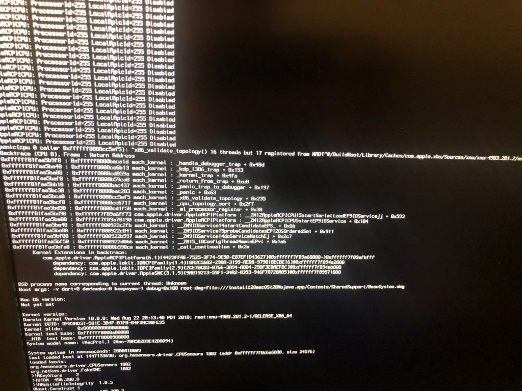

tio121 Posted December 18, 2018 Share Posted December 18, 2018 I'm having a strange kernel panic when I try to run the Mojave installer. I'm using your EFI directory as-is. I set up the bios according to your guide. "x86_validate_topology() 16 threads but 17 registered from MADT" Any ideas? Asus X299 Prime A Intel i7 9800x Nvidia RTX 2080 ti AMD RX 460 Samsung 970 Pro NVME 16gb RAM origin.zip Link to comment https://www.insanelymac.com/forum/topic/334343-imac-pro-x299-live-the-future-new-with-macos-1014-mojave-successful-buildsuccessful-guide/page/3/#findComment-2654410 Share on other sites More sharing options...
kgp Posted December 18, 2018 Author Share Posted December 18, 2018 1 minute ago, tio121 said: I'm having a strange kernel panic when I try to run the Mojave installer. I'm using your EFI directory as-is. I set up the bios according to your guide. "x86_validate_topology() 16 threads but 17 registered from MADT" Any ideas? Asus X299 Prime A Intel i7 9800x Nvidia RTX 2080 ti AMD RX 460 Samsung 970 Pro NVME 16gb RAM origin.zip Adopted TSCAdjustReset.kext added to EFI-Folder???? Link to comment https://www.insanelymac.com/forum/topic/334343-imac-pro-x299-live-the-future-new-with-macos-1014-mojave-successful-buildsuccessful-guide/page/3/#findComment-2654411 Share on other sites More sharing options...
tio121 Posted December 19, 2018 Share Posted December 19, 2018 Yeah I built that kext and put that in as well. This is a 8c/16t chip so I left the plist at default. But it appears that kext doesn't even get a chance to load before it kernel panics. Link to comment https://www.insanelymac.com/forum/topic/334343-imac-pro-x299-live-the-future-new-with-macos-1014-mojave-successful-buildsuccessful-guide/page/3/#findComment-2654480 Share on other sites More sharing options...

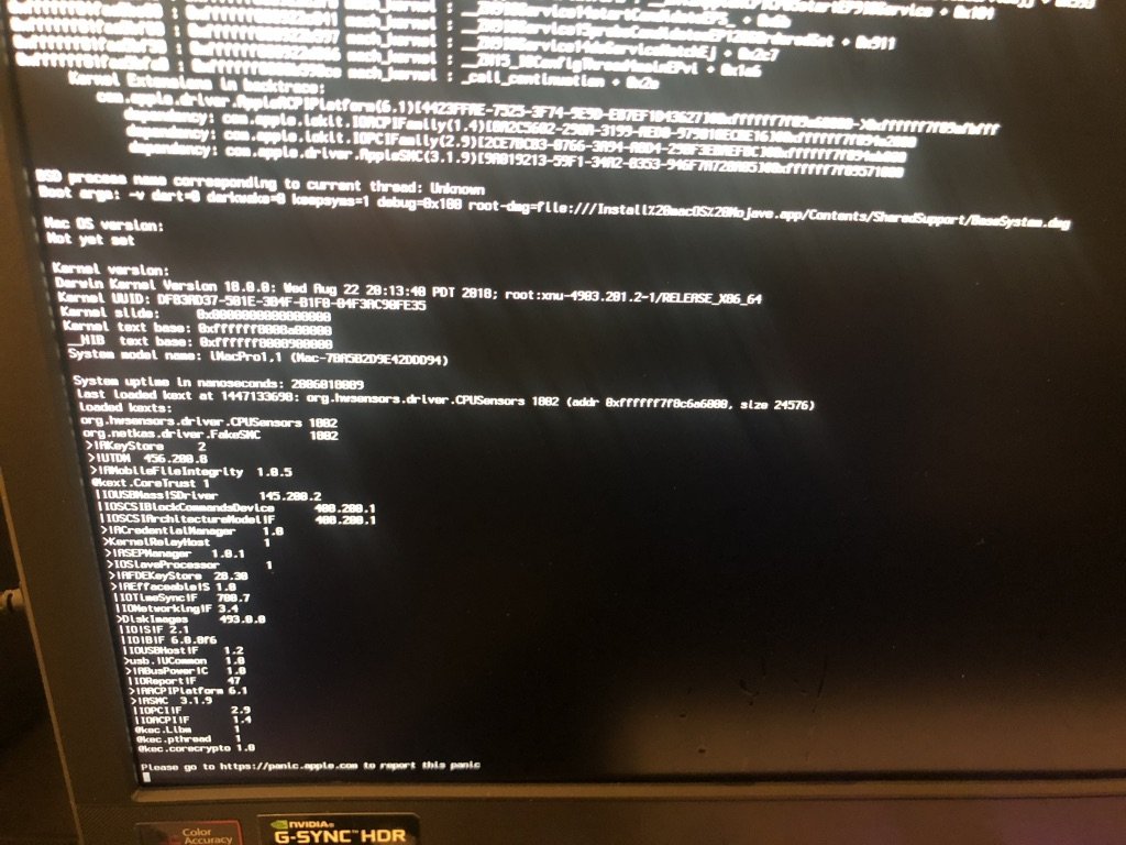

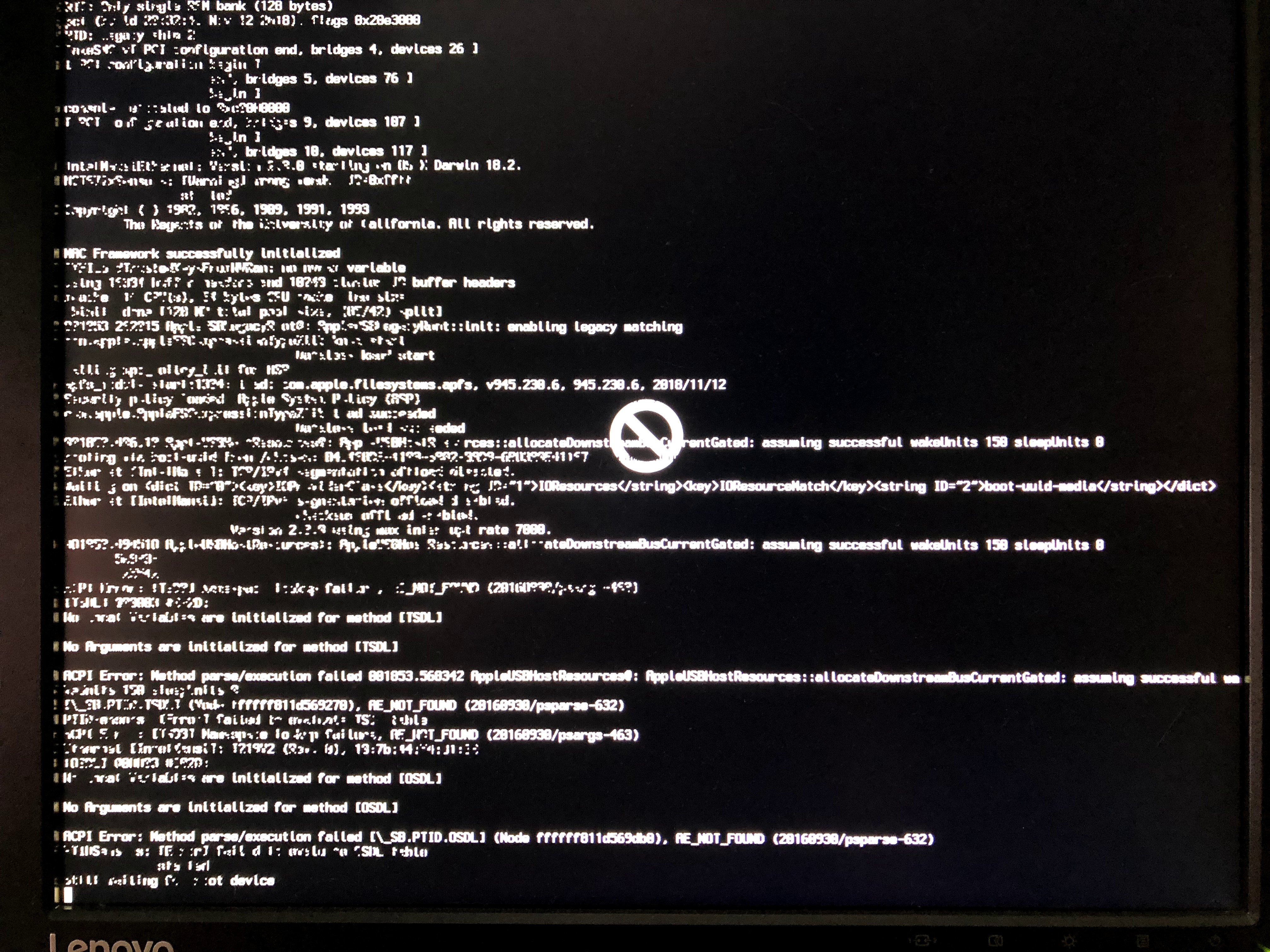

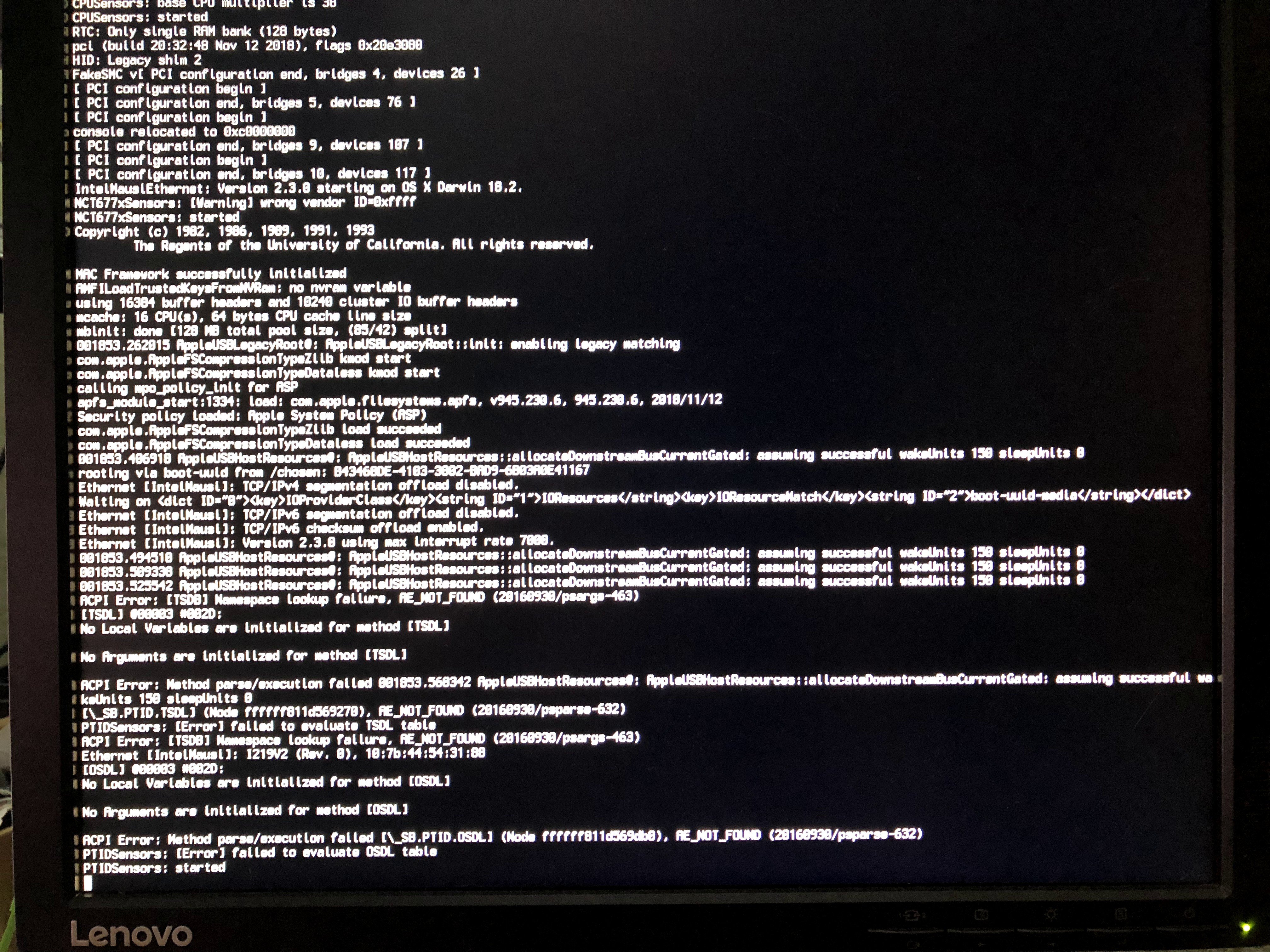

vladie Posted December 25, 2018 Share Posted December 25, 2018 (edited) Hi Trying to run your config on i7-9800x, asus prime x299-a, rx vega 64. Kernel starts to boot (from USB stick) and i see first screenshot for near 60 seconds, and then i see second screenshot (if i will wait more i see message 'still waiting for root device') TSCAdjustReset was adopted. UPDATE: seems that are only one USB port are seen by os x (i can insert usb stick into this port and boot installer). Tried kext-s from XHC-USB-Kext-Library, but no luck Keyboard/mouse not working, so i can't install macos in order to create working XHC-USB-Kext config with IoRegistryExplorer. I've also tried to boot high sierra installer (with usb port count patch enabled) - but result the same - no keyboard/mouse. Edited December 25, 2018 by vladie Link to comment https://www.insanelymac.com/forum/topic/334343-imac-pro-x299-live-the-future-new-with-macos-1014-mojave-successful-buildsuccessful-guide/page/3/#findComment-2655477 Share on other sites More sharing options...
Napka Posted December 25, 2018 Share Posted December 25, 2018 @Vladie I had similar problems with latest BIOS v1602. Reverted to 1503 and everything’s good again. 1 Link to comment https://www.insanelymac.com/forum/topic/334343-imac-pro-x299-live-the-future-new-with-macos-1014-mojave-successful-buildsuccessful-guide/page/3/#findComment-2655569 Share on other sites More sharing options...
