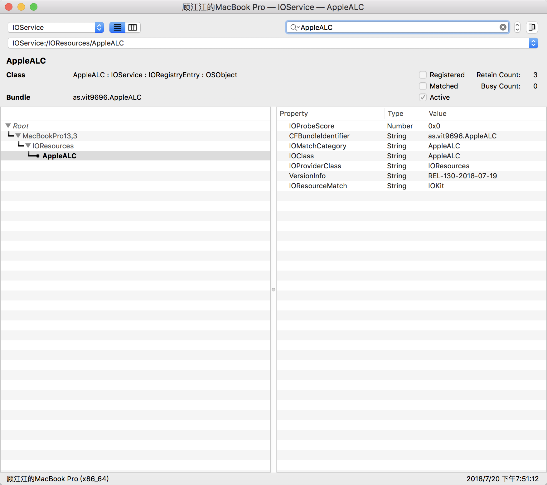

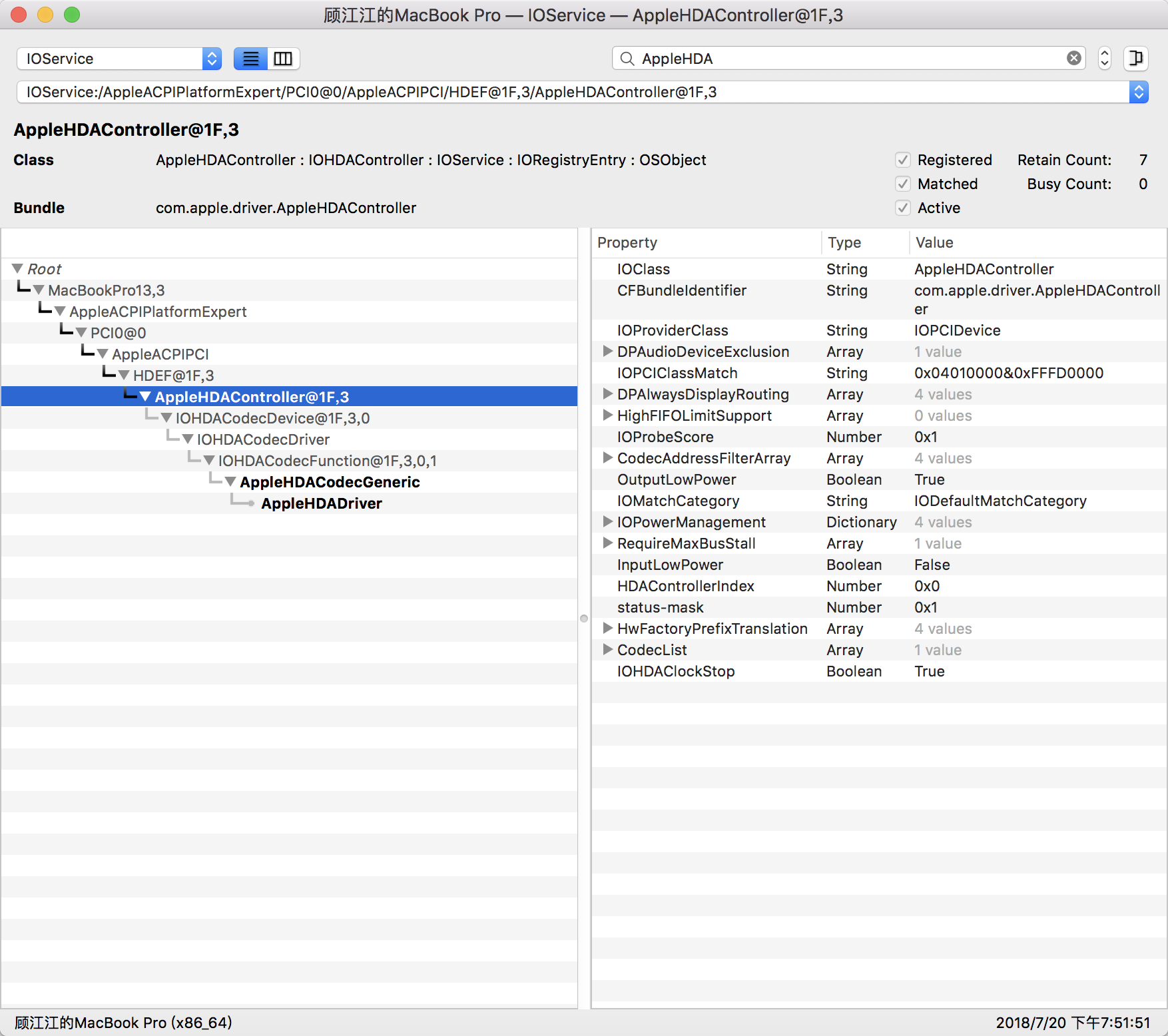

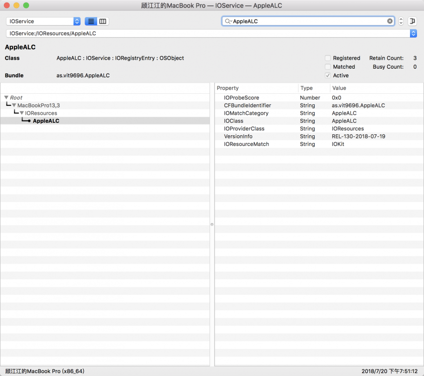

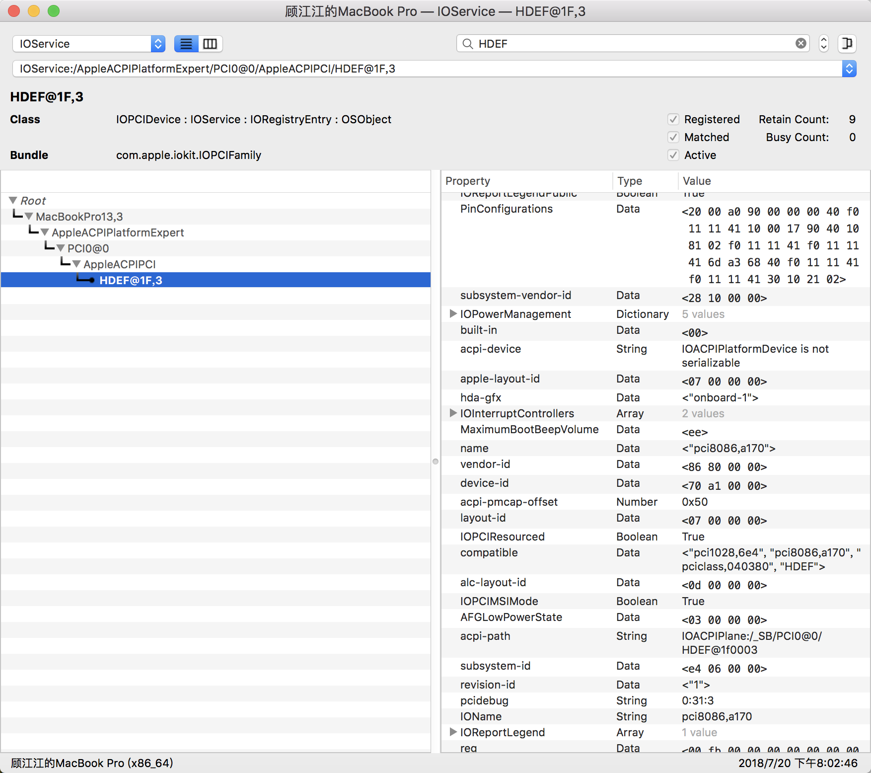

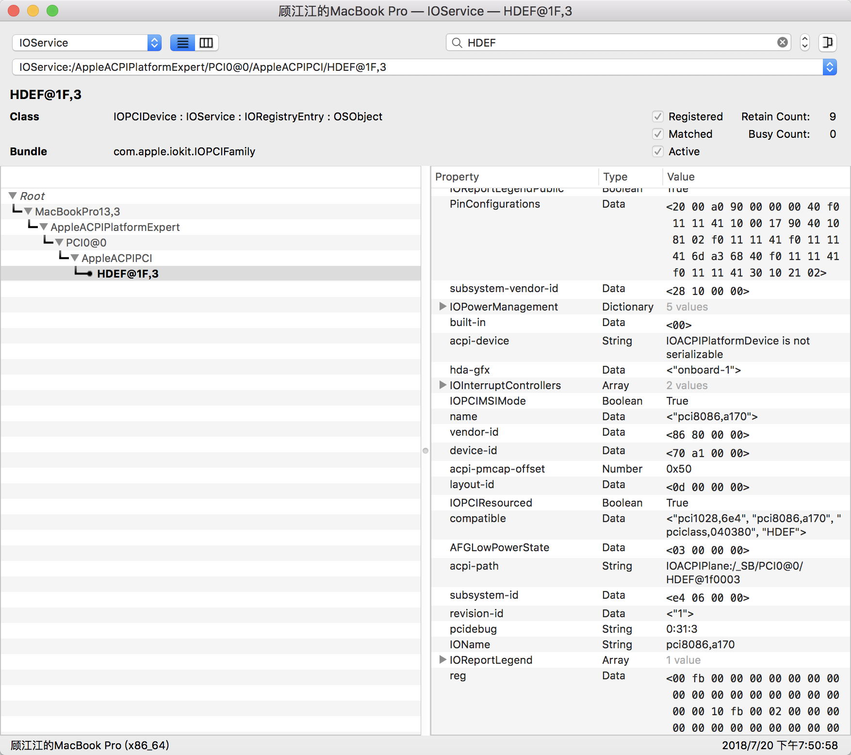

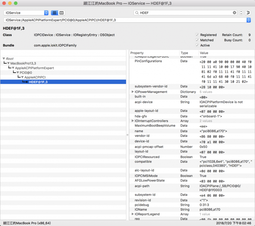

gujiangjiang Posted July 20, 2018 Share Posted July 20, 2018 Today when i update to AppleALC1.3.0 and my sound have stop working now and it shows grey icon on state bar. I'm using HDEF to using AppleALC and my laptop is XPS15-9550. I had to redownload AppleALC1.2.8 to rework my sound. All look fine but my sound still cant work. Link to comment Share on other sites More sharing options...
gujiangjiang Posted July 20, 2018 Share Posted July 20, 2018 Now i'm using AppleALC1.2.8 and sound works fine and i looked into Ioreg and i found AppleALC1.2.8 have more properties than AppleALC1.3.0 such as apple-layout-id MaximumBootBeepVolume alc-layout-id IOPCIMSIMode I hope this found can help to debug how AppleALC1.3.0 dont work. Thanks for your works. Link to comment Share on other sites More sharing options...

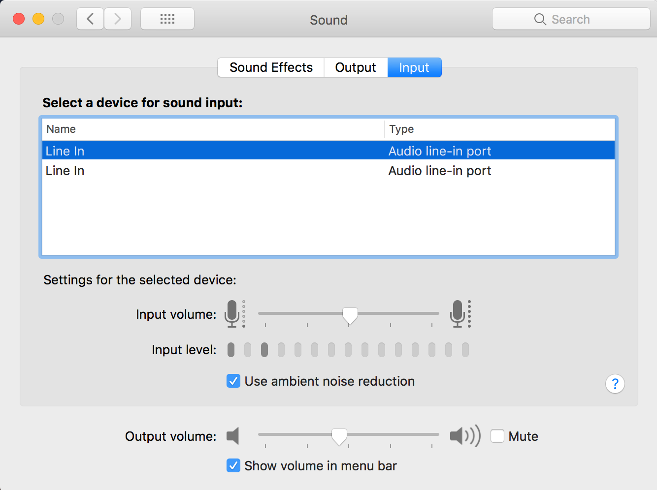

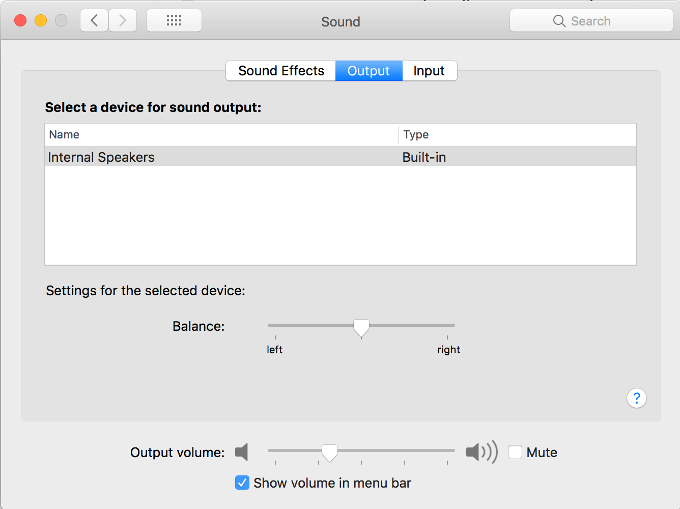

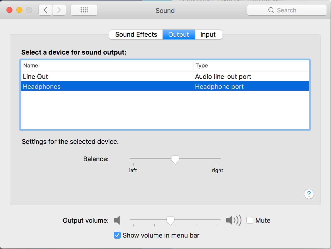

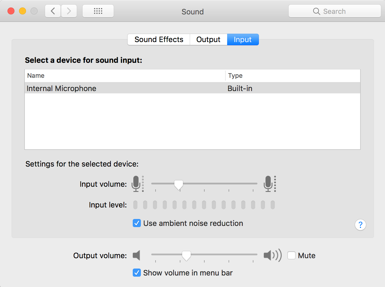

Unnamed X Posted July 22, 2018 Share Posted July 22, 2018 (edited) Hi, I need help in creating a new layout to support the Docking audio port on Zbook 15 G2 (ALC280). Currently: Layout 4: + Built-in mic works, ext mic (line in) works with noise (no ambient noise reduction option). + Internal speaker and headphone hot-swap works, but no line out for the docking. Layout 13: + No internal speaker or mic. + Headphone works, line out for the docking works. + There are 2 selections for ext mic (line in), the first one works (with ambient noise reduction option). I tried to clone the layout 13 and adding internal speaker and mic from layout4 to it, but didn't work. My procedure: + Modify layout.xml and platforms.xml + Add record to info.plist and pin.plist + Build with Xcode and import to Clover Kext folder. Even if I tried to modify layout 13 or 4 instead of making a new one, it still results same as the original one, nothing was changed. Here is my files, I sorry for my bad modification. Thank you so much! codec_dump.txt Codec Map.txt Archive.zip Edited July 22, 2018 by Unnamed X Link to comment Share on other sites More sharing options...
