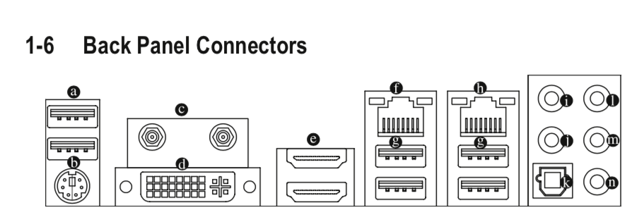

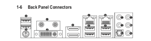

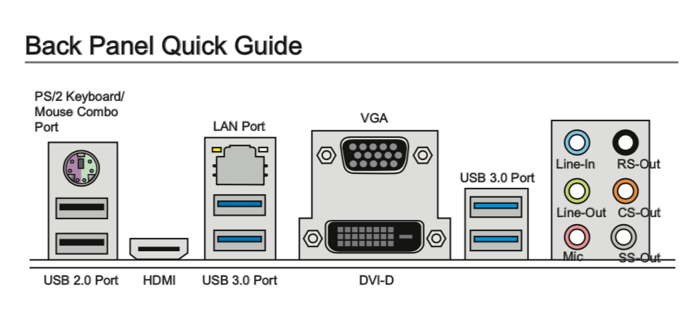

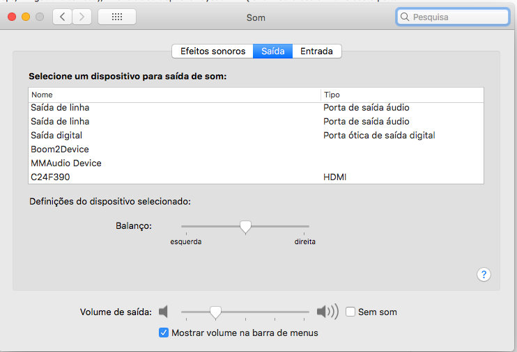

arsradu Posted July 7, 2018 Share Posted July 7, 2018 (edited) Guys, so, after spending most of the day today trying to understand how to add a new layout to AppleALC (which now I have a better idea how to do, although there are still a TON of things I don't know), I was wondering if anyone here can tell me, for this motherboard layout, which Layout ID should I inject in config to have an accurate mapping of these ports? So far, none of them seem to fit the description. And please, don't say 1 or 7, cause this motherboard doesn't have two Line Outs. So, for Desktops, if I got this correctly, I have default options Layout ID 1 (for a motherboard with 6 audio ports like this one, but unlike the one probably added to Layout ID 1, I need one with only 1 Line Out), from Toleda's resources, or Layout ID 7 (6 ports: Grey, Black, Orange, Pink, Green, Blue), from Mirone's resources. BUT, as I said, with Layout ID 7 I have no sound when using Internal Speakers. I do have sound when using Line Out, but it doesn't seem to be mapped correctly, cause I only have some channels active, but not all. Now, if I got this correctly, in this particular case, the Line-Out port is the same as the Internal Speakers ports (the Green one)? Cause I'm confused. Also, can anyone tell me if HDMI is supposed to show up as Digital Output? Or is it only for Optical ports? Cause, as you can see, there is no optical out on my motherboard. I have a 5.1 sound audio system and using the Green, CS Out and RS Out ports on the motherboard for that (these are the ports corresponding to the audio jack colors coming from the speakers). Basically I just matched the color of the audio jack to the one of the ports on the motherboard. But only the front speakers work. Not sure what to do about that... Maybe there is nothing to do. I don't know. Maybe I need to create an Aggregate audio. But then I won't have volume control over all the speakers at once which seems like a big letdown on Apple's side. But it is what it is. Edited July 7, 2018 by arsradu Link to comment https://www.insanelymac.com/forum/topic/311293-applealc-%E2%80%94-dynamic-applehda-patching/page/96/#findComment-2624782 Share on other sites More sharing options...

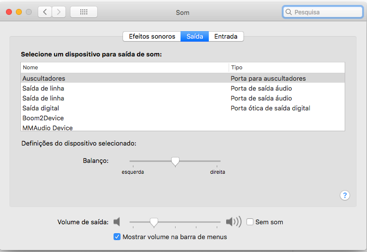

MorenoAv Posted July 7, 2018 Share Posted July 7, 2018 (edited) Hi @arsradu, I'll send 2 photos, of my sound output, and I have digital output, and you can see I have too one entry for HDMI... Hope this helps, our motherboards are very similar... I too have two Line out, digital out, and HDMI. Edited July 7, 2018 by MorenoAv Link to comment https://www.insanelymac.com/forum/topic/311293-applealc-%E2%80%94-dynamic-applehda-patching/page/96/#findComment-2624785 Share on other sites More sharing options...
arsradu Posted July 7, 2018 Share Posted July 7, 2018 6 minutes ago, MorenoAv said: Hi @arsradu, I'll send 2 photos, of my sound output, and I have digital output, and you can see I have too one entry for HDMI... Hope this helps, our motherboards are very similar... I too have two Line out, digital out, and HDMI. Thank you! So, this answers two questions: 1. HDMI IS separate (not the same thing as Digital Out, that seems to be used only for Optical Out) 2. my motherboard, as opposed to yours, doesn't/shouldn't have a Digital Out option since there is no Optical Out port. This is your motherboard: k is an Optical Out port (so it's perfectly normal for you to have Digital Out in options). i is Orange (Center Speaker Out) j is Black (Rear Speaker Out) l is Blue (Line-In) m is Green (Line-Out) n is Pink (Mic-In) Link to comment https://www.insanelymac.com/forum/topic/311293-applealc-%E2%80%94-dynamic-applehda-patching/page/96/#findComment-2624787 Share on other sites More sharing options...
MorenoAv Posted July 7, 2018 Share Posted July 7, 2018 yep thats it... and you're welcome ... Link to comment https://www.insanelymac.com/forum/topic/311293-applealc-%E2%80%94-dynamic-applehda-patching/page/96/#findComment-2624788 Share on other sites More sharing options...

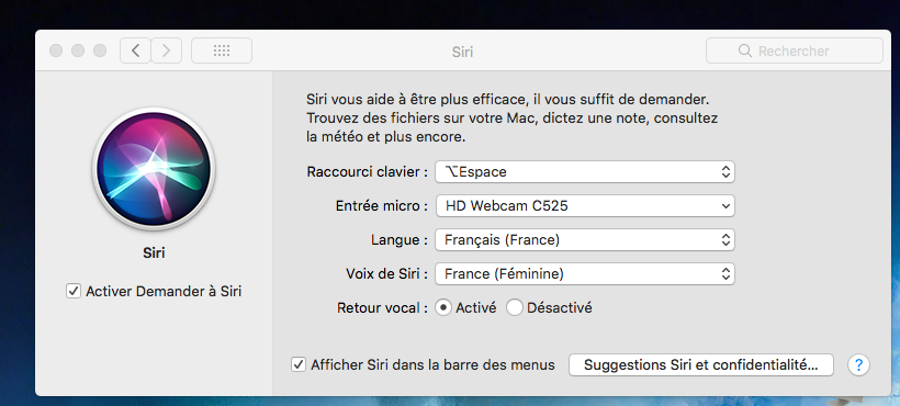

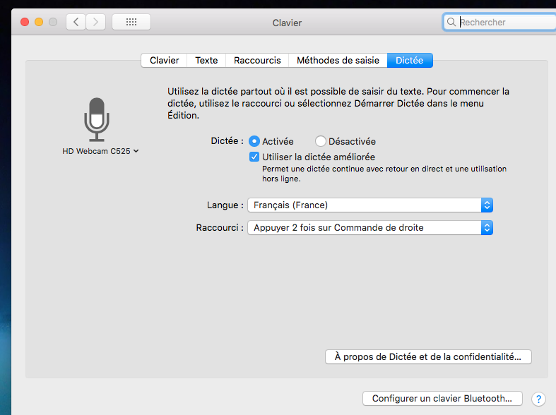

Genxster Posted July 8, 2018 Share Posted July 8, 2018 Can anybody confirms AppleALC works with Siri ,For me Mic works flawlessly with other apps like QuickTime media player but its not working with Siri, it doesn't recognise words I say .There is no account related error cause I can use typing instead .In Sierra ,it was working fine but not here.Os:10.13.5Alc255 ,layout id 17 (,other ids like 13 ,3 27 ,28,18 have no mic detection so I don't use them)Dell Vostro 3546 i3-4400 integrated only graphicsSent from my Redmi Note 3 using Tapatalk Link to comment https://www.insanelymac.com/forum/topic/311293-applealc-%E2%80%94-dynamic-applehda-patching/page/96/#findComment-2624816 Share on other sites More sharing options...
Matgen84 Posted July 8, 2018 Share Posted July 8, 2018 16 minutes ago, Genxster said: Can anybody confirms AppleALC works with Siri ,For me Mic works flawlessly with other apps like QuickTime media player but its not working with Siri, it doesn't recognise words I say .There is no account related error cause I can use typing instead . In Sierra ,it was working fine but not here. Os:10.13.5 Alc255 ,layout id 17 (,other ids like 13 ,3 27 ,28,18 have no mic detection so I don't use them) Dell Vostro 3546 i3-4400 integrated only graphics Sent from my Redmi Note 3 using Tapatalk Sorry I don't know for ALC255. AppleALC works well with Siri on High Sierra 10.13.5 (ALC892, layout-id=1) Link to comment https://www.insanelymac.com/forum/topic/311293-applealc-%E2%80%94-dynamic-applehda-patching/page/96/#findComment-2624817 Share on other sites More sharing options...
Genxster Posted July 8, 2018 Share Posted July 8, 2018 Sorry I don't know for ALC255. AppleALC works well with Siri on High Sierra 10.13.5 (ALC892, layout-id=1) Ohh thanks for your replySent from my Redmi Note 3 using Tapatalk 1 Link to comment https://www.insanelymac.com/forum/topic/311293-applealc-%E2%80%94-dynamic-applehda-patching/page/96/#findComment-2624818 Share on other sites More sharing options...
Matgen84 Posted July 8, 2018 Share Posted July 8, 2018 8 minutes ago, Genxster said: Ohh thanks for your reply Sent from my Redmi Note 3 using Tapatalk I suppose mic input is activate... Link to comment https://www.insanelymac.com/forum/topic/311293-applealc-%E2%80%94-dynamic-applehda-patching/page/96/#findComment-2624819 Share on other sites More sharing options...
Genxster Posted July 8, 2018 Share Posted July 8, 2018 I suppose mic input is activate...I mean ,when I talk like whispering ,it recognise some of words not all ,BTW mic is working fine as in Windows with QuickTime recorder and other apps ,just not here.so mic is turned on for Siri tooSent from my Redmi Note 3 using Tapatalk 1 Link to comment https://www.insanelymac.com/forum/topic/311293-applealc-%E2%80%94-dynamic-applehda-patching/page/96/#findComment-2624820 Share on other sites More sharing options...
Matgen84 Posted July 8, 2018 Share Posted July 8, 2018 (edited) @Genxster On my system, I've also activate Dictation for Siri work correctly. Edited July 8, 2018 by Matgen84 Link to comment https://www.insanelymac.com/forum/topic/311293-applealc-%E2%80%94-dynamic-applehda-patching/page/96/#findComment-2624821 Share on other sites More sharing options...
Genxster Posted July 8, 2018 Share Posted July 8, 2018 [mention=1956897]Genxster[/mention] On my system, I've also activate Dictation for Siri work correctly. Dictation etc already tried to turn on and off ,thanks for you support Sent from my Redmi Note 3 using Tapatalk 1 Link to comment https://www.insanelymac.com/forum/topic/311293-applealc-%E2%80%94-dynamic-applehda-patching/page/96/#findComment-2624822 Share on other sites More sharing options...
