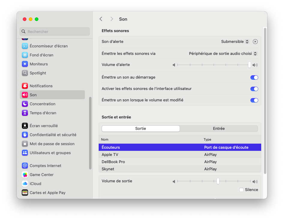

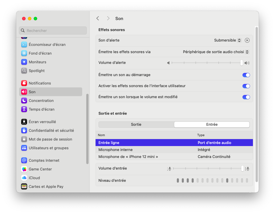

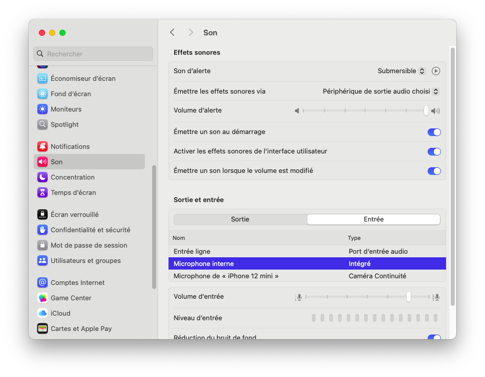

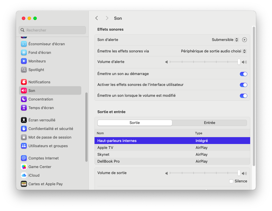

Also, I tried to use a headphone as a mic and it works even if the sound quality is awful. Here's some screenshots:
Auto switch from speakers to headphones
Internal Speakers which works with layout-id 33/66/71
Jack as a mic which works
Internal mic which doesn't work

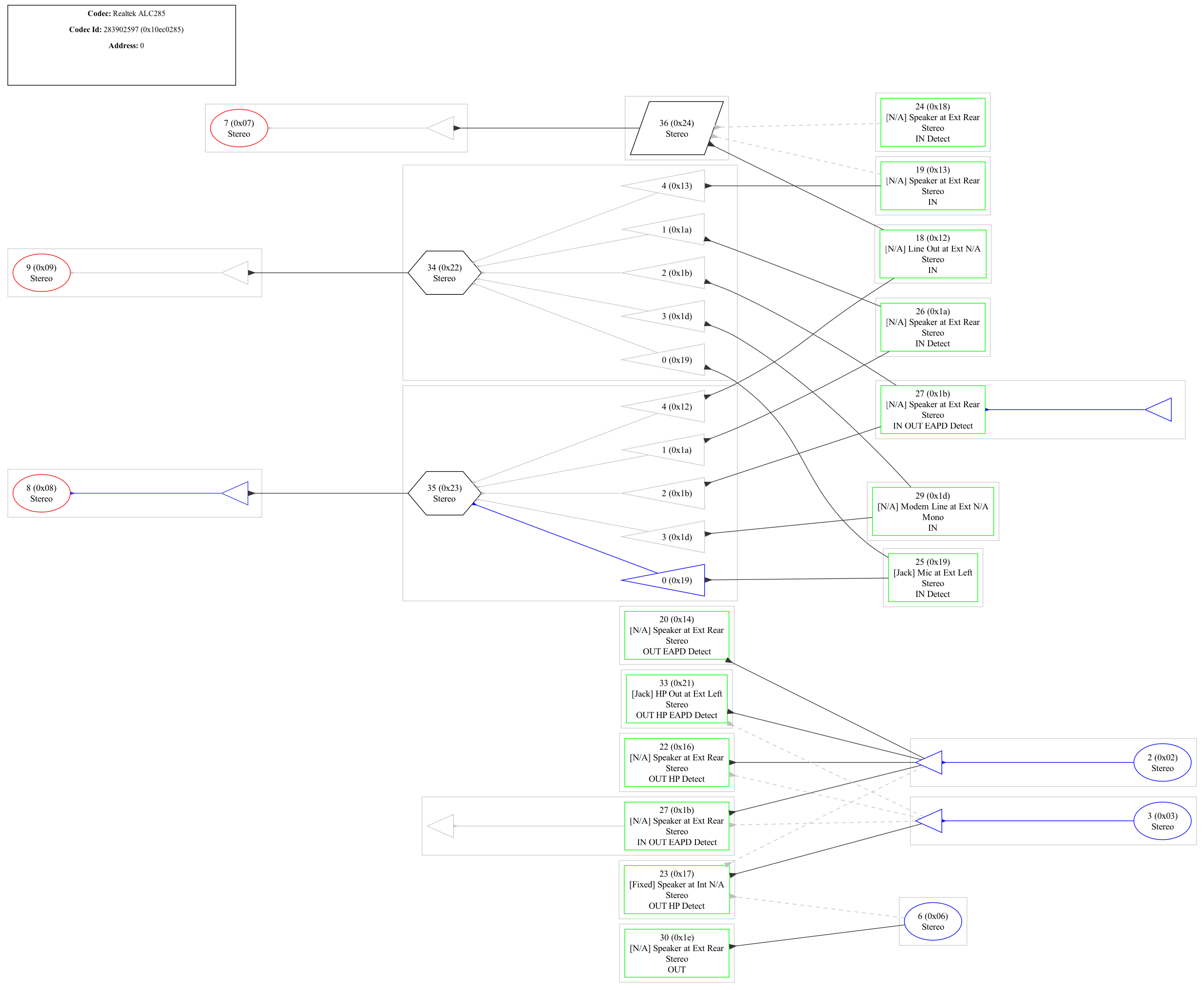

Finally, here's a graphical representation of your codec. I'm hoping that the internal mic is your Line Out because I doubt it's a modem or another speaker.

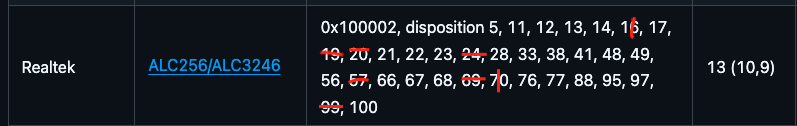

@PG7, ALC256 - this is a codec that is standardly supported by https://github.com/acidanthera/AppleALC/releases/tag/1.9.6.
No additional steps are required (except for macOS Tahoe)
The audio works on the All In One speakers, but the internal microphone does NOT work on any of them!
My request is specifically to repair the INTERNAL MICROPHONE.
Thank you for your reply.
3 hours ago, verdazil said:
@PG7, apparently, other layout IDs need to be tested for this codec.
Regarding those that aren't marked, the audio works but the internal microphone doesn't.
I've already tested them all!

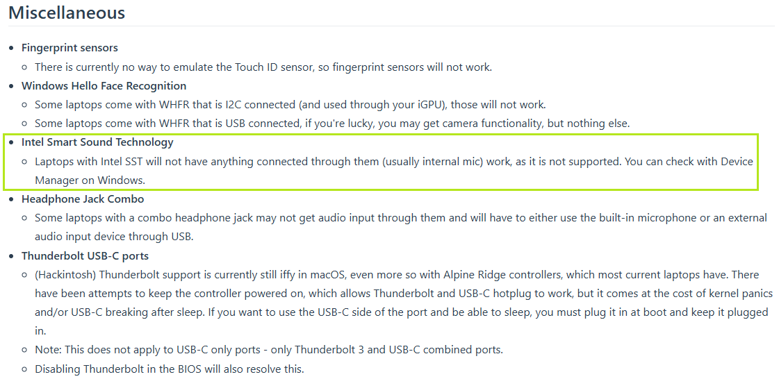

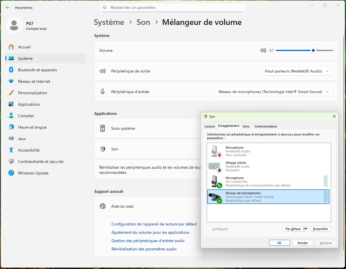

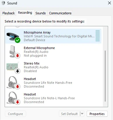

Have you checked to see if your built-in microphone is an Intel Smart Sound Technology device?
Built-in microphones using Intel Smart Sound Technology are not supported on macOS and cannot be used because they don't work with AppleALC.kext.
