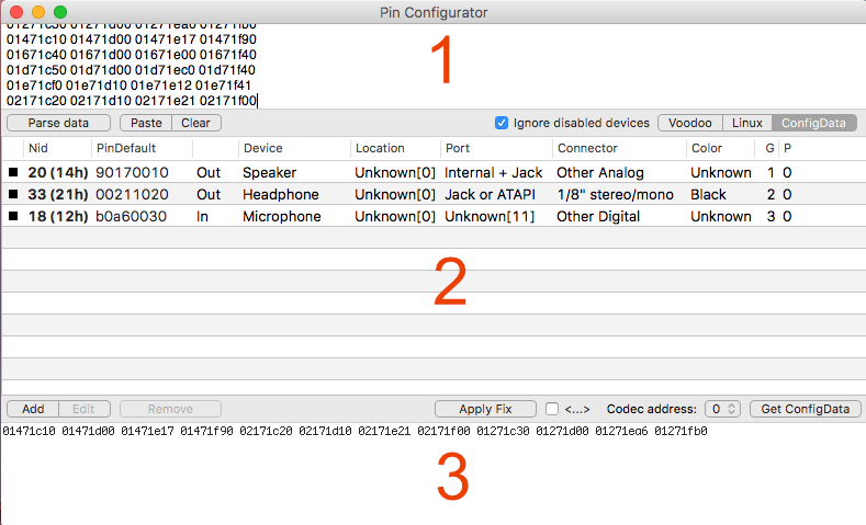

MacPeet Posted August 7, 2018 Share Posted August 7, 2018 (edited) @arsradu PinConfigurator.zip 1. Insert verbs from the codec_dump and click "parse data" 2. Here any adjustments if necessary 3. codec address (usually 0 or 2 / is in the codec_dump) and click Get ConfigData You may have to set EAPD here (see codec_dump): Example add EAPD: 01471c10 01471d00 01471e17 01471f90 01470c02 02171c20 02171d10 02171e21 02171f00 02170c02 01271c30 01271d00 01271ea6 01271fb0 This is the finished PinConfig (example) for info.plist (PinConfigs.kext) for AppleALC master source. Credits: thanks saxmms for PinConfigurator Edited August 7, 2018 by MacPeet 2 Link to comment https://www.insanelymac.com/forum/topic/311293-applealc-%E2%80%94-dynamic-applehda-patching/page/104/#findComment-2629233 Share on other sites More sharing options...
arsradu Posted August 7, 2018 Share Posted August 7, 2018 (edited) 25 minutes ago, MacPeet said: @arsradu PinConfigurator.zip 1. Insert verbs from the codec_dump and click "parse data" 2. Here any adjustments if necessary 3. codec address (usually 0 or 2 / is in the codec_dump) and click Get ConfigData You may have to set EAPD here (see codec_dump): Example add EAPD: 01471c10 01471d00 01471e17 01471f90 01470c02 02171c20 02171d10 02171e21 02171f00 02170c02 01271c30 01271d00 01271ea6 01271fb0 This is the finished PinConfig (example) for info.plist (PinConfigs.kext) for AppleALC master source. Credits: thanks saxmms for PinConfigurator What an AWESOME tool!! Thank you so much! I had to do this the old fashion way... Manually. :))) I wish I knew about this earlier. By the way, when you have a bit of time, would you be able to take a look at my attempt to make a new layout ID for ALC 892 (motherboard: MSi Z97S SLI Krait Edition)? Link here. I feel like it should....(at least in theory, please don't hit me...) work? It just...doesn't. I haven't tried the newer AppleALC sources... I thought I'd wait for someone to take a look first. I've had so many attempts. Some of the Layout IDs already added (and not by me) to ALC892 (such as Layout 12) didn't work for me... Sooo....at this point, I'm not even sure it's because of the resources I've made... Maybe it's something else entirely. I would greatly appreciate that. Once again, many thanks for this! This is awesome! Edited August 7, 2018 by arsradu Link to comment https://www.insanelymac.com/forum/topic/311293-applealc-%E2%80%94-dynamic-applehda-patching/page/104/#findComment-2629236 Share on other sites More sharing options...

jaymonkey Posted August 8, 2018 Share Posted August 8, 2018 (edited) On 8/7/2018 at 4:09 PM, MacPeet said: 1. Insert verbs from the codec_dump and click "parse data" 2. Here any adjustments if necessary 3. codec address (usually 0 or 2 / is in the codec_dump) and click Get ConfigData You may have to set EAPD here (see codec_dump): Example add EAPD: 01471c10 01471d00 01471e17 01471f90 01470c02 02171c20 02171d10 02171e21 02171f00 02170c02 01271c30 01271d00 01271ea6 01271fb0 This is the finished PinConfig (example) for info.plist (PinConfigs.kext) for AppleALC master source. @MacPeet, Many thanks for posting the info on the pin configurator utility ... it looks like it could be a vey useful tool for adding custom codec pin config's to AppleALC I have a 2017 15" HP Spectre X360 laptop that has ALC295 codec, currently running MacOS 10.13.6 and using AppleALC Ver 1.2.7 (layout-id 3) for HDA Audio all Audio Input and Output devices work perfect. However in anticipation of MacOS10.14.X tried using AppleALC version 1.3.0 and 1.2.8 but without much success, see this post for more information. I'd like to send the AppleALC Devs the pin config for this laptop and tried following your short guide, however i ran in to a few issues ... Can you please expand on the following questions I have or point me to a more complete usage guide:- 1. I've created a codec dump under linux, however when i copy and paste the contents into pin configurator and click on parse data, it correctly identifies the source as Linux but does not fill the data out in the table section (marked as 2 in your example) ... I've attached my HDA Codec dump to this post. 2. Can you explain how you derive the two hex strings for the EAPD data ? Alternatively if the attached codec dump is enough for the Dev's to work from then maybe i don't need to extract the Pin Config ? Cheers Jay HP Spectre X360 Codec Dump.zip Edited August 26, 2018 by jaymonkey Link to comment https://www.insanelymac.com/forum/topic/311293-applealc-%E2%80%94-dynamic-applehda-patching/page/104/#findComment-2629320 Share on other sites More sharing options...

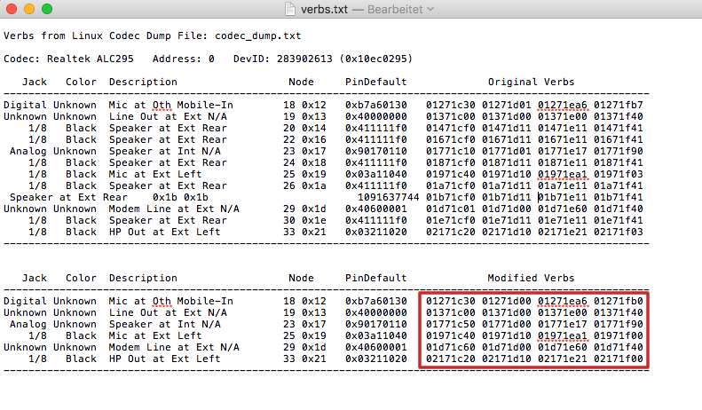

MacPeet Posted August 8, 2018 Share Posted August 8, 2018 @jaymonkey this is your complete convoluted dump: Dump.zip that in verbs.txt is for PinConfigurator: EAPD you see in the codec_dump see "EAPD 0x2: EAPD" Try this in Mojave with layoutID3 with boot flags -alcbeta -lilubetaall trial_1.3.1_1.2.6.zip Link to comment https://www.insanelymac.com/forum/topic/311293-applealc-%E2%80%94-dynamic-applehda-patching/page/104/#findComment-2629332 Share on other sites More sharing options...

jaymonkey Posted August 8, 2018 Share Posted August 8, 2018 1 hour ago, MacPeet said: @jaymonkey this is your complete convoluted dump: EAPD you see in the codec_dump see "EAPD 0x2: EAPD" @MacPeet, Thank you very much for looking at the codec dump and returning a processed (convoluted) file ... I give it a go and report back .. Cheers Jay Link to comment https://www.insanelymac.com/forum/topic/311293-applealc-%E2%80%94-dynamic-applehda-patching/page/104/#findComment-2629341 Share on other sites More sharing options...
