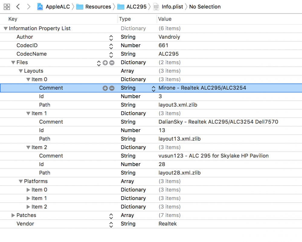

aylamrin Posted August 6, 2018 Share Posted August 6, 2018 Hi all, I am using a DELL Inspiron 5370. Details: Codec: ALC295 AppleALC: 1.2.8 Lilu: 1.2.5 Issue: With layout-id 13 or 28, (layout-id=3 does not work) I get the following in Sys Prefs: Output: Internal Speakers Input: Internal Mic Everything works. However, when I plug in headphones/headset, the output in Sys Preference changes to Headphones, But, there is no audio from headphones. I tried forcing apple-layout-id from 1 to 0x0F, but same result. Can someone help me (especially, if you are using layout 13, or 28) or using ALC256 (also)? Link to comment Share on other sites More sharing options...
twsps Posted August 6, 2018 Share Posted August 6, 2018 Hi all, I am using a DELL Inspiron 5370. Details: Codec: ALC295 AppleALC: 1.2.8 Lilu: 1.2.5 Issue: With layout-id 13 or 28, (layout-id=3 does not work) I get the following in Sys Prefs: Output: Internal Speakers Input: Internal Mic Everything works. However, when I plug in headphones/headset, the output in Sys Preference changes to Headphones, But, there is no audio from headphones. I tried forcing apple-layout-id from 1 to 0x0F, but same result. Can someone help me (especially, if you are using layout 13, or 28) or using ALC256 (also)? Why are you saying ALC256 when you mentioned ALC295? Does ALC256 works on ALC295?Sent from my Mate 9 using Tapatalk Link to comment Share on other sites More sharing options...

aylamrin Posted August 6, 2018 Share Posted August 6, 2018 3 hours ago, twsps said: Why are you saying ALC256 when you mentioned ALC295? Does ALC256 works on ALC295? Sent from my Mate 9 using Tapatalk I am not sure, I am making a guess, and I may be very wrong . ALC256, uses layout ids 13 and 28 and have similar pathmap as ALC295. Link to comment Share on other sites More sharing options...
twsps Posted August 6, 2018 Share Posted August 6, 2018 6 minutes ago, aylamrin said: I am not sure, I am making a guess, and I may be very wrong . ALC256, uses layout ids 13 and 28 and have similar pathmap as ALC295. Then it wouldn't make sense, as you're using id = 13 and 28, AppleALC will recognize it as 295. Not using ALC256. Link to comment Share on other sites More sharing options...
aylamrin Posted August 6, 2018 Share Posted August 6, 2018 1 hour ago, twsps said: Then it wouldn't make sense, as you're using id = 13 and 28, AppleALC will recognize it as 295. Not using ALC256. But more importantly, I would like to have my headphones working when plugged in . At the moment it is not. Link to comment Share on other sites More sharing options...

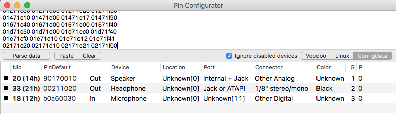

aylamrin Posted August 6, 2018 Share Posted August 6, 2018 (edited) Dear @vandroiy2012, could you please check this codec dump. My system is DELL Inspiron 5370. It has ALC295. Issue: Internal Speakers: Working Internal Mic: Working Headphones/Headset : Detected as Headphones but NO audio Using layout id-13. (Same result with 28. Layout-id 3 does not work) codec#0.txt Edited August 6, 2018 by aylamrin Link to comment Share on other sites More sharing options...

vandroiy2012 Posted August 6, 2018 Share Posted August 6, 2018 28 minutes ago, aylamrin said: Dear @vandroiy2012, could you please check this codec dump. My system is DELL Inspiron 5370. It has ALC295. Issue: Internal Speakers: Working Internal Mic: Working Headphones/Headset : Detected as Headphones but NO audio Using layout id-13. (Same result with 28. Layout-id 3 does not work) codec#0.txt Every resource have author. I didn't make resources for this codec. Look in info.plist to see authors. @daliansky and @vusun123 are here. @Mirone is retired. Link to comment Share on other sites More sharing options...
twsps Posted August 6, 2018 Share Posted August 6, 2018 Every resource have author. I didn't make resources for this codec. Look in info.plist to see authors. [mention=1543600]daliansky[/mention] and [mention=1171430]vusun123[/mention] are here. [mention=702532]Mirone[/mention] is retired. But based on what I've researched, it seems like the kext may have some degree to make my cpu temp and frequency go up. Sent from my Mate 9 using Tapatalk Link to comment Share on other sites More sharing options...

MacPeet Posted August 6, 2018 Share Posted August 6, 2018 @aylamrin I looked at your codec_dump. Your HP device is on node 33, just like layoutID 13 and 28. Is not different. What headphones are you trying? 3 pin 3.5 jack or 4 pin 3.5 jack? Link to comment Share on other sites More sharing options...
