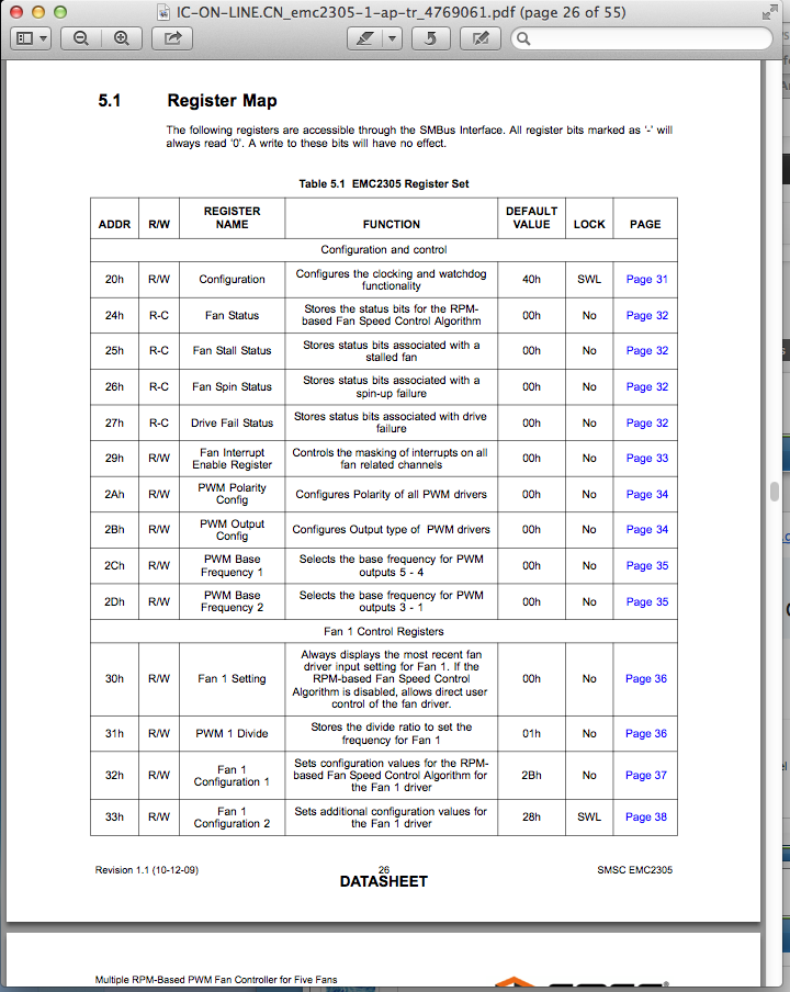

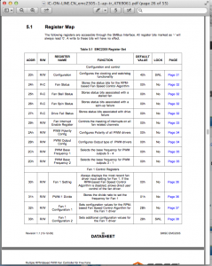

hi welcome back the dell 690 has only these
SMSC EMC2710P
SMSC LPC47M534-NS
i just want to say that the speesfan  support all of these chip set
So, you have to search datasheet or sources for support EMC2710 or analogs.
