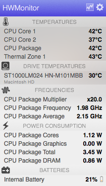

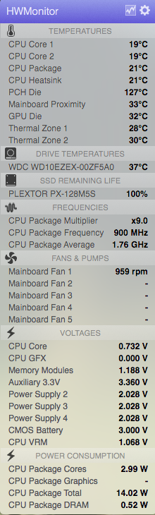

Anybody knows how to get fan speed readings on ASUS X55 laptops?
I would like to know where to start digging if it is something that needs a lot of work.
Thanks to this wonderful program, after install , almost all sensors work perfectly!

I tried the attached HWMonitor and FakeSMC, and it works the same way. No fan speed. @Herve is right. There is need of ACPI patching or some other kext?.. What could I do?

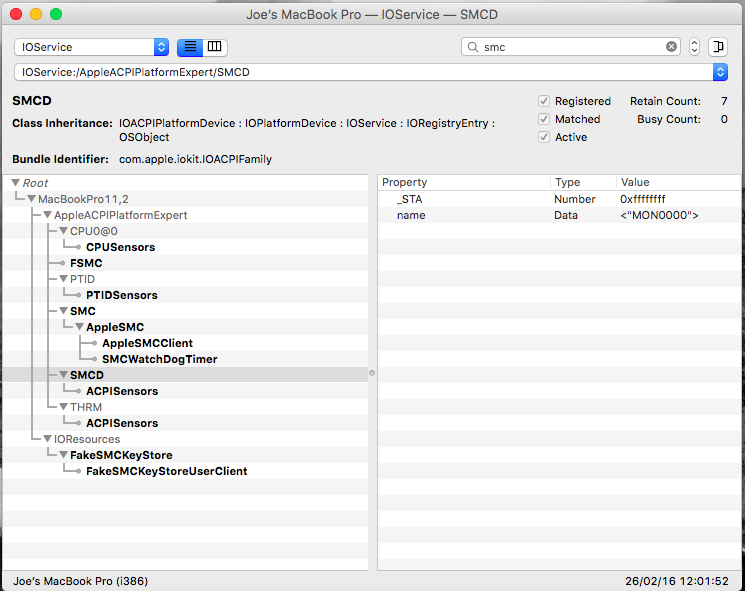

Oh sorry for that man, I was using my normal DSDT not the one you sent me. Let me post ioreg and config plist witht that
I can find this SMCD device you say but only when I use your DSDT
Here goes the ioreg and the config plist
Archive.zip

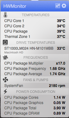

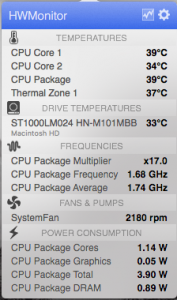

THANKS TO @legot28 fan reading works very nice now! Thanks so much  :w00t:
Well, after a reboot, it doesnt work.. I have tried with and without caches to no result. I have other versions of OSX installed and I tried and it also didnt work....
I dont understand.. Here goes the screenshot as proof:

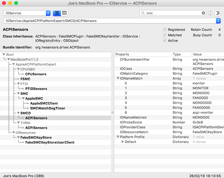

I attach here my current IOREG
kosakgroove IOREG.zip
By looking at current IOREG, compared to the one I submitted when it was working, the SMCD device seems unchanged.... :(

OMG! Thanks so much @legot28 thanks to your modification of the Info plist of my FakeSMC, more precisely the FNum key, and some other little tweaks in my DSDT, fan readings work great in my Asus Laptop hehe
I got no other words than Thank you thank you thank you! :D
