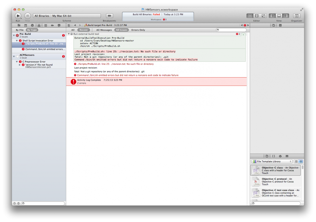

Kozlek thanks for fix.Now I can build project file with several warnings but everything seem ok
But after restart kexts do not want to load and I can't boot.Only solution is to re-install.
I see "can't to resolve library dependency". It means you have bad Info.plist or kext loaded before its parent. It may occur if you put kexts in extra. Do not do this!

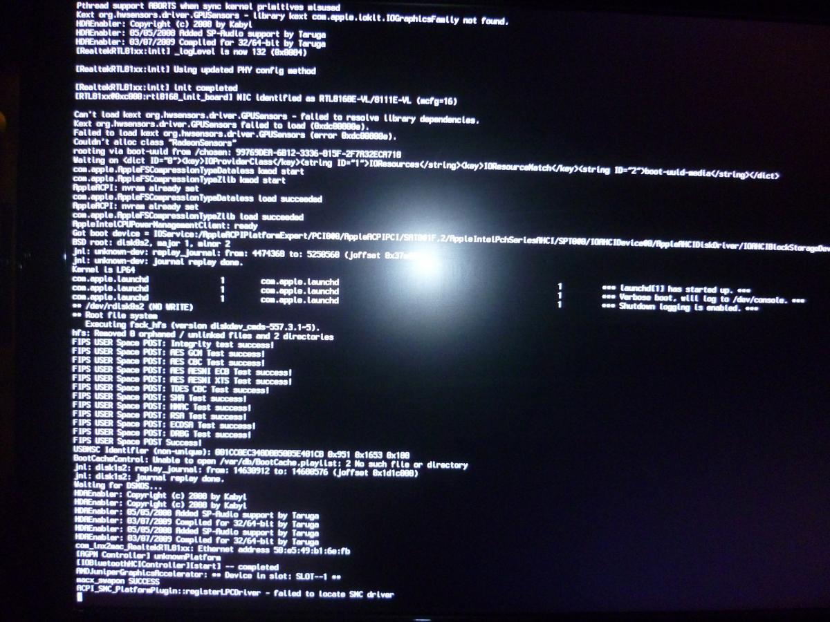

HWSensors.5.2.655 worked on my test/recovery install, then i try to upgrade with lastest version.
I had the same problem as @applegeek with HWSensors.5.2.731.
first, i boot my first hard drive to repare the test/recovery system with reinstalling the 5.2.655.
also, the fakesmc.kext on test/recovery hard drive still bad, and the installer removed fakesmc.kext from my first hard drive.
after reboot, all partition give the same error as @applegeek.
to not reinstall all, i decided to reinject the fakesmc.kext.
before make the test, i copied it on a other hard drive.
here how i done:
boot my first system in single user mode
-s
mount hard drive (in real this one is a raid0 of 2 SSD)
/sbin/mount -uw /
mount the hard drive contening the copy of the original fakeSMC.kext
ls -l /dev/disk*
mine was /dev/disk3s3 in hfs
mkdir /disk
mount -t hfs /dev/disk3s3 /disk
i check if FakeSMC.kext is really there
ls /disk/ | more
So i have to copy it to /System/library/Extensions/
cp -r /disk/FakeSMC.kext /System/library/Extensions/
i check it
ls /System/library/Extensions/ | more
then reboot
reboot
All fine.
i save my install and my time ...
about HVsensors, surely i should install plugins and not the FakeSMC.kext ...
i it's better to do it manually, to be sure of what is done.

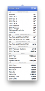

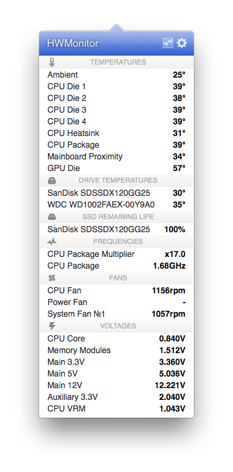

See, CPU Core is 0.036V that is very wrong. It must be about 1V

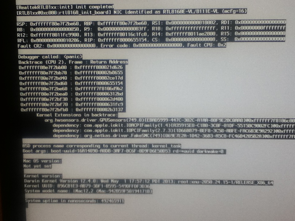

I'm running on my sig config, and with the last two HWSensors versions, i can't get to the boot screen, i'm using .678 now and i't all running great.
I get this in verbose on the latest HWSensors : 7/30/13 7:34:16.000 PM kernel[0]: FakeSMC: [Fatal] forbidding start on Apple hardware
