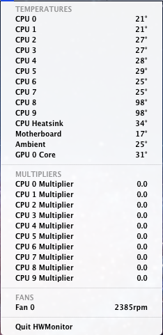

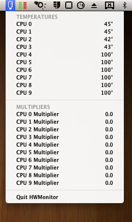

mm67 Posted February 3, 2012 Share Posted February 3, 2012 Looks like this with Z68XP-UD4. Should have only 4 core temperatures and multipliers are not showing. Cpu heatsink temperature is really Ambient, Motherboard should be Cpu temperature and 3rd sensor that now says Ambient is probably really disconnected, that 25 C never changes on Windows or OS X. Link to comment https://www.insanelymac.com/forum/topic/275429-hwsensors/#findComment-1792484 Share on other sites More sharing options...

kozlek Posted February 4, 2012 Author Share Posted February 4, 2012 Looks like this with Z68XP-UD4. Should have only 4 core temperatures and multipliers are not showing. Cpu heatsink temperature is really Ambient, Motherboard should be Cpu temperature and 3rd sensor that now says Ambient is probably really disconnected, that 25 C never changes on Windows or OS X. I could add your Super I/O's profile with proper temperatures translation into kext config. But first I should to know which chip manufacturer and revision you have. Show me your kernel log, please. Is there a proper way to install this via the installer. I tried installing it over my existing FakeSMC kexts and it didnt reboot after the install. Booting into windows and replacing the old kexts allowed me to boot again. Thanks! Remove old FakeSMC before instilling new one. Just move it to trash and run installer. 1 Link to comment https://www.insanelymac.com/forum/topic/275429-hwsensors/#findComment-1792583 Share on other sites More sharing options...

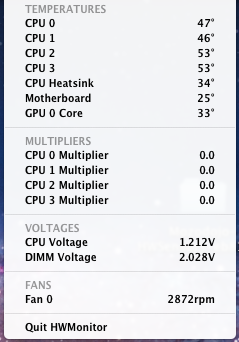

mm67 Posted February 4, 2012 Share Posted February 4, 2012 I could add your Super I/O's profile with proper temperatures translation into kext config. But first I should to know which chip manufacturer and revision you have. Show me your kernel log, please. This what you need ? Feb 4 13:25:37 localhost kernel[0]: IT87x: based on code from Open Hardware Monitor project by Michael Möller (C) 2010 Feb 4 13:25:37 localhost kernel[0]: IT87x: mozodojo (C) 2011 Feb 4 13:25:37 localhost kernel[0]: IT87x: found ITE IT8728F Link to comment https://www.insanelymac.com/forum/topic/275429-hwsensors/#findComment-1792656 Share on other sites More sharing options...
kozlek Posted February 4, 2012 Author Share Posted February 4, 2012 This what you need ? Feb 4 13:25:37 localhost kernel[0]: IT87x: based on code from Open Hardware Monitor project by Michael Möller (C) 2010 Feb 4 13:25:37 localhost kernel[0]: IT87x: mozodojo (C) 2011 Feb 4 13:25:37 localhost kernel[0]: IT87x: found ITE IT8728F I added your chipset profile into plugin. Check the repository. Link to comment https://www.insanelymac.com/forum/topic/275429-hwsensors/#findComment-1792669 Share on other sites More sharing options...

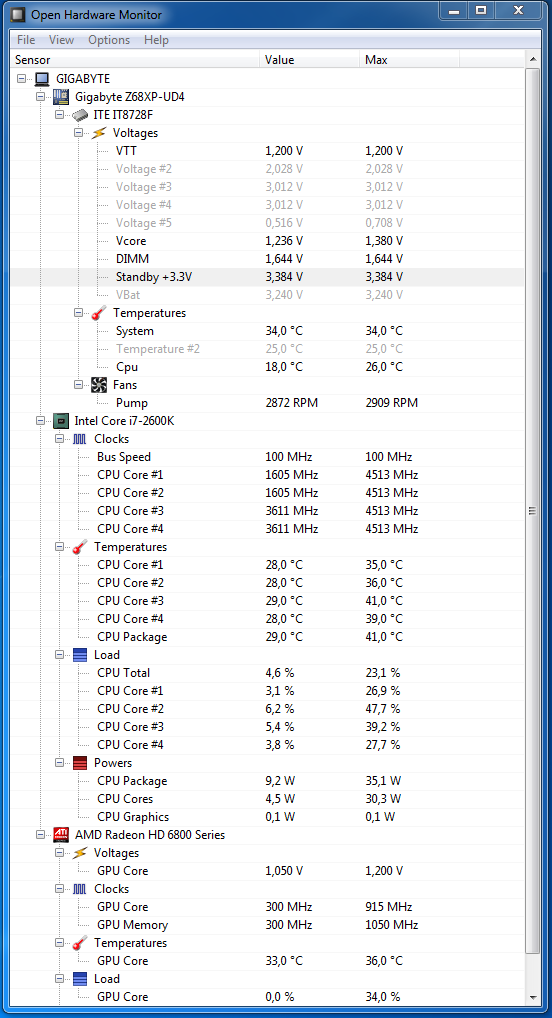

mm67 Posted February 4, 2012 Share Posted February 4, 2012 I added your chipset profile into plugin. Check the repository. Now Cpu heatsink is showing value that is labeled as System in Windows programs, Motherboard is showing that disconnected sensor and real Cpu heatsink is missing. I had Prime95 running in background and I know that real Vcore value on full load is 1.380 V, correct Dimm voltage is probably 1.64 V, it is set to 1.65 V in bios. I have a feeling that now only temperatures of first two cores are shown two times, third core on my cpu always runs warmer than others. Fan speed reading and Radeon temperature seem to be correct. Here is same situation with old FakeSMC: Voltages are wrong here also but temperatures are correct because I rearranged names in IT87x.kext Info.plist.zip Link to comment https://www.insanelymac.com/forum/topic/275429-hwsensors/#findComment-1792693 Share on other sites More sharing options...

kozlek Posted February 4, 2012 Author Share Posted February 4, 2012 Now Cpu heatsink is showing value that is labeled as System in Windows programs, Motherboard is showing that disconnected sensor and real Cpu heatsink is missing. I had Prime95 running in background and I know that real Vcore value on full load is 1.380 V, correct Dimm voltage is probably 1.64 V, it is set to 1.65 V in bios. I have a feeling that now only temperatures of first two cores are shown two times, third core on my cpu always runs warmer than others. Fan speed reading and Radeon temperature seem to be correct. Here is same situation with old FakeSMC: Voltages are wrong here also but temperatures are correct because I rearranged names in IT87x.kext Info.plist.zip DIMM voltage is really could be something else. Could you run OpenHardwareMonitor in Windows and get a screenshot? Link to comment https://www.insanelymac.com/forum/topic/275429-hwsensors/#findComment-1792732 Share on other sites More sharing options...

mm67 Posted February 4, 2012 Share Posted February 4, 2012 DIMM voltage is really could be something else. Could you run OpenHardwareMonitor in Windows and get a screenshot? I see now what is happening, you are using channels 1 & 2 as Vcore and Dimm voltage, but they are actually on channels 6 & 7. Link to comment https://www.insanelymac.com/forum/topic/275429-hwsensors/#findComment-1792738 Share on other sites More sharing options...
