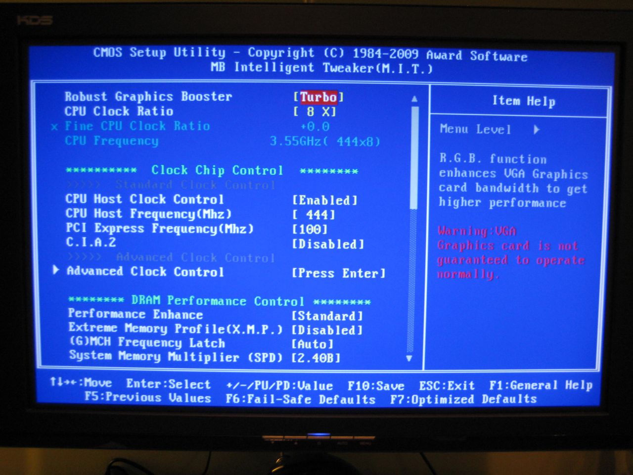

MEAT & POTATOES - Intel Core 2 Quad Q9450 Yorkfield 2.66GHz (Clocked@ 3.55GHz) LGA 775 95W | Arctic Cooling Freezer 7 Pro 92mm CPU Cooler | GIGABYTE GA-EP45-UD3P (REV 1.6) | G.SKILL 8GB DDR2 1066 (PC2 8500) F2-8500CL5D-4GBPK | eVGA GeForce 8800 GT 512MB GDDR3 (512-P3-N801-AR) | MSI GeForce 8500 GT 256MB GDDR2 (NX8500GT-MTD256EH)
CASE - Antec Nine Hundred Black Steel ATX Mid Tower Case | Antec TPQ-850 850W Power Supply (TPQ-850)

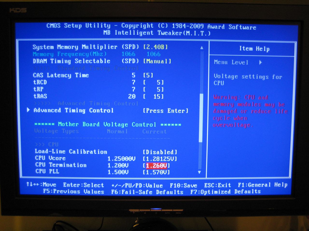

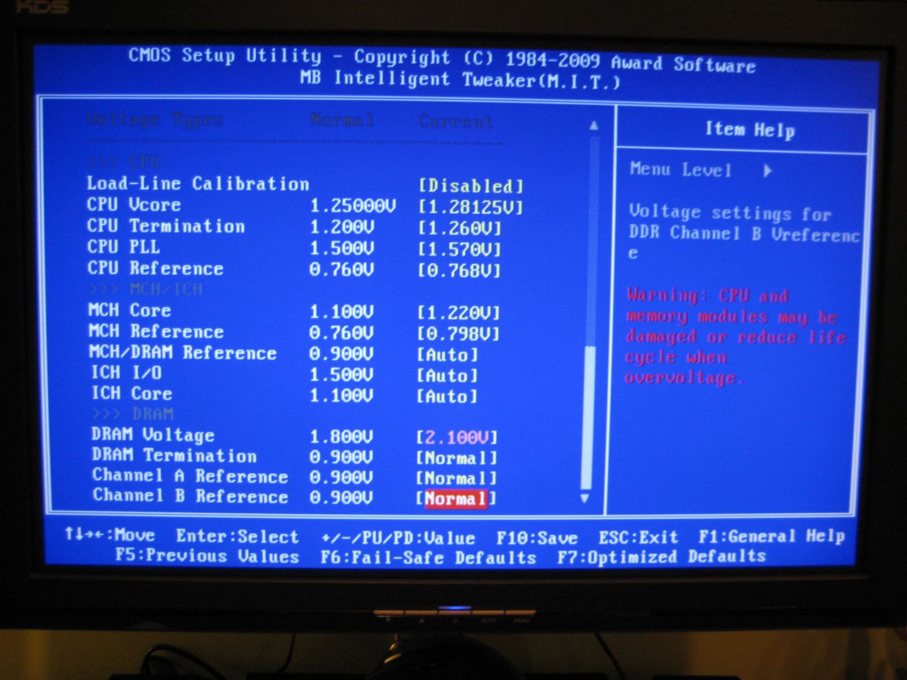

OTHER GOODIES - Dual Sony Optiarc 22X SATA DVD Burners | D-Link DBT-120 B4 USB Bluetooth | Rosewill RCR-FD200 All-in-one USB 2.0 Black 3.5" Card Reader with 1.44MB Floppy Drive
I noticed you are using the same kind of RAM I am.
I had a really diffucult time getting the ram to work at 1066mhz. I finally got it working but i'm curious what bios settings you used to get it to post at 1066.
My biggest issue is that the system wouldn't post with the MCH set to 1.4 which is what gskill suggested
If you have a minute would you mind pming me with your bios settings so i can compare?
Thanks in advance.

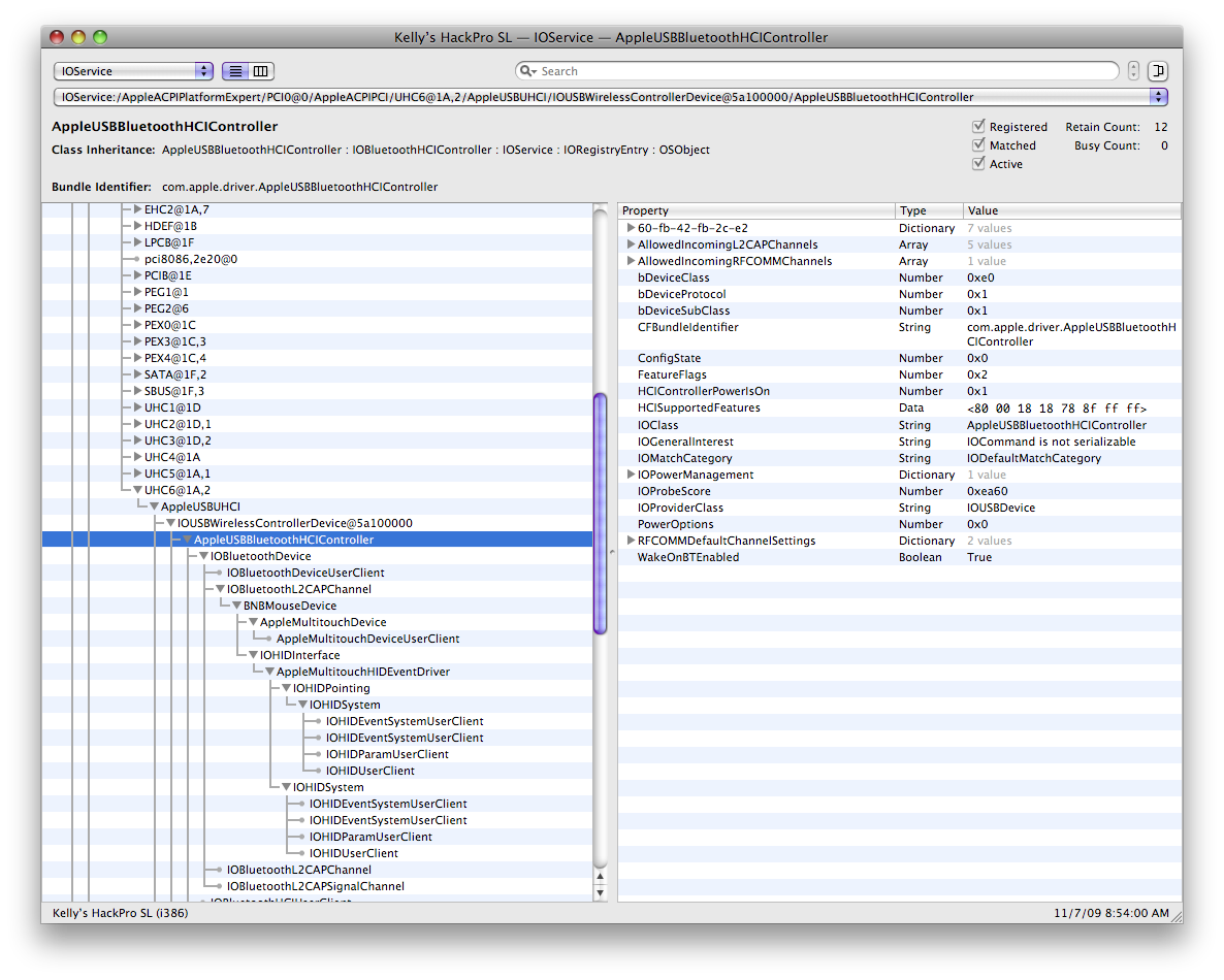

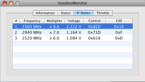

So are there any users whose keyboards/mice LEDs light up as they press a key after the computer has been shut down by Snow Leo? (Negatives are important too, so please, report, but in a non-polluting way, so make your posts have something else in them.)
Thanks in advance.
Here you go. Be sure to juice the RAM at the correct voltage. 2.1v - 2.2v Gigabyte MOBOs want to undervolt at the default settings. Also make sure the timings are right. The board sets those wrong sometimes too 5,5,5,15
post-16858-1257632096_thumb.jpgpost-16858-1257632103_thumb.jpgpost-16858-1257632108_thumb.jpg
I have had a similar issue with 10.5.8 but I can't remember for the life of me how I fixed it!
I shut down my hack one night and turned the light off, turned around to say "goodnight" to my hack, and noticed my caps lock LED was on. So I rebooted and shutdown and the light stayed on.
I seem to remember tinkering at the time with OHR and Sleep enabler kexts to fix the USB device removal error.
Since I checked to make sure all my kexts were up-to-date and after getting my USB ports to sleep properly it has been fixed.
never noticed this though since running SL

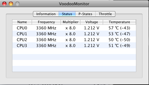

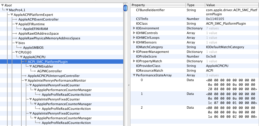

If you are using MP4,1 and no Legacy SMC_PlatformPlugin, you will certainly lost speedstep.
There is no Step2_0 data in your ioreg, as what i said before,
"I dont know if the new macpro4,1 is using variable speeds on power demand or if it can be enable/disable in someway, i dont see the StepData in the macpro4.1 ioreg."
So i need to add MacPro4,1 to PLimitDict=0 and StepDataDict=SP1 to enable speedstep,
