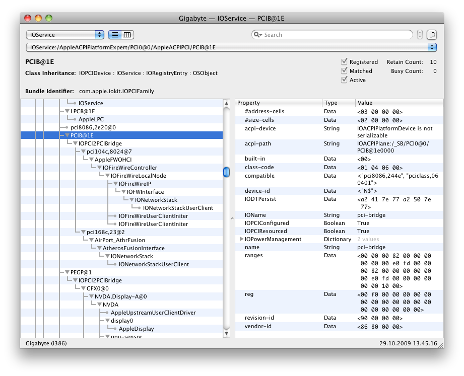

keeza Posted October 29, 2009 Share Posted October 29, 2009 mm67 I've sort of worked out why your code hasn't worked for me - there is an issue with Device HUB0 (or PCIB). With your latest dsdt stepping wouldn't work for me. Also do you have your Firewire Bus showing under system profiler? Both of these have been fixed and I'll attach my dsdt when I get a chance to incorporate MC's optimisations into it. Link to comment https://www.insanelymac.com/forum/topic/192518-dsdt-fixes-for-gigabyte-boards/page/13/#findComment-1313859 Share on other sites More sharing options...
mm67 Posted October 29, 2009 Share Posted October 29, 2009 mm67 I've sort of worked out why your code hasn't worked for me - there is an issue with Device HUB0 (or PCIB). With your latest dsdt stepping wouldn't work for me. Also do you have your Firewire Bus showing under system profiler? Both of these have been fixed and I'll attach my dsdt when I get a chance to incorporate MC's optimisations into it. Both PCIB and Firewire work as you can see, Firewire is also visible in System Profiler. And I know that Firewire works since I usually have a WD external HD connected to it. Link to comment https://www.insanelymac.com/forum/topic/192518-dsdt-fixes-for-gigabyte-boards/page/13/#findComment-1313866 Share on other sites More sharing options...

keeza Posted October 30, 2009 Share Posted October 30, 2009 Kinda stuck again, I've attached two folders: One contains a shortened dsdt with MC's additions but for some reason doesnt work yet on my system. Problem one: "Unable to list firewire devices" in red text appears in System Profiler under Firewire but appears OK in Ioreg. Problem two: P-States dont step, temps around 45 degrees. Problem three: Grab doesnt show anything (hence why I cant attach screenshots) The other folder contains a working dsdt which fixes problems 1&2 above but is based on my original dsdt and is very long. Problem 3 remains. I suspect the problem is based around Device PCIB. Whenever I remove the LNKA etc blocks of code then that causes the issues. Everything else is the same between the two. My only other alternative is to go back to my pre SMBus dsdt which works fine. Keeza.zip Link to comment https://www.insanelymac.com/forum/topic/192518-dsdt-fixes-for-gigabyte-boards/page/13/#findComment-1314505 Share on other sites More sharing options...
