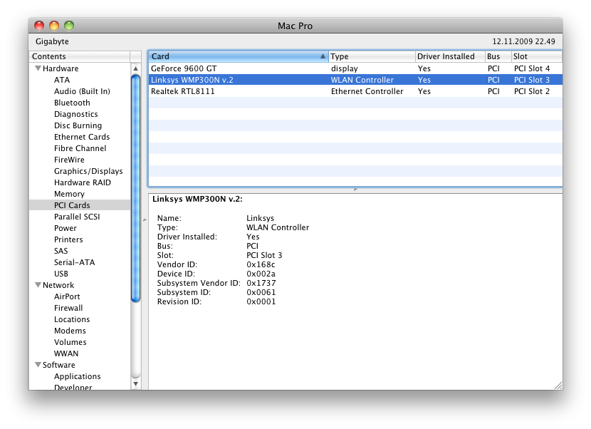

how bout this image below, can this be fix via dsdt? just want the product name to appear if possible D
card is Linksys WMP300N, works flawlessly BTW only after you edit and add (4329) on broadcom's info.plist. already added LAN, and GFX (screenshot) on my dsdt so might as well add my wireless card.
Thanks in advance :)
You want something like this ?
Mine is the Atheros version, with dsdt injection works fine using both 32- and 64-kernels.
that's exactly what i want mm67 :)
This is how I did it:
                Device (WLAN)
                   Name (_ADR, 0x00020000)
                   Name (_SUN, 0x3)
                       Store (Package (0x08)
                               "device-id",
                               Buffer (0x04)
                                   0x2a, 0x00, 0x00, 0x00
		                    "device_type",
	                        "WLAN Controller",
		                    "model",
	                        "Linksys WMP300N v.2",
		                    "name",
	                        "Linksys"
                           }, Local0)
                       Return (Local0)
On my board this is located under device PCIB(HUB0), you must check the place and address from IORegistry. And remember that the device-id is for Atheros version, you will want to replace that with Broadcomm value or remove it.
thanks mm67,
ah finally after a few tries it showed on my system profiler, what did the trick was changed from (0x00020000) to (0x00010000).. noob ;)
any way to changed the "slot"? i want ethernet to changed as "PCI" only including the WPM300N to be uniform.
or like your screenshot posted
ethernet = PCI slot 1
WMP300N = PCI slot 2
using EthernetBuiltIn=Y on my LAN BTW.

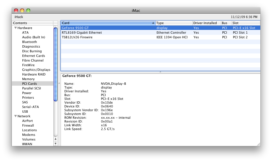

Do you mean something like this?
I did this using 2 different ways. This one uses the _SUN line but as mm67 noted PCI Slot 1 will always be shown as just PCI.
				Device (FRWR) // FireWire
				Name (_ADR, 0x00010000)
				Name (_SUN, 0x2)
					Store (Package (0x06)
						"device-id",
						Buffer (0x04)
							0x20, 0x80, 0x00, 0x00
						"name",
						"Texas Instruments",
						"model",
						"TSB12LV26 Firewire"
					}, Local0)
					MCDP (Arg2, RefOf (Local0))
					Return (Local0)
Or the second way is to omit the _SUN line and use the AAPL,slot-name and put whatever string you like.
				Device (GIGE) // Ethernet
				Name (_ADR, 0x00000000)
						"device-id",
						Buffer (0x04)
							0x69, 0x81, 0x00, 0x00
						"AAPL,slot-name",
						"PCI Slot 1",
						"name",
						"Realtek",
						"model",
						"RTL8169 Gigabit Ethernet"
					}, Local0)
					Return (Local0)
This is how I got the video card to show PCI-E x16 Slot.
			Device (PEGP)
			Device (GFX0)
					Store (Package (0x02)
						"AAPL,slot-name",
						"PCI-E x16 Slot"
					}, Local0)
					Return (Local0)

im going with this look, forgot to edit out "PCI-E" on my ethernet but the slot assignment will be the same. Thanks a lot mm67 and audisport for all the help :)
BTW tried changing "display" on my graphic card type and got a black screen after boot, dont know if it can be replaced but i'll stop for now.
According to this thread I found when I was searching on this earlier it is done by standard and cannot be changed.
http://www.insanelymac.com/forum/lofiversi...hp/t134842.html
Your DWA-556 should work just fine. I have a DWA-552 that's work but you have to add your device-I'd to the atheros driver as well as add it into your DSDT. I actually use a legacy kext to inject the ID but you should still add the device via DSDT. I'm on my iPhone so im away from my machine. I'll get the details as soon as I can.
kdawg, the dwa-556 works perfectly well. It only becomes dead after a wake from sleep (need to reboot to wake it again), which renders sleep useless.
What I just noticed is that I have the same issue in Windows 7.. So maybe it is a faulty card. Don't think D-Link releases firmware so I can reprogram the PROM in case of a faulty card :(
(I was using the Atheros 64 bit driver before 10.6.2 was released and I added the device ID to the drivers plist to make it work. After updating to 6.2 it just worked. Or the driver wasn't overwritten by the update because it was already the correct version. Or Apple has added my device id in the final update)
