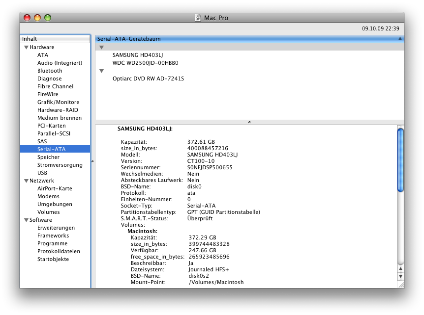

FKA Posted November 11, 2009 Share Posted November 11, 2009 question to all, been looking at few posted SATA screenshots here and i notice that my board doesn't display anything? i mean on some boards it list ICH10/R, ICH9, 3gb speed etc but on my board it's just empty.. could it be because my board dont have AHCI selection? already change my "Device (IDE1)" to "SATA" and add my device ID but it didnt do anything or im not doing it right.. here's my SATA section in system profiler and ioregistry if it helps. Thanks. Are you using port or blockstorage injector kexts? D. Link to comment https://www.insanelymac.com/forum/topic/192518-dsdt-fixes-for-gigabyte-boards/page/19/#findComment-1327380 Share on other sites More sharing options...
sk1nhead Posted November 11, 2009 Share Posted November 11, 2009 Are you using port or blockstorage injector kexts? D. im not using any kext like that, i believe its been that way since Leopard. The kext im using right now are fakesmc, legacyALC883, evoreboot and voodoomonitor.. could be because my BIOS doesnt have AHCI section to choose from? looking at my screenshot, im running on SATA right and on 3GB speed? on snow leopard 10.6-.6.2 it's been like that on my system profiler with or without dsdt editing. here's the option on my bios (good thing the manual is here) On-Chip Primary PCI IDE - disabled since i dont use any ide devices On-Chip SATA Mode - choices are (Enhanced, Auto, Combined, Non-Combined, Disabled).. im using enhance but tested every one of them except disabled off course :-) SATA drives too (1Tb and 640Gb) are connected on port 0 and 1 while my Lightscribe ODD is on 2, my board only has 4 sata ports (0-3) and 1 IDE. Link to comment https://www.insanelymac.com/forum/topic/192518-dsdt-fixes-for-gigabyte-boards/page/19/#findComment-1327436 Share on other sites More sharing options...
FKA Posted November 11, 2009 Share Posted November 11, 2009 On-Chip Primary PCI IDE - disabled since i dont use any ide devicesOn-Chip SATA Mode - choices are (Enhanced, Auto, Combined, Non-Combined, Disabled).. im using enhance but tested every one of them except disabled off course :-) Any other ICH7 users have this quirk!? On another note - I've just bought an ATI 4850 1GB DDR3 (£55 new - bargain!) I'm using netkas's legacyATI4800 kext to inject device ID - it works an absolute treat and frankly I'm glad to see the back of the pedestrian 9500 GT ! 2 questions: Has anybody used _DSM to inject the device ID for ATI 48** cards? Off hand - does anybody know what audio chipset the ATI 4850 uses for HDMI audio? 01:00.1 Audio device: ATI Technologies Inc Unknown device aa30 D. Link to comment https://www.insanelymac.com/forum/topic/192518-dsdt-fixes-for-gigabyte-boards/page/19/#findComment-1327770 Share on other sites More sharing options...
nrgexplosion Posted November 11, 2009 Share Posted November 11, 2009 The HDMI out on the 4800 series cards is an integrated RealTek chip. I have no idea what the device id it though. I have never gotten it to work on mine in osx, we could probably get more info from the windows side. Any other ICH7 users have this quirk!? On another note - I've just bought an ATI 4850 1GB DDR3 (£55 new - bargain!) I'm using netkas's legacyATI4800 kext to inject device ID - it works an absolute treat and frankly I'm glad to see the back of the pedestrian 9500 GT ! 2 questions: Has anybody used _DSM to inject the device ID for ATI 48** cards? Off hand - does anybody know what audio chipset the ATI 4850 uses for HDMI audio? 01:00.1 Audio device: ATI Technologies Inc Unknown device aa30 D. Link to comment https://www.insanelymac.com/forum/topic/192518-dsdt-fixes-for-gigabyte-boards/page/19/#findComment-1327912 Share on other sites More sharing options...
eberts Posted November 11, 2009 Share Posted November 11, 2009 Any other ICH7 users have this quirk!? Yes, when I booted the vanilla snow dvd (with bootcdmaker-cd) I could see my hard drives and dvd-drive in system profiler but the controller didn't show up. My board has an ICH7 whithout AHCI too. Link to comment https://www.insanelymac.com/forum/topic/192518-dsdt-fixes-for-gigabyte-boards/page/19/#findComment-1327937 Share on other sites More sharing options...
AudiSport Posted November 11, 2009 Share Posted November 11, 2009 Any other ICH7 users have this quirk!? I see the same thing on my ICH7. Link to comment https://www.insanelymac.com/forum/topic/192518-dsdt-fixes-for-gigabyte-boards/page/19/#findComment-1327957 Share on other sites More sharing options...
