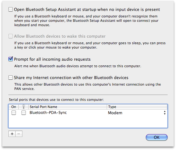

Here's a problem which I think is a DSDT problem. I just bought a Magic Mouse and wanted to get it to wake via Bluetooth (D-Link DBT-120, hardware revision B4). Currently I don't have a problem waking my machine via wired mouse or keyboard. And this is the only approved Bluetooth dongle that will allow wake from USB. So when I plug the dongle into my MacBook, Mac Mini or eMac the "Allow Bluetooth devices to wake this computer" is available. However when I plug it into my OSX86 machine it's greyed out. Anyone have any ideas? I have all my USB/EHCI/UHCI devices show up as built-in.

Hi Kdawg
You shouldn't need device id BUT Try this:
Interesting. Let's start by teaching me something. How do you get that image to show up there?
Anyway. We first need the IORegistryExplorer output of both machines. You may PM me if you want to share it privately, in a place where you can remove it afterwards.
p.s. I might get one myself, for my hack, but only after it works for you :)

question, any gigabyte user using Apple aluminum keyboard who has successfully waken their system from sleep? this is my problem since i changed my old white apple KB to aluminum one? regular USB mouse, PC keyboard and my white apple KB wakes my system fine except this pesky aluminum one hehe.. also how do you enter your bios? i have the slim keyboard w/o numpad and it doesnt have a delete key (only backspace) so i switch keyboard whenever i wanna enter my bios which is really a pain sometime.. also my boards dsdt has only USB0-USB3 (now UHC1-UHC4) and USBE (now UHCI), could that be the reason maybe?
Looks like someone beat me to the "How to post a image tutorial".
So I did some research on the Bluetooth issue. It seems I jumped the gun. I had a PM from kmare saying he had the same problem but his worked in Leopard. So I was like wait a minute! I rebooted into my old 10.5.8 Leopard install and sure enough the "allow bluetooth wake" function works. So I took two ioreg dumps. One from 10.6.1 and one from 10.5.8. The best I can make out is they indeed rewrote some of the bluetooth drivers. In 10.5 it's called CSRUSBBluetoothHCIController.kext in 10.6 they're calling it AppleUSBBluetoothHCIController.kext it seems they operate a bit differently. Hopefully this is just a bug Apple will soon fix.
MC I sent the ioreg dumps to you via PM for your examination.
One has PowerOptions set to 0 and the other has 15 which also appears to be the working one, so I would start by adding this property in the Info.plist of AppleUSBBluetoothHCIController.kext and see if it changes anything.
p.s. I might get one myself, for my hack, but only after it works for you :D
