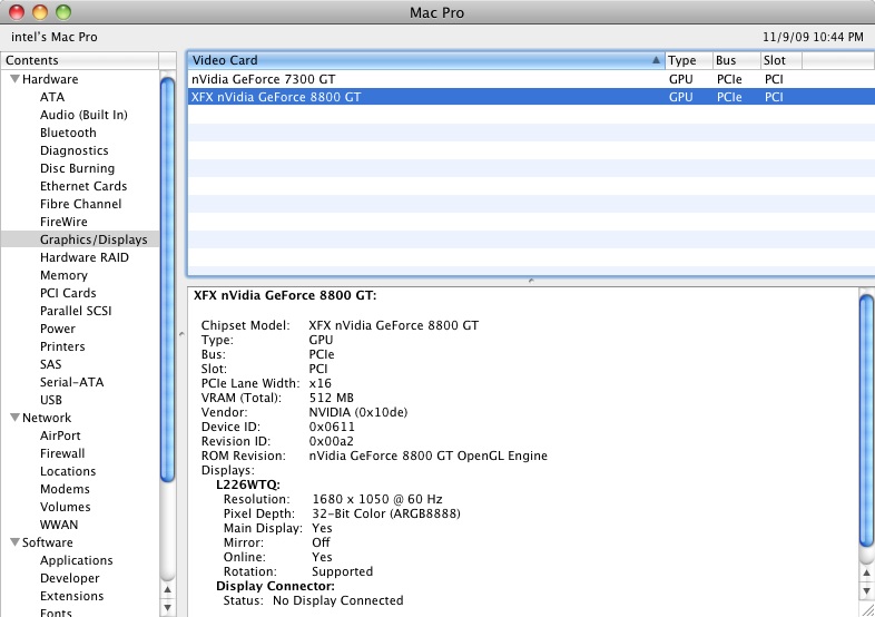

Could you tell me how to get two graphic cards working? Using GFX String or GFX DSDT? If using DSDT, can you teach me how to? I will try on my EP35-DS3P.
Thank you.
Give me some time. I'll try and help you out. In the meantime gather your DSDT, ioreg dumps and whatever else you got and send me an IM link.
@ kdawg
Thank you very much for your kindness and sorry for asking your help.
Now I got two graphic cards working via GFX DSDT. I looked at Window properties. PCIE x16 is PCIROOT(0)#PCI(0100)#PCI(0000) and PCIE x4 is PCIROOT(0)#PCI(1C00)#PCI(0000). I also looked at IODeviceTree of IORegistryExplorer and I saw PEX0@1C. After that I tried to edit my DSDT by adding Device (GFX0) in Device (PEX0) and then they ware working. Previously I tried to make it many times and I couldn't make it. Just got it working today.
@ kdawg
So is it GraphicsEnabler=y that is letting you use them now? Don't forget to post your DSDT.
@ kdawg
I forgot to remove GraphicsEnabler=y from com.apple.Boot.plist while I used DSDT with two GFX0s. Then, I removed GraphicsEnabler=y and changed something in DSDT. Now it's working fine. I can wake up from sleep. I remember if I used GraphicsEnabler=y, I got blank screen after waking up. This happened on my EP35-DS3P.
In contrast, I have to use GraphicsEnabler=y or GFX string for my HD4870 on EP45-UD3R.

@tmongkol, are you able to wake up your monitor after letting the comp sleep overnight?
@ iSoprano
I have never tried yet. I will try and let you know later.
/updated
I tested waking up my EP35-DS3P and it's working. I typed this message after waking up the system. This is my log after waking up from sleep. I will try it more longer and see what will be.
