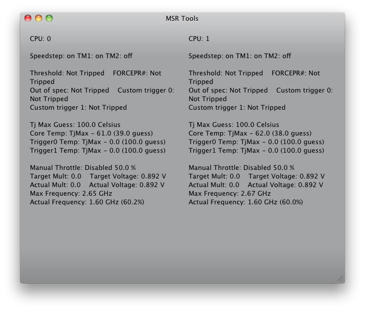

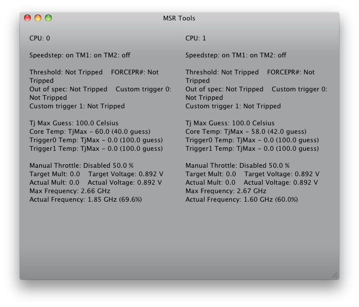

xjasx Posted November 4, 2009 Share Posted November 4, 2009 Having some trouble with my PR scope, i've been using iSoprano's PR scope from original post, but decided I'd switch it up to how Master Chief does it... Scope (_PR) { Processor (CPU0, 0x00, 0x00000410, 0x06) {} Processor (CPU1, 0x01, 0x00000410, 0x06) {} Processor (CPU2, 0x02, 0x00000410, 0x06) {} Processor (CPU3, 0x03, 0x00000410, 0x06) {} } Scope (_PR.CPU0) { Method (_PSS, 0, NotSerialized) { Return (Package(0x06) { Package (0x06) { 0, 0, 10, 10, 0x4820, 0 }, Package (0x06) { 0, 0, 10, 10, 0x081E, 1 }, Package (0x06) { 0, 0, 10, 10, 0x471C, 2 }, Package (0x06) { 0, 0, 10, 10, 0x071A, 3 }, Package (0x06) { 0, 0, 10, 10, 0x4618, 4 }, Package (0x06) { 0, 0, 10, 10, 0x0616, 5 } }) } Method (_CST, 0, NotSerialized) { Return (Package (0x02) { One, Package (0x04) {ResourceTemplate () {Register (FFixedHW, 0x1, 0x2, 0x0, 0x1,)},0x01,0x9D,0x3E8} }) } } Scope (_PR.CPU1) { Method (_CST, 0, NotSerialized) { Return (Package (0x04) { 0x03, Package (0x04) {ResourceTemplate () {Register (FFixedHW, 0x01, 0x02, 0x000, ,)},0x01,0x01,0x3E8}, Package (0x04) {ResourceTemplate () {Register (FFixedHW, 0x08, 0x00, 0x414, ,)},0x02,0x01,0x1F4}, Package (0x04) {ResourceTemplate () {Register (FFixedHW, 0x08, 0x00, 0x415, ,)},0x03,0x55,0x0FA} }) } } Scope (_PR.CPU2) { Method (_CST, 0, NotSerialized) { Return (^^CPU1._CST ()) } } Scope (_PR.CPU3) { Method (_CST, 0, NotSerialized) { Return (^^CPU1._CST ()) } } Originally i did not include the _PSS, and even with it, the speedstep isnt there, BUT cpu2 and 3 will jump between x6 and x9 multipliers (C1E state) doesn't make sense to me because aren't CPU2 and 3 just referring to code in CPU1? Link to comment https://www.insanelymac.com/forum/topic/192518-dsdt-fixes-for-gigabyte-boards/page/15/#findComment-1319436 Share on other sites More sharing options...
Master Chief Posted November 4, 2009 Share Posted November 4, 2009 Having some trouble with my PR scope, i've been using iSoprano's PR scope from original post, but decided I'd switch it up to how Master Chief does it... <snip /> Originally i did not include the _PSS, and even with it, the speedstep isnt there, BUT cpu2 and 3 will jump between x6 and x9 multipliers (C1E state) doesn't make sense to me because aren't CPU2 and 3 just referring to code in CPU1? You forgot to add (removed?) _PSS objects! Here's an example: Processor (CPU3, 0x03, 0x00000410, 0x06) { Alias (\_PR.CPU1._PSS, _PSS) Alias (\_PR.CPU2._CST, _CST) } as the above code (example) is what you need for P state support (first Alias) and C state support (second Alias). And thus only two instead of the usual eight lines Tip: Get rid of unnecessary Scope statements (to improve the readability). Hi,I have not changed the BIOS recently, It is the same one I used in 10.5.7 without "verifying dmi pool data" showing up. As for the model identifier I did change it in the SMBIOS.plist in Extra folder, which I changed back to what it was but this did not change anything. Yes I did encounter the CMOS reset bug which I took care of by changing values in device RTC in DSDT. After that I needed to re-enter everything in CMOS setup as per my preferences. This "verifying dmi pool data" thing is same with every iteration of DSDT I have used. Now I am beginning to think it might even be Chameleon bootloader with PC-EFI v10.5. Because I used the much older one on Leopard previously. If this would have been caused by the boot loader, then others people here would have complained long before you. Don't you agree? I would say re-check your BIOS settings one more time (using the default settings as a starter). Link to comment https://www.insanelymac.com/forum/topic/192518-dsdt-fixes-for-gigabyte-boards/page/15/#findComment-1319447 Share on other sites More sharing options...

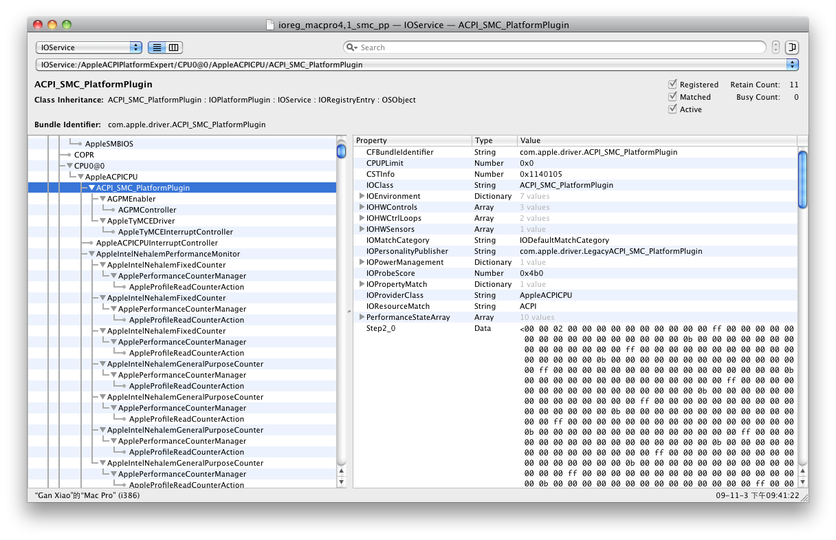

ganxiao Posted November 5, 2009 Share Posted November 5, 2009 Hi all, i found something very interesting!!! On some gigabyte mainboard, SSDT table depends on feartures you enabled in bios. I have cst errors in post screen when boot 10.6.1 on my ex58-ud4 platform previously. Turbo boost feature didn't work on my i7 920 in SL either. I realized that's due to lack of c-state info in ssdt, and noticed someone claimed he got rid of those annoiying messages by enable c states in bios. After hack the AppleLPC.kext and enable C3/C6/C7 state support in bios, those messages are gone, and it seems c-states gonna work. I got CSTInfo in ioreg, and have to remove irq under PIC/RTC/TMR to solve issue of sound distort and interrupt conficts. Geekbench 64bit score increased from 9000 to 9500, and msr tool show turbo boost active. After compared ssdt table before and after c state enabled in bios, i noticed ssdt table was different, Name (CSEN, 0x00000000) change to Name (CSEN, 0x00000001), Method (_CST, 0, NotSerialized) appears after c stats enabled in bios. Still need to hack SMC_Platform_Plugin to enable speedstep course i use macpro4,1 in smbios.plist. CST_Disable_in_BIOS.zip CST_Enable_in_BIOS.zip In conclude, gigabyte user may not need to mod ssdt and add it to dsdt to get c-state and p-state work. Vanilla C-state and speedstep should work w/o dsdt smc_plugin and lpc hacks on some giga MB. gigabyte has implemented ssdt table well enough for osx, what we need to do is: 1. enable C1E, EIST, C3/C6/C7 support in bios to produce proper ssdt table, enable turbo boost if using i7 cpu 2. use macpro3,1 in smbios.plist, then you may not need smc_plugin hack 3. hack LPC if needed (my EP43-UD3L do not need hack, device id 3a18 is the same as apple's, but EX58-UD4 need) @masterchief your dsdt mod is really excellent, good job!! I'm merging those mods to my i7 platform. Link to comment https://www.insanelymac.com/forum/topic/192518-dsdt-fixes-for-gigabyte-boards/page/15/#findComment-1320846 Share on other sites More sharing options...
FKA Posted November 5, 2009 Share Posted November 5, 2009 In conclude,gigabyte user may not need to mod ssdt and add it to dsdt to get c-state and p-state work. Vanilla C-state and speedstep should work w/o dsdt smc_plugin and lpc hacks on some giga MB. gigabyte has implemented ssdt table well enough for osx, what we need to do is: 1. enable C1E, EIST, C3/C6/C7 support in bios to produce proper ssdt table, enable turbo boost if using i7 cpu 2. use macpro3,1 in smbios.plist, then you may not need smc_plugin hack 3. hack LPC if needed (my EP43-UD3L do not need hack, device id 3a18 is the same as apple's, but EX58-UD4 need) @masterchief your dsdt mod is really excellent, good job!! I'm merging those mods to my i7 platform. Hi ganxiao Firstly this thread is about DSDT mod's ... i.e. not hacking the AppleLPC.kext but adding LPC device id to DSDT. Secondly - good for you if you don't need to make any additions to DSDT to get C-and P-states working Thirdly - how have you proved that your P and c states are actually working ? Last but not least - do you think p-states are related to enabling the C.I.A.2 function in BIOS? I have to admitt I hadn't thought about this before! D. Link to comment https://www.insanelymac.com/forum/topic/192518-dsdt-fixes-for-gigabyte-boards/page/15/#findComment-1320886 Share on other sites More sharing options...
ganxiao Posted November 5, 2009 Share Posted November 5, 2009 Hi ganxiao Firstly this thread is about DSDT mod's ... i.e. not hacking the AppleLPC.kext but adding LPC device id to DSDT. Secondly - good for you if you don't need to make any additions to DSDT to get C-and P-states working Thirdly - how have you proved that your P and c states are actually working ? Last but not least - do you think p-states are related to enabling the C.I.A.2 function in BIOS? I have to admitt I hadn't thought about this before! D. Hi FormerlyKnownAs, Thanks for your quick reply, Fisrt My bad! when i say hacking the AppleLPC.kext, i mean adding LPC device id to DSDT actually, but adding LPC device id to AppleLPC.kext's plist also works. Second Yes, I didn't need to make any additions to DSDT to get P-states working, I'm not sure if C-states did work, maybe you can tell how to verify that, but i indeed get rid of those cst errors. here is dsdt i am using now dsdt.aml.zip Third Here is a snapshot of ioregistryexplorer Here is i7 920 @ 1.6GHz, lowest frequency in SL and windows Here is when turbo boost activated, i7 920 @ 2.8GHz, 1x mutiplier more than stock 2.66GHz here is i7 920 @ 1.83GHz, one of several middle states, which mean p-states really works Temperature is around 36 - 39 Celsius in idle, almost the same in windows Here is my ioreg dump for more details, ioreg_macpro4_1_smc_pp.zip Fourth When i use MacPro4,1 in smbios.plist, i don't have to use legacy AGPM kext to enable GPU throttle, It's enabled by default in MacPro4,1 What i did in my own made LegacyACPI_SMC_PlatformPlugin.kext is just add MacPro4,1 to PLimitDict=0 and StepDataDict=SP1 to enable speedstep, I dont know if the new macpro4,1 is using variable speeds on power demand or if it can be enable/disable in someway, i dont see the StepData in the macpro4.1 ioreg. Last but not least I don't think C.I.A.2 function has relationship with p-states, C1E and EIST enable p-states, C3/C6/C7 SUPPORT enable c-states, I noticed Gigabyte P35/P45 had a different SSDT table, it might not work in my way, and dgsga with ASUS X58 MB has same experience like me . Maybe it's only available in i7 platform, But i hope this could help you! Link to comment https://www.insanelymac.com/forum/topic/192518-dsdt-fixes-for-gigabyte-boards/page/15/#findComment-1320950 Share on other sites More sharing options...
Cathul Posted November 5, 2009 Share Posted November 5, 2009 This is how my SATA device looks in my dsdt.dsl at the moment: Device (SATA) { Name (_ADR, 0x001F0002) Method (_DSM, 4, NotSerialized) { Return (MCID (Arg2, 0x2681)) } } Guess i'll screw the bay information. It works great as it is at the moment. I don't have to use any injector for device ids and stuff like that. And tbh, i'll get my 24" iMac early 2009 generation with a radeon 4850 tomorrow evening. Guess i wont mess with a hack anymore when i have this iMac. Link to comment https://www.insanelymac.com/forum/topic/192518-dsdt-fixes-for-gigabyte-boards/page/15/#findComment-1320954 Share on other sites More sharing options...
FKA Posted November 5, 2009 Share Posted November 5, 2009 Last but not leastI don't think C.I.A.2 function has relationship with p-states, C1E and EIST enable p-states, C3/C6/C7 SUPPORT enable c-states, I noticed Gigabyte P35/P45 had a different SSDT table, it might not work in my way, and dgsga with ASUS X58 MB has same experience like me . Maybe it's only available in i7 platform, But i hope this could help you! I think you correct - there is a lot in your SSDT that isn't in the P35/45 ... I'm still interested in the Turbo boost feature your talking about - excuse my ignorance but are you talking about CIA2 in BIOS or something else? Cheers D. Link to comment https://www.insanelymac.com/forum/topic/192518-dsdt-fixes-for-gigabyte-boards/page/15/#findComment-1320963 Share on other sites More sharing options...
ganxiao Posted November 5, 2009 Share Posted November 5, 2009 I think you correct - there is a lot in your SSDT that isn't in the P35/45 ... I'm still interested in the Turbo boost feature your talking about - excuse my ignorance but are you talking about CIA2 in BIOS or something else? Cheers D. Turbo boost is a new feature introduced in Nehalem, check 1 2 for details. There is a "Intel® Turbo Boost Tech" option in my bios to enable this feature, CIA2 is auto-overclock function, it only increase fsb speed. But Turbo boost change mutipliers. BRs, Ganxiao Link to comment https://www.insanelymac.com/forum/topic/192518-dsdt-fixes-for-gigabyte-boards/page/15/#findComment-1320981 Share on other sites More sharing options...
