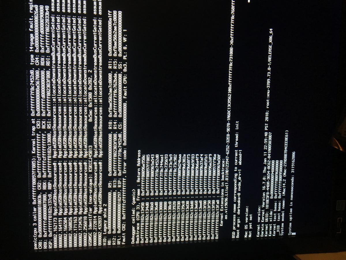

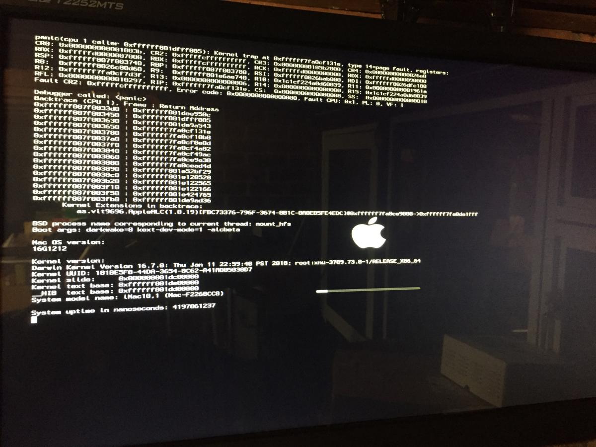

Was just wondering if anybody else has had trouble with the new security update for Sierra.
I am now unable to boot into the OS and get a panic very soon after powering on.
I've tried updating to the latest Clover. I believe it's 4380 as I write this. That however has not helped matters!
Was hoping to maybe get some ideas of what to try next.
Thanks in advance.
Oh and the offending machine is a 780 Core 2 Duo with a HD5450 graphics card.
Your AppleALC.kext is too old. Boot with this flag:
-alcoff
Then update to the latest one and install Lilu.kext too. It's now mandatory when using plugins like AppleALC.kext (read more here).
You might want to update Clover in the meantime as it now have an option to block ESP/CLOVER/kexts before macOS starts ;).
Thank you very much for the quick response, I really do appreciate the help you guys give!
I'd be lost trying to figure this stuff out.
I'll report back if that works either way!
Wooohooo,
I'm back in.
Nice one, Polyzargone
Thanks again.
@vdubbus77
KernelPanic by Lilu !!!
Lilu too old.
Boot with flag -liluoff -alcoff
... then renew Lilu and AppleALC !!!
Update Lilu to version 1.2.1 and AppleALC 1.2.2, then all right!
LayoutID 11 (0B) or even better (NEW) LayoutID 13 (0D) !!!
Optiplex works, yes.  :wub:
