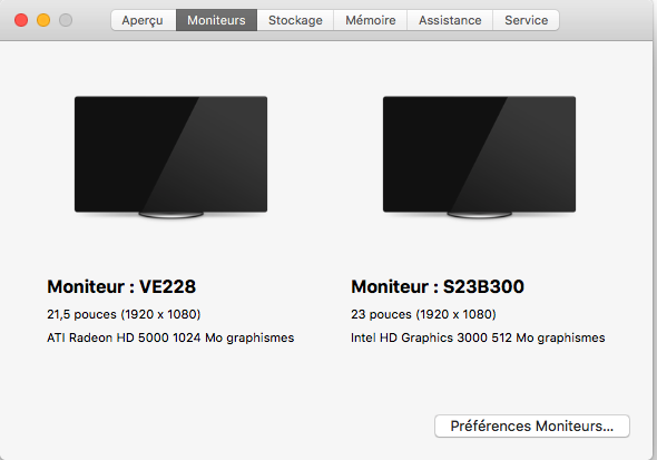

chris1111 Posted April 3, 2018 Share Posted April 3, 2018 No issue here Radeon HD 5570 and Intel HD3000 IGPU Duall screen works as usual 1 Link to comment https://www.insanelymac.com/forum/topic/312656-guide-macos-sierra-1012-dell-optiplex-780-760-755-790-990/page/61/#findComment-2607414 Share on other sites More sharing options...
