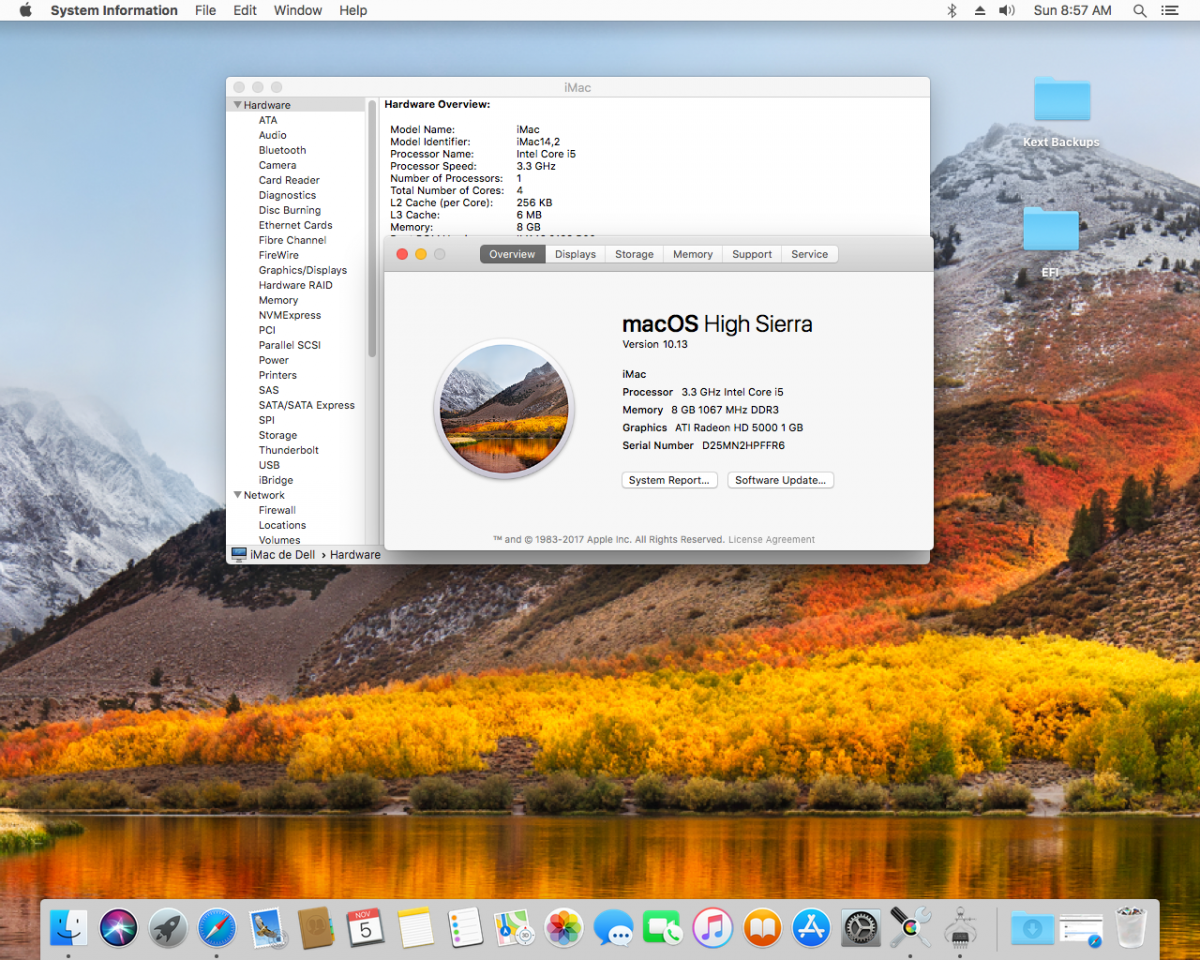

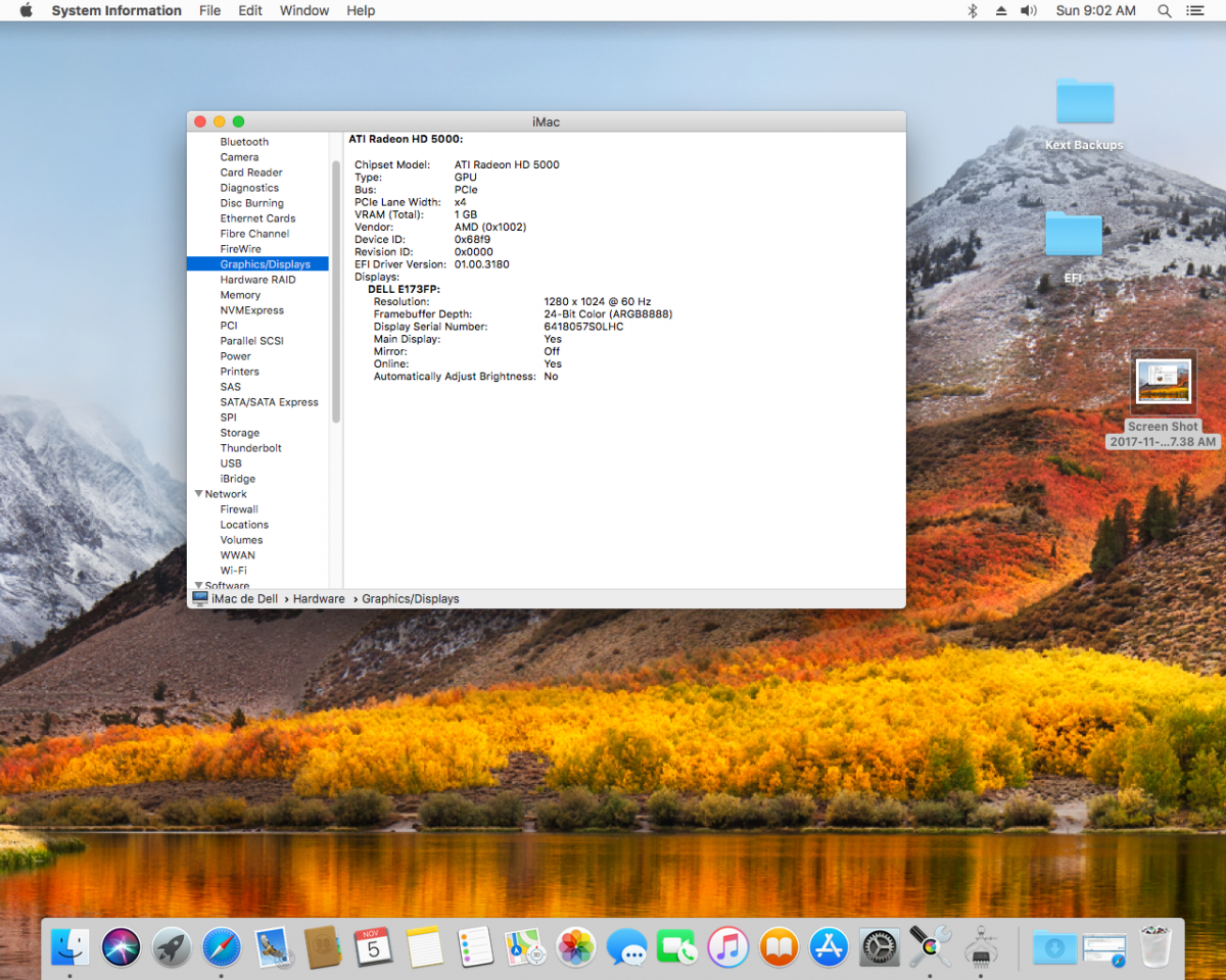

chris1111 Posted November 5, 2017 Share Posted November 5, 2017 @chris1111 I just want it to give you an update, after redoing the whole process I discovered that your EFI folder was the solution all along. Now my Sapphire HD5450 is recognize as ATI Radeon 5000 HD . Now the only problem I am trying to tackle is acceleration (I supposed), because when trying to watch a video in full screen I experienced a kind of 'choppiness' in the video. Also, when login a kind of black lines appear like cutting the screen. You have a black lines appear like cutting the screen at login on desktop ? I do not know which EFI folder to talk to you, I have sent several. could you upload the EFI folder that you use for your HD here you could also Upload the complete System Report in Apple Menu, about this Mac Also try to activate in the Bios /Video /Dual Display, maybe it will have an Impact, I do not know? As I told you, I have 2500k HD 3000 and all of my 4 graphics card ATI 5450 works! Since High Sierra you need a PC with both GPU for the ATI 5450 so you need for the kite roll Back 10.12 some kext and I do not know if the card works on a i5 2500 should take my CPU i5 2500 to test it and it's not me not interested Link to comment https://www.insanelymac.com/forum/topic/312656-guide-macos-sierra-1012-dell-optiplex-780-760-755-790-990/page/53/#findComment-2529389 Share on other sites More sharing options...

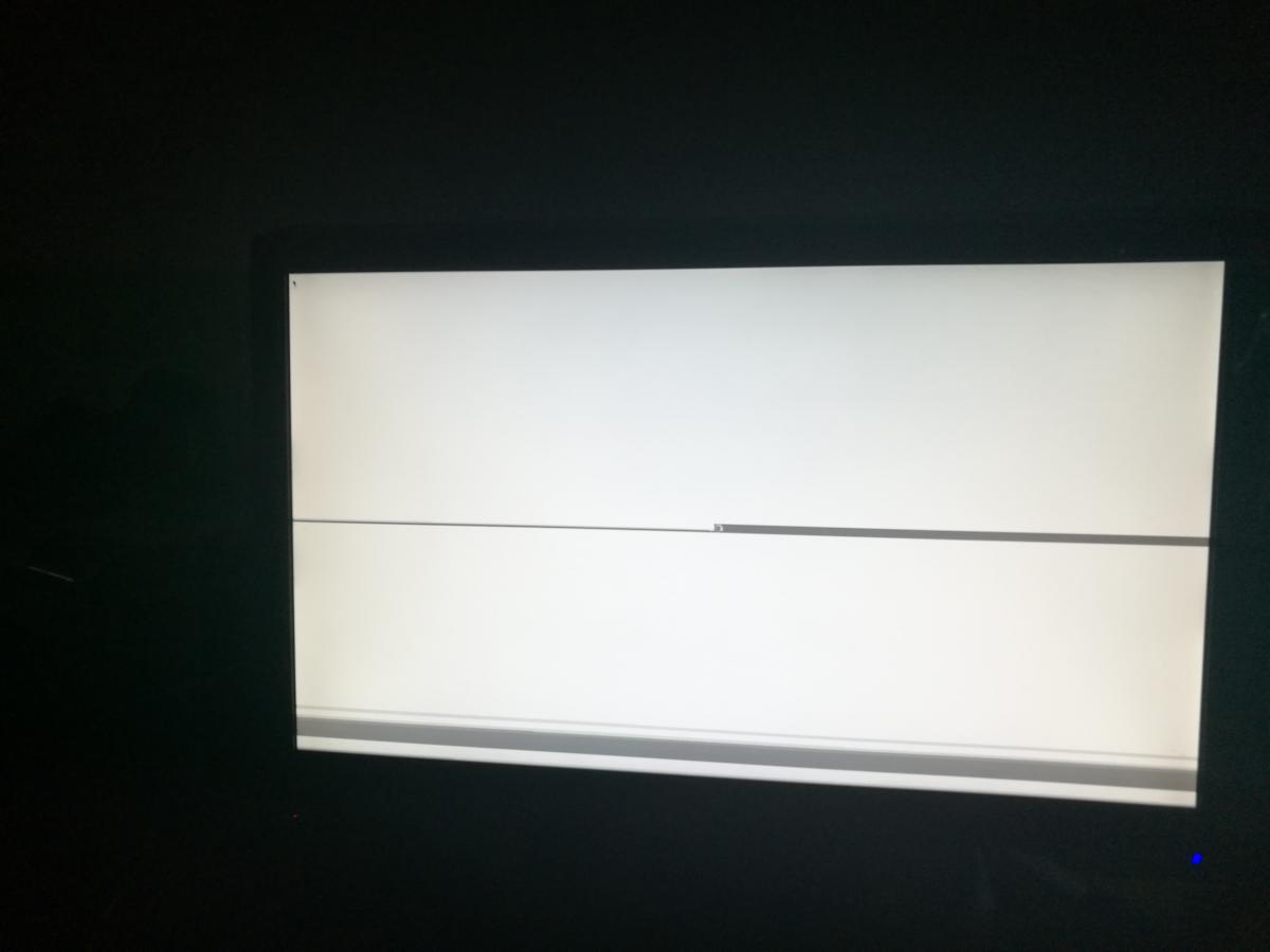

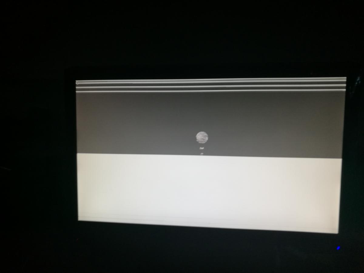

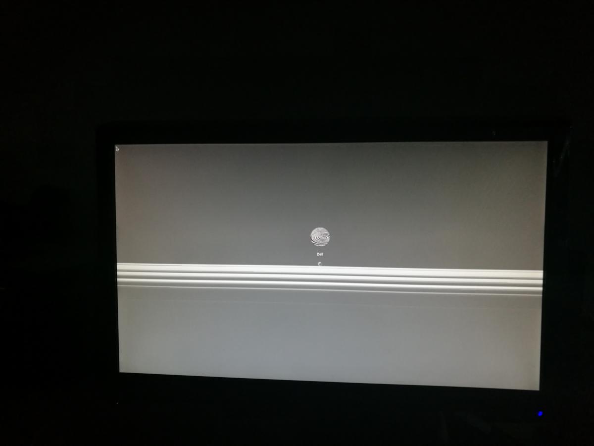

Neys Posted November 5, 2017 Share Posted November 5, 2017 You have a black lines appear like cutting the screen at login on desktop ? I do not know which EFI folder to talk to you, I have sent several. could you upload the EFI file that you use for your HD here you could also Upload the complete System Report in Apple Menu, about this Mac Also try to activate in the Bios /Video /Dual Display, maybe it will have an Impact, I do not know? As I told you, I have 2500k HD 3000 and all of my 4 graphics card ATI 5450 works! Since High Sierra you need a PC with both GPU for the ATI 5450 so you need for the kite roll Back 10.12 and I do not know if the card works on a 2500 i5 should take my CPU i5 2500 to test it and it's not me not interested Hi, Here is the EFI file I used. It actually is the first file you upload to help me, I erased GFX0-SSDT.aml(I was going to upload the file but I am not permited). Regarding the roll back I tried but it did not work(appleACPICPU, MCHC) Thanks Link to comment https://www.insanelymac.com/forum/topic/312656-guide-macos-sierra-1012-dell-optiplex-780-760-755-790-990/page/53/#findComment-2529404 Share on other sites More sharing options...

Neys Posted November 5, 2017 Share Posted November 5, 2017 Ok this one let me know Are you on DVI or HDMI? I am in HDMI, I try the config file but the issue still persists. I attached some photos so you can get a better picture of what is happening. Link to comment https://www.insanelymac.com/forum/topic/312656-guide-macos-sierra-1012-dell-optiplex-780-760-755-790-990/page/53/#findComment-2529637 Share on other sites More sharing options...
chris1111 Posted November 5, 2017 Share Posted November 5, 2017 I am in HDMI, I try the config file but the issue still persists. I attached some photos so you can get a better picture of what is happening. EFI CLOVER/ACPI/patched/GFX0-SSDT.aml Rename GFX0-SSDT.aml to SSDT-GFX0.aml the file was renamed by me because I dont want a used with my other card ATI 5570 And my GT 1030 Link to comment https://www.insanelymac.com/forum/topic/312656-guide-macos-sierra-1012-dell-optiplex-780-760-755-790-990/page/53/#findComment-2529640 Share on other sites More sharing options...
Neys Posted November 5, 2017 Share Posted November 5, 2017 EFI CLOVER/ACPI/patched/GFX0-SSDT.aml Rename GFX0-SSDT.aml to SSDT-GFX0.aml the file was renamed by me because I dont want a used with my other card ATI 5570 And my GT 1030 I rename the file and use the last config file and I am still having the same problem. Link to comment https://www.insanelymac.com/forum/topic/312656-guide-macos-sierra-1012-dell-optiplex-780-760-755-790-990/page/53/#findComment-2529646 Share on other sites More sharing options...
