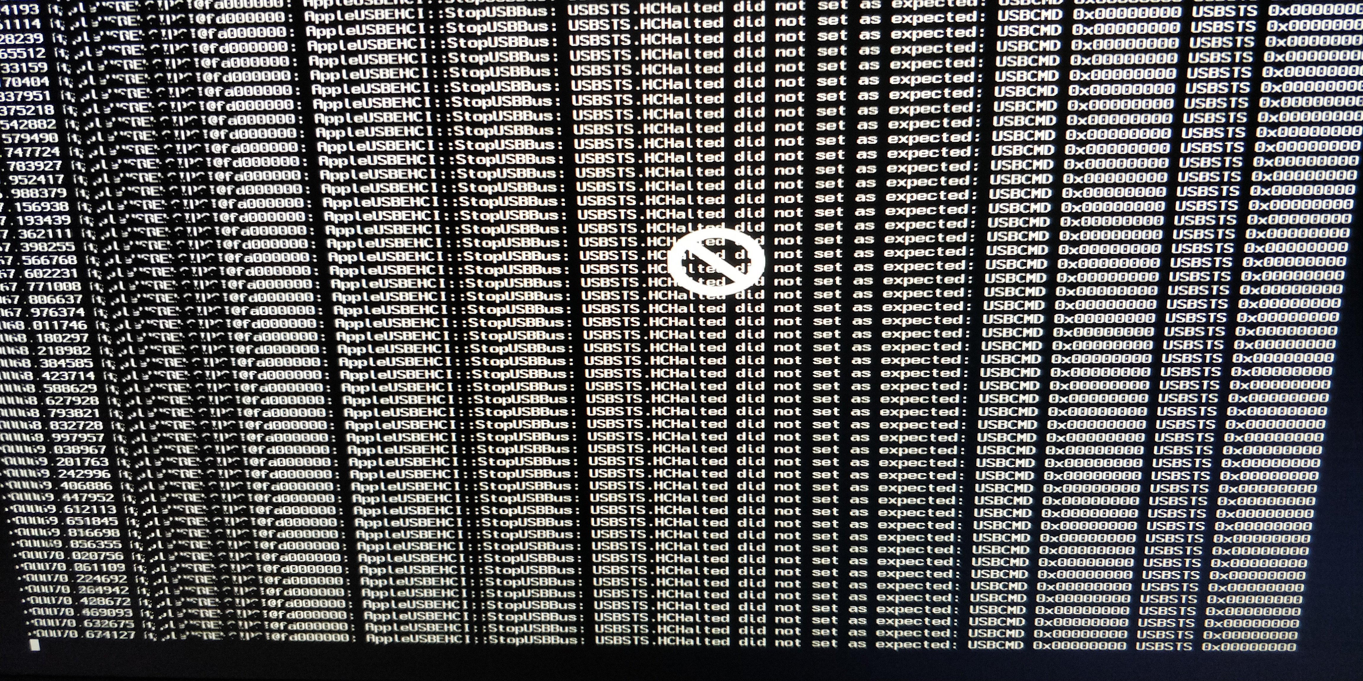

polyzargone Posted July 6, 2019 Share Posted July 6, 2019 8 hours ago, Eceiah said: When i use the latest one, it just gives me error upon installing on the USB. What error exactly? Link to comment https://www.insanelymac.com/forum/topic/312656-guide-macos-sierra-1012-dell-optiplex-780-760-755-790-990/page/63/#findComment-2680404 Share on other sites More sharing options...
MacPeet Posted July 6, 2019 Author Share Posted July 6, 2019 (edited) known problem Delete EHCI (EHC1 / EHC2) completely from the DSDT. OSX configures it very well alone with USBInjextAll.kext in /other and then the USB flash drive boots without problems. Edited July 6, 2019 by MacPeet Link to comment https://www.insanelymac.com/forum/topic/312656-guide-macos-sierra-1012-dell-optiplex-780-760-755-790-990/page/63/#findComment-2680431 Share on other sites More sharing options...

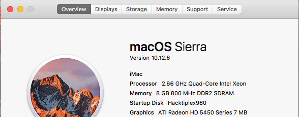

Eceiah Posted July 7, 2019 Share Posted July 7, 2019 11 hours ago, MacPeet said: known problem Delete EHCI (EHC1 / EHC2) completely from the DSDT. OSX configures it very well alone with USBInjextAll.kext in /other and then the USB flash drive boots without problems. I did manage to install sierra 10.12.6 but no audio, gpu = 7mb and lan connection :(( maybe i got confused what files goes to where. even my kext is messed up and when i load dsdt it doesnt boot up. please check my config and advise or edit. these 3 kexts is the only kext on my "Others" folder. Nothing on 10.12 Folder. config.plist AppleALC.kext.zip Lilu.kext.zip USBInjectAll.kext.zip Link to comment https://www.insanelymac.com/forum/topic/312656-guide-macos-sierra-1012-dell-optiplex-780-760-755-790-990/page/63/#findComment-2680461 Share on other sites More sharing options...

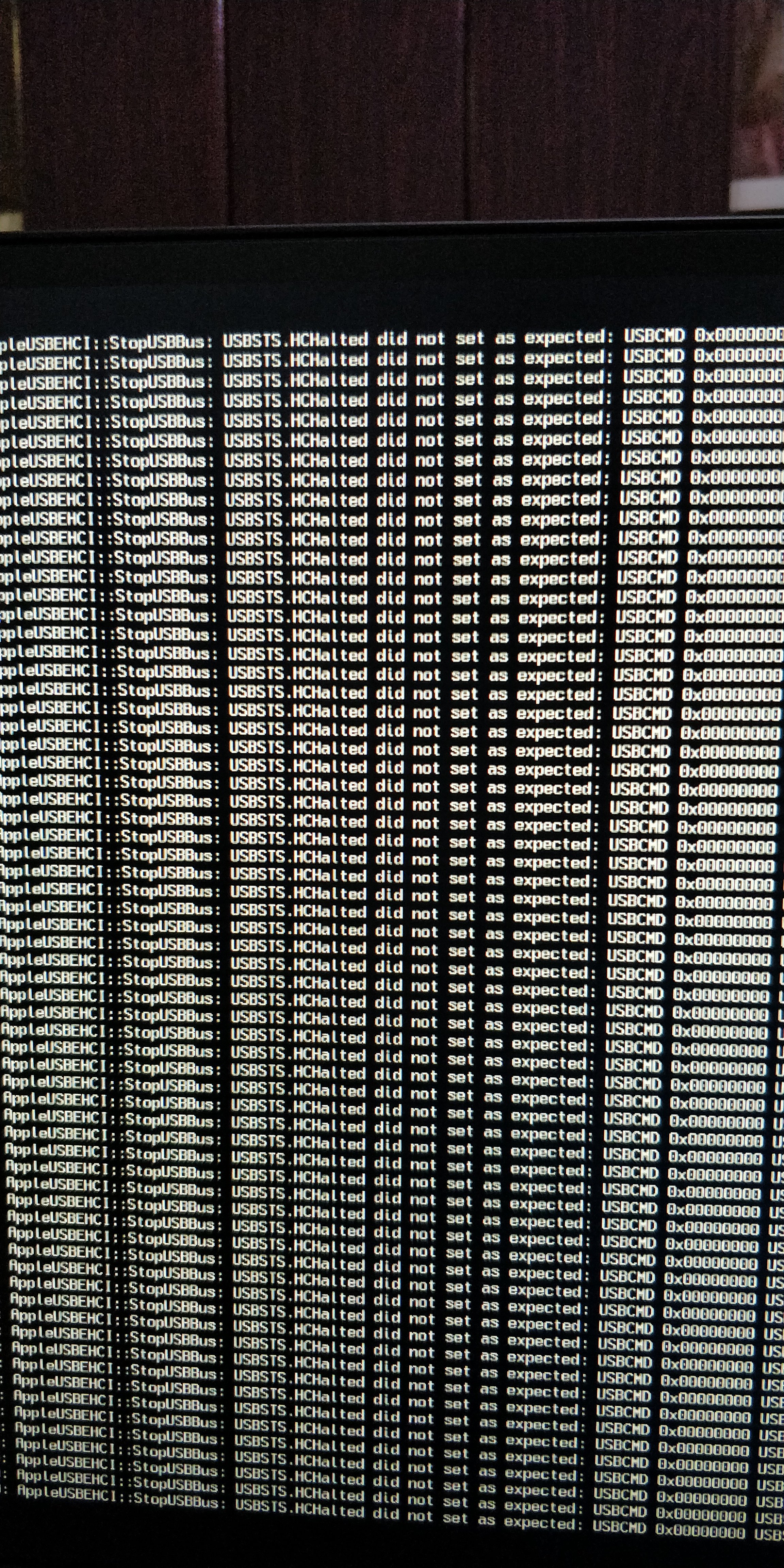

Eceiah Posted July 7, 2019 Share Posted July 7, 2019 4 hours ago, Eceiah said: Yes sir! so you mean if i install the latest clover on the USB Installer and HDD osx version doesnt matter? I did replace my clover folder with yours but now same error :(((( Please help Link to comment https://www.insanelymac.com/forum/topic/312656-guide-macos-sierra-1012-dell-optiplex-780-760-755-790-990/page/63/#findComment-2680535 Share on other sites More sharing options...
Eceiah Posted July 7, 2019 Share Posted July 7, 2019 50 minutes ago, Eceiah said: I did replace my clover folder with yours but now same error :(((( Please help Attached is my current reverted clover. Please assist on GPU and audio... CLOVER.zip Link to comment https://www.insanelymac.com/forum/topic/312656-guide-macos-sierra-1012-dell-optiplex-780-760-755-790-990/page/63/#findComment-2680539 Share on other sites More sharing options...
polyzargone Posted July 7, 2019 Share Posted July 7, 2019 Try another USB port. Or another USB pen (USB 2 if possible). Link to comment https://www.insanelymac.com/forum/topic/312656-guide-macos-sierra-1012-dell-optiplex-780-760-755-790-990/page/63/#findComment-2680550 Share on other sites More sharing options...
Eceiah Posted July 7, 2019 Share Posted July 7, 2019 1 hour ago, Eceiah said: Attached is my current reverted clover. Please assist on GPU and audio... CLOVER.zip 20 minutes ago, polyzargone said: Try another USB port. Or another USB pen (USB 2 if possible). the error appeared while booting your clover folder. Link to comment https://www.insanelymac.com/forum/topic/312656-guide-macos-sierra-1012-dell-optiplex-780-760-755-790-990/page/63/#findComment-2680556 Share on other sites More sharing options...

Eceiah Posted July 8, 2019 Share Posted July 8, 2019 3 hours ago, Eceiah said: I dont understand. Do you want me to reinstall sierra again? Ive tried before all usb ports/4 usb thumb drive but as ive said the all downloadable clover version gives me the same error. I reverted to the last attached clover. Only issue now is the sound and hd5450 not working. Ok i had time today and made another usb installer with attached clover. Used Clover_v2.4k_r4972. Below is the Clover Config. Wish me luck and will update later once done. Followed the Optiplex 760-780 files in the Forum for my Optiplex 960. CLOVER.zip Link to comment https://www.insanelymac.com/forum/topic/312656-guide-macos-sierra-1012-dell-optiplex-780-760-755-790-990/page/63/#findComment-2680600 Share on other sites More sharing options...

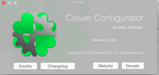

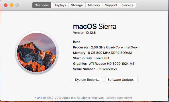

Eceiah Posted July 8, 2019 Share Posted July 8, 2019 11 hours ago, Eceiah said: Ok i had time today and made another usb installer with attached clover. Used Clover_v2.4k_r4972. Below is the Clover Config. Wish me luck and will update later once done. Followed the Optiplex 760-780 files in the Forum for my Optiplex 960. CLOVER.zip UPDATE!!!! All is working fine now!! Thanks to all of you guys! Attached is my current config. Let me know any suggestions! config.plist Link to comment https://www.insanelymac.com/forum/topic/312656-guide-macos-sierra-1012-dell-optiplex-780-760-755-790-990/page/63/#findComment-2680654 Share on other sites More sharing options...
Eceiah Posted July 9, 2019 Share Posted July 9, 2019 (edited) On 7/8/2019 at 12:01 AM, polyzargone said: I said : try another USB port or another USB pen. Hello Poly. Thanks a lot for your kind replies. Ive managed to install everything. Just wanna ask, can i update the security patch directly from app store? Edited July 9, 2019 by Eceiah typo Link to comment https://www.insanelymac.com/forum/topic/312656-guide-macos-sierra-1012-dell-optiplex-780-760-755-790-990/page/63/#findComment-2680719 Share on other sites More sharing options...
