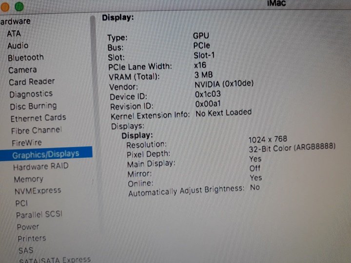

Hi, I need a little help. I managed to install Yosemite, Dell 790 i5 2400, gtx 1060. Everything works, except the gtx1060 video card. I installed nvidia web driver, it loads it but it has no graphics acceleration. El Capitan, Sierra, High Sierra do not manage to install them. I have attached the EFI file, maybe someone can help me make my DSDT. The files are extracted to the origin folder.

I managed to make updates to Sierra from Yosemite. Even so the video card has no graphics acceleration. I installed nvidia web driver. What more needs to be done. So far I have not had any such problem.

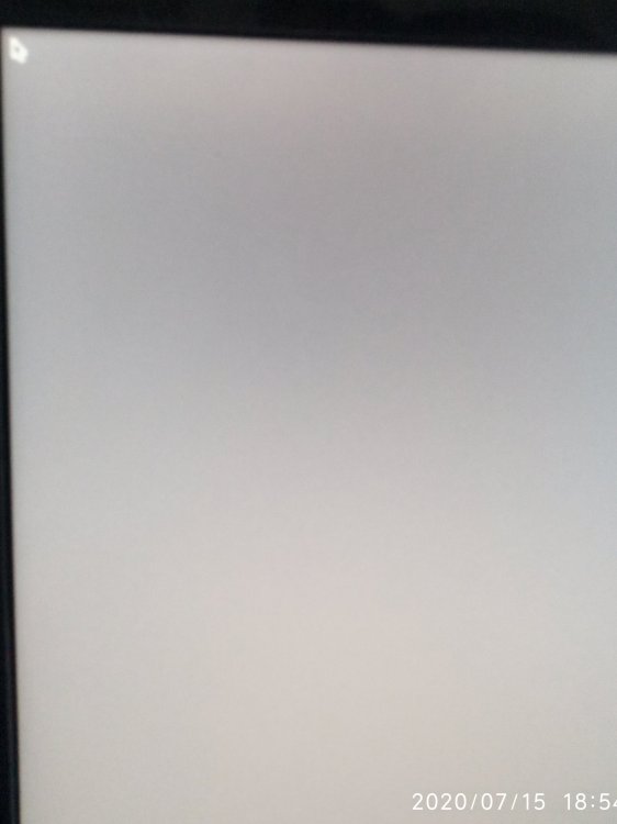

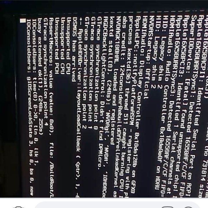

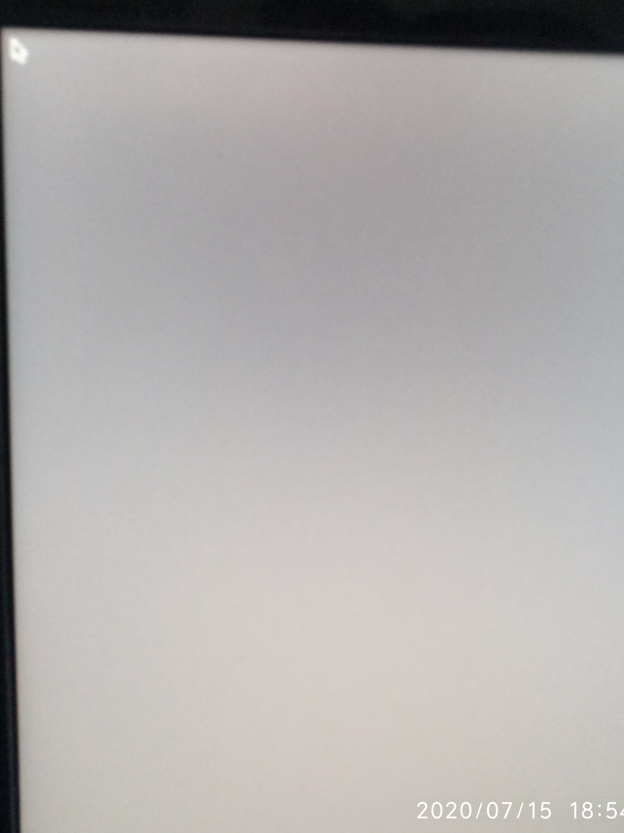

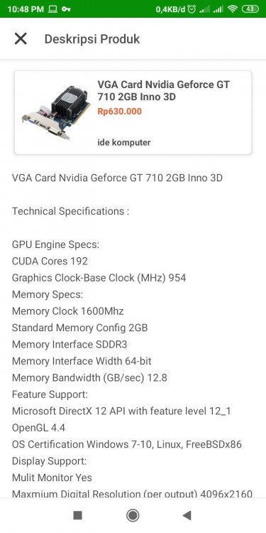

Good night.  I  just had a problem installing osx mojave ... creat install media using MBR after successfully making an installation on usb then I install it to the PC and the hard drive is installed then the pc restarts loading again approximately 85% complete then the pc always repeats the restard My EFI clover  from you @chris1111
after the IOsconsole error then the white screen appears, the mouse pointer 2 seconds the PC is off and restarts again
DELL 780 CORE2DUO E8500 VGA CARD Nvidia GT710 5gb ram hd. 250GB
CLOVER.zip
Remove this -no_compat_check from boot args then add this dart=0
Your DSDT.aml is not good

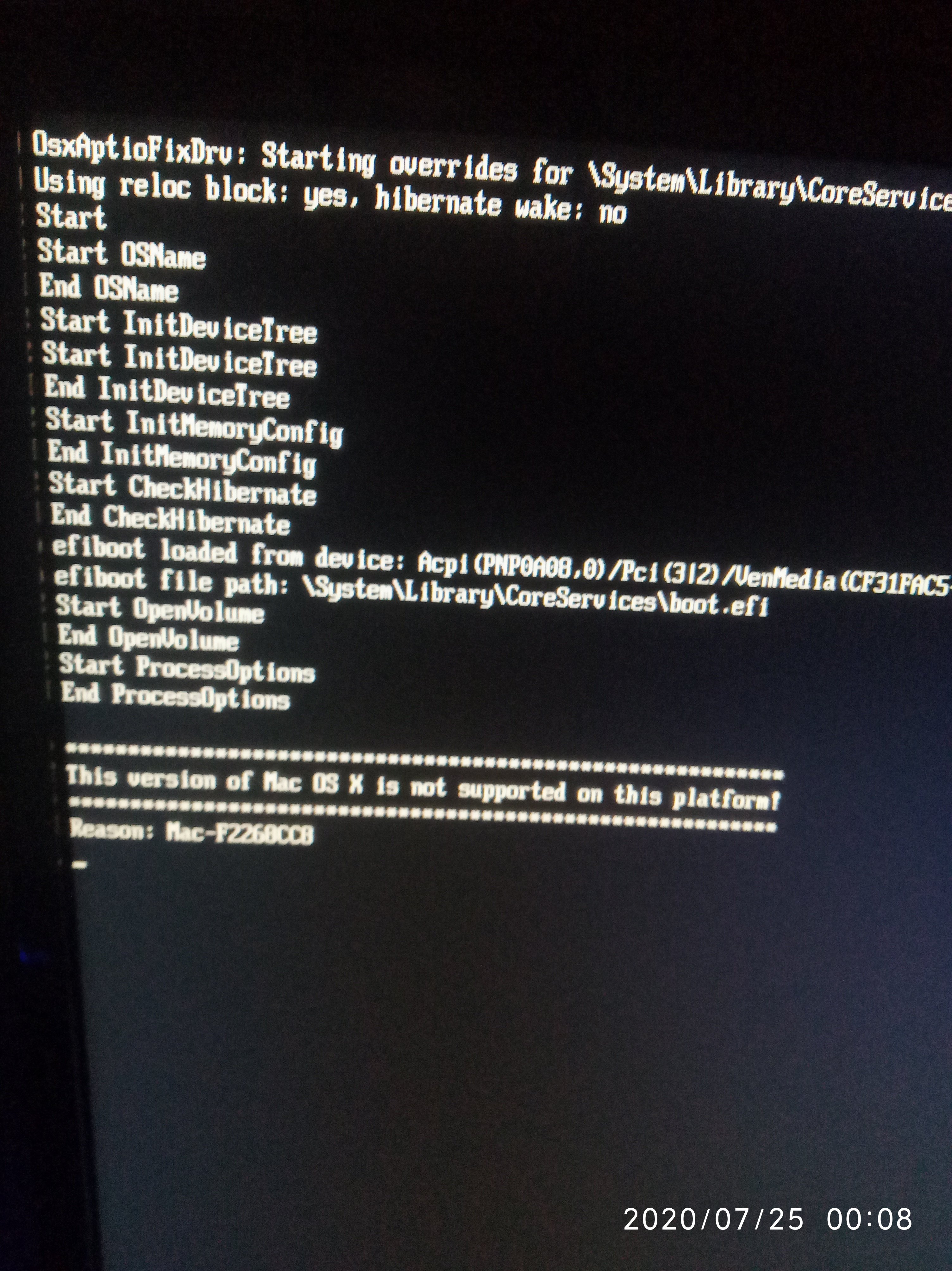

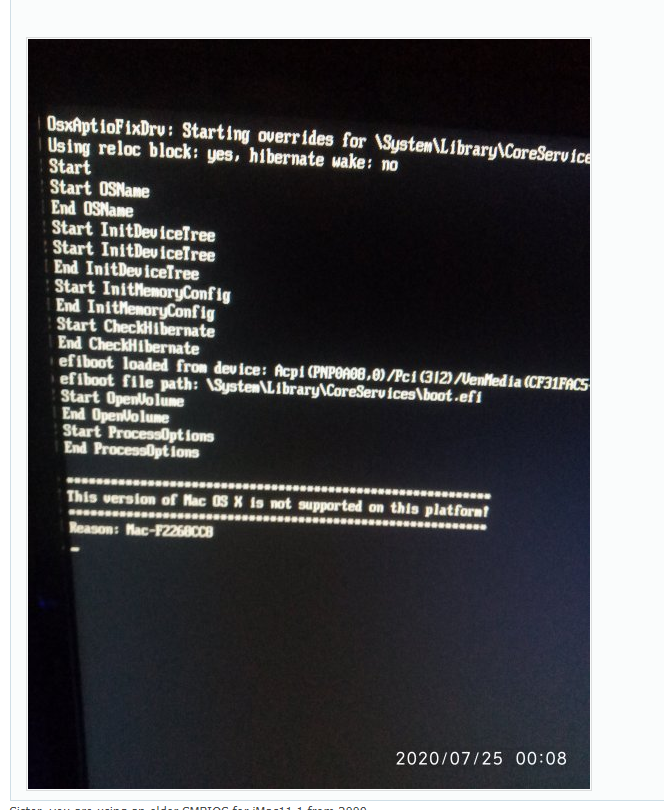

1 hour ago, sonia sudarsono said:
@ chris1111
Sister, you are using an older SMBIOS for iMac11,1 from 2009.
that is not compatible with Mojave, hence the error message that appears at the bottom of your screen "Mac-F228CC8" Use a compatible SMBIOS that will run with macOS mojave.
https://de.wikipedia.org/wiki/IMac
Under this link you will find all compatible Macs that are compatible with mojave.
Then search for these listed compatible models:
iMac: A1418, A1419
iMac Pro: A1862
Mac Pro: A1481
Mac Mini: A1347
MacBook Pro: A1278, A1286, A1398, A1425, A1502, A1706, A1707, A1708
MacBook Air: A1465, A1466
MacBook: A1534
then generate a new smbios for your system using clover configurator.app, then it should boot.

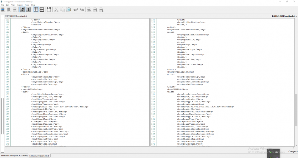

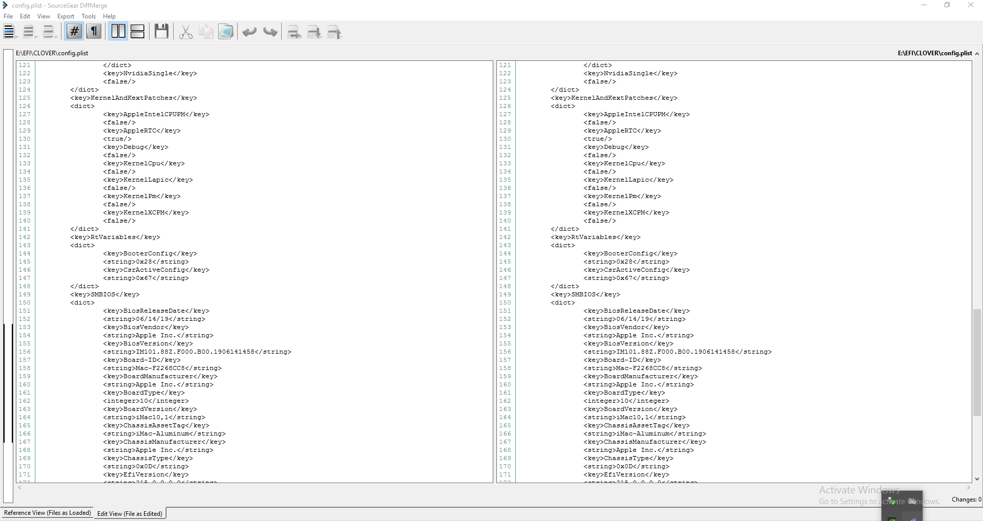

To change or edit the config.plist under Windows operating system, you need the DiffMerge, here is the download link: https://sourcegear.com/diffmerge/downloads.php

how to be able to edit like this .... while this kind of programming language I do not understand at all

I've changed iMac10,1 to iMac15,1, whereby your config.plist needs to be changed according to your hardware spec.
I do not known if the current DSDT is from your system?
In addition, you should hold down the F4 key while booting with clover Bootloader, so that clover saves various DSDTs in EFI folder under EFI/ACPI/origin , then you should upload this folder so that we can try to adapt your DSDT
