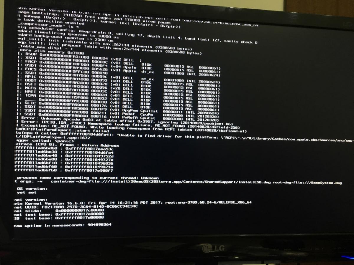

twingolover Posted November 10, 2017 Share Posted November 10, 2017 Hi, i successfully manage and moving hardware of a Dell 990DT on a new case to fit also GPU ATI Radeon R7 260X. boot correctly on Windows and every hardware recognised correctly and without any BIOS warning Now i'm looking how to install Sierra (deleting old Windows installation, i need only osx for test) BIOS give me opportunity to install in Legacy or UEFI mode ( i set Legacy to follow this guide) created Sierra's usb pen on a mac and used last clover using setting: Bootloader / Install boot0af in the MBR CloverEFI / Clover-EFI 64Bit SATA Drivers64UEFI / EmuVariableUefi-64 Drivers64UEFI / OsxAptioFixDrv-64 Drivers64UEFI / PartitionDxe-64 Now i have to copy using DSDT_and_config_for_Optiplex990.zip 14.33KB 300 downloads (Patched DSDT (PEG0) for HD5450, Sound with AppleALC - LayoutID 15 (0F), config: Create serial number, board serial number, MLB, ROM) DSDT.aml insert to EFI/Clover/ACPI/patched/ config.plist insert to EFI/Clover/ and placing kext in 10.12 folder at startup , setting "-v" and "dont' reboot on kernel panic" and i get this https://ibb.co/ewOuTG how i can solve this problem? is related to config plist or DSDT ? Link to comment https://www.insanelymac.com/forum/topic/312656-guide-macos-sierra-1012-dell-optiplex-780-760-755-790-990/page/54/#findComment-2532155 Share on other sites More sharing options...
chris1111 Posted November 10, 2017 Share Posted November 10, 2017 Hi, i successfully manage and moving hardware of a Dell 990DT on a new case to fit also GPU ATI Radeon R7 260X. boot correctly on Windows and every hardware recognised correctly and without any BIOS warning Now i'm looking how to install Sierra (deleting old Windows installation, i need only osx for test) BIOS give me opportunity to install in Legacy or UEFI mode ( i set Legacy to follow this guide) created Sierra's usb pen on a mac and used last clover using setting: Bootloader / Install boot0af in the MBR CloverEFI / Clover-EFI 64Bit SATA Drivers64UEFI / EmuVariableUefi-64 Drivers64UEFI / OsxAptioFixDrv-64 Drivers64UEFI / PartitionDxe-64 Now i have to copy using DSDT_and_config_for_Optiplex990.zip 14.33KB 300 downloads (Patched DSDT (PEG0) for HD5450, Sound with AppleALC - LayoutID 15 (0F), config: Create serial number, board serial number, MLB, ROM) DSDT.aml insert to EFI/Clover/ACPI/patched/ config.plist insert to EFI/Clover/ and placing kext in 10.12 folder at startup , setting "-v" and "dont' reboot on kernel panic" and i get this https://ibb.co/ewOuTG how i can solve this problem? is related to config plist or DSDT ? Under KernelAndKextPatches <key>AppleIntelCPUPM</key> <true/> make a sig of your complete hardware thanks Link to comment https://www.insanelymac.com/forum/topic/312656-guide-macos-sierra-1012-dell-optiplex-780-760-755-790-990/page/54/#findComment-2532182 Share on other sites More sharing options...
twingolover Posted November 10, 2017 Share Posted November 10, 2017 sorry, you're right....signature updated. ok find it under option on startup. Now start but present a new issue....it seems related to an unknown device. can be dued to a bios configuration ? There is a list of thing that i have to disable? http://ibb.co/bS3y7b Link to comment https://www.insanelymac.com/forum/topic/312656-guide-macos-sierra-1012-dell-optiplex-780-760-755-790-990/page/54/#findComment-2532398 Share on other sites More sharing options...
chris1111 Posted November 10, 2017 Share Posted November 10, 2017 sorry, you're right....signature updated. ok find it under option on startup. Now start but present a new issue....it seems related to an unknown device. can be dued to a bios configuration ? There is a list of thing that i have to disable? http://ibb.co/bS3y7b IoconsoleUser GIOScreenLock is relate to the Graphics card You can ry the config.plist attaching here http://www.insanelymac.com/forum/topic/312656-guide-macos-sierra-1012-dell-optiplex-780-760-755-790-990/?p=2531440 You can made some little modifications if this not work 1 Link to comment https://www.insanelymac.com/forum/topic/312656-guide-macos-sierra-1012-dell-optiplex-780-760-755-790-990/page/54/#findComment-2532410 Share on other sites More sharing options...
chris1111 Posted November 11, 2017 Share Posted November 11, 2017 IoconsoleUser GIOScreenLock is relate to the Graphics card You can ry the config.plist attaching here http://www.insanelymac.com/forum/topic/312656-guide-macos-sierra-1012-dell-optiplex-780-760-755-790-990/?p=2531440 You can made some little modifications if this not work See here try to ad the file http://www.insanelymac.com/forum/topic/329530-hp-pavillon-15-no59sf-hang-atioconsoleusers-gioscreenlockstate-3-hs-0-bs-0-now-0-sm-0x0/?p=2532713 Link to comment https://www.insanelymac.com/forum/topic/312656-guide-macos-sierra-1012-dell-optiplex-780-760-755-790-990/page/54/#findComment-2532728 Share on other sites More sharing options...
