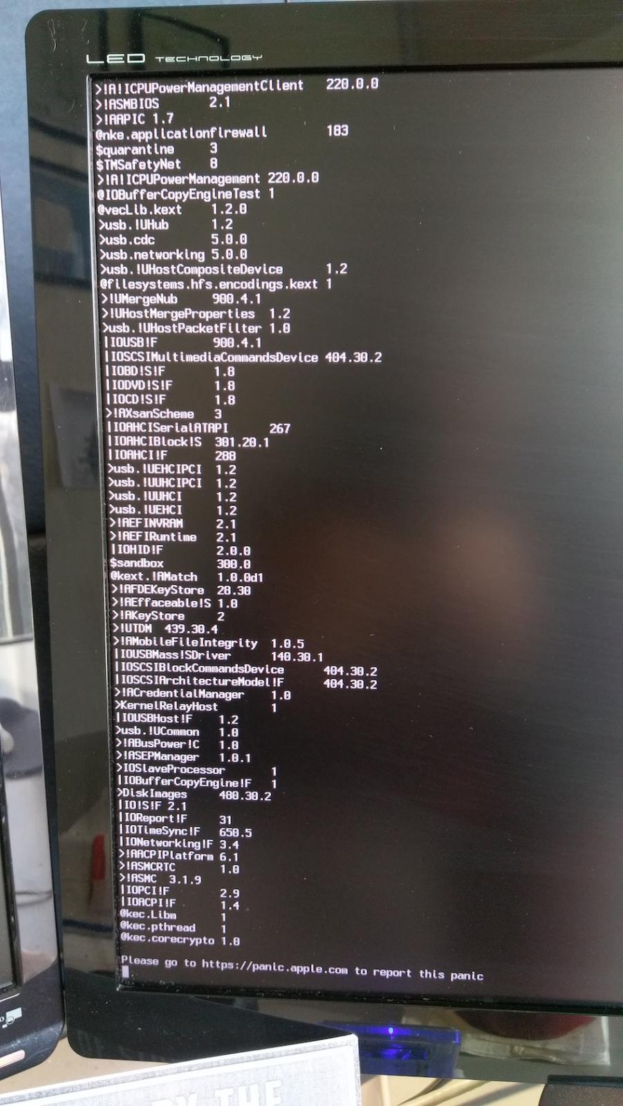

Hey Folks,
   When I upgrade my Dell760 from 10.13.1 to 10.13.2 I am getting kernel panics that i feel is related to the ACPI. Please see screengrab attached. Has anyone any  suggestions of fixes regarding this panic.
Hey Folks,
Update Lilu and AppleALC
Thanks Chris, Updated both and that fixed my bootloop and Sound.

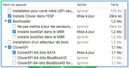

Clover version currently?
Install Clover with the following selection:
Install Clover in the ESP
Bootloader / Install boot0af in the MBR
CloverEFI / Clover EFI 64Bit SATA
Drivers64UEFI / EmuVariableUefi-64
Drivers64UEFI / OsxAptioFixDrv-64
Drivers64UEFI / PartitionDxe-64
Install RC Scripts in Target Volume
try this:

Ok try Fresh Install, 10.12.6
Install Clover ESP like in the image
Change the file in EFI by the fille attaching
You need Plug the screen on  DVI or HDMI
Hope that work
