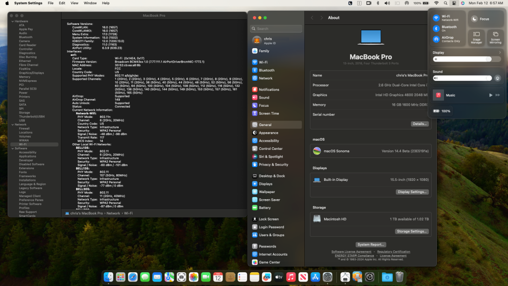

eSaF Posted February 8 Share Posted February 8 (edited) Ok as you can see from the attached pic I managed to get working WiFi and B/Tooth after installing the AX 210 Card. BUT and it's a big BUT, as expected with this Fenvi T-919 alternative setup, AirDrop is only from Mac to iPhone (that's what I got, maybe something needs tweaking??!!). Also my absolute favorite feature 'Handoff to iPhone Camera' is not available. I like to use that feature as the quality of F/Time Video is much better than my webcam especially in low light conditions. I will keep this Beta 2 on the Test Disk until the next Update comes along to play with it but I am very much hoping the Devs can get OCLP back on track for my trusted T-919 Card. I have to give Props to @Max.1974 for the encouragement and @miliuco for providing the files and Notes on the subject, you guys are invaluable, Big Thanks. I have included config.plist and kext files so that someone with more knowledge can make a suggestion to improve (if possible) what is shown. config.plist Edited February 8 by eSaF 5 1 Link to comment Share on other sites More sharing options...
miliuco Posted February 8 Share Posted February 8 (edited) @eSaF Is this setting with Sonoma 14.4 + AirportItlwm? Afaik, Apple has changed things in latest beta in the wifi system and because of this Fenvi wifi don't work after OCLP root patch. But, since AirportItlwm is also wifi system based, I would expect that this kext doesn't work either. Itlwm, instead, is ethernet system based so it can work using the updated version for this macOS. I'm talking without having tried 14.4 so excuse me if I'm wrong. Note: remember that itlwm.kext needs Heliport app to connect to wifi network. If you put Heliport in the startup items, macOS connects to wifi network at every boot. In any case, with both kext you lose Airdrop and Handoff. For Handoff there is no fix but for Airdrop many of us use LocalSend as a replacement to our full satisfaction. Edited February 8 by miliuco 2 1 Link to comment Share on other sites More sharing options...
eSaF Posted February 8 Share Posted February 8 23 minutes ago, miliuco said: @eSaF Is this setting with Sonoma 14.4 + AirportItlwm? Afaik, Apple has changed things in latest beta in the wifi system and because of this Fenvi wifi don't work after OCLP root patch. But, since AirportItlwm is also wifi system based, I would expect that this kext doesn't work either. Itlwm, instead, is ethernet system based so it can work using the updated version for this macOS. I'm talking without having tried 14.4 so excuse me if I'm wrong. Note: remember that itlwm.kext needs Heliport app to connect to wifi network. If you put Heliport in the startup items, macOS connects to wifi network at every boot. In any case, with both kext you lose Airdrop and Handoff. For Handoff there is no fix but for Airdrop many of us use LocalSend as a replacement to our full satisfaction. Thanks Bro for this Beta 14.4, I opted for the other fix in your Guide opposed to the Heliport app fix. I hate the showing of that Icon on the Menu Bar, instead preferring the original look of a Mac WiFi Icon only (yes I know I am fussy ). On the plus side, I like the fact I didn't have to disable SIP, compromising security. If only Handoff to iPhone Camera could be enabled, I could live with the fact AirDrop only worked one way, from Mac to iPhone and not both ways. I still have Beta2 on my Test Disk but switched back to the Disk containing the 14.3 (23D56) version where everything works and I use on a daily basis. 3 1 Link to comment Share on other sites More sharing options...

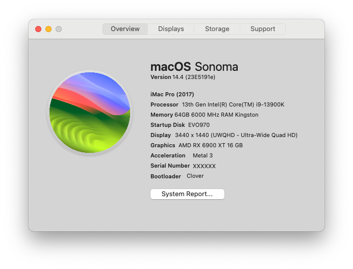

Max.1974 Posted February 9 Share Posted February 9 Here im fine too, but im using Carbon Copy Cloner to clone my MacBookAir. For now working everything, and only using AirportItlwm.kext Beta 14.4 For my friends that ask me what works or not... Spoiler Raptor Lake 13th intel i9-13900K AMD RX 6900 XT Aorus Aorus Z790 Elite AX 211 intel and BRCM BT. God bless you all !! 4 Link to comment Share on other sites More sharing options...

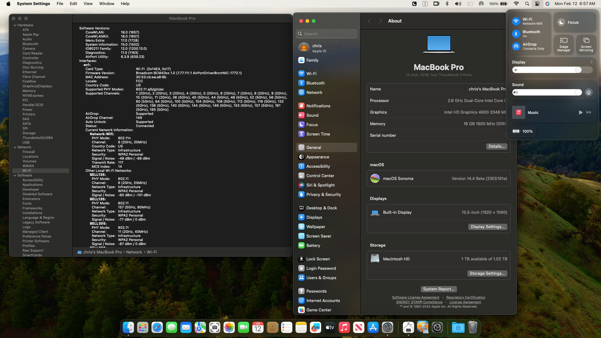

chris1111 Posted February 9 Share Posted February 9 HP EliteBook 840 G4 Latest Beta WIFI Bluetooth OK AX200NGW 6 1 Link to comment Share on other sites More sharing options...
