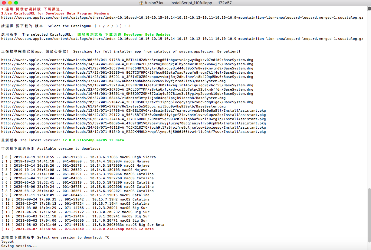

fusion71au Posted June 7, 2021 Share Posted June 7, 2021 Link to macOS Monterey InstallAssistant.pkg (to get full installer app) here: http://swcdn.apple.com/content/downloads/38/12/071-51840-A_R2JDKNM0LX/wqollynqs6j5006166tvw4rliu9htf7swu/InstallAssistant.pkg It was listed alongside the Big Sur Betas as “macOS 12.0.0.21A5248p" on the same software catalog... https://swscan.apple.com/content/catalogs/others/index-10.16seed-10.16-10.15-10.14-10.13-10.12-10.11-10.10-10.9-mountainlion-lion-snowleopard-leopard.merged-1.sucatalog.gz Spoiler 1 Link to comment https://www.insanelymac.com/forum/topic/348725-pre-release-macos-monterey/page/3/#findComment-2760138 Share on other sites More sharing options...

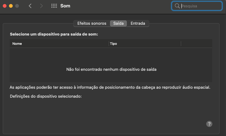

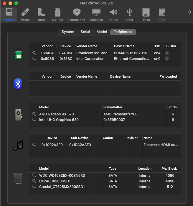

MorenoAv Posted June 7, 2021 Share Posted June 7, 2021 Has anyone solved the lack of sound or are only me that has sound problems? Curiously if I connect my AirPods Pro I have sound, but in Hackintool I only have HDMI sound... 1 Link to comment https://www.insanelymac.com/forum/topic/348725-pre-release-macos-monterey/page/3/#findComment-2760139 Share on other sites More sharing options...

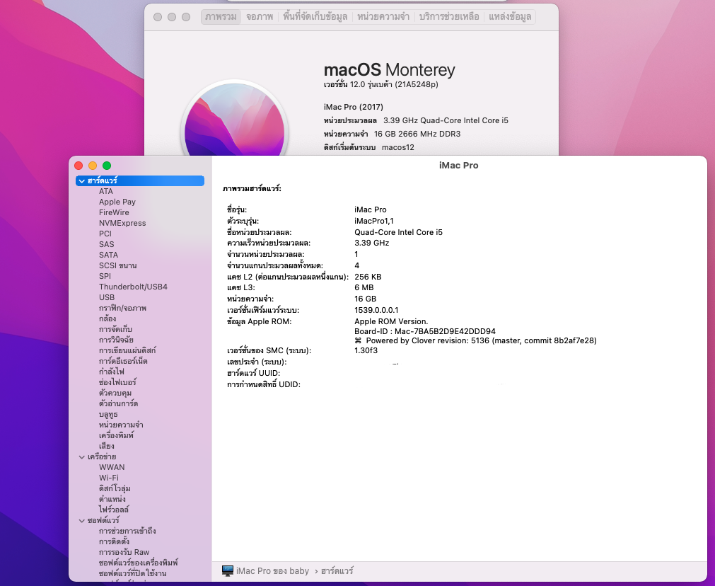

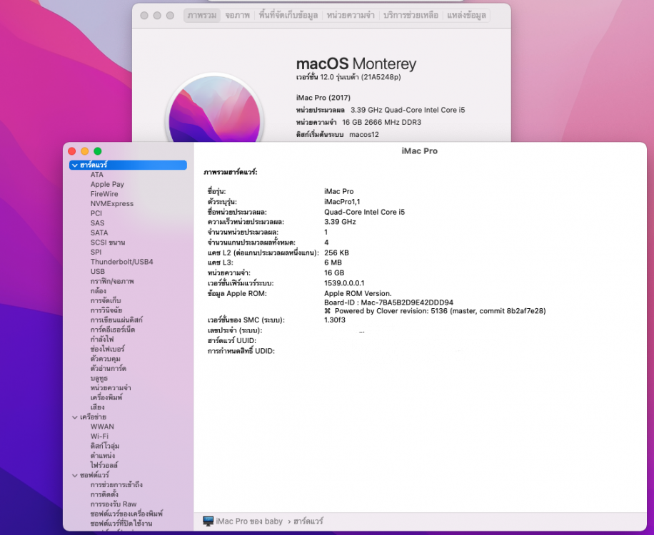

naiclub Posted June 8, 2021 Share Posted June 8, 2021 (edited) My installation is perfect.😁 Edited June 8, 2021 by naiclub 3 Link to comment https://www.insanelymac.com/forum/topic/348725-pre-release-macos-monterey/page/3/#findComment-2760153 Share on other sites More sharing options...

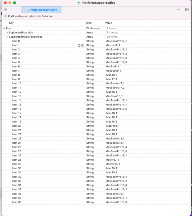

Guest 5T33Z0 Posted June 8, 2021 Share Posted June 8, 2021 Does someone know the minimum SMBIOS for MacBookPros? For Catalina it was 10.1., for BigSur 11,1 this maybe 12,1? Link to comment https://www.insanelymac.com/forum/topic/348725-pre-release-macos-monterey/page/3/#findComment-2760161 Share on other sites More sharing options...
Matgen84 Posted June 8, 2021 Share Posted June 8, 2021 4 minutes ago, 5T33Z0 said: Does someone know the minimum SMBIOS for MacBookPros? For Catalina it was 10.1., for BigSur 11,1 this maybe 12,1? Hi @5T33Z0 I found this on the first page Link to comment https://www.insanelymac.com/forum/topic/348725-pre-release-macos-monterey/page/3/#findComment-2760162 Share on other sites More sharing options...

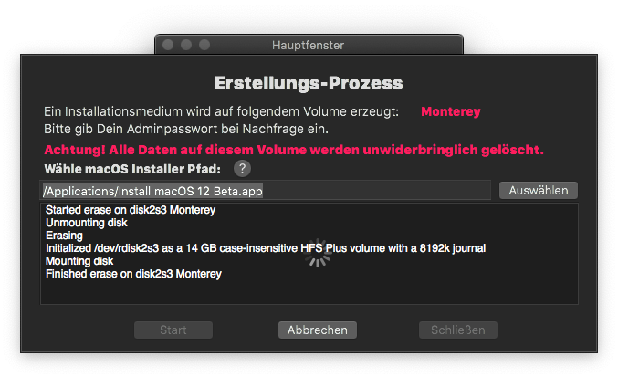

Guest 5T33Z0 Posted June 8, 2021 Share Posted June 8, 2021 (edited) Just building a USB Installer. Requires 14 Gigs… Edited June 10, 2021 by 5T33Z0 Link to comment https://www.insanelymac.com/forum/topic/348725-pre-release-macos-monterey/page/3/#findComment-2760163 Share on other sites More sharing options...
Matgen84 Posted June 8, 2021 Share Posted June 8, 2021 17 minutes ago, 5T33Z0 said: Just building a USB Installer. Requieres 14 Gigs… Hi @5T33Z0 Can you tell me where to find this tool for create USB Installer ! Please. Link to comment https://www.insanelymac.com/forum/topic/348725-pre-release-macos-monterey/page/3/#findComment-2760164 Share on other sites More sharing options...
Guest 5T33Z0 Posted June 8, 2021 Share Posted June 8, 2021 (edited) 4 minutes ago, Matgen84 said: Hi @5T33Z0 Can you tell me where to find this tool for create USB Installer ! Please. It's called ANYmacOS and is from the Cretaor of Kext Updater, @Sascha_77. It can download macOS and create Install Media. Edited June 8, 2021 by 5T33Z0 Link to comment https://www.insanelymac.com/forum/topic/348725-pre-release-macos-monterey/page/3/#findComment-2760165 Share on other sites More sharing options...
d5aqoep Posted June 8, 2021 Share Posted June 8, 2021 7 hours ago, MorenoAv said: Has anyone solved the lack of sound or are only me that has sound problems? Curiously if I connect my AirPods Pro I have sound, but in Hackintool I only have HDMI sound... alcid=28 -lilubetaall -wegbeta under nvram boot-args and zero sound issues here on my AMD RX580. Even the onboard Realtek is getting detected. I am using the following latest kexts enclosed in this post. kexts8june2021.zip 1 Link to comment https://www.insanelymac.com/forum/topic/348725-pre-release-macos-monterey/page/3/#findComment-2760166 Share on other sites More sharing options...
Slice Posted June 8, 2021 Share Posted June 8, 2021 7 hours ago, MorenoAv said: Has anyone solved the lack of sound or are only me that has sound problems? Curiously if I connect my AirPods Pro I have sound, but in Hackintool I only have HDMI sound... Hackintool doesn't support VoodooHDA which can help. 2 Link to comment https://www.insanelymac.com/forum/topic/348725-pre-release-macos-monterey/page/3/#findComment-2760167 Share on other sites More sharing options...
Guest 5T33Z0 Posted June 8, 2021 Share Posted June 8, 2021 First Impressions trying to install it on my Laptop: minimum SMBIOS is MacBookPro11,4 to get the Installer going since it's a Mid 2015 Model. I disabled WLAN and BT in BIOS since I need BrcmBluetoothInjector.kext and BrcmFirmwareData.kext for my card (disabled the kexts as well). But I get stuck in a Loop related to com.apple.bluetooothd. Link to comment https://www.insanelymac.com/forum/topic/348725-pre-release-macos-monterey/page/3/#findComment-2760170 Share on other sites More sharing options...

naiclub Posted June 8, 2021 Share Posted June 8, 2021 (edited) 2 hours ago, 5T33Z0 said: Does someone know the minimum SMBIOS for MacBookPros? For Catalina it was 10.1., for BigSur 11,1 this maybe 12,1? Is this what you asked? Edited June 8, 2021 by naiclub 2 Link to comment https://www.insanelymac.com/forum/topic/348725-pre-release-macos-monterey/page/3/#findComment-2760174 Share on other sites More sharing options...

Guest 5T33Z0 Posted June 8, 2021 Share Posted June 8, 2021 33 minutes ago, naiclub said: Is this what you asked? Nice. Thanks. Where is this file PlatformSupportlist.plist located in the Installer? Link to comment https://www.insanelymac.com/forum/topic/348725-pre-release-macos-monterey/page/3/#findComment-2760178 Share on other sites More sharing options...
