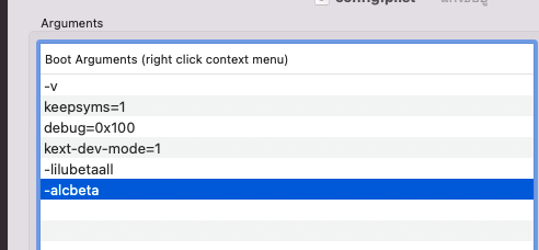

10 minutes ago, naiclub said:
I don't think you need to modify any AppleALC, just follow this picture.
But since @PMheart has released kexts for Monterey (AppleALC included) I think it's better to use them without this boot argument. Same with -lilubetaall, now I'm working without it.
Edited by miliuco
Ah can I get the new version of the file you mentioned so that the boot argument can be taken out. Same with -lilubetaall out of argument thanks.
Yes. New versions have constants for Monterey and beta args are not needed.
and then the new file you mentioned where is it? thanks

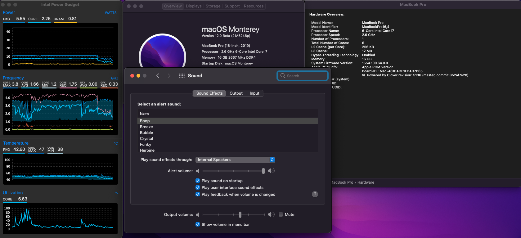

Some of you (or then again maybe none at all) :hysterical:, may be wondering why I've been silent on this Monterey Beta, quite frankly it gave me a battle to get it up and running after a fresh install. Initially I changed nothing from BS but at boot during the verbose text the purple lines appeared like the first BS Beta and then the graphics signal will just die, aha I thought, I need to add a boot arg of some sort. So with my injured pride I scoured the posts here from the knowledgeable and came up with pleasing results, kudos to all the OC Brainiacs here on IM. :thumbsup_anim: See attached (so far as I can tell everything is working apart from Graphics Card is not displayed in About this Mac).
Spoiler
1353986906_ScreenShot2021-06-08at09_56_31.thumb.png.5b10831d1e53efb99d0c37745f0963ce.png686804982_ScreenShot2021-06-08at10_01_20.thumb.png.ad1f7b806a420df1e915211836558fbd.png1102668164_ScreenShot2021-06-08at10_23_14.thumb.png.d1a88f36328f19426b08a85d91c7947c.png658147327_ScreenShot2021-06-08at10_26_28.thumb.png.14641b2d831b3b290b6ede3c17ed26c7.png

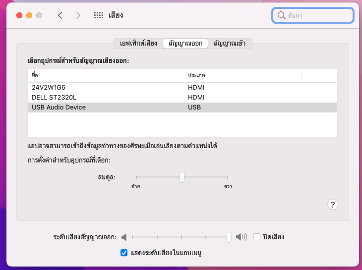

I have updated to the latest version and removed the boot argument. Same with -lilubetaall,alcbetaall but the sound is not complete, still missing HDMI.

1 hour ago, naiclub said:
I have updated to the latest version and removed the boot argument. Same with -lilubetaall,alcbetaall but the sound is not complete, still missing HDMI...
Do you have an USB audio device? Have you installed AppleALCU instead of or in addition to AppleALC?
EDIT: I see you only have AppleALC.
 My post was published a few seconds before yours :)

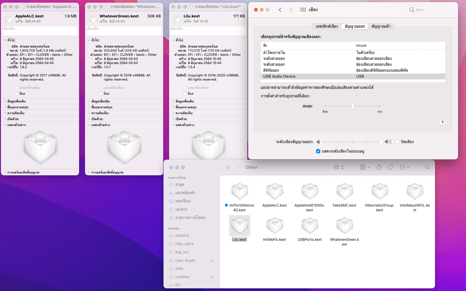

USB audio device. It's headphones. Nothing new. I don't have an AppleALCU like you said above, only had AppleALC from the start. And before that I was using an older version of AppleALC. and it all works fine. Just add what's in the picture.
Edited by naiclub
2 minutes ago, naiclub said:
I don't have an AppleALCU like you said above, only had AppleALC from the start. And before that I was using an older version of AppleALC. and it all works fine. Just add what's in the picture...
If you install the new kexts and remove -alcbeta and -lilubetaall is it fixed?

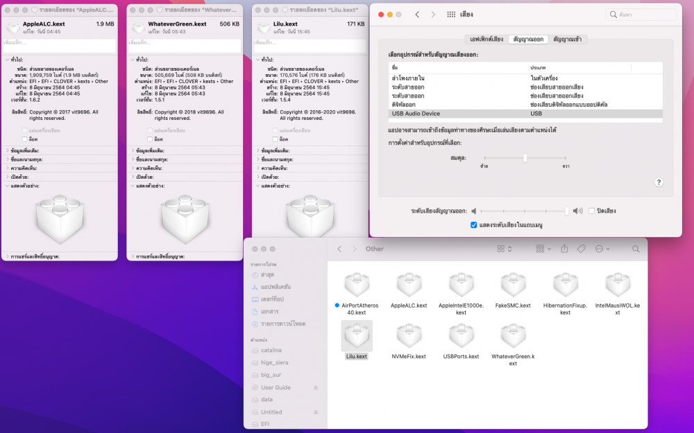

no way and no luck but the opposite I have tried to add as shown in the picture and it's a new version of Kext. What was given instead was like a picture.

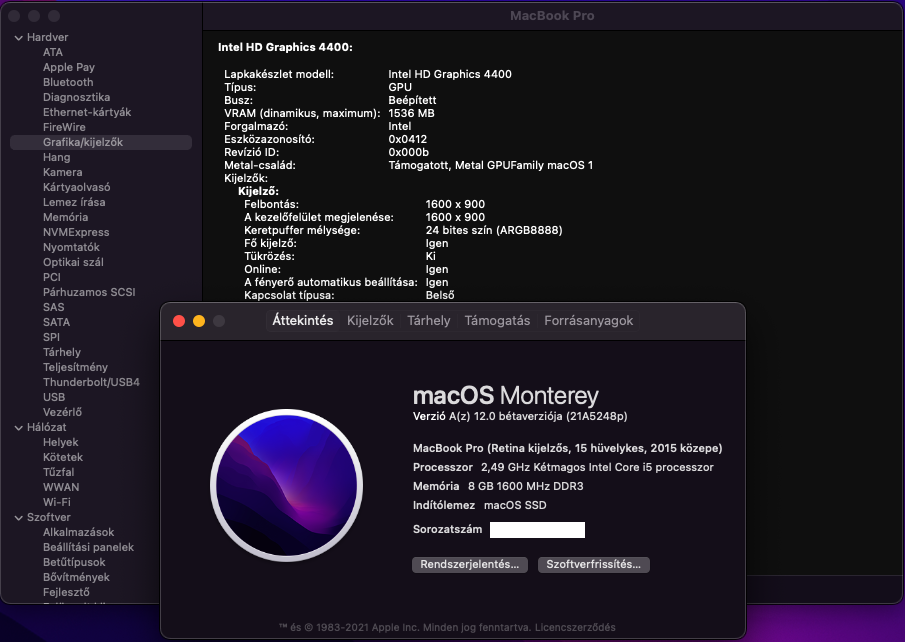

Just installed it on my Lenovo T440 (Haswell HD 4400). Everything is working so far, except the Intel WiFi. Looks like it needs an update from devs.
I just had to change the SMBIOS from MBP11,1 to 11,4. Everything went ok, basically I didn't touch a thing, it went automatically.
Clover v5136, only -lilubetaall bootarg.
Edited by kushwavez

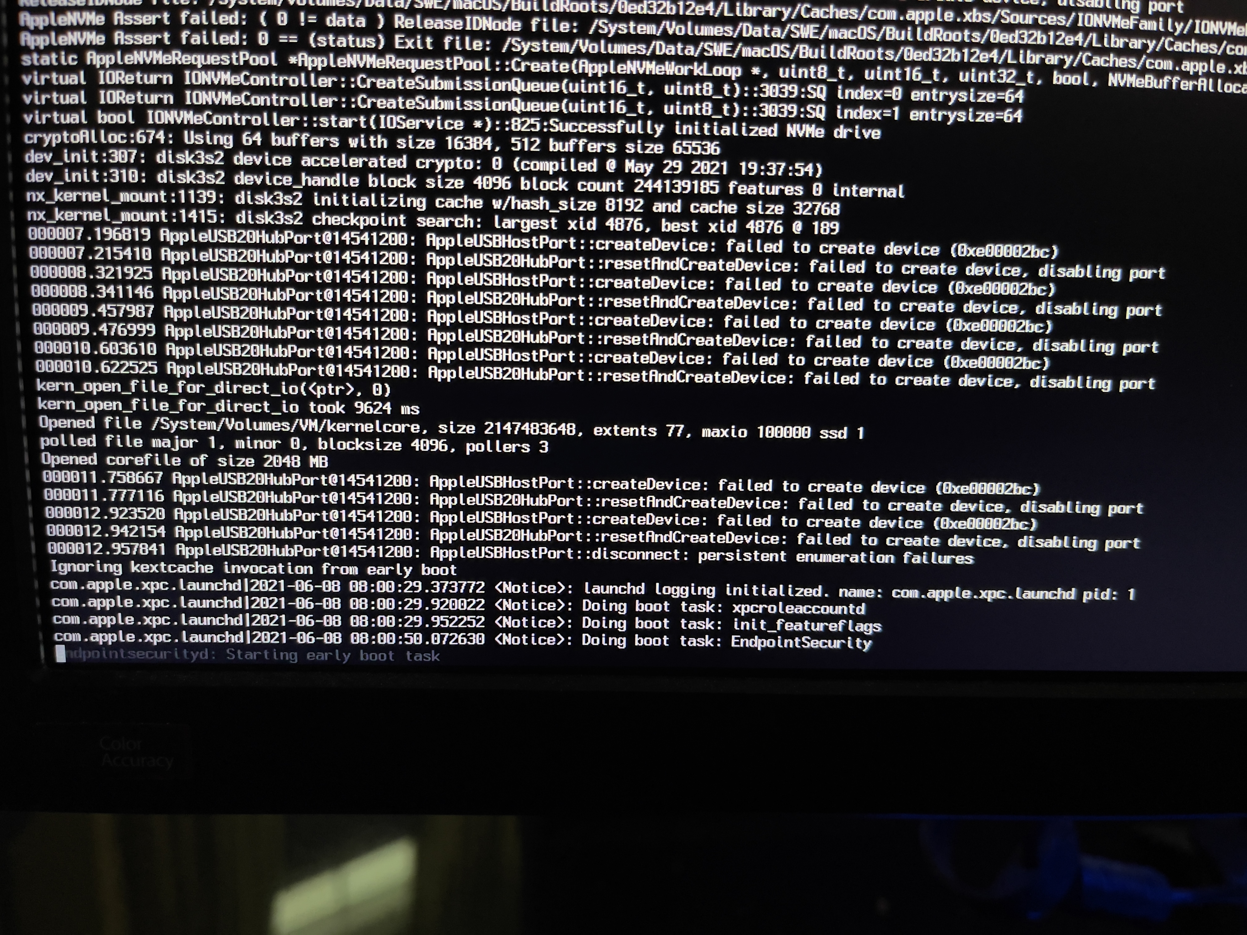

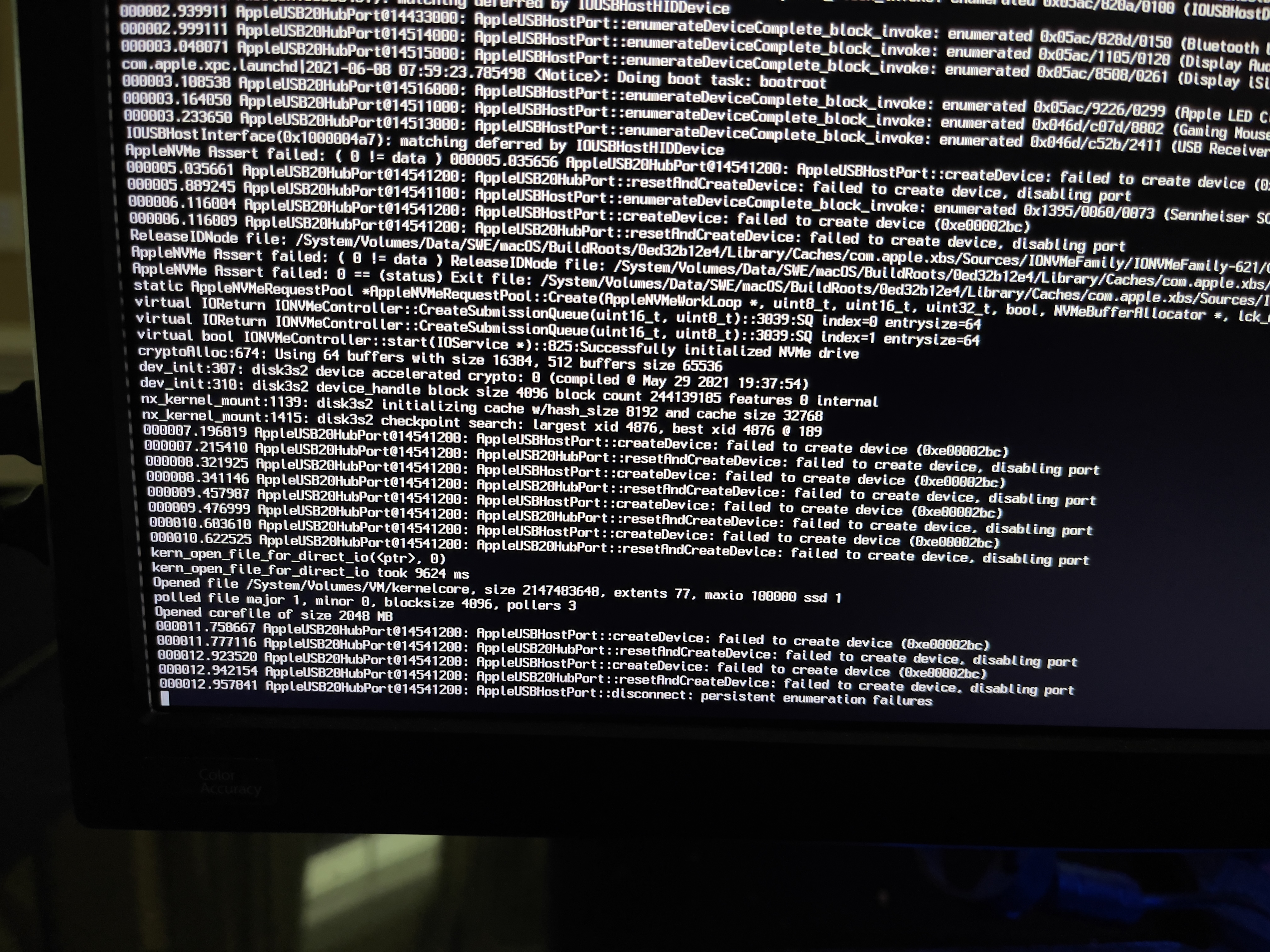

Thanks to everyone posting info on KEXTs, I'm now up and running but have one problem.
I have an extremely long delay in the boot process.
I've added -v and noticed 2 main areas of delay.
The first photo shows errors around AppleUSB20HubPort@14541200
This was by far the longest delay, can someone tell me what this means?
The second is com.apple.xpc.launchd, and any advice is welcome.
thanks.

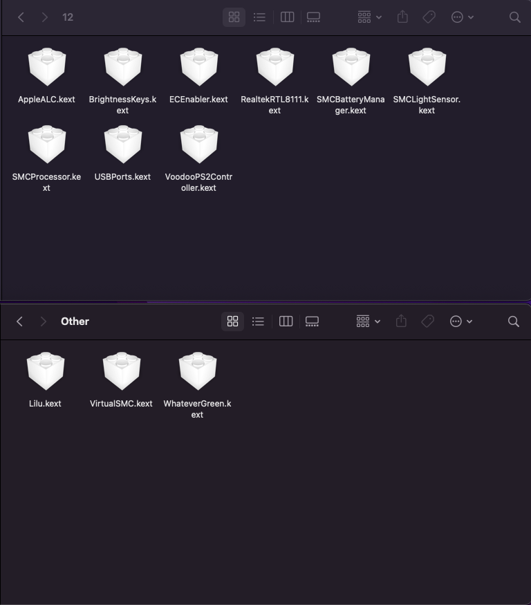

Installing on a separate partition now on my 9th gen laptop.
Has anyone tried to use “12” as a folder for clover kexts? Like we do for Big Sur “11”.
