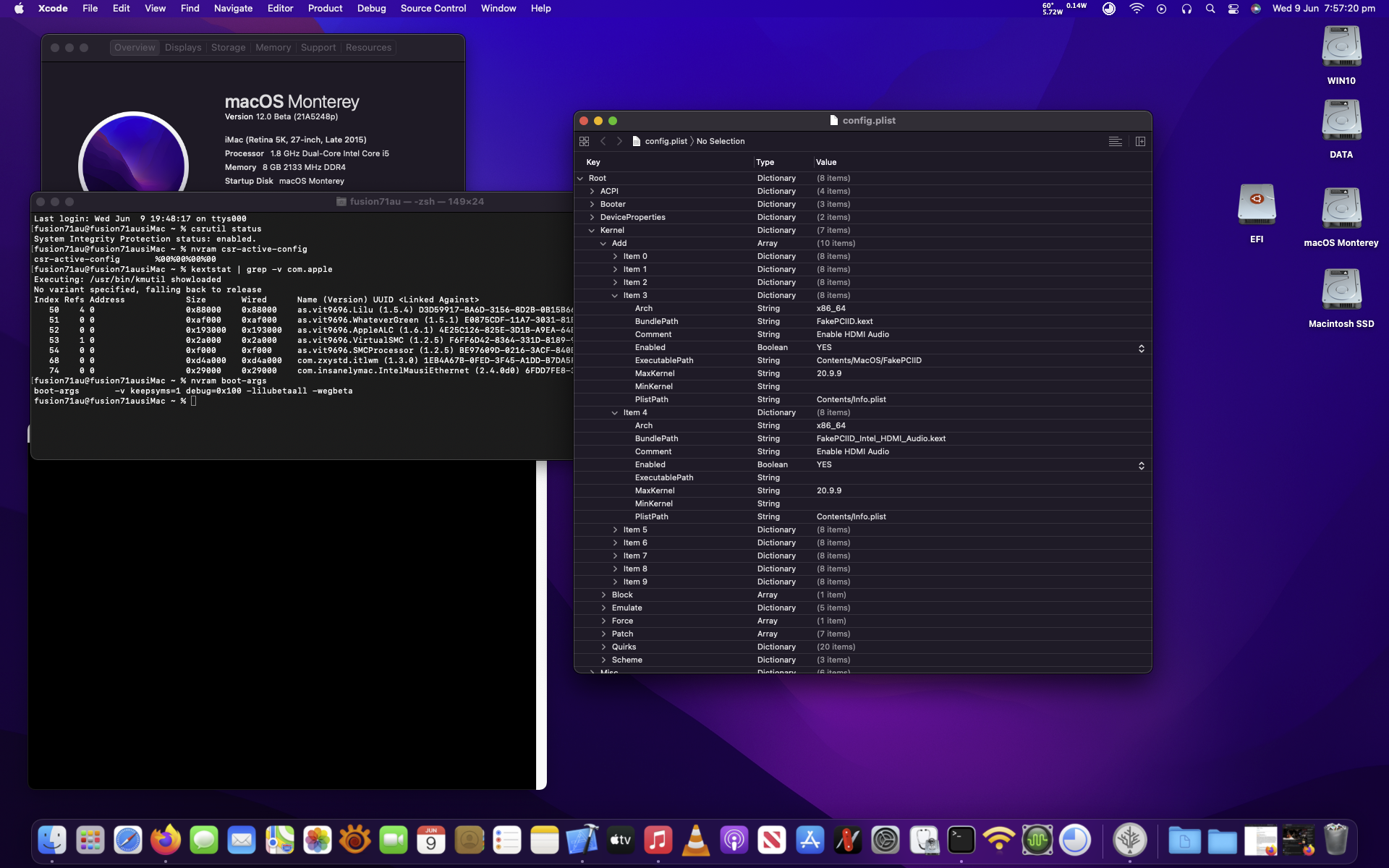

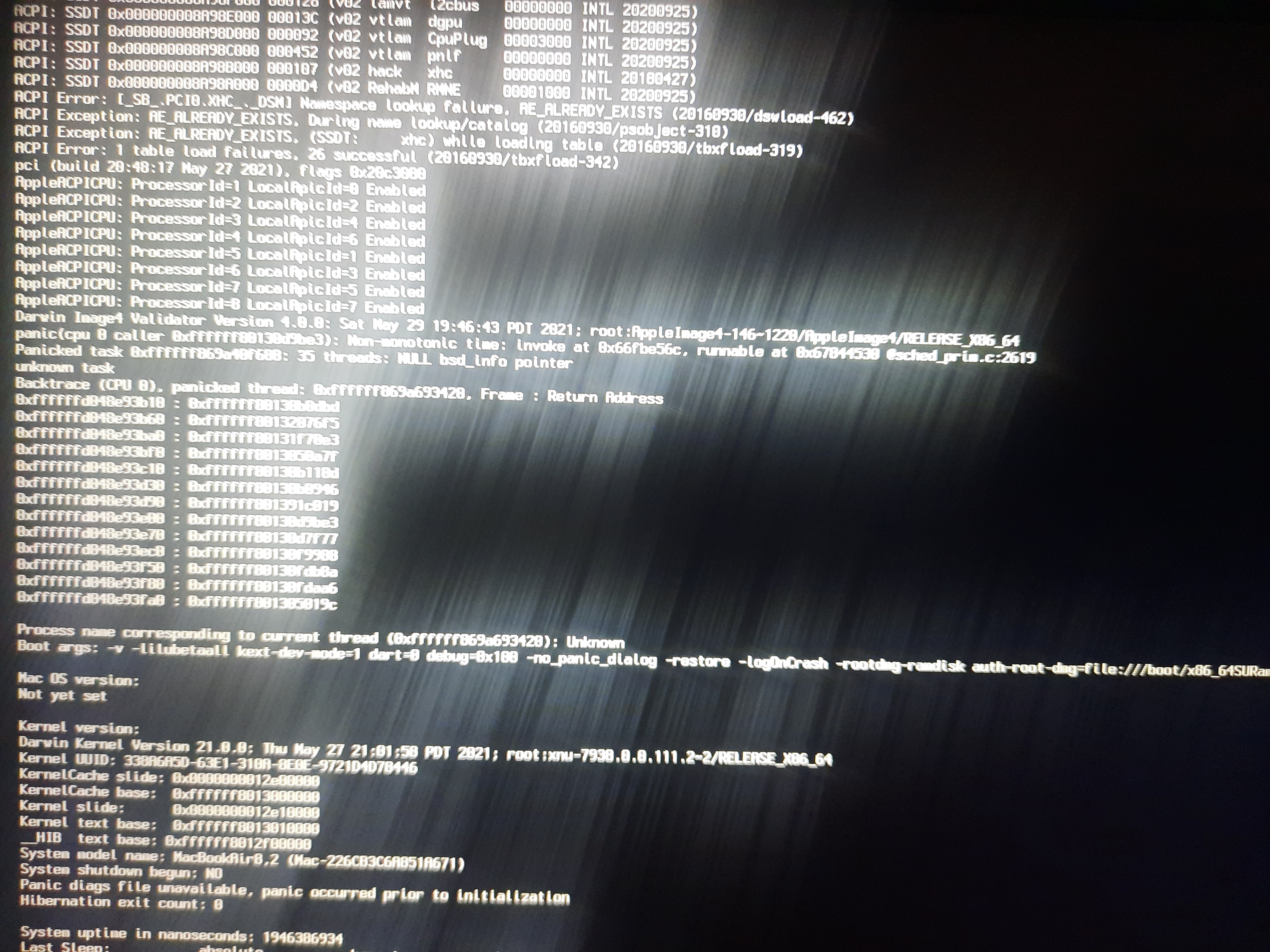

tunglamvghy Posted June 9, 2021 Share Posted June 9, 2021 I've just update to macOS 12 from macOS 11.4 and I get this kernel panic. How can I fix it? Link to comment https://www.insanelymac.com/forum/topic/348725-pre-release-macos-monterey/page/7/#findComment-2760330 Share on other sites More sharing options...
tunglamvghy Posted June 9, 2021 Share Posted June 9, 2021 7 minutes ago, eSaF said: Insure all kexts are updated plus you will need to add certain boot args (see some posts for what is needed in boot args as all systems are not the same, it a case of trial and error at this stage). I compiled all kexts with the latest commits. The boot-args I added -lilubetaall Link to comment https://www.insanelymac.com/forum/topic/348725-pre-release-macos-monterey/page/7/#findComment-2760335 Share on other sites More sharing options...
Matgen84 Posted June 9, 2021 Share Posted June 9, 2021 30 minutes ago, tunglamvghy1210 said: I've just update to macOS 12 from macOS 11.4 and I get this kernel panic. How can I fix it? Do you try to delete boot-args author-root-dmg. Link to comment https://www.insanelymac.com/forum/topic/348725-pre-release-macos-monterey/page/7/#findComment-2760336 Share on other sites More sharing options...
tunglamvghy Posted June 9, 2021 Share Posted June 9, 2021 (edited) 11 minutes ago, Matgen84 said: Do you try to delete boot-args author-root-dmg. How can I delete it? It was automatically added when installing. It's not in boot-args in config.plist Edited June 9, 2021 by tunglamvghy1210 Link to comment https://www.insanelymac.com/forum/topic/348725-pre-release-macos-monterey/page/7/#findComment-2760337 Share on other sites More sharing options...
Matgen84 Posted June 9, 2021 Share Posted June 9, 2021 7 minutes ago, tunglamvghy1210 said: How can I delete it? It was automatically added when installing. It's not in boot-args in config.plist Sorry, I mistaken Link to comment https://www.insanelymac.com/forum/topic/348725-pre-release-macos-monterey/page/7/#findComment-2760338 Share on other sites More sharing options...

miliuco Posted June 9, 2021 Share Posted June 9, 2021 1 hour ago, tunglamvghy1210 said: I've just update to macOS 12 from macOS 11.4 and I get this kernel panic. How can I fix it?... Please fill in your signature (user > profile). If we don't know your hardware, we can't help you. Link to comment https://www.insanelymac.com/forum/topic/348725-pre-release-macos-monterey/page/7/#findComment-2760340 Share on other sites More sharing options...
miliuco Posted June 9, 2021 Share Posted June 9, 2021 @Matgen84 Some boot args seen on the screen do not come from config.plist. However, we can't help @tunglamvghy1210 if he does not write a signature with his hardware. Link to comment https://www.insanelymac.com/forum/topic/348725-pre-release-macos-monterey/page/7/#findComment-2760342 Share on other sites More sharing options...
fusion71au Posted June 9, 2021 Share Posted June 9, 2021 Clean installed macOS Monterey beta1 on my Skylake NUC6i5SYH with OC 0.7.0 and latest Acidanthera kexts as of 6/8/21 (iMac17,1 SMBIOS). I still needed -lilubetaall in my boot args for AppleALC v1.6.1 to work and get audio output. Finally running stable after I disabled loading of FakePCIID.kext & FakePCIID_Intel_HDMI_Audio.kext in my config.plist (these were causing random KPs after 4-5 minutes of the system running)... Spoiler Mostly everything works except HDMI audio/ FakePCIID issue mentioned above. Open Intel Wireless itlwm.kext still OK for the NUC's Intel Wireless-AC 8260. However noticed ProperTree plist editor loads in black screen window 🤔. 1 Link to comment https://www.insanelymac.com/forum/topic/348725-pre-release-macos-monterey/page/7/#findComment-2760344 Share on other sites More sharing options...

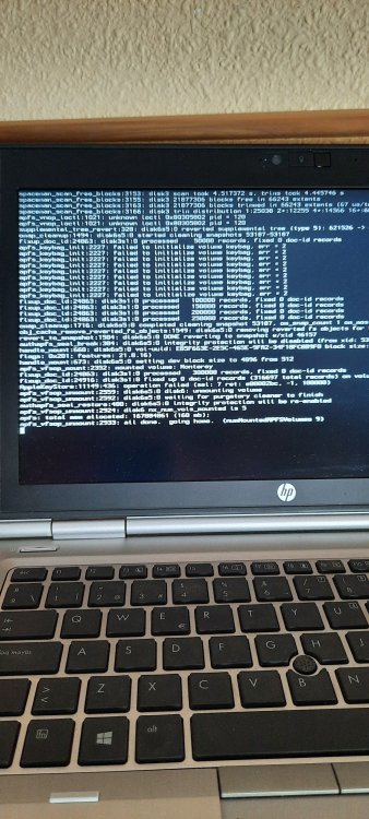

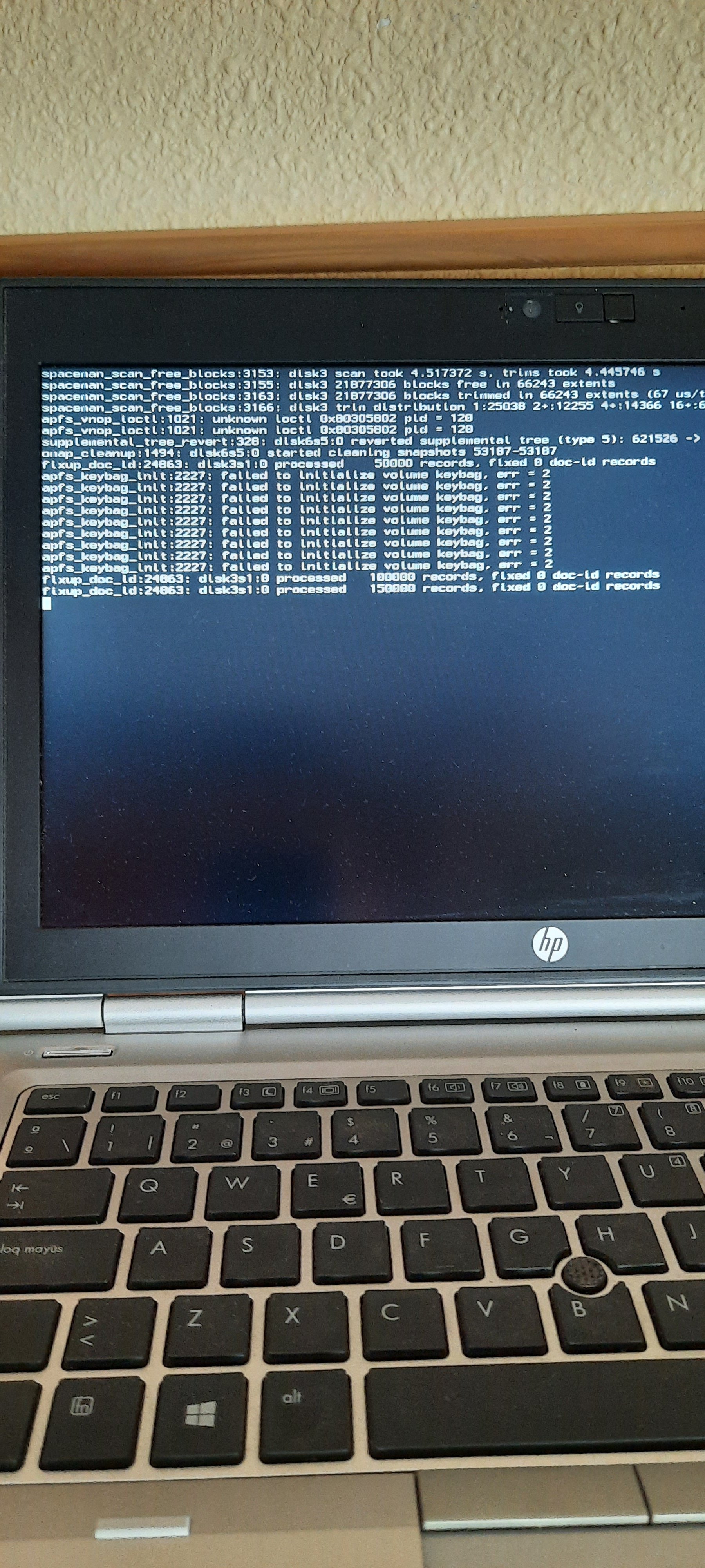

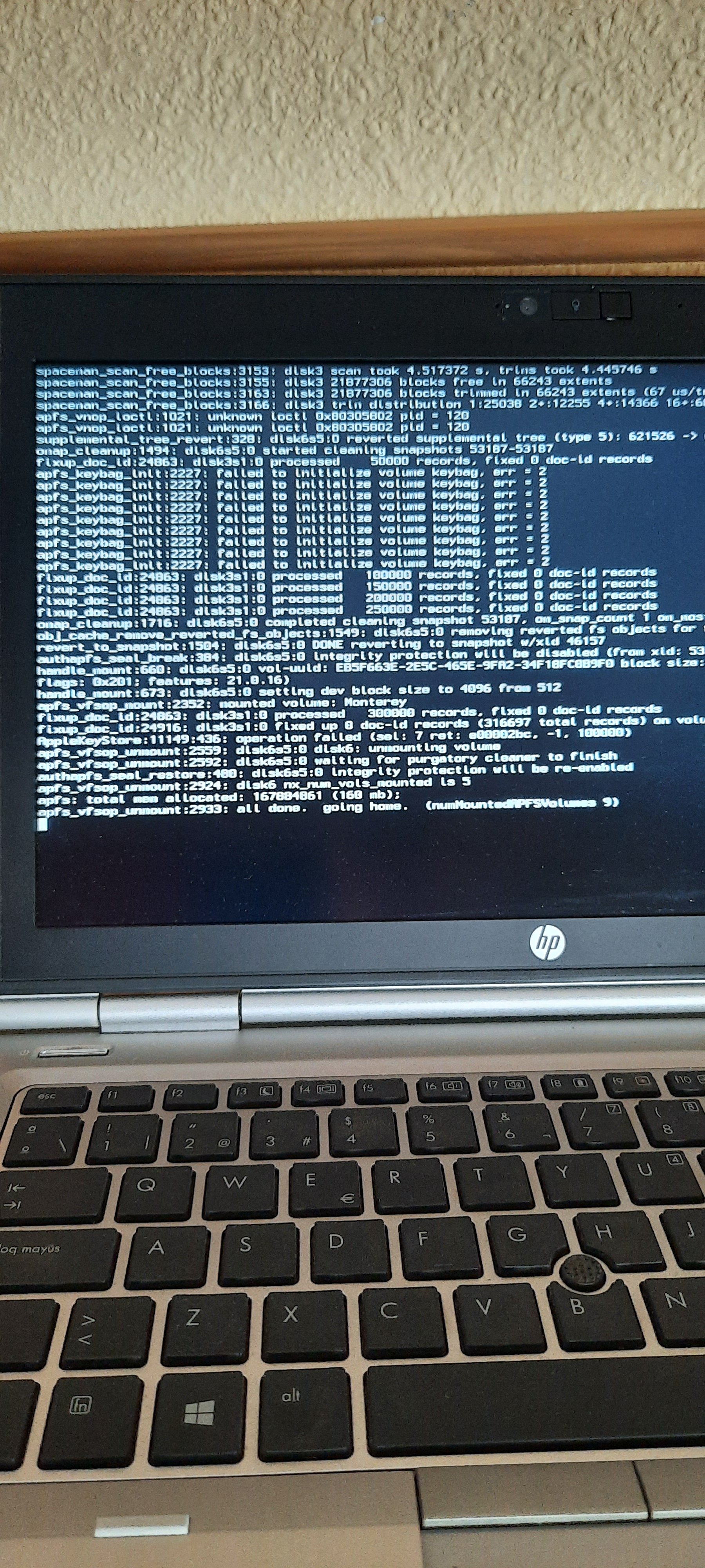

asdesoso Posted June 9, 2021 Share Posted June 9, 2021 21 hours ago, chris1111 said: If you find the solution let me known same issue on my Probook 6570 b Apple Drop support HD 4000 Hi @chris1111 Here we are again, with our HP ProBook/EliteBook Intel Ivy Bridge 3rd generation, in my case I have an EliteBook 2570P as you know, last year I thought that our HD 4000 will be deprecated, but with Big Sur HD 4000 was already supported natively. But lasts weeks I was thinking that this year with Monterey our HD 4000, will be deprecated finally, and badly this happens. I tried to put all HD 4000 kexts from Big Sur 11.4 into S/L/E in Monterey volume, also to put it into OC/Kexts, but the same. I read on macrumors forum, that if there is a Nvidia Kepler combined with HD 4000, both two will run OK, but if we have only HD 4000, there is a problem related with WindowServer, that causes and crashes as I attach in the photos. I update from Big Sur 11.4 to Monterey 12.0 DP1 into my Haswell based machine, without any problem, all is running fine, except audio, ALC892, but currently I don´t care about this. So my priority is related with HD 4000 in my 2570P. Currently I´m using your OC creator script, so I am trying to boot up Monterey with the EFI created by your script. Cheers. Link to comment https://www.insanelymac.com/forum/topic/348725-pre-release-macos-monterey/page/7/#findComment-2760349 Share on other sites More sharing options...

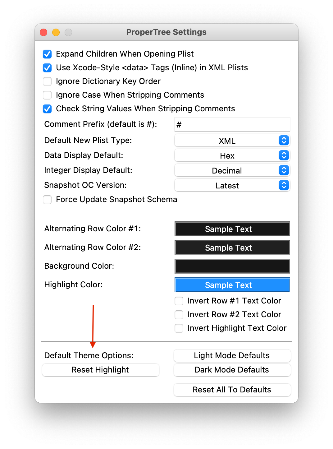

miliuco Posted June 9, 2021 Share Posted June 9, 2021 (edited) 1 hour ago, fusion71au said: ...However noticed ProperTree plist editor loads in black screen window 🤔. Current version of ProperTree runs in dark mode by default. Have you this preferences window? Here yo can switch theme. 11 minutes ago, eSaF said: ... possibly understand your problem and offer good advise. In my boot arg I had to add these two entries to get Monterey to boot (see attached)... I don't know if this will be enough to repair his error. See that in boot args he already has -lilubetaall. I think it is something more complex. Edited June 9, 2021 by miliuco 1 Link to comment https://www.insanelymac.com/forum/topic/348725-pre-release-macos-monterey/page/7/#findComment-2760356 Share on other sites More sharing options...

dehjomz Posted June 9, 2021 Share Posted June 9, 2021 (edited) I was having kernel panics every 5 minutes. I can confirm that removing FakePCIID.kext and other related FakePCIID kexts (e.g., Intel i225-V for ethernet) from loading stops the kernel panics. System is now stable. Sleep/wake works now. In fact, I've realized that I don't even need the Fake PCIID kexts anymore: as audio loads with AppleALC, and the built in AppleEthernetE1000.dext loads for my Intel i225-V card... (not that I was using the Intel 2.5 Gbps card anyways). With how visually similar Monterey looks to Big Sur, can anyone confirm or speculate as to the reasons why you're interested or excited in upgrading from Big Sur? I saw the keynote, but I don't see anything all that compelling about Monterey... If you add the Monterey wallpaper *.heic to Big Sur, the two operating systems will look practically the same, although I have noticed some differences in some of the dialog boxes. Some of my Apps don't work yet with Monterey, like Serato. I just want to know some reasons why others are interested in Monterey, I may be missing something. Thanks! Edited June 9, 2021 by dehjomz Link to comment https://www.insanelymac.com/forum/topic/348725-pre-release-macos-monterey/page/7/#findComment-2760373 Share on other sites More sharing options...

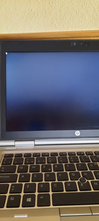

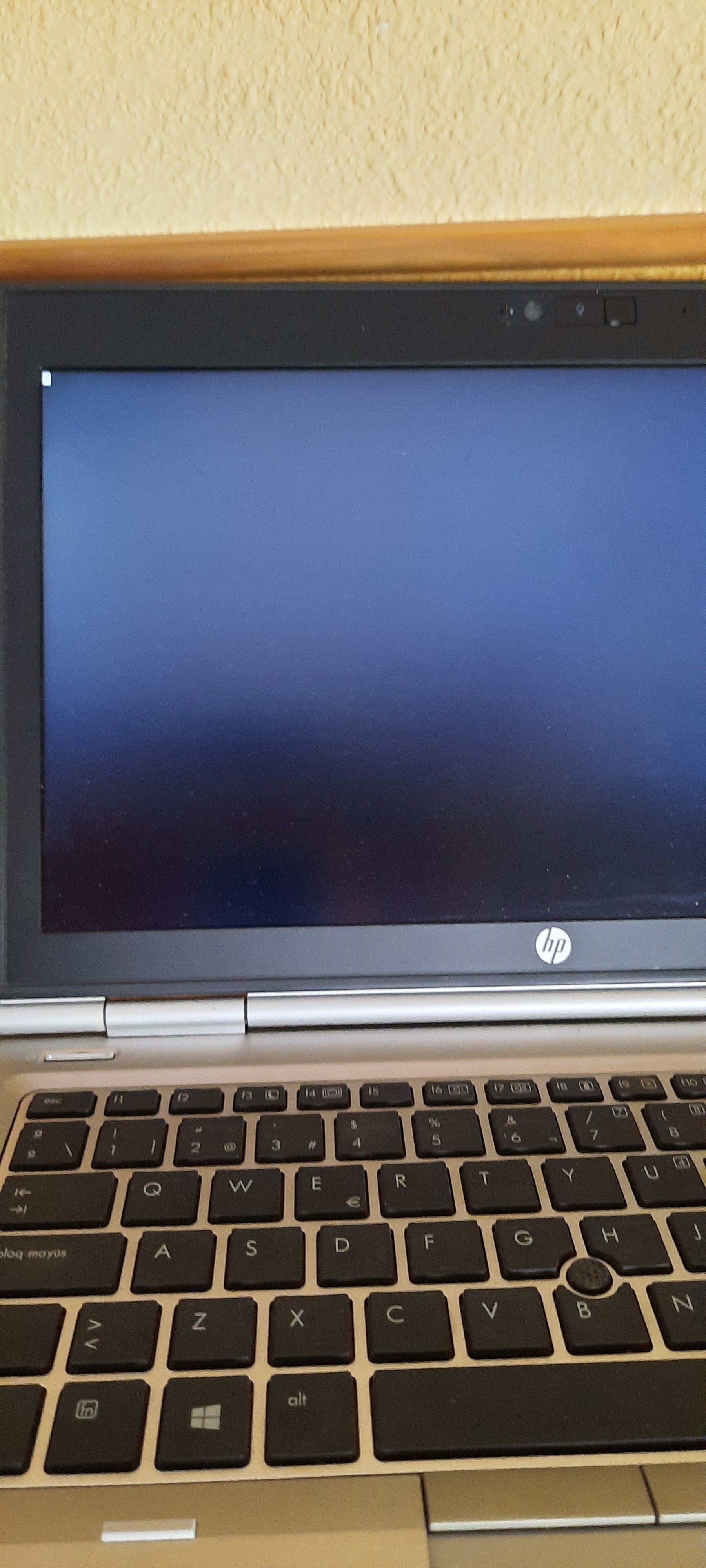

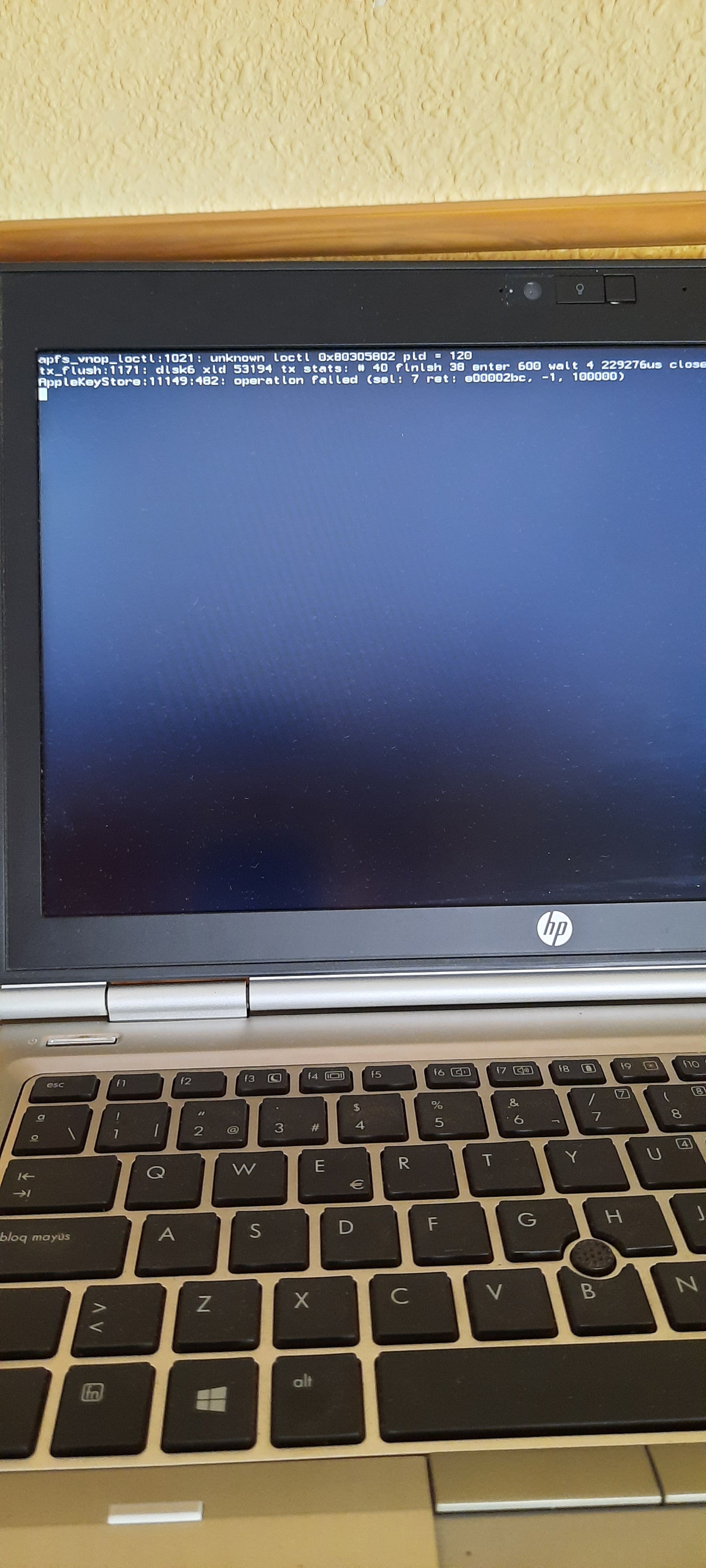

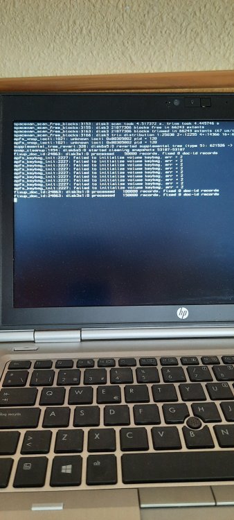

Partime Posted June 9, 2021 Share Posted June 9, 2021 50 minutes ago, zerking said: Does any one got a hang for a long while before getting into the login screen? Besides, my Orico BT403 bluetooth dongle stop working on Monterey even though it's working fine with Big Sur. yes. I had a post on page 5 with pictures. I've added -v and noticed 2 main areas of delay. The first photo shows errors around AppleUSB20HubPort@14541200 This was by far the longest delay, can someone tell me what this means? The second is com.apple.xpc.launchd, and any advice is welcome. 1 Link to comment https://www.insanelymac.com/forum/topic/348725-pre-release-macos-monterey/page/7/#findComment-2760382 Share on other sites More sharing options...
